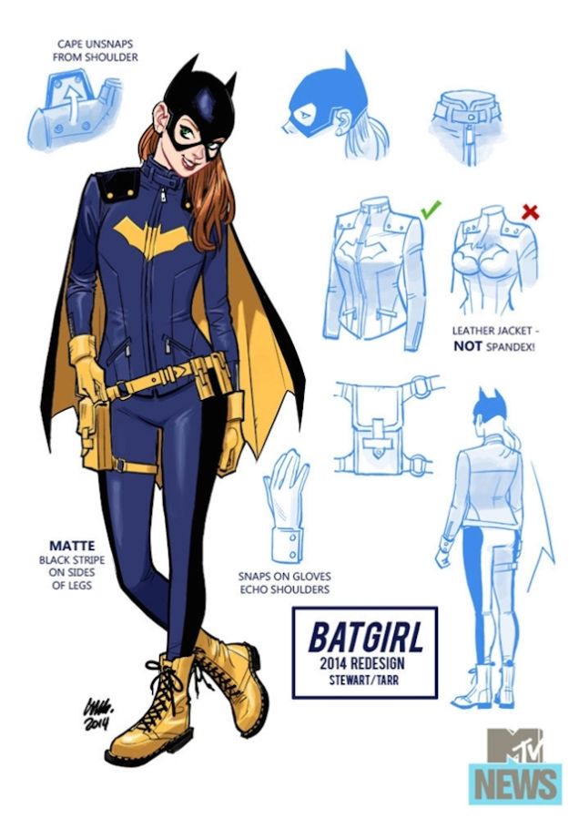

the way her new helmet looked and sat on her head read to me as a cross between a catwoman and captain america helmet, so as i formulated gameplan i had that in mind with the approach.

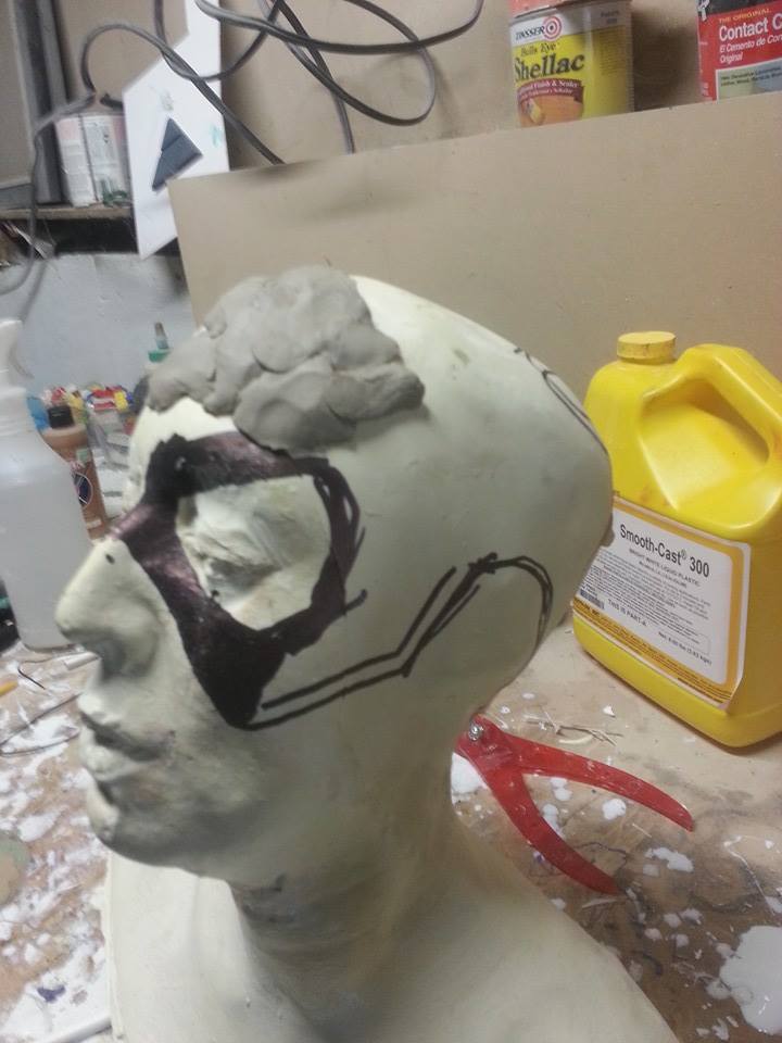

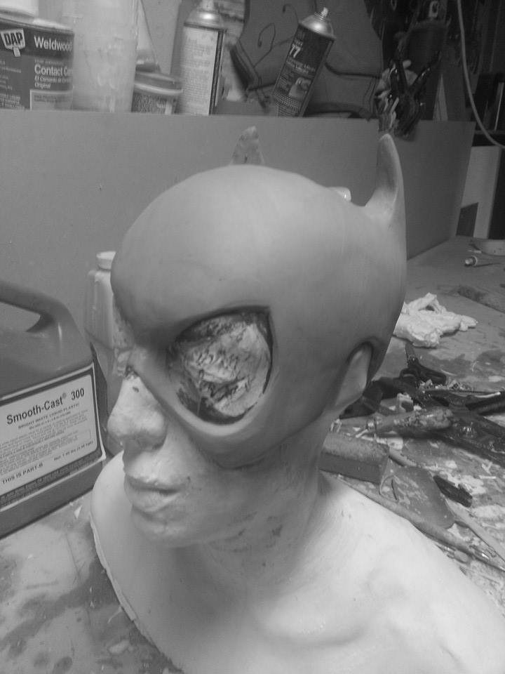

so first run out i started blocking the clay out
10530800_256385944556101_3334768496002242199_n.jpg10518696_256683371193025_692819082495690991_n.jpg

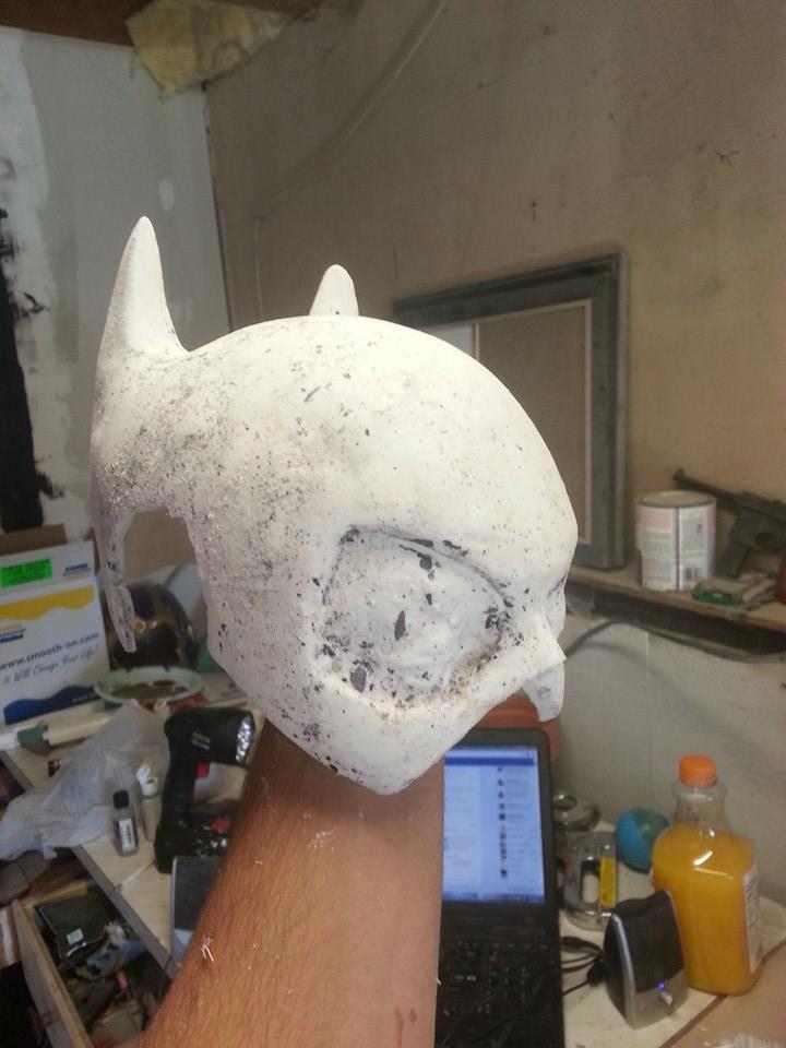

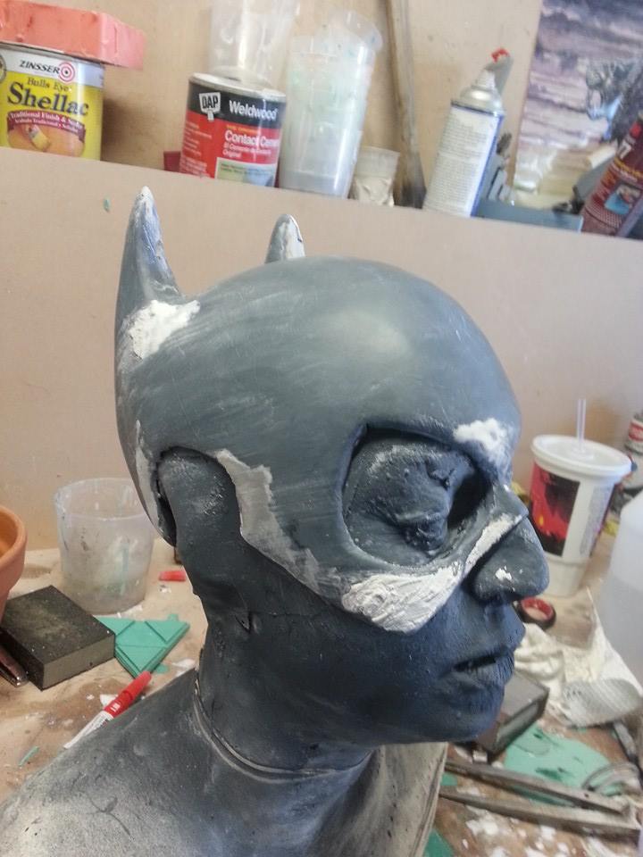

then primed it and started filling and sanding to smooth out more

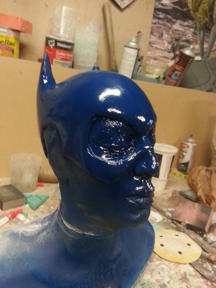

my usual step after this phase is to seal it up with a thick clear coat coat before starting the molding process, BUT i didnt have my usual stuff and thought "hey, i got gloss spray paint thats pretty much the same thing concept isnt it? ill just blast a few coats of that on there."
famous last words

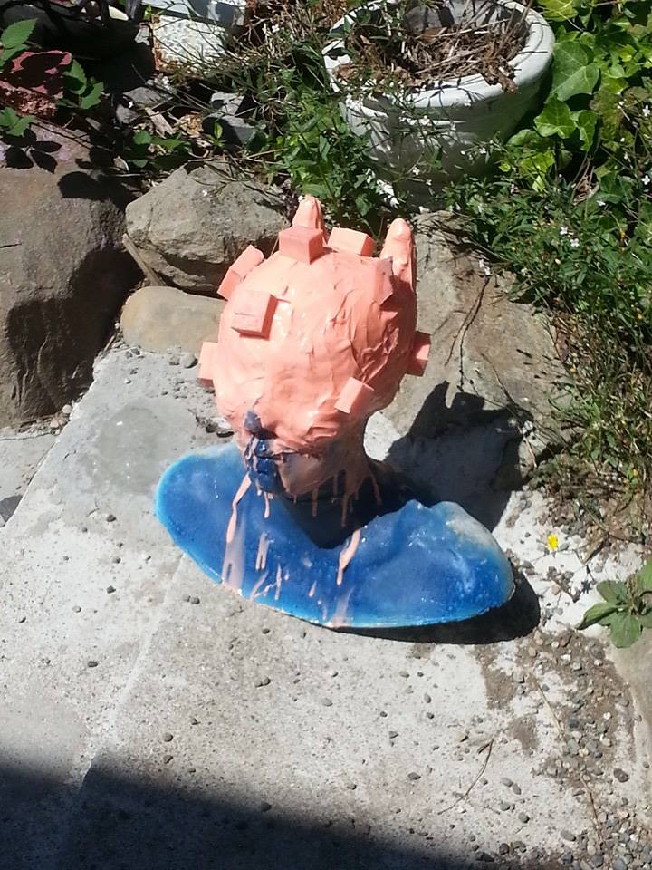

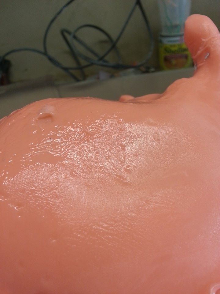

i had let it air out overnight and begin molding the next morning, i thought everything was well and good until i removed the mold and found an absolute gooey stew of despair....
the silicone had been messed with from the degassing of the coats of spray paint and damaged the sculpt a bit and a few places. but most damaging of all stabbed me right in my ego and confidence haha

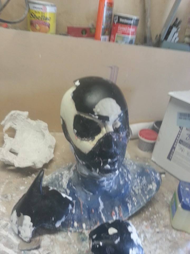

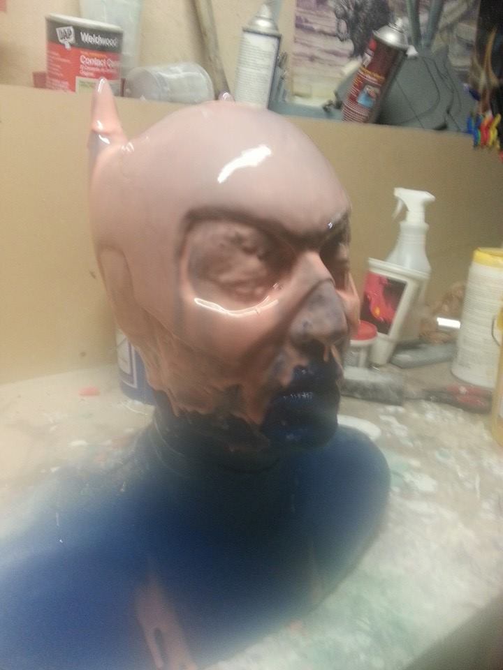

after a day of pouting i picked myself up and started to fix the damage and resculpt a few pieces and try molding again
BUT the second attempt at molding something strange happened that i still cant explain.
the either the sculpt or mold had shrank because what was designed to fit a head of 22 inches (the same as the armature i was using) now became more of a childs helmet at being able to only fit a head size of about 19 inches.
the weirdest part is that it shrank evenly all the way round and still proportional. so yes it was a loss because not what i wanted but not a complete loss because i can now produce child sized helmets.

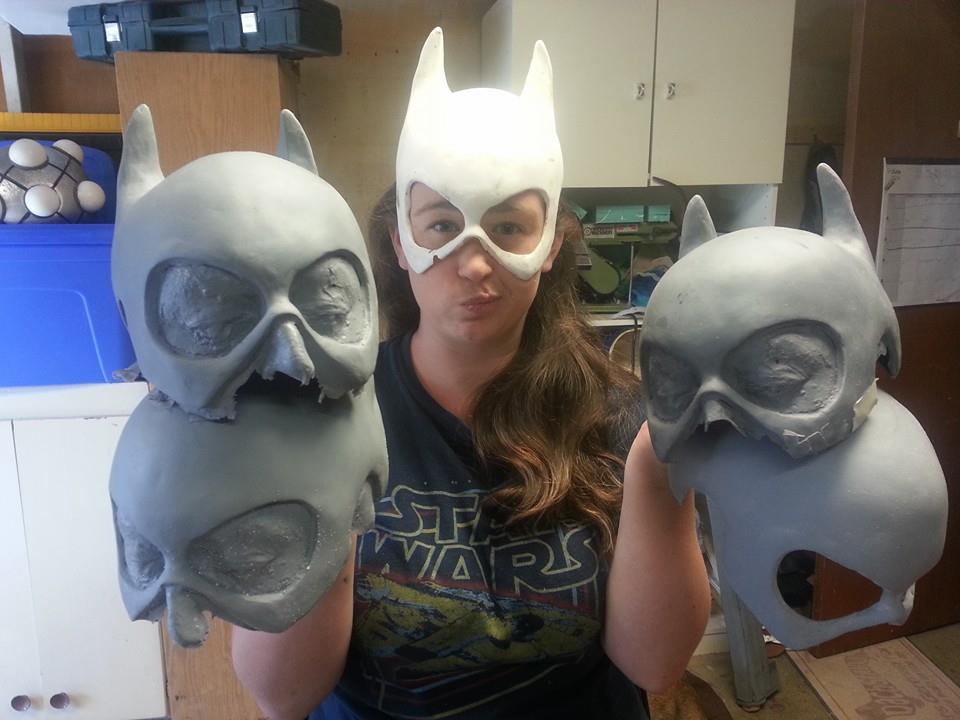

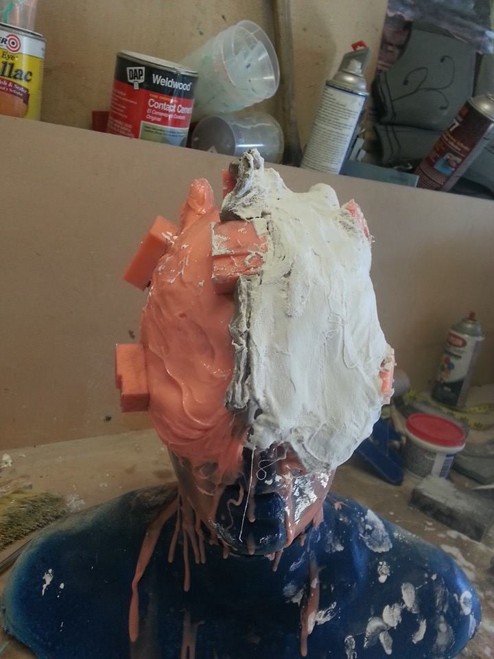

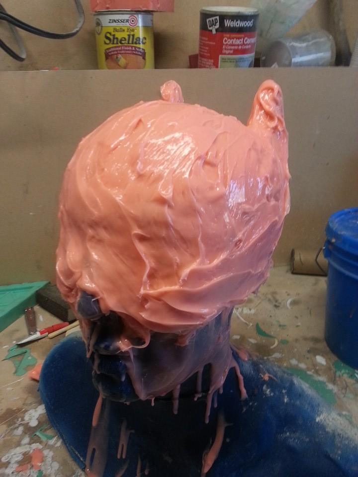

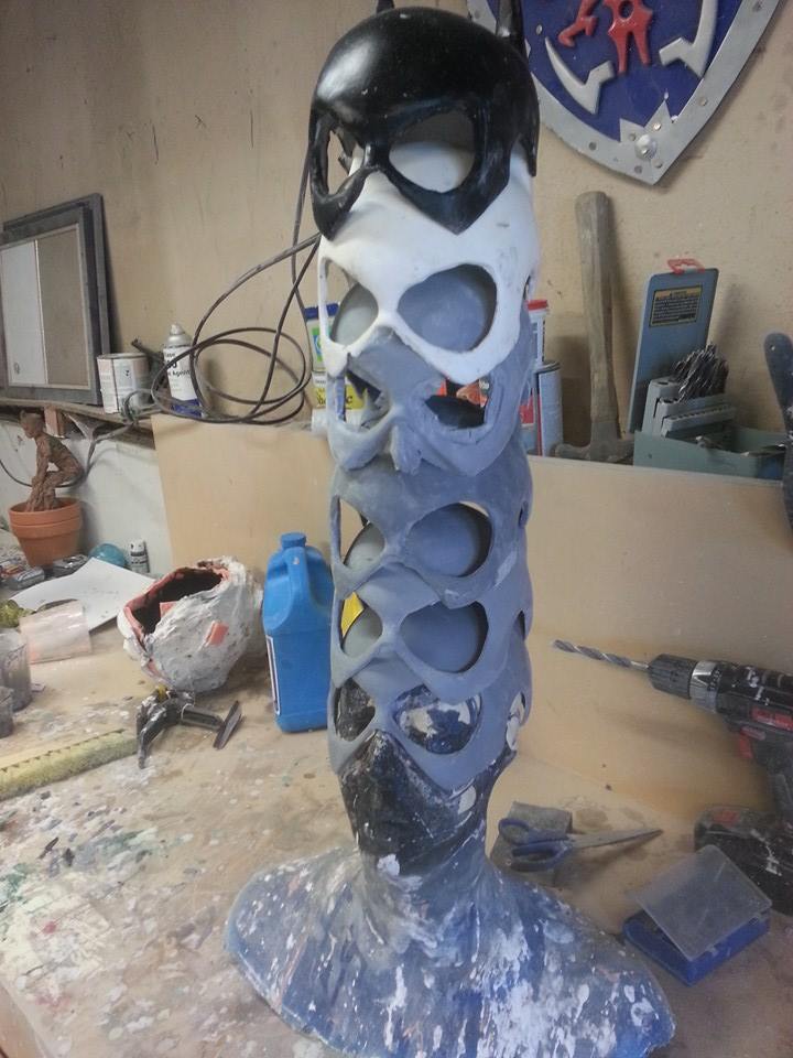

so this called for yet ANOTHER sculpt of the helmet along with a another mold.
10552490_258706954324000_57184358813519440_n.jpg10559813_258729044321791_4538270839628482269_n.jpg
it was a nice 95 degrees the day i decided to mold for the 3rd time so the sun helped the cure
third time was the charm and it came out wonderfully!

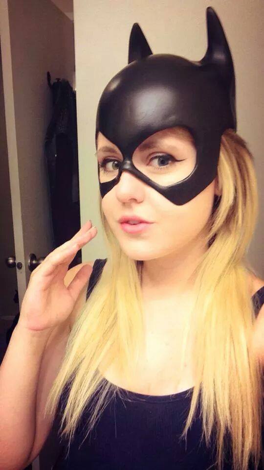

and heres a couple lovely ladies sporting there new helmets
10609416_272830766244952_4570708338209604212_n.jpg10718014_10202217084623374_1430851375_n.jpg

If your silicone rubber is Rebound from Smooth On - Great Silicone BTW, but it's a platinum silicone which reacted with your high gloss spray paint. Only use clear coat, never anything with color in it as your sealant...otherwise the silicone wont set up against it. Not sure it had anything to do with the spray degassing...that's silicone inhibition.
