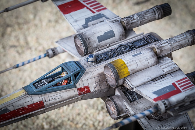

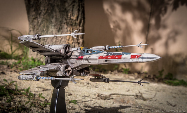

How about keeping the kit's color, keep it unpainted? My experience with the Bandai kits is that the color is spot on. My X-wing was kept with its original color.
IMG_5123 by Oscar Baez Soria, on Flickr
IMG_5154 by Oscar Baez Soria, on Flickr
Re: Bandai Y-Wing - Base color question
nice job on your X Wing. That's the 1/48 I believe? The poured colors and finish on the 1/72 Y look off to me so I'm going to paint all colors.
