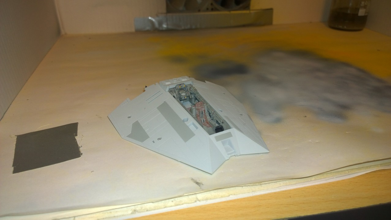

I did the main body top and bottom plus the canopy with a mix of Tamyia XF-66 light grey and XF-2 flat white, about 4 parts white to 1 part grey. I pretty much went by eye to get a colour I was happy with. It initially had a blueish hue to the finish but I figured that would change with work later on.

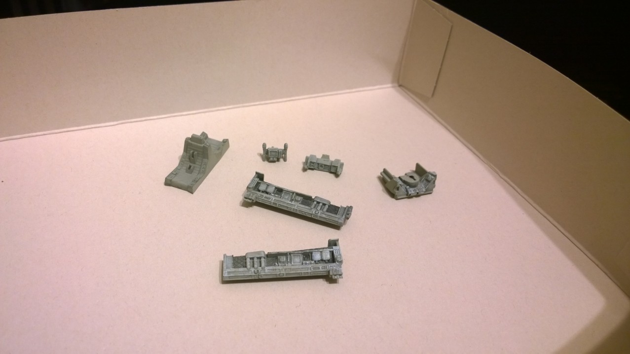

I couldn't find a lot of reference on the interior of the cockpit so I kind of made it up. I did a base coat of XF-55 Deck Tan with a wash of the mix I used for the Snowspeeder body. Some of the cross pattern on the wall of the cockpit got a light wash with a dark grey XF-24, then a little bit of drybrushing to bring out some highlights.
I dotted some of the raised areas with various colours to add soem extra detail.
Then did some assembly of the cockpit and body.
Then added the seats. More of the same, base coat with Deck Tan and wash of light grey. I did the seats with a Model Master burnt sienna that I had and dry brushed over the top of that with light grey. It seemed to come out ok.

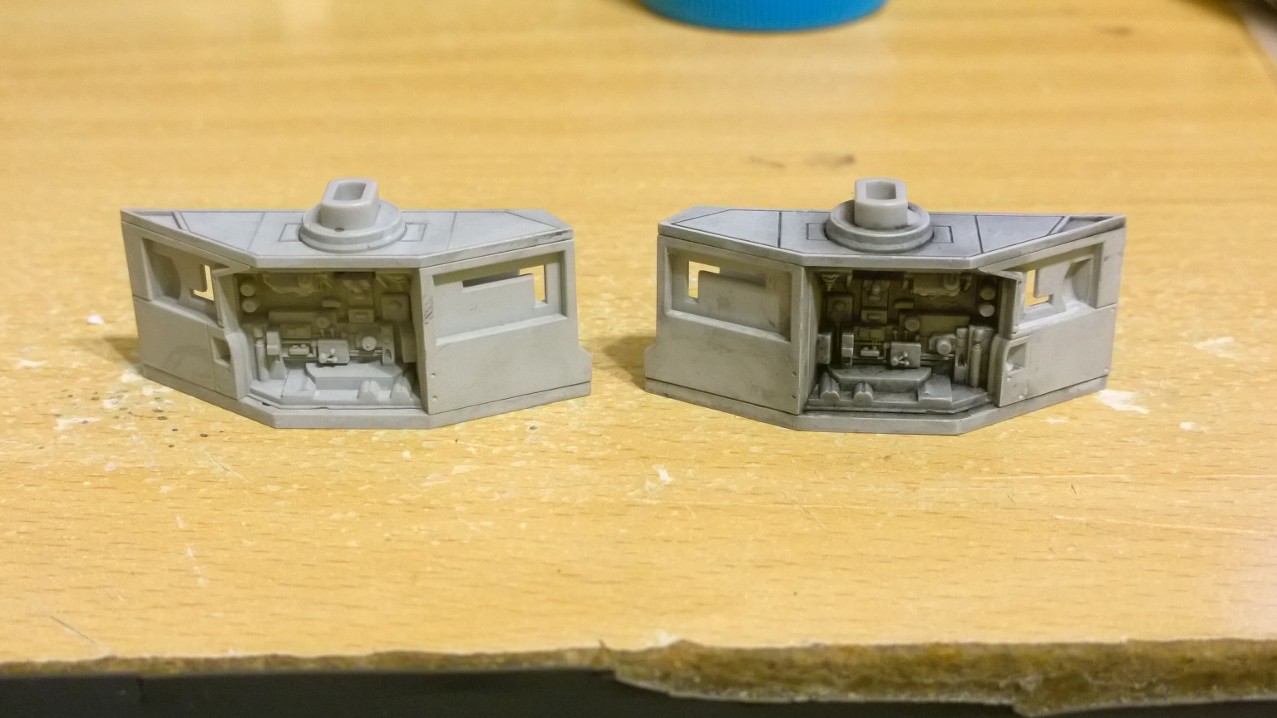

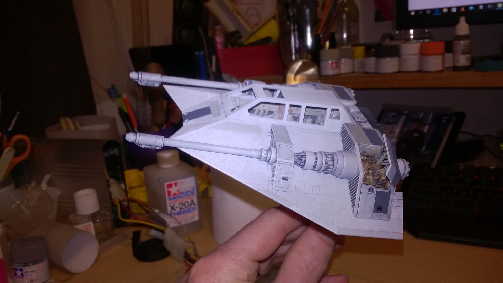

After the cockpit was put into the body I decided to have crack at doing a wash. Initially I tried a wash with some thinners and some dark grey acrylic. The results were not as good as I was hoping. While it was not bad it did not contrast enough, much to light. I tried on a couple of parts that I figured were small enough that I could fix later if I stuffed it up.
So I tried something that I had seen Adam Savage do on one of his Tested.com videos which was to do the wash with oil paints. I have some Georgian branded oils in Paynes Grey and Burnt Umber, I added a little thinner and went nuts. I covered the entire piece with the very dark wash and let it sit for ten minutes to soak in, then I wiped it away with kitchen towels.
Much better look, it really gave a grimy appearance and really got stuck in the small gaps. It did mean a much longer drying time though. It did change the overall base colour a little though.
The darker is the oil paint to show the difference in paints.

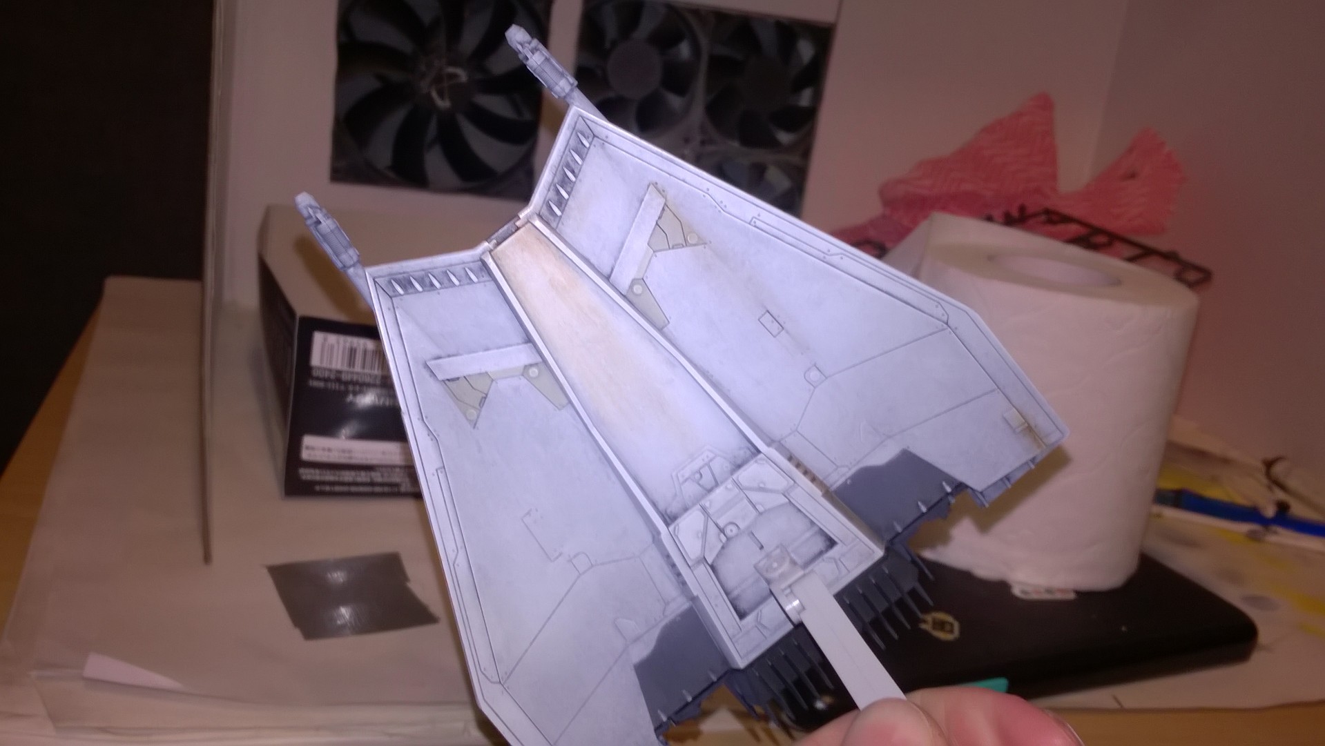

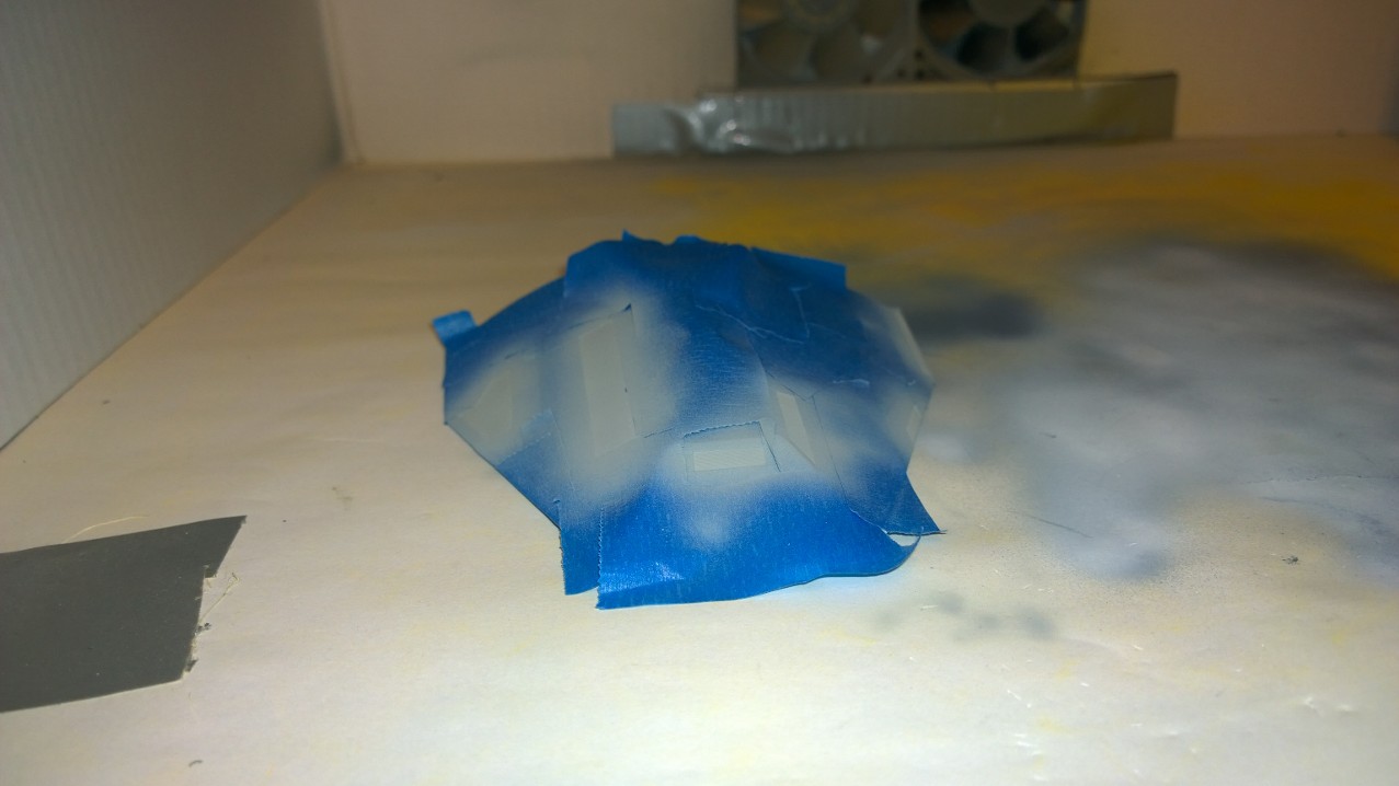

So next was to paint some of the panels. I could have used the stickers provided but opted to paint. After a load of masking it was ready.
Pretty happy with the results on the top.
On the bottom I deviated from the pictures I had seen. I only did the single dark panels at the rear rather than double panels either side. I also used a different colour for the area near the vents at the front. Went with Deck Tan there as I had it spare in the airbrush. Again it came out ok.
This bit was probably the most fun of the model so far. On the read engine pods I masked of the panels and sprayed them the dark grey, Then after that had dried I applied the oil paint wash. So happy with the result. The look of oily grimy spaceship was great. I was so worried about ruining the paint job but just told myself that it was nothing that couldn't be repainted.
For the interior of the engine bay I used some burnt umber and very loosely painted the interior and used a cotton bud to get rid of the excess.

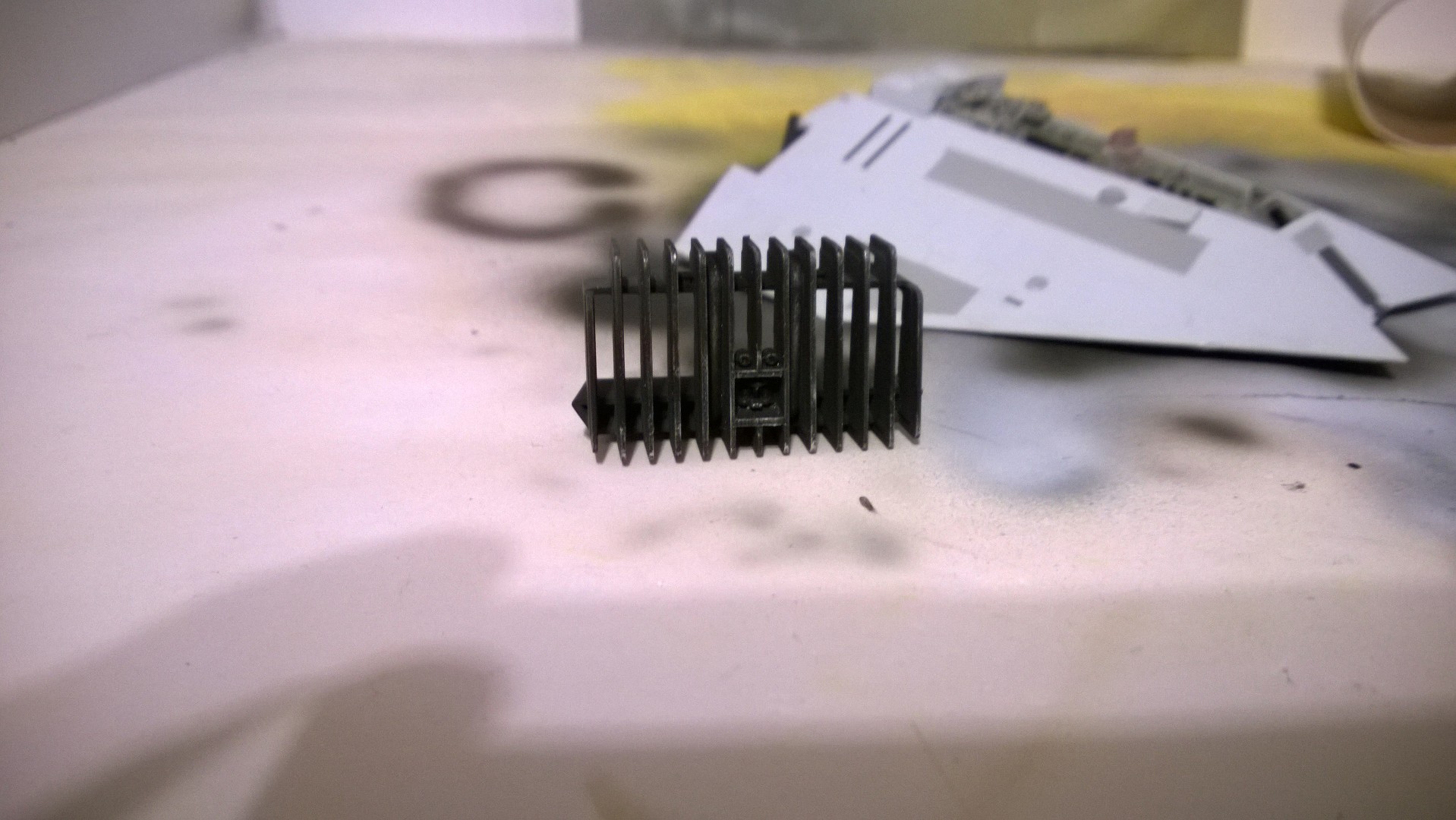

The rear grill was surprisingly fun too. Initial coat was Dark grey. I did do three black areas inside the fins but the pics don't really show it. The black was basically where the engines are when attached to the model. Then a bit of dry brushing in the vents and along the edges with flat aluminum to bring out the highlights and edges.

Right, it's all starting to take shape now. I opted to have one of the wing flaps up because the detail inside was interesting and I had already thrown some of the burnt umber into the cavity.
The wash on the laser gun housing came out really well, I actually went back an just dabbed a little more around there to darken it up. Some of the detail around where the rear gun is attached came out well too, looks like oil build up rather than paint.

I added the cannons
And then did some rust running from some of the small vents. I haven't done a lot of streaking. I have kind of decided that even though the rebels were a small outfit they would have at least tried to look after their gear a little, therefore they wouldn't have been as dirty as some models I have seen. Anyway, I am reasonable happy with this small amount of rust.
