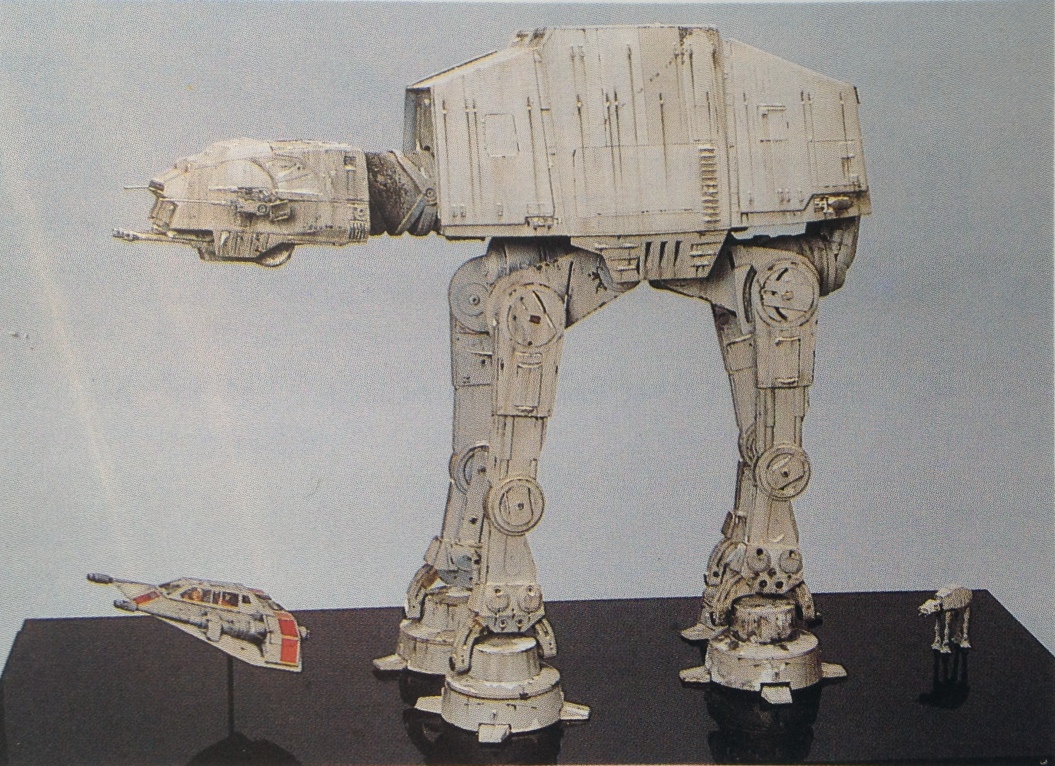

I'd like to throw a question out and see if it can get passed along as to which original grey was used, or perhaps the most proper substitute used today?
Thank you very much for viewing.
I shall begin the sub assemblies!
Analyzer
Archive X paints ( I am not sure which, but you can ask in the FacebookGroup if no one chimes in here)
If using Tamiya paints, Tamiya XF-19 (Sky Grey) mixed with XF-2 (Flat white) is supposed to be a great match for the studio model and I think was used as the paint master for the MR Snowspeeder. I forget, but I might have also added just a very small bit of XF 55 Deck Tan at the last minute, but the mix was most XF-19 with flat white
when painting the odd "whiter" panels like along the side of the cockpit, it is a mix of Deck Tan and Flat white
I forget what I used for the darker grey markings on Luke's Version. It might have been a base of Tamiya XF-77
I used that and mixed to match the Bandai sprue color
Not sure about Vallejo or Model Master etc...
Sindariel
The most accurate paint for the Snowspeeder is supposed to be Archive-X "SP Lettering Grey", which funnily is the same color that was used for the AT-AT and (ESB) AT-ST.
Apart from that, most people use a mix of Flat White and XF19 Sky Grey, Flat White and Medium Grey (XF20), or Flat White and Light Gull Grey.
I've used the same paint mix as Andy Moore at Britmodeller on mine:
But i've ruined it with weathering and wont post any pictures. :p
Analyzer
it sure seems that way...
While it may be accurate for painting the filming models, I personally prefer the AT-AT to be a little greyer and the Snowspeeders to be a little whiter so I still used a mix of XF-19 and white, but for my AT-ATs, but I used almost straight XF-19 with very little white, while for the Snowspeeder I added more white..akin to how the ANH Tie color was much darker blue/grey on the studio model compared to the lighter more neutral grey on screen
I believe the correct mix would be mostly XF-19 with a bit of white added
