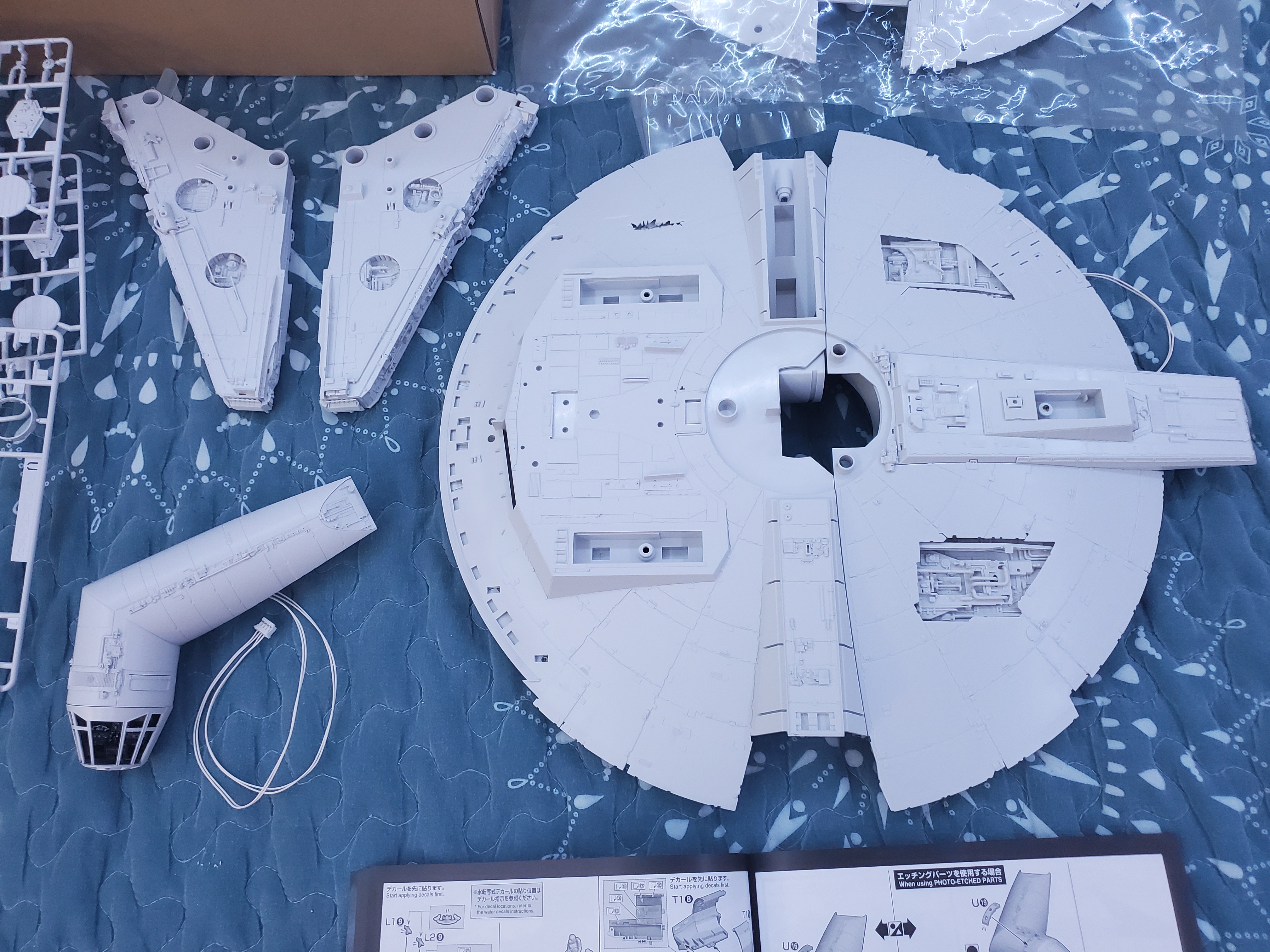

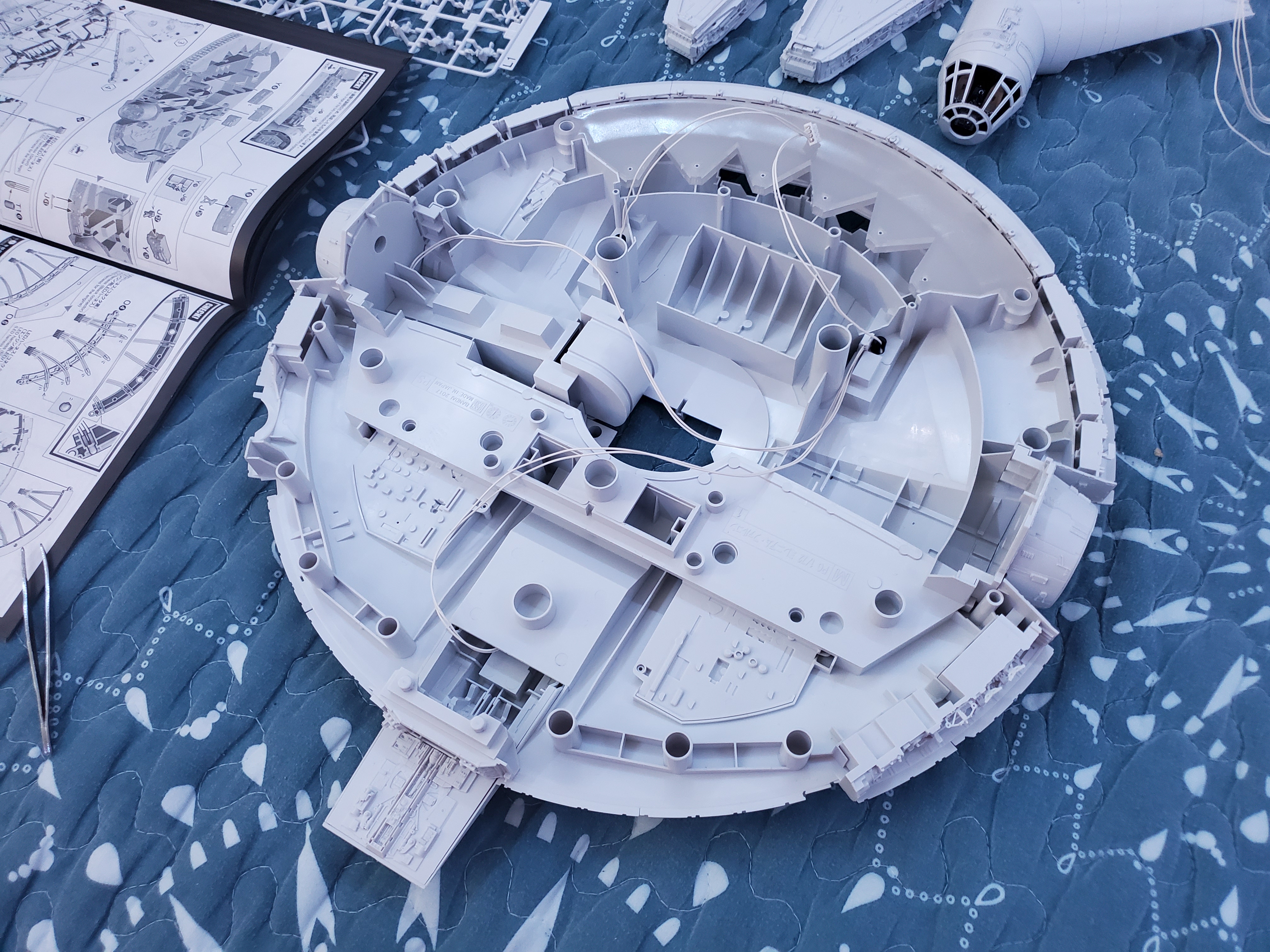

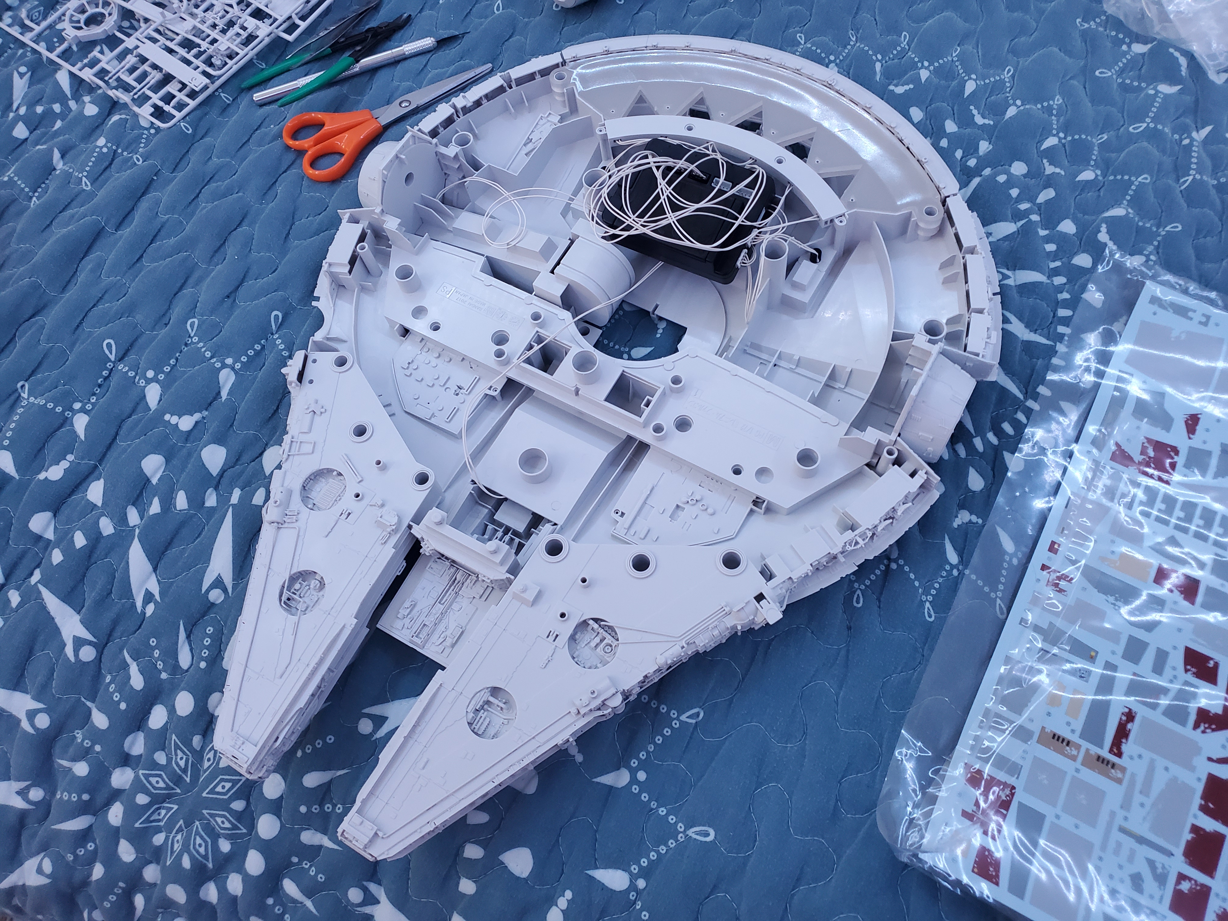

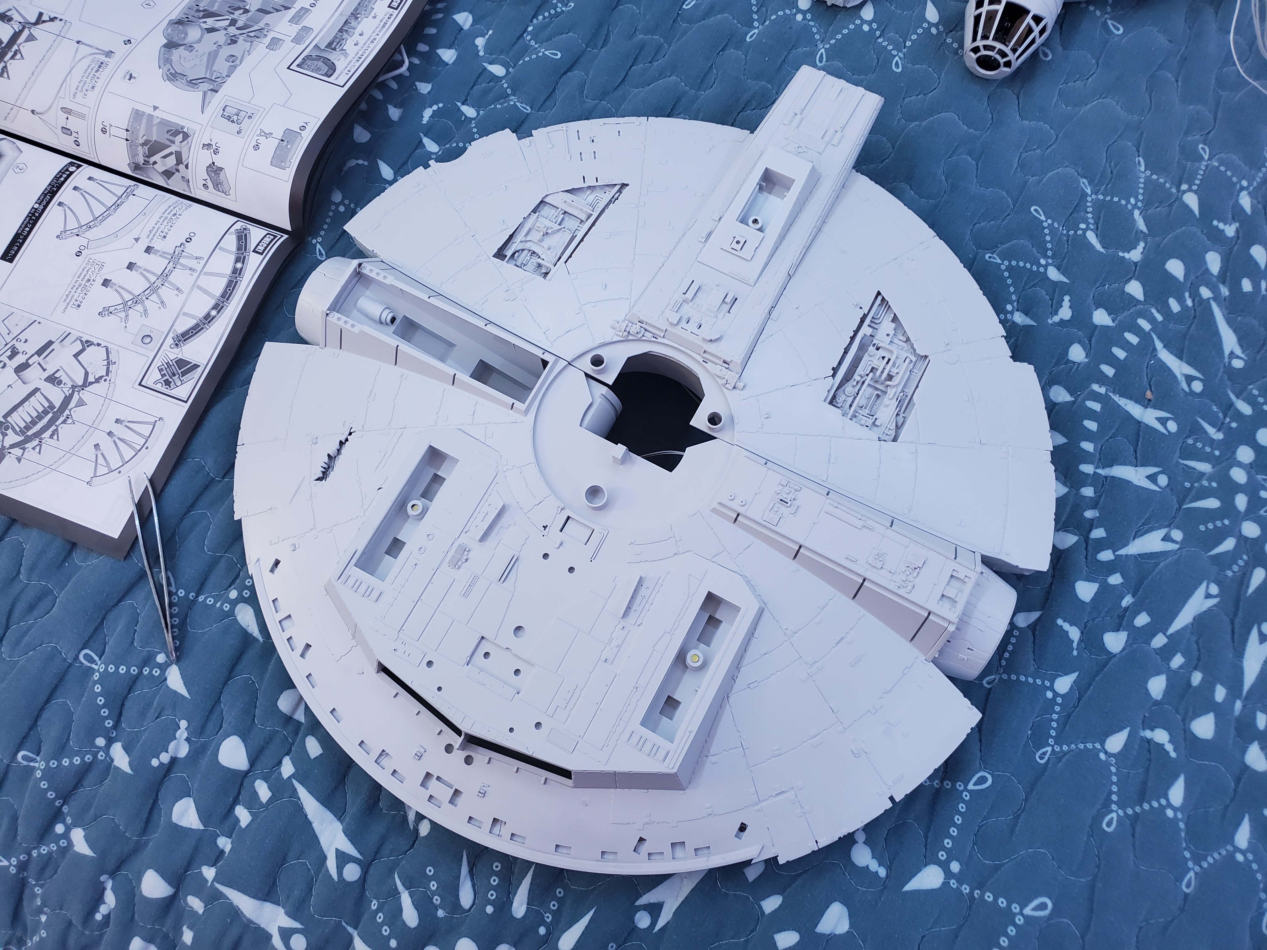

Hey guys! I haven't posted anything in a LONG time. I've just been busy with work and school, and I haven't really built any models other than a 1/350 Titanic model. Just recently though, I was able to purchase Bandai's 1:72 Perfect Grade Falcon from Amazon for the cheapest price I found. This will be my latest project and I will post updates and photos over the next few months or so as I make progress. Hope you guys enjoy the ride!

I am interested to see how this turns out, I like the detail already! I have a Falcon on the shelf waiting to be built... You might just inspire me!

The bare plastic color is actually kind of nice, although it tends to look like plastic
If not painting it, I might suggest dull coating it after you do the decals. That will cut back the "plastic sheen" and also give you a decent surface to do some pastel weathering on (for streaks and such)
Just beware, keep enamel or mineral spirit based line panel washes away from any connections or they may dissolve or crack since they are unprotected
Stick to water based washes if you will be doing any

Looks nice, but you're not planning on painting it?
I'm not painting a base coat on it. I don't know how to get the correct color mix for the base color. This is what I did for my 1:144 Falcon. I skipped the base coat and did the decals and weathering, and then put several coats of clearcoat over the model. After a while, the model slowly turned a little off-white or yellowish, which captures the hull color nicely.
