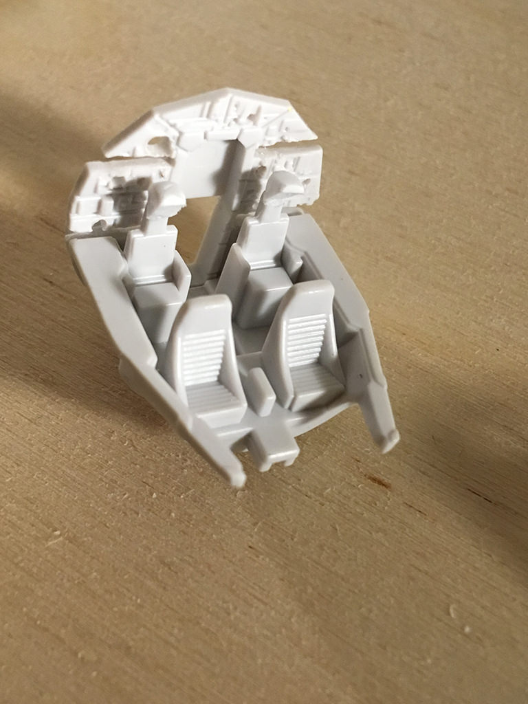

I started with the cockpit. I cut and drilled out the back wall for lighting, added the head rests to the passenger seats and rounded the tops of the pilot and co-pilot seats. I thinned out all the crossbars in the canopy to make them appear more in scale. I made a door from styrene strip. I just drew the details on loosely with a gundam pen to give the impression depth. I wasn't too precise with the painting as I knew that once it's all closed up with the canopy in place you're not going to see a whole bunch inside anyway. I also didn't want the cockpit lights blazing away at blinding intensity and tried to keep them toned down.

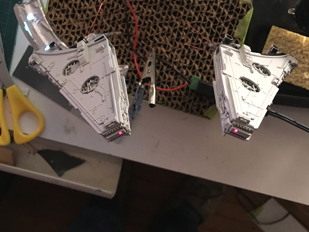

On to the mandibles. I wanted the red headlights so I added a pair of red 3mm led's to the front of each one. I drilled out the holes in the end caps for headlights themselves. Doing it this way certainly provided some light blocking challenges but I was up for it. I'm really happy with the results.

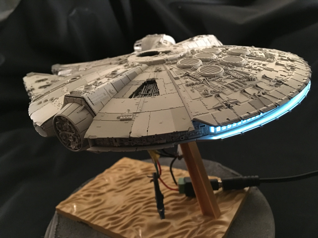

Next up, lighting! I made a light box and use some warm white strip LED's for the engines. I'm going to run the whole thing off a 9V adapter so my friend doesn't have to worry about constantly changing batteries.
Here I started working on the grey paneling. For the medium grey I used Tamiya grey primer. For the rest of the grey accents I used custom mixes of warm and cool variants of the Vallejo Mode-Air light gull grey. I then did a quick test fit to see how everything is looking. I took everything apart again and went in and knocked back some of the panels with AS-20 while leaving others at full opacity.

Looking great so far. (y)
Color matches are pretty good and the greeblies underneath the damaged parts are well done, but why no PE exhaust grill?
