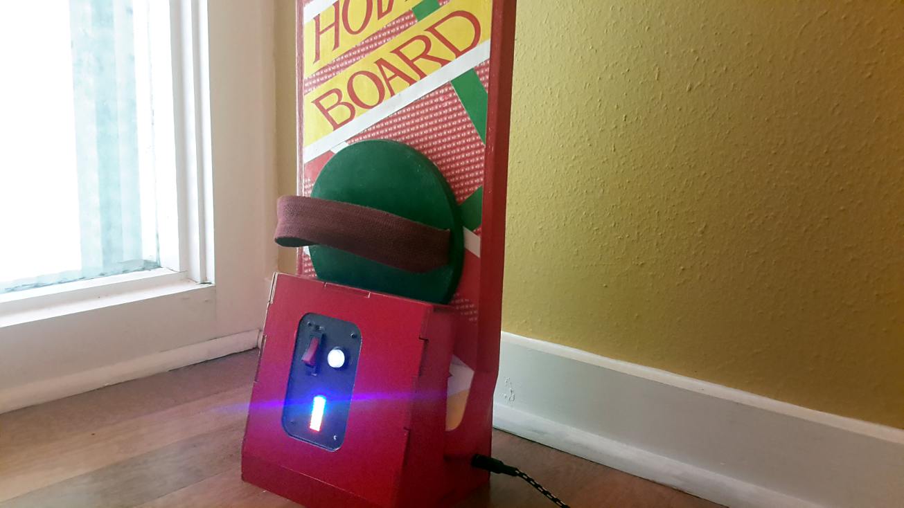

Since I needed a stand to hold the hoverboard, I decided to build one that acts as a hoverboard charger. Again, I cut the pieces from 3/16" plywood using a laser cutter.
The electronics is based on an Arduino Pro MIni (168, 5V, 16MHz), with a microswitch (which detects when the board is inserted) and a 10-bar LED battery level display.
20190606_184129.jpg 20190606_184209.jpg 20190613_183814.jpg 20190613_183849.jpg
The charger can be screwed to a wall, or simply stand on the floor.
When the board is inserted, the 10-bar LED battery level display cycles randomly through four different patterns.

My question is.... what exactly is charging inside? What does it do?
So, you really want to know what is charging?
- official answer: The Hoverboard batteries, of course - what else?
- honest answer: Nothing :lol: it just pretends to. It's a stand, with a few blinking LEDs.
