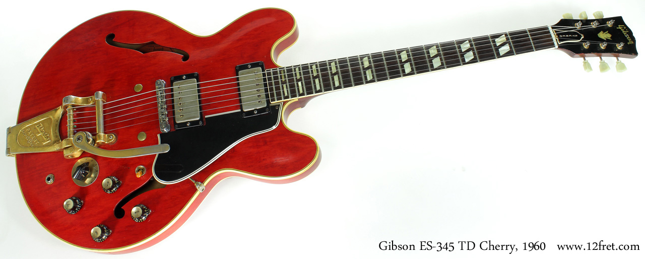

Tune-O-Matic is the name of the bridge, not the tailpiece. I'm not sure what you mean when you say they "used both". The ES 345 was available without a factory Bigsby and had a standard Gibson stoptail, leaving the studs exposed when fitted for for the tremolo.
You can cleary see the slotted heads in the photos you posted. This is an example of an original gold stoptail along with an original ES 345.

^^This is correct. Those are definitely stop tail studs. Tune-O-Matic isn't a brand, it's a type of bridge (originally) manufactured by Gibson. Since the Bigsby was aftermarket, they removed the tailpiece but left the studs.
