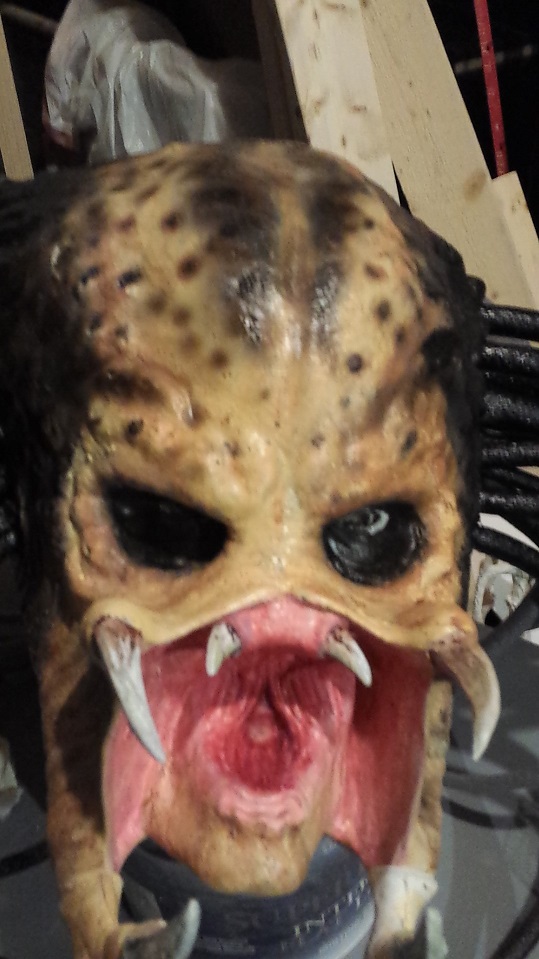

Airbrushing seems scarey but it's actually really easy. I'd never used an airbrush before and was amazed how easy it was . I personally like to prime the latex before painting using white spray primer that you'd find at the hardware store. Here's a picture of my WIP very first airbrush attempt on a ruffkins toys P1 mask.
There are no rules to making a costume, you can build it however you like. The more creative the better. Check out the Important Costume & Prop Links as the information is very, very helpful it will save you time and headache.

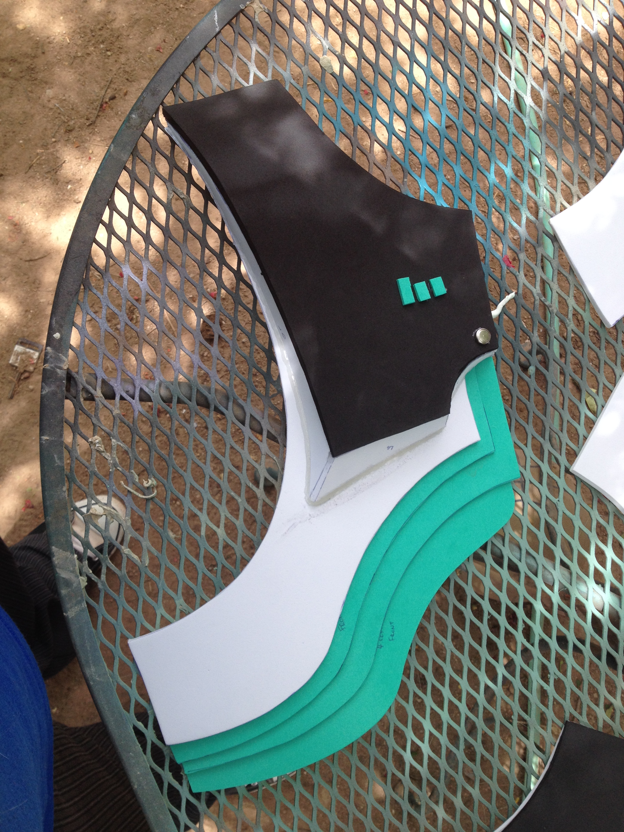

I did however make a little progress on the armour last night and made my shoulder pads, using templates found on here Im rather pleased with how they are starting to look.

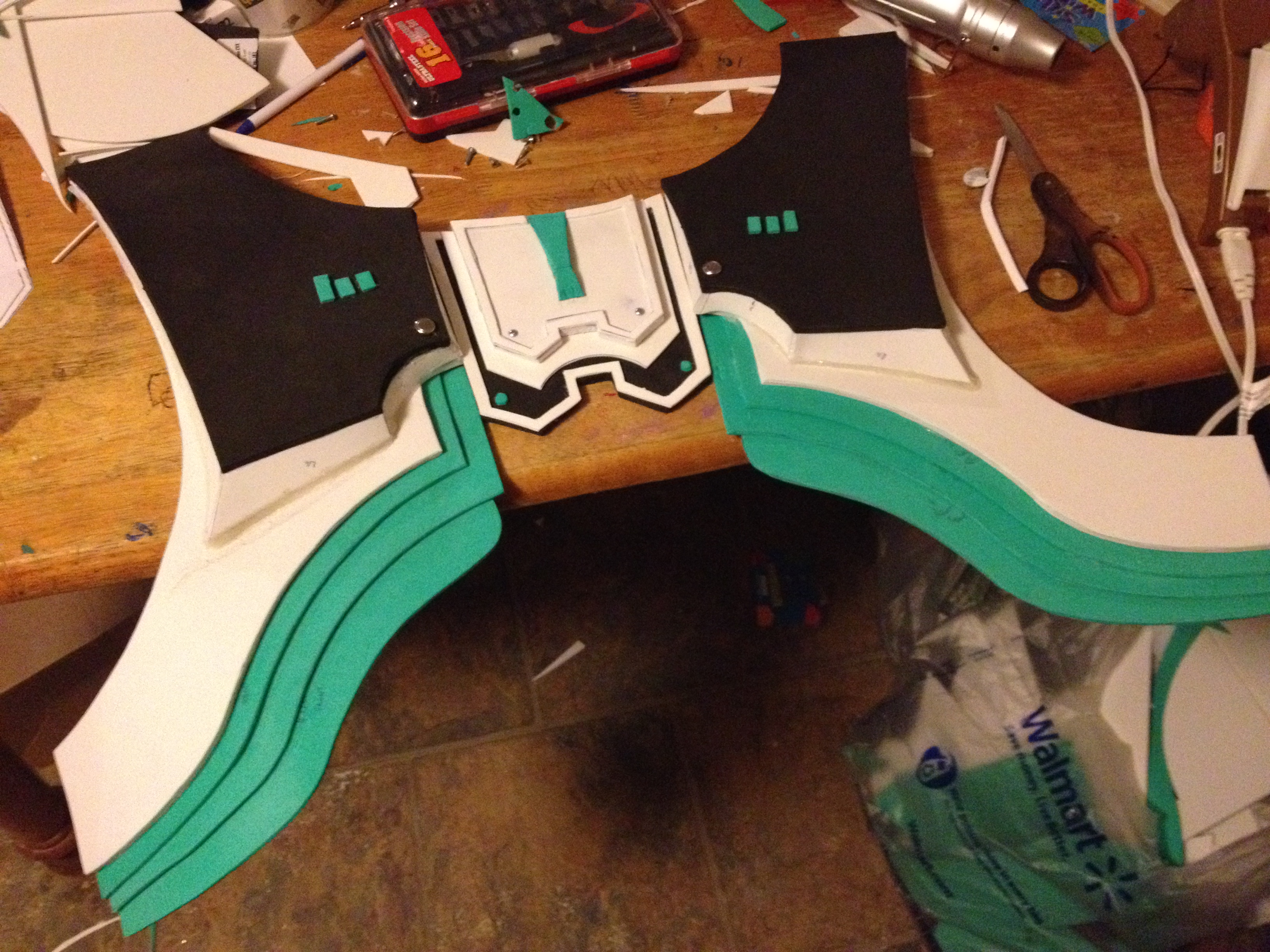

Firstly a HUGE thanks for Vinman and his Templates.  These are by far the easiest to use that Ive found anywhere.  Yes I had to scale much of it up a little (110%-120%) as Im not small but it seems to be working out for me this way.
With a combination of 3mm to 6mm Foam sheets Im starting to get some headway with this project.
So heres my current collection of parts:

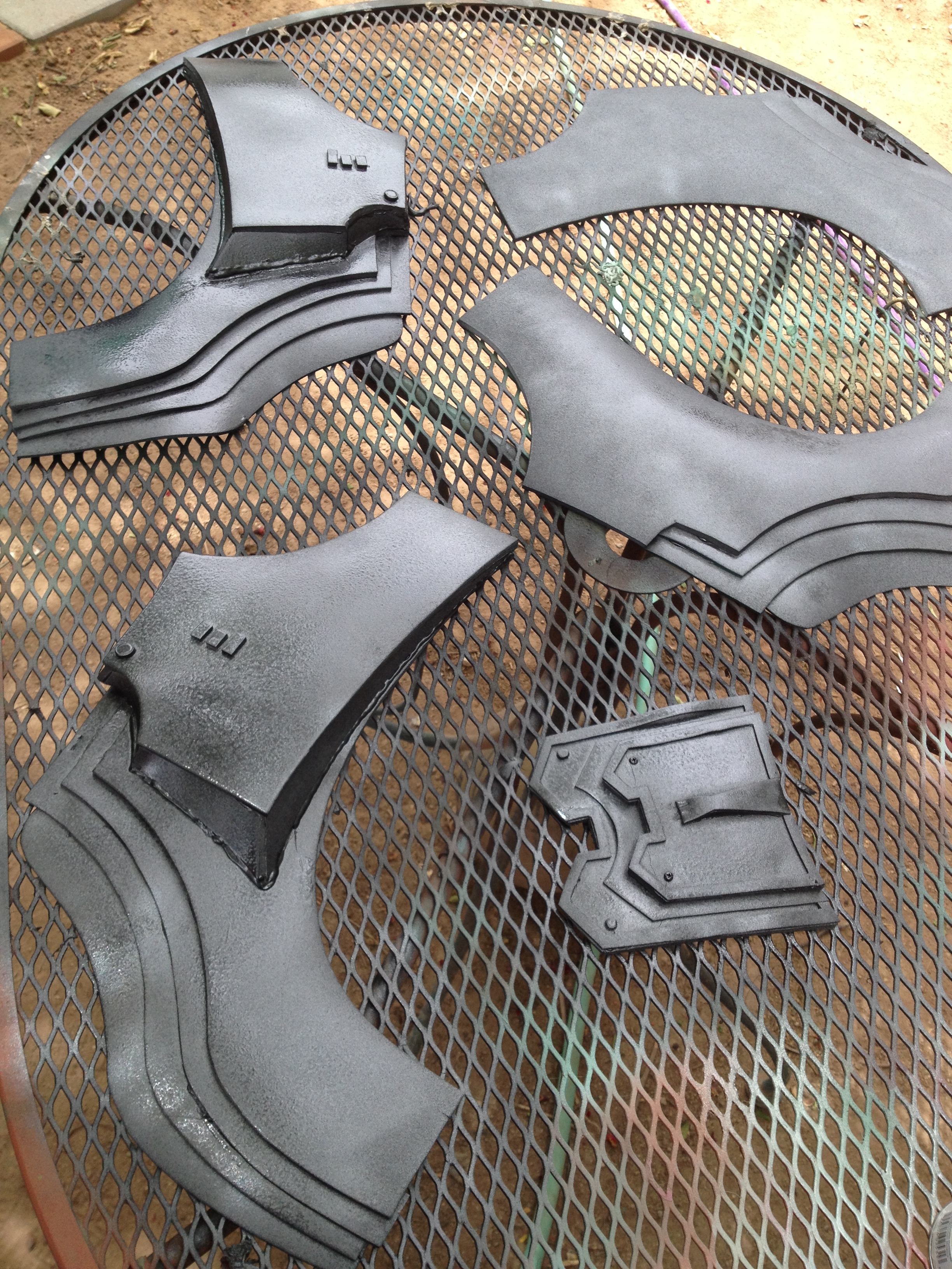

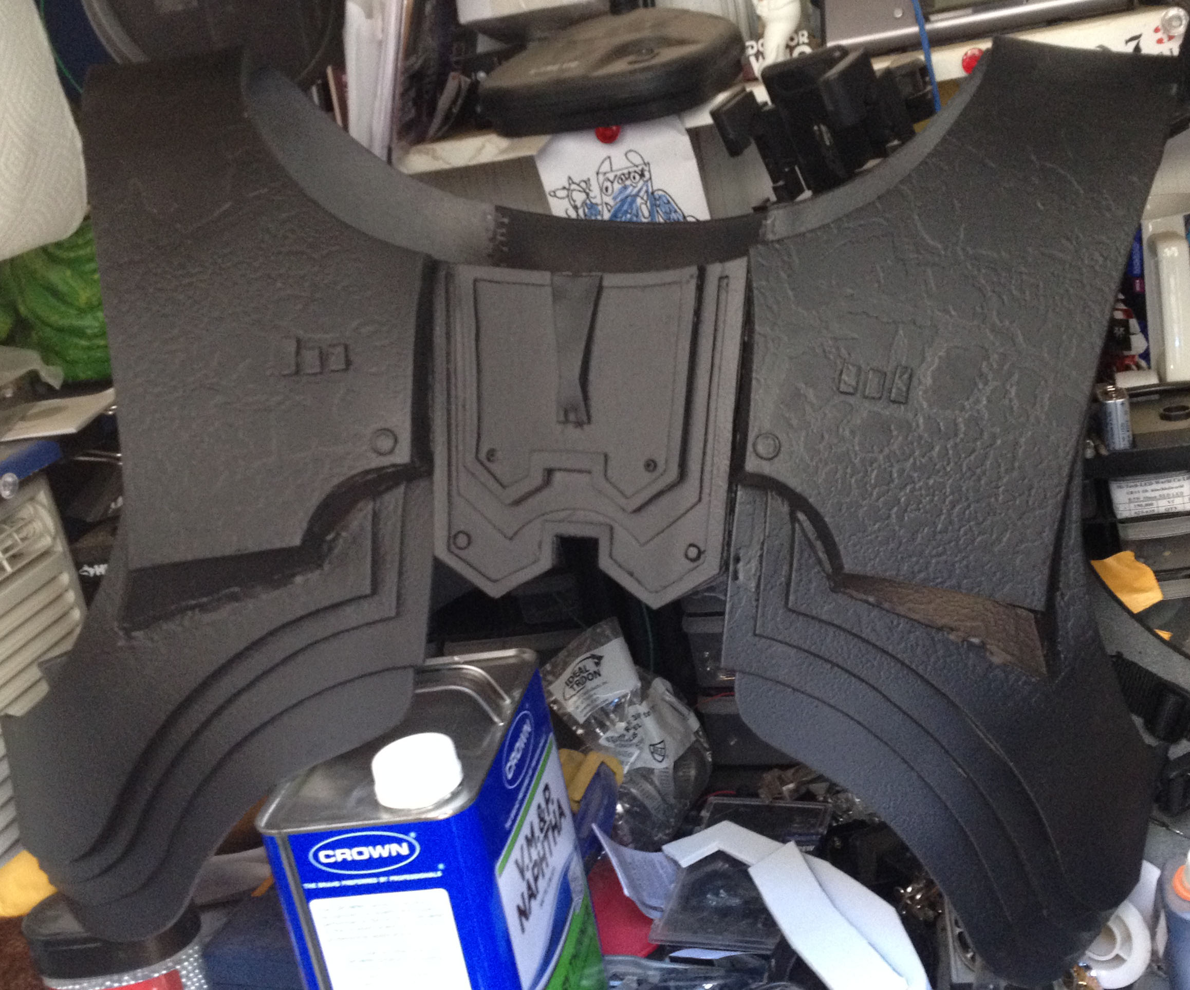

So last night I assembled the chest armour. I gave it a coat of plasti-dip and planned to give it another coat this morning, however I decided to try out the new Rustoline version thinking or hoping it would essentially be the same thing.
It wasnt. yes it did give a coat of rubber but what it did to the coats underneath was unexpected.
the effect was actually pretty cool, and might add to the overall finish once I give it the coat of hammered brown.
for now heres where I'm at for now
