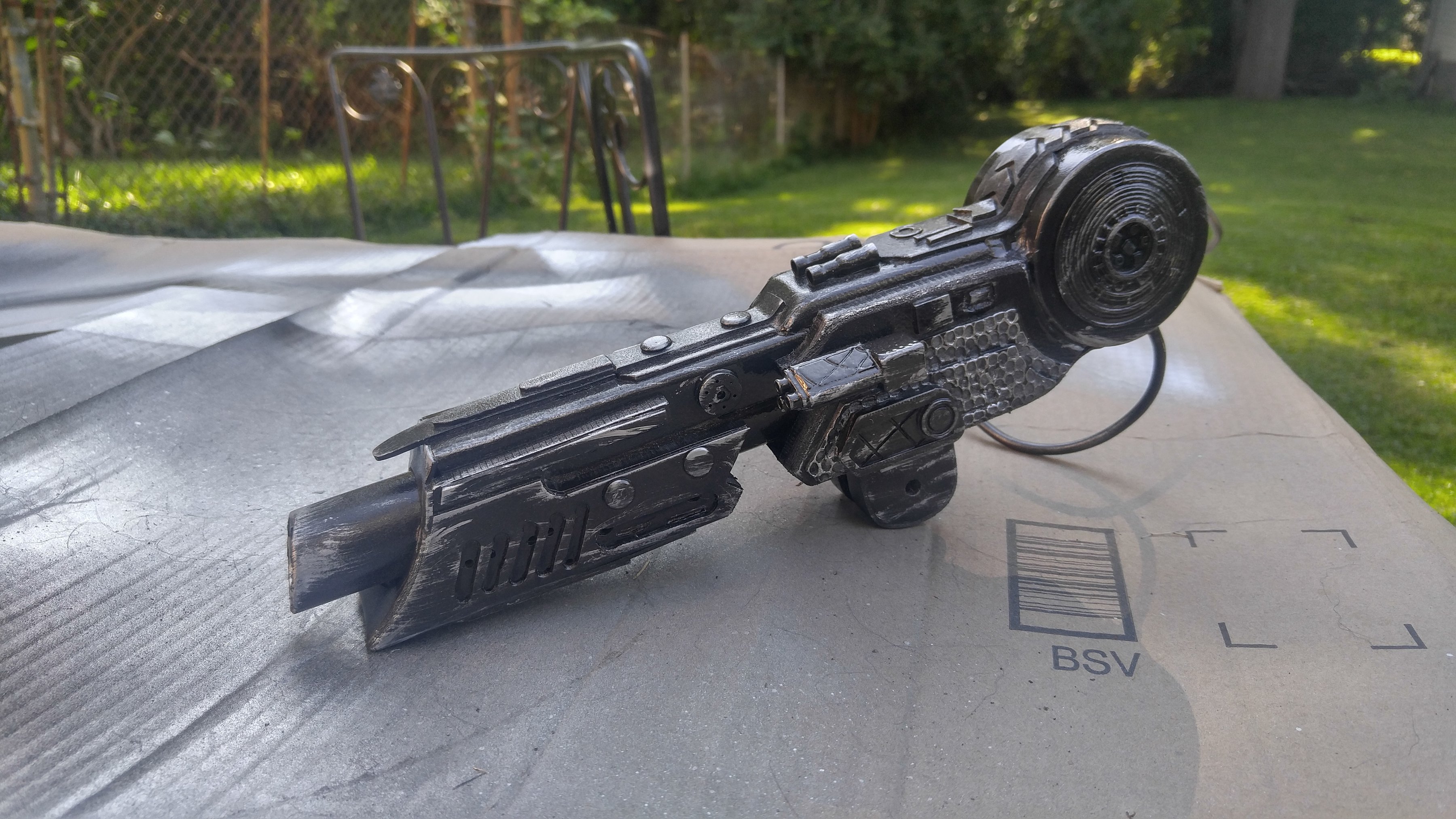

Though I would post my build for the AVP Scar Plasma Caster, it's not 100% screen accurate but I think its pretty close. I searched the web for reference images and a lot of what I found seemed to have conflicting info. Hopefully it helps some of you out if your looking to build one or one that's similar in design. Its not a step by step tutorial but should give some helpful info.
Started with a basic layout, 1/4" Sintra will add strength, 3/4' PVC pipe for the barrel. The small cylinder at the back is a hair gel container.

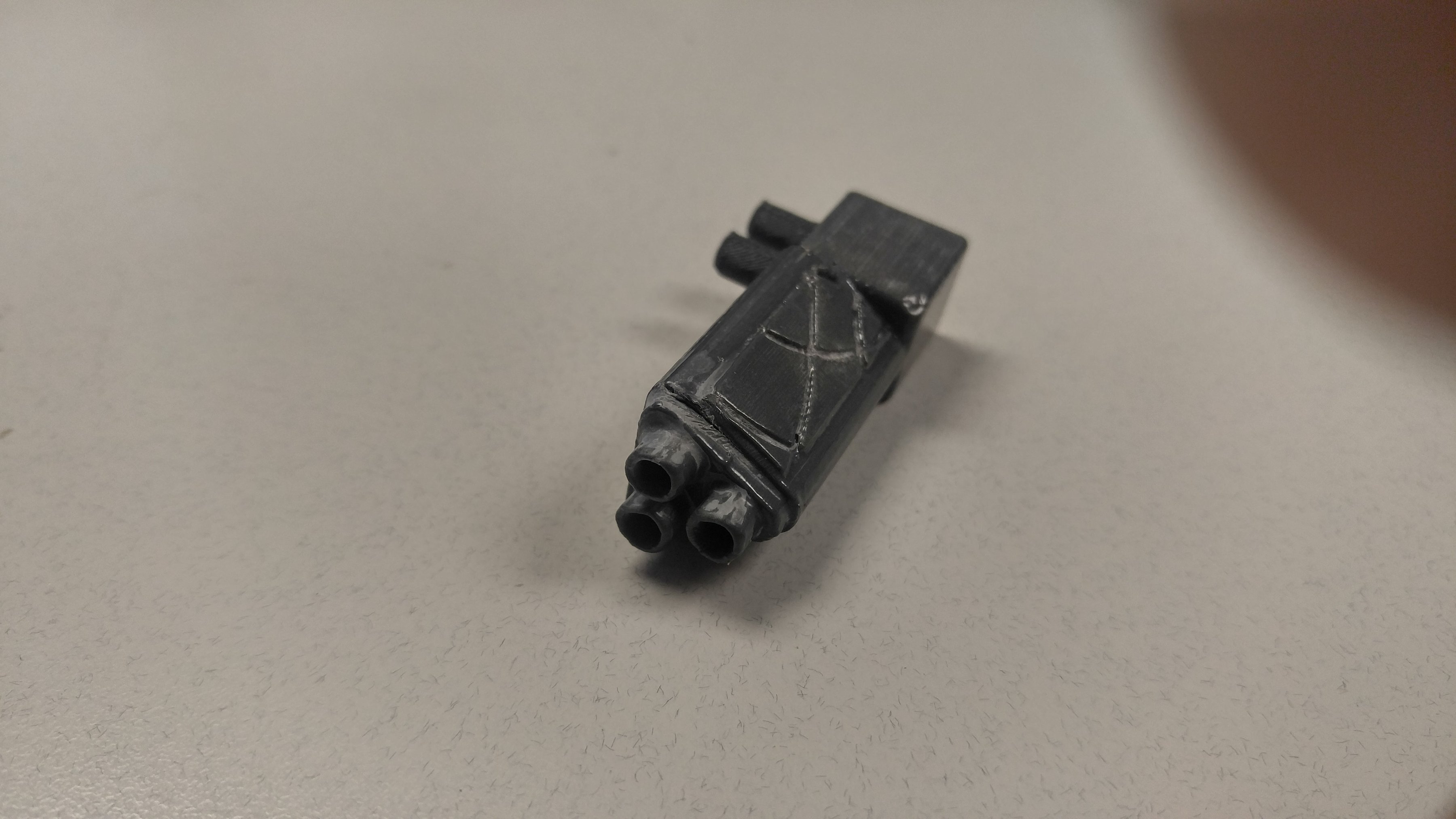

3D printed piece for some added detail.

Here's the look before paint and weathering, the wire out the back isn't in the movies or design but I think it will look cool this way.
Base coat of silver outdoor paint. Some people like to coat their parts with PlastiDip first. Might be a good idea, I just choose to skip it.
Here's the second coat and a bit of weathering on the back end. this paint is a hammered finish outdoor paint. Below are some finished pictures, unless I decide to add more weathering.
