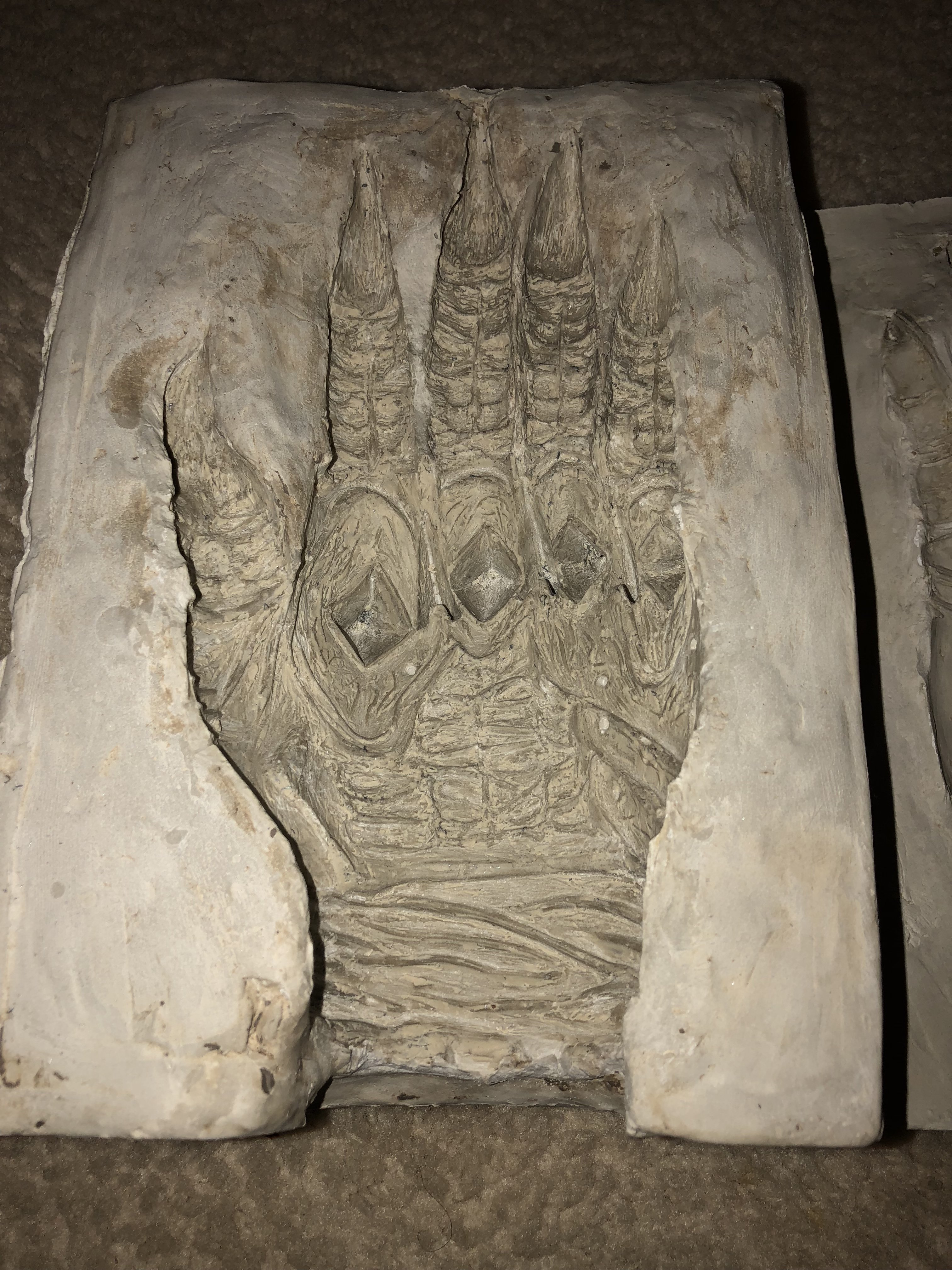

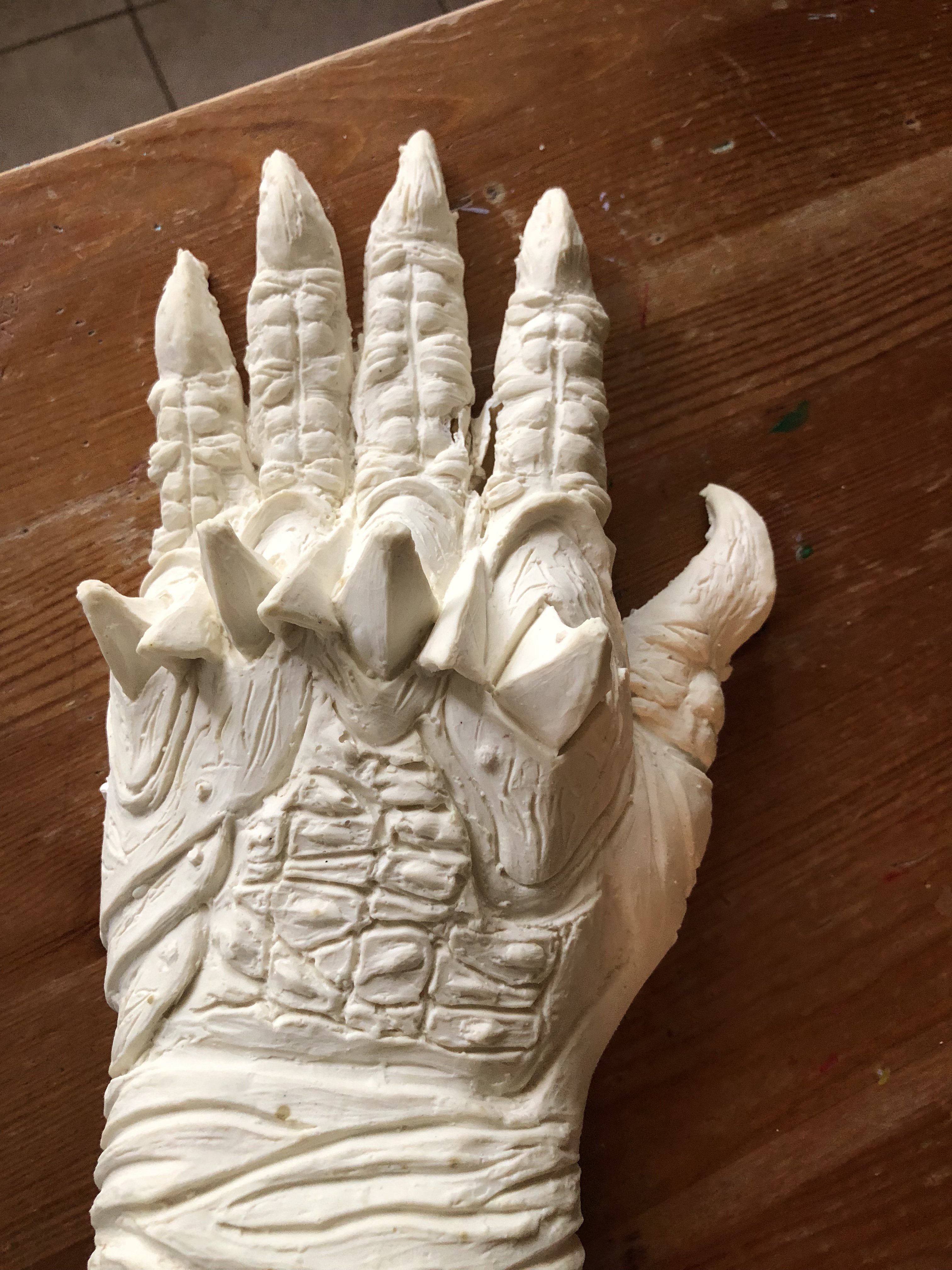

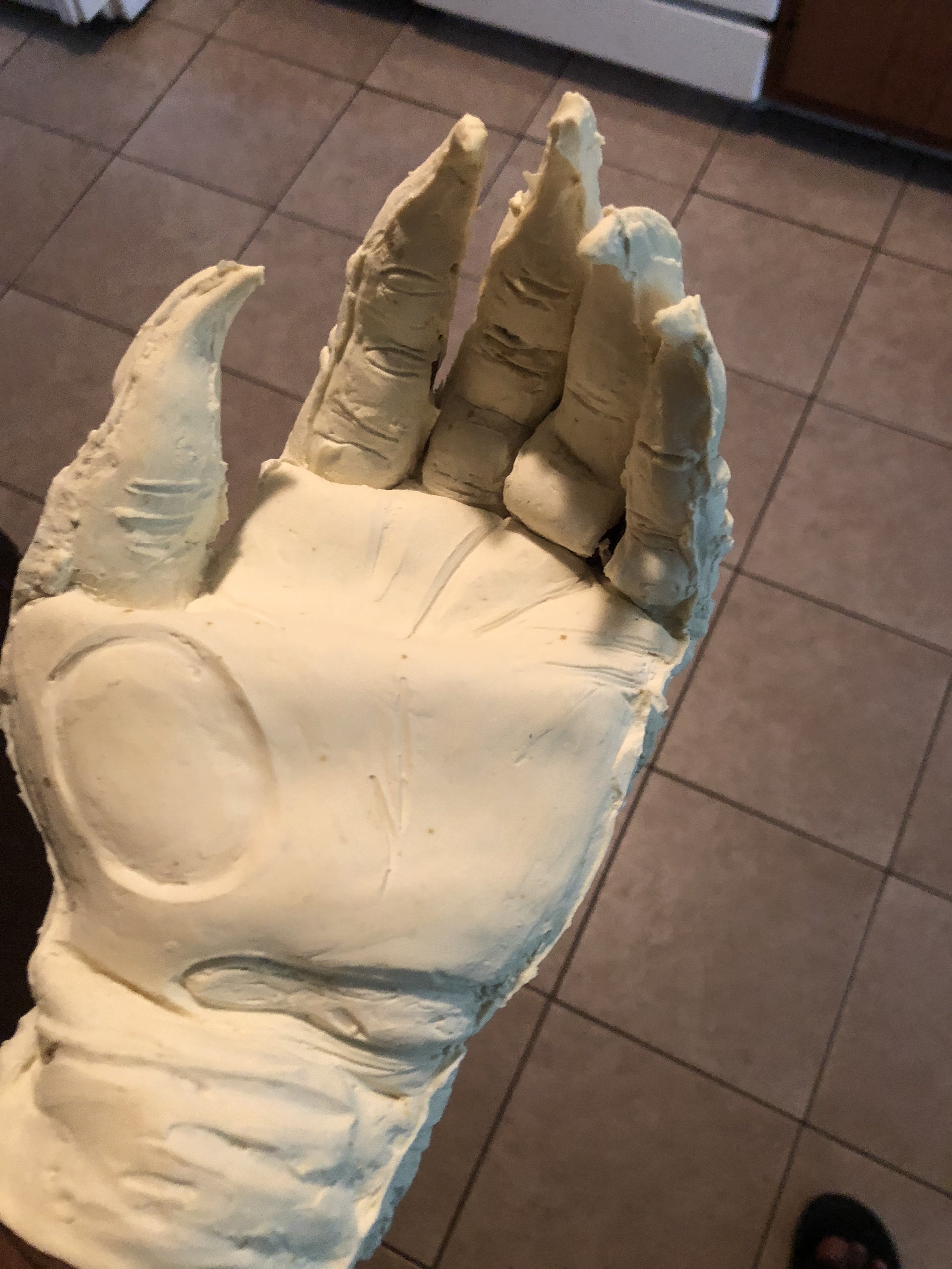

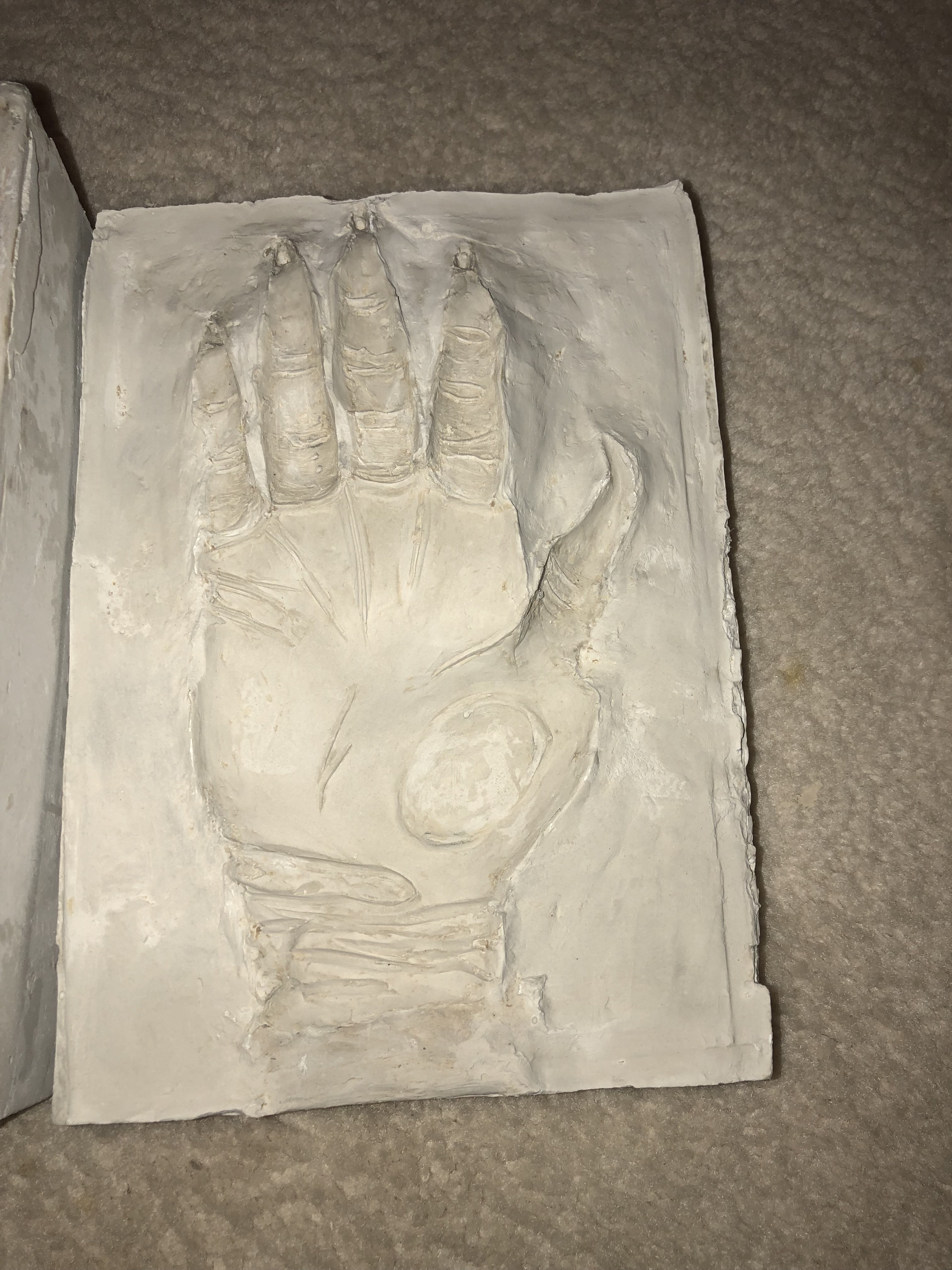

This is my first attempt its not hard . Patience is needed and slight learning curve. Now i will need to finish cleaning the mold with mineral spirits so i can dwell the latex.

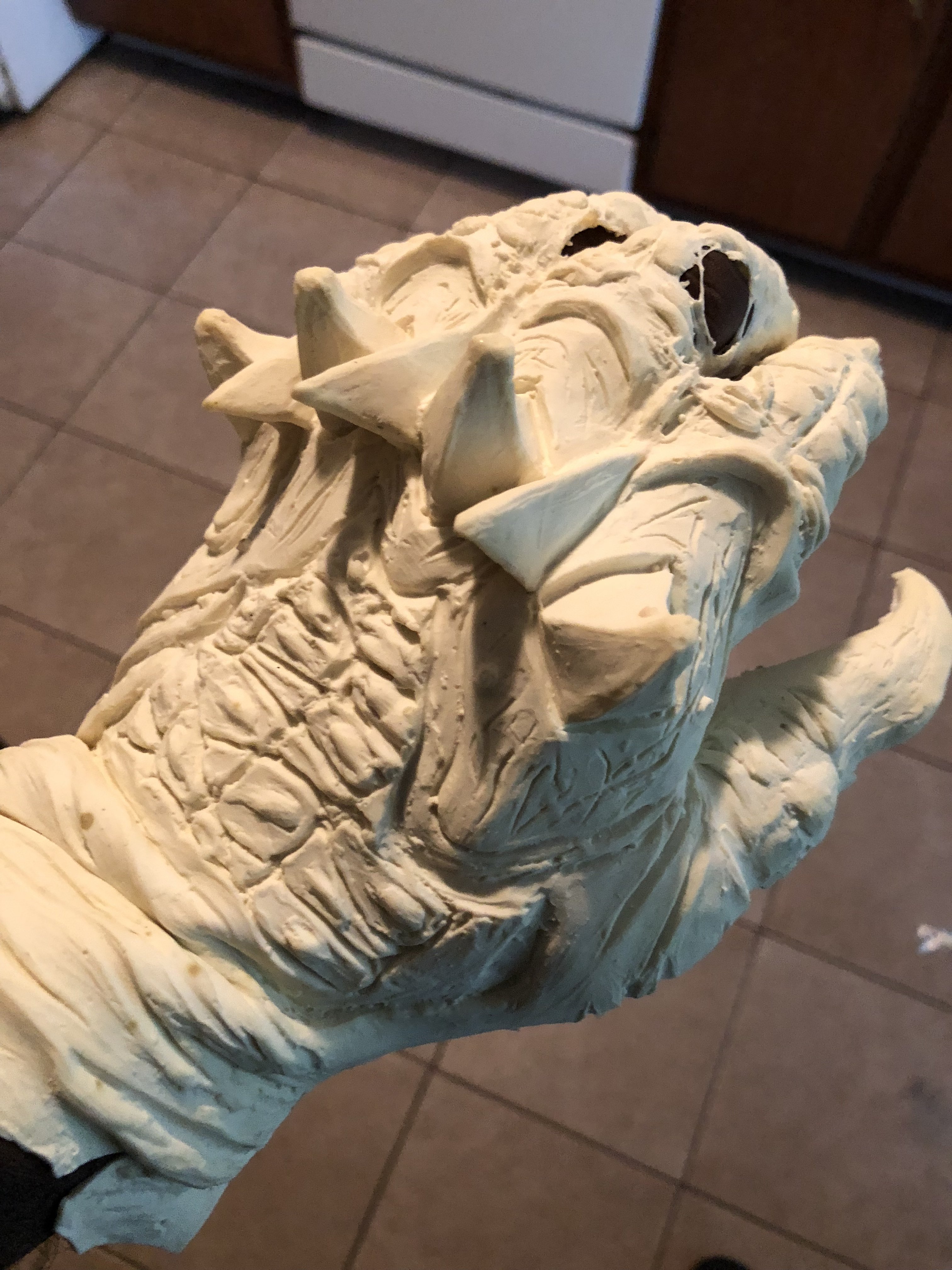

So here is the result of the first test pull from the mold . FAILURE. So here is the reason :
1) latex got too thick over the winter and was not flowing, needs to be thinned out.
2)During dwelling and draining the latex was so thick it did not want to drain , so at that point I decided to take drastic measures and hosed it out. That didn’t turn out well, but since this was a test I was good with it
3)Due to the thick latex the finger would not drain so the genius that i’m I used a screw driver to remove the excess . It did remove the excess but it also ripped hole in finger space. I’m glad this was a test .
