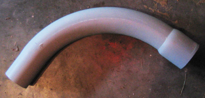

First thing I was concerned with and the biggest challenge in my opinion was getting sheet material to conform to the rounded arc of the main body of the backpack.
So I started out with a piece of large electrical conduit made from PVC, (Home Depot or Lowes)

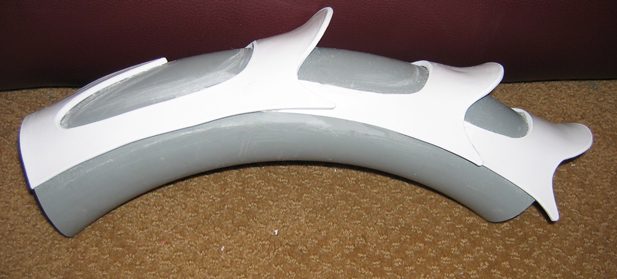

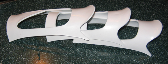

I created the fin portions, heated them by boiling and wrapped them around when I liked the shape I hot glued them on

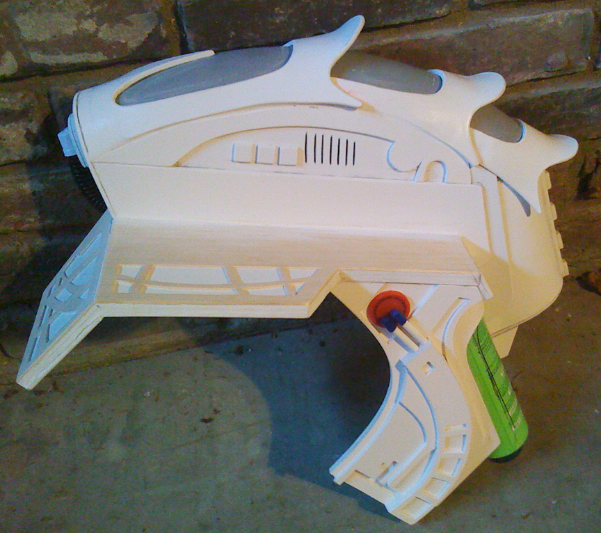

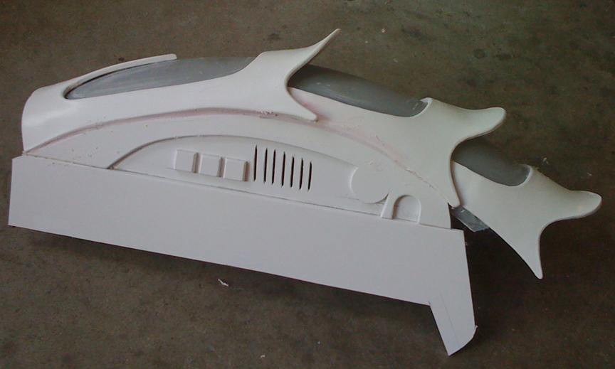

Next I began cutting out the flat panels out of layeres of Sintra and built them up and assembled them
Then I started to assemble all the pieces I had created and fitting new pieces in as needed
This is the progress to date. I hope to continue to work as much as I can until I knock it out
