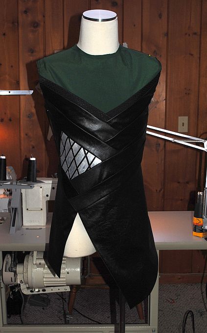

After the fitting, the tunic was taken apart and the patterns transferred to paper. I kept the front with the style lines in tact for use as a guide for adding the criss-crossing strips. I made a base front out of muslin and then cut it down to the top 'v' that the fabric strips are attached to.
I began at the top and worked my way down. Each strip was sewn with top edge over the bottom edge of the one above it. It was then folded down with a 1/4" overlap and sewn down. Then, the next strip was attached.
The 'keyhole' on the front that shows the silver tiles was created next so that it could be added in while the strips were being constructed. For the areas with the silver tiles (this section and the backs of the legs), we decided not to cast all of the pieces, but rather simply mask off the lines on the faux leather and use Angelus leather paint to create the tiles. The piece was then incorporated into the rest of the strips and the lower front was completed.
The upper front was assembled and attached to the lower front. There is a 6" 'pocket' at the center between the upper and lower front sections for the breastplate to slip into.

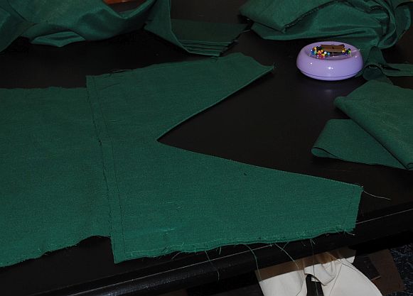

First thing today, I added the back to the tunic. The back is being made of the green fabric backed with muslin. I decided this might aid in breathability somewhat and keep the heat down a bit. Here are the front/skirt piece and the back pieces laid out flat before assembly.

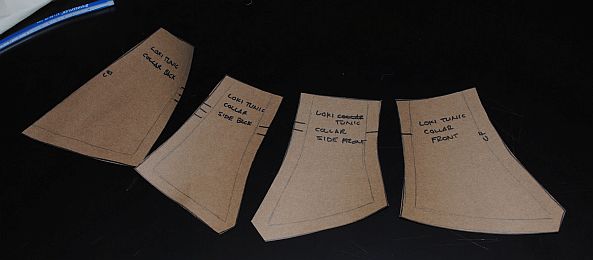

Once the back was complete, it was time to add the collar. Rather than just adding a black band collar, I wanted something a little more sculptural and that would blend out into the green so that the green would not show above the breastplate.
I began by making a basic collar in muslin using the pattern pieces for the tunic and adding a simple band collar. I then marked the piece from top to bottom where the new seams should be and cut it apart.
I then transferred the cut apart pieces to paper and created my new collar pattern.
The entire collar piece was made out of the black faux leather and lined in green. Then, it was just a matter of marking the tunic, cutting the top back and sewing in the new piece. Here's what the finished collar looks like on the tunic.

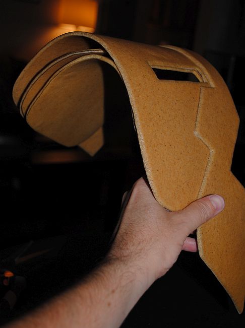

With the jacket pattern mocked up, I decided to make the templates for the shoulder armor. I created the templates with poster board and pinned them to the mock up on the form to test the size and fit. The armor will be created in the same way that the arm pieces were done.
There will actually be two main pieces per side: the chest and 'collar band' and the shoulder itself. I made a template for each piece and they will be bonded together at the worbla stage. There is also a cutout in the shoulder for the cape to fit through.
