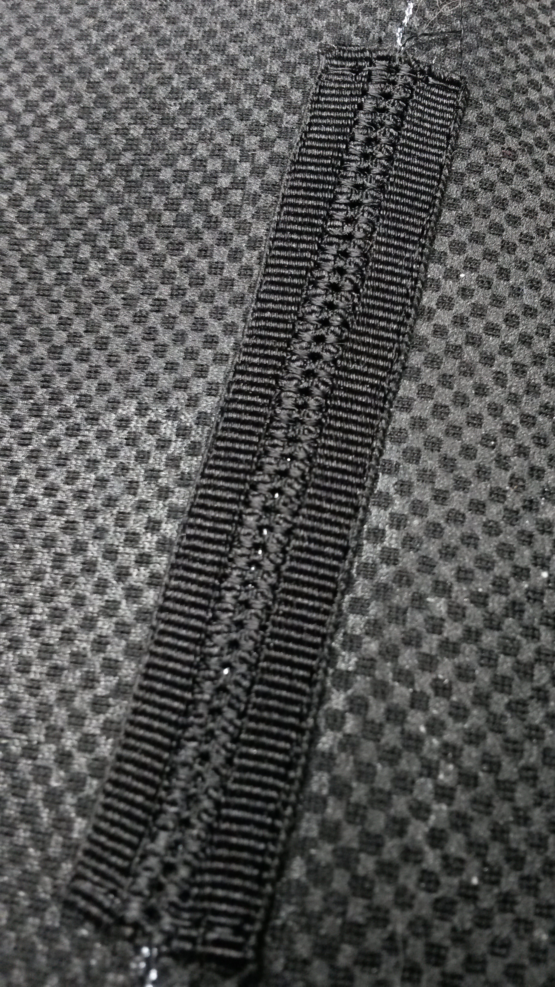

On one or two of the threads here, we were discussing the possibility that the newer Marvel suits were not a woven kevlar or cordura, but rather a heavy weight spandex with a raised ink screen print. So, I started playing around with screen printing. I managed to find on evilBay, that Topps had "relic" cards, that had little scraps of fabric from the cutting room floor, and first I managed to find the Winter Soldier suit, and then I found the Avenger's suit. I was surprised the scale of the print was the same size for both movies! I could have sworn it was a larger scale for WS, but the few hi-rez images that showed texture for WS was so photoshopped it skewed things. So, since I was able to see the scale of the print, which is basically just squares, I made the print up in Illustrator and had a large transparency sheet made to burn my screen.
Now... I definitely bit off more than I could chew with the scale of the print, and it was a comedy of errors trying to print all the pieces I needed, but I did learn a lot, and I'm going to take some classes before I remake the suit, or make something new.
Here's a close up of my fabric and my trim test. I had to custom-make my own trim since I couldn't find anything like it. It is a fold-over elastic from Japan which I put a decorative stitch on with my machine, and top stitched metallic thread under.
I'll post more of my build info shortly. I built almost everything in this; I patterned the suit, I laser-engraved the SHIELD patches out of a silicone sheet, I hand-fronted my wig, made the gloves, and I made the boots from scratch. First time doing that and they are NOT comfortable, but they look freakin fabulous!

The fabric looks very good. I'm still quite convinced that they used black spacer mesh for the film and the material is 4-way stretch (although limited on one axis), and relatively easy and inexpensive to get. It's also extremely breathable & dries very fast. I also used fold-over elastic for the trim on my suit.
For my current patches (which I haven't used since switching to the Infinity War costume), I made a 3D model that I printed using transparent and black flexible filament. I then painted the back side with silver spray paint and then glued velcro over that. The 2-color print just requires a filament change after the background layers are printed. They are not super soft, but they are quite flexible. I knew I might re-use the suit for other cosplays (which I did for Infinity War), so I used a velcro attachment. It would have been easy to sew the patches on to the suit directly and it's also possible to model the holes for the thread directly for the printable model, making it a lot easier to get the hand-stitching to look professional.
It's a good solution for looks, but they did indeed use screen-printed spandex for the films, confirmed by the fabric swatch cards I found and a couple panels I attended at Dragon*Con. (Adam Savage confirmed they use this method in a podcast, too!) When I was at pre-judging at the DC costume contest, one of the judges who saw mine commented how he washed the real Black Widow suit so many times! I had managed to find a woven stretch cotton, I believe it was a Robert Kaufmann, that I used for my CA:WS suit that had a decent texture to it, too. It would be great if we could find a screen printer who could do continuous yardage like this and do runs of it.
