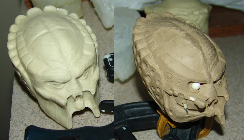

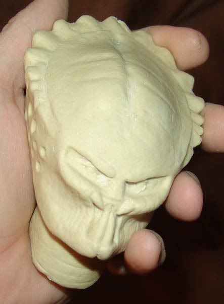

So I picked up some firm clay and went and started a head and shoulders of something I wanted to do for while now.
I ended up thinking it was too small and started a new one...
After getting the shape about how I wanted I closed the mandible and decide to go with that.
I think I need to bring the crown forward and maybe beef up the jaw. Overall I'm pretty pleased with the way this has come out so far. This would be my first actual pred head too.

I did a silicone adhesive mold and didn't let the first layer cure quite as long as I should have and ended up with more cleanup then I wanted.
MasterAnubis
So that one ended up coming out so well I started another one. I didn't say before but that one I cast up was made of Task 8. It's not all that great for slip style casting but it is a good stiff plastic that is heat resistant.
something a little more traditional I think. I originally wanted to cast the first one up then do some damage but if all works out, this one will get the battle damage.

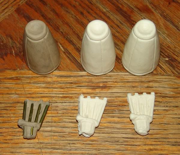

I did a neck ring to see if I like how it fits... I don't know if this style is what I really want. I cast up the big teeth and worked on the mouth a bit. I don't have the lower teeth in. I think I'm going with separate teeth there but the top teeth will stay in the sculpt.
I tried to make a cheap mold of the hand and it turned out to be bad choice, so I'm going to have to make a good mold of the hand to get a one piece hand.

Are you casting in resin from your clay sculpts?
I make silicone adhesive molds off of the clay. Then make prototype parts out of them. That way I can cut up the pieces and glue them together in a different way if I need. I can even add clay to them. Then once I get the parts the way I like, I make a proper silicone mold for it using Polytek Platsil 71-20.
The hand is a good example of why I did it in stages. For the fingers I ended up with four different finger molds and then I cut and glued everything together so that I had the right proportions. The whole hand was just too delicate to work with as clay and wire hanger.
The white resin is Smooth Cast 321. It takes a while for it to set up so it gives me time to pour into multiple molds. Mixing very small amount is hard. The tan resin of the mandibles is Task 8. It's a lot quicker but has different characteristics when cured(heat resistant and more rigid).
