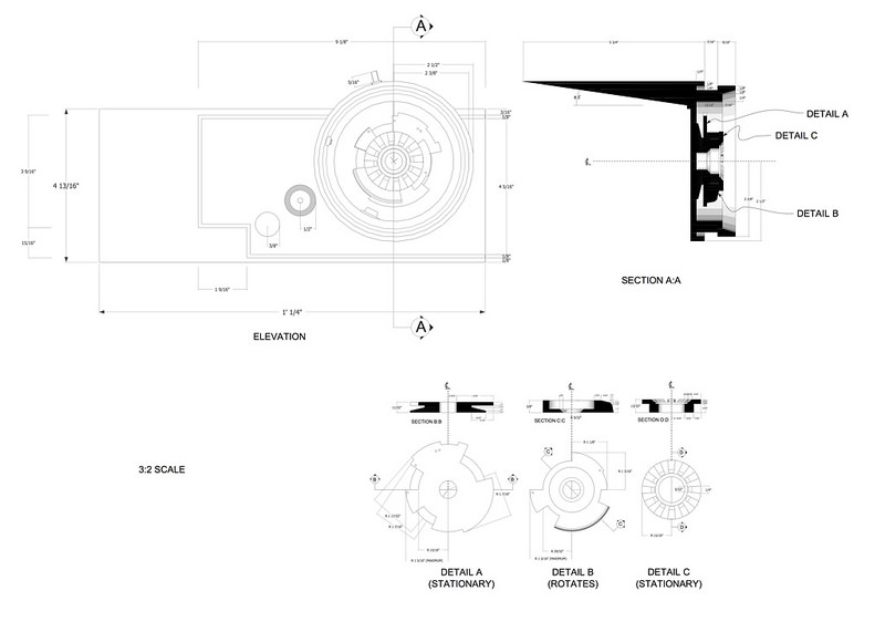

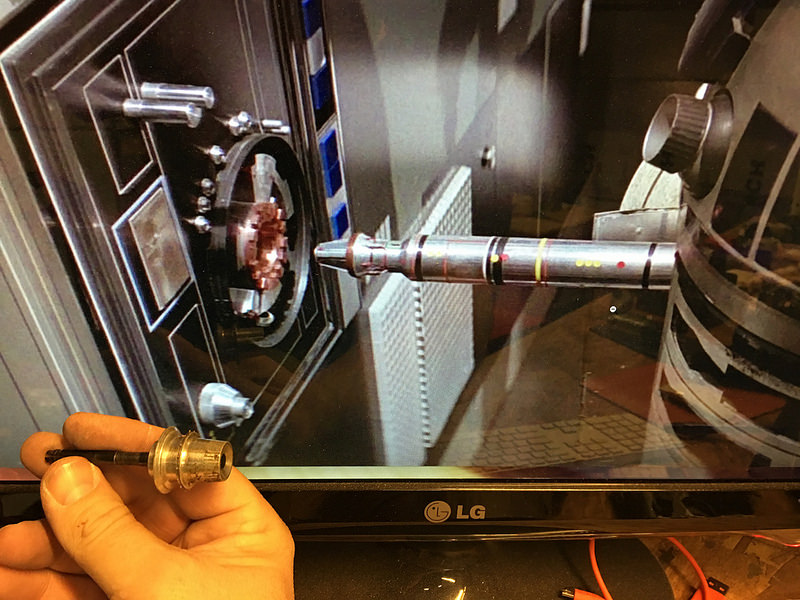

This project goes back several years when I asked Stinson, who has done amazing work on the Full Scale Falcon with his digital renders, but I asked him for a slightly different project. I wanted the plans to build a Droid Socket, and he did not disappoint . . .

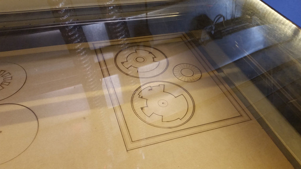

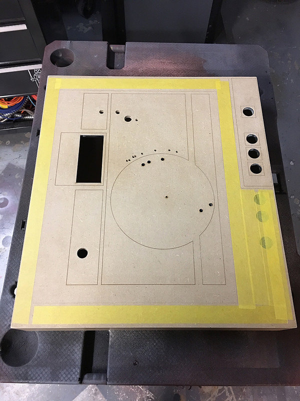

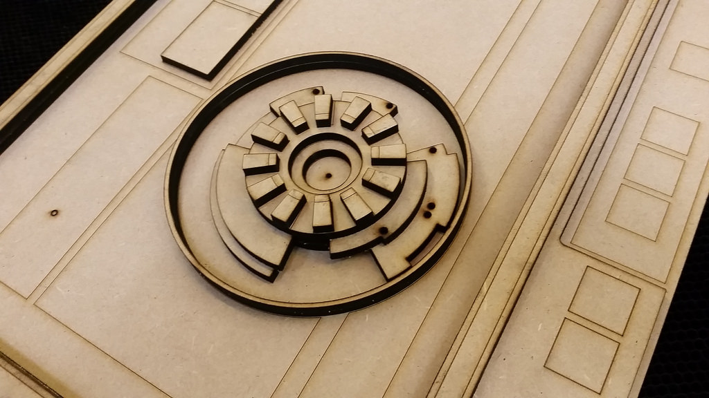

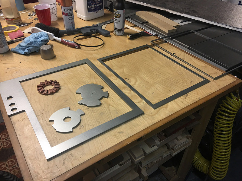

I will say, I was like a kid at Christmas!!!! Sofa sent me a kit, actually a couple different kits. Since we build 2/3rd droids and the above photos are a 1:1 scale he was kind enough to send me both to experiment with. But I started with the 1:1. Now I will say this, we have a ton of ideas between the two of us as to where this prop can go; electronics, automation, etc. but for now, lets deal with getting it build and finished as a static/semi-static prop. After all, Celebration is only a couple weeks away :)

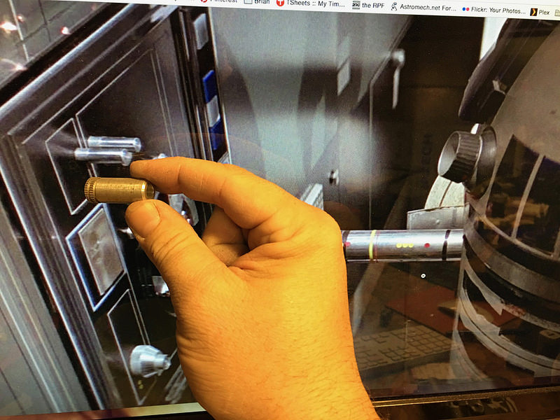

So we started with finding the best looking greeblies needed in addition to those that Sofa laser cut on his AWESOME AMAZING MACHINE!!!!
not bad, not bad. tough to really tell what the originals are from, but we did our best to get close.

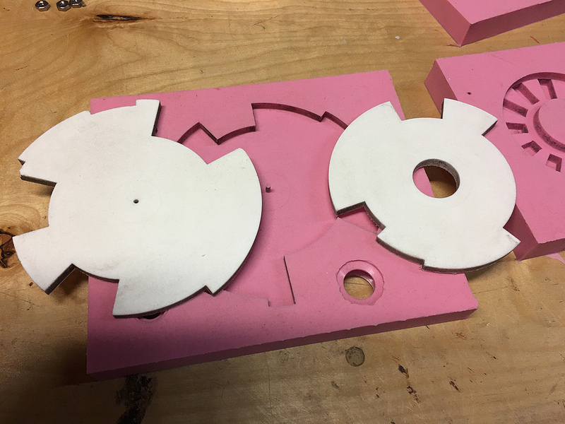

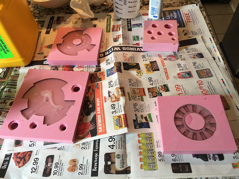

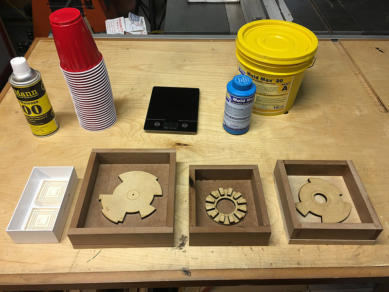

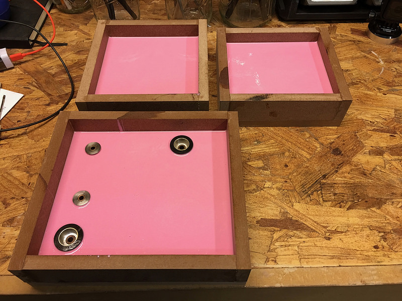

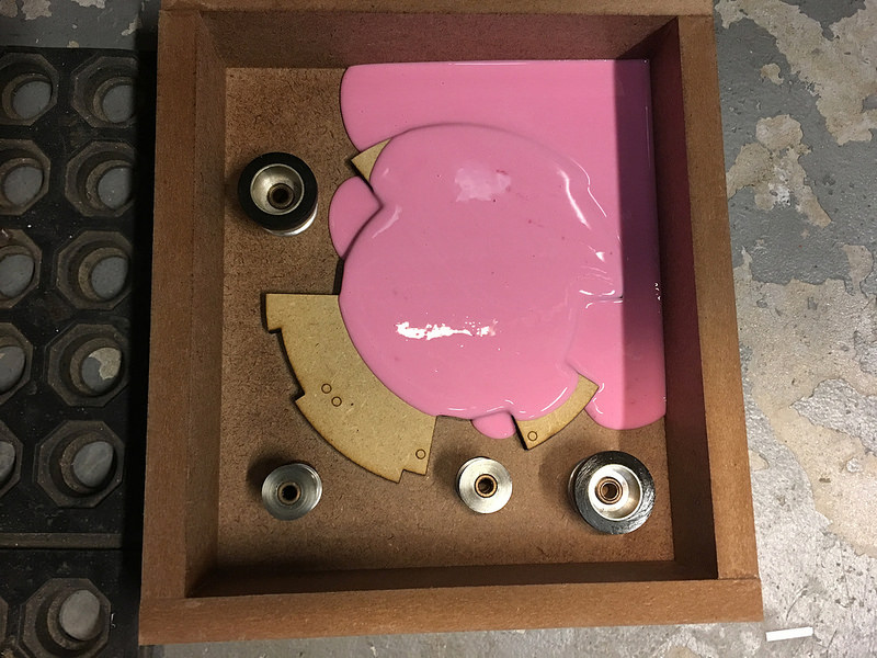

Next up I decided to make a few molds. the laser cuts are fantastic, but obviously with the MDF there is a fair amount of fill, sanding, and sealing on the frames as it is, so I thought the smaller pieces could be resin and save a bit of time. Also, the center piece with the teeth all have to be individually sanded, sealed, and then glued in place, so a mold definitely was faster there.
may as well mold a few other pieces while you pouring right????

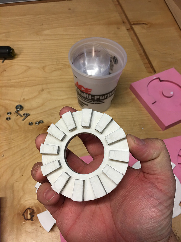

Obviously the next step was to cast :)

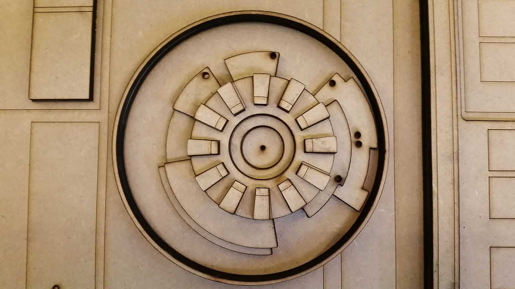

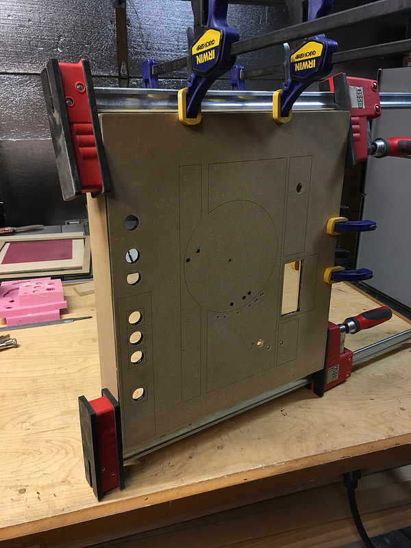

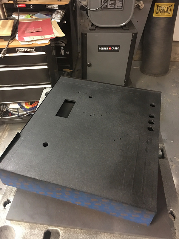

Next comes the box assembly, and the first round of painting . . .
And of course a quick test fit :)

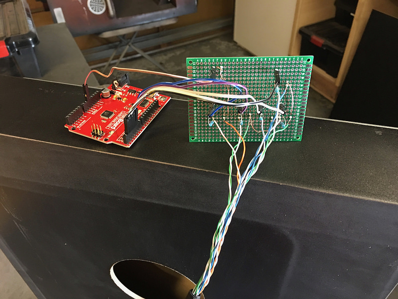

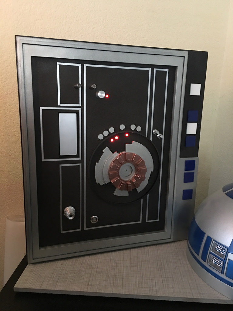

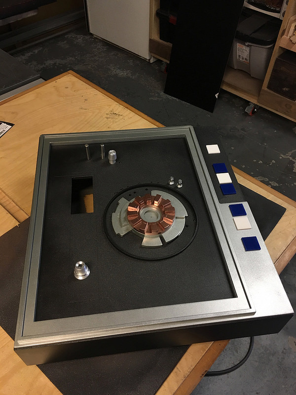

followed by pin-stripe and some simple electronics to help it come to life . . .

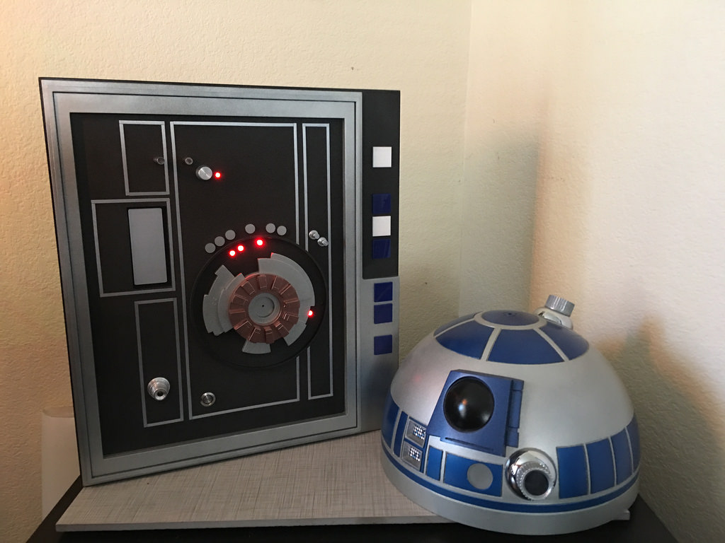

and then, the final result . . .
