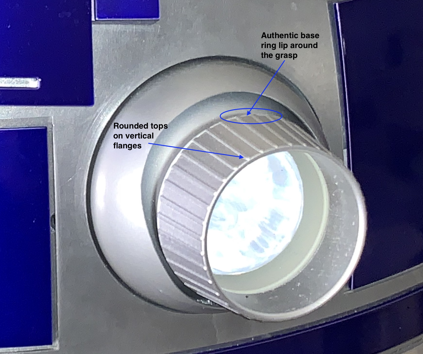

This is a great example of an R2-D2 aluminum holoprojector replaced with a screen accurate plastic grasp.
The original screen used HPs had Bakelite (plastic) grasps.
They were not aluminum.
The fine details on the original plastic grasps is very very difficult to reproduce by machining aluminum.
Here are some of the these details as pointed out by a prop maker after assembling on his R2 build.
The lip along the bottom of the grasp.
The rounded edges at the ends of the grasp ribs.
