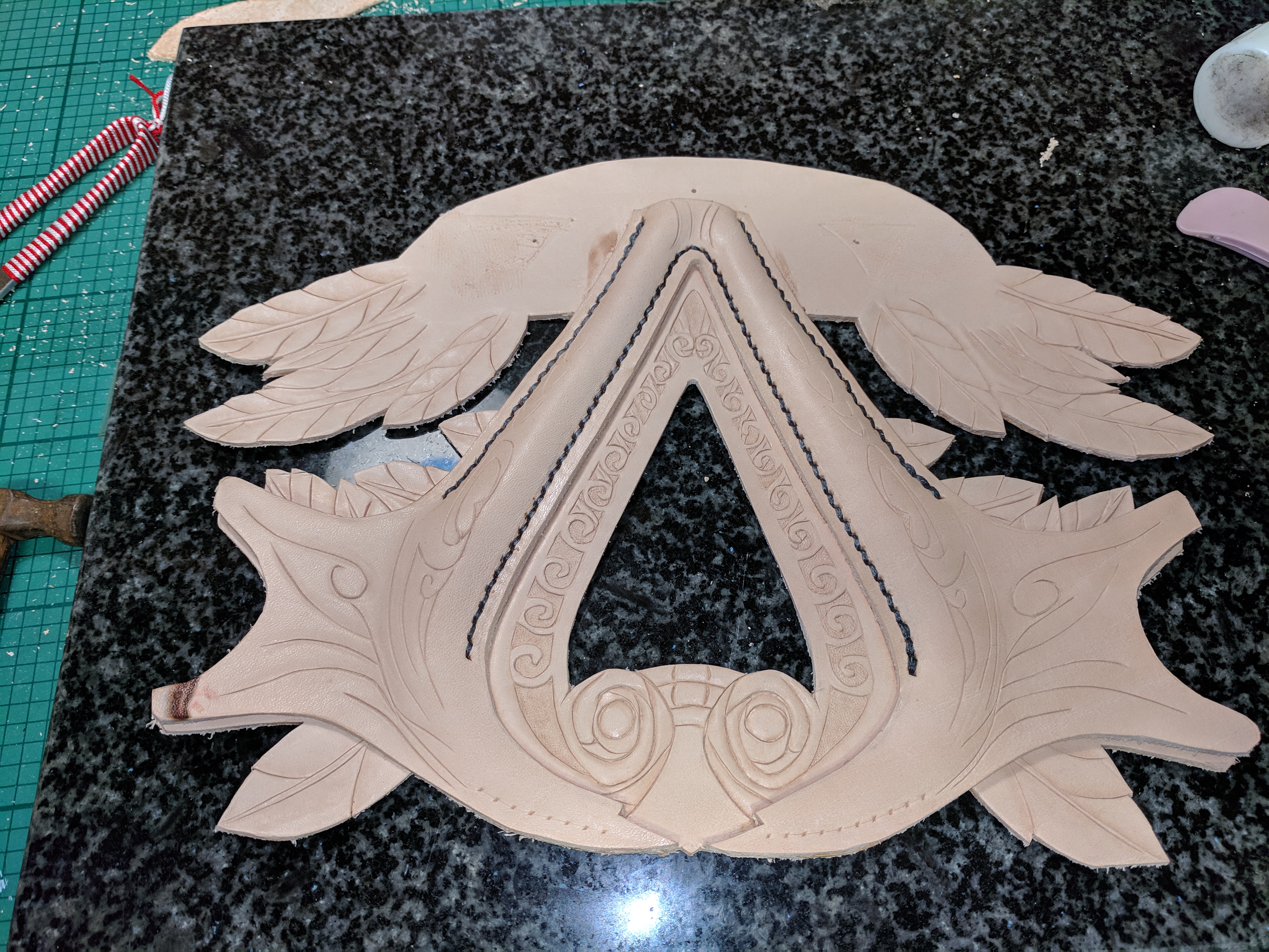

Starting out I decided that the insignia was quite a tricky thing to make so decided to begin here. Searching the RPF I found Athanasios' thread and was in utter admiration with the overall costume and the fact that he had made everything from leather, from scratch. So much so that I decided to take a stab at leather as well.

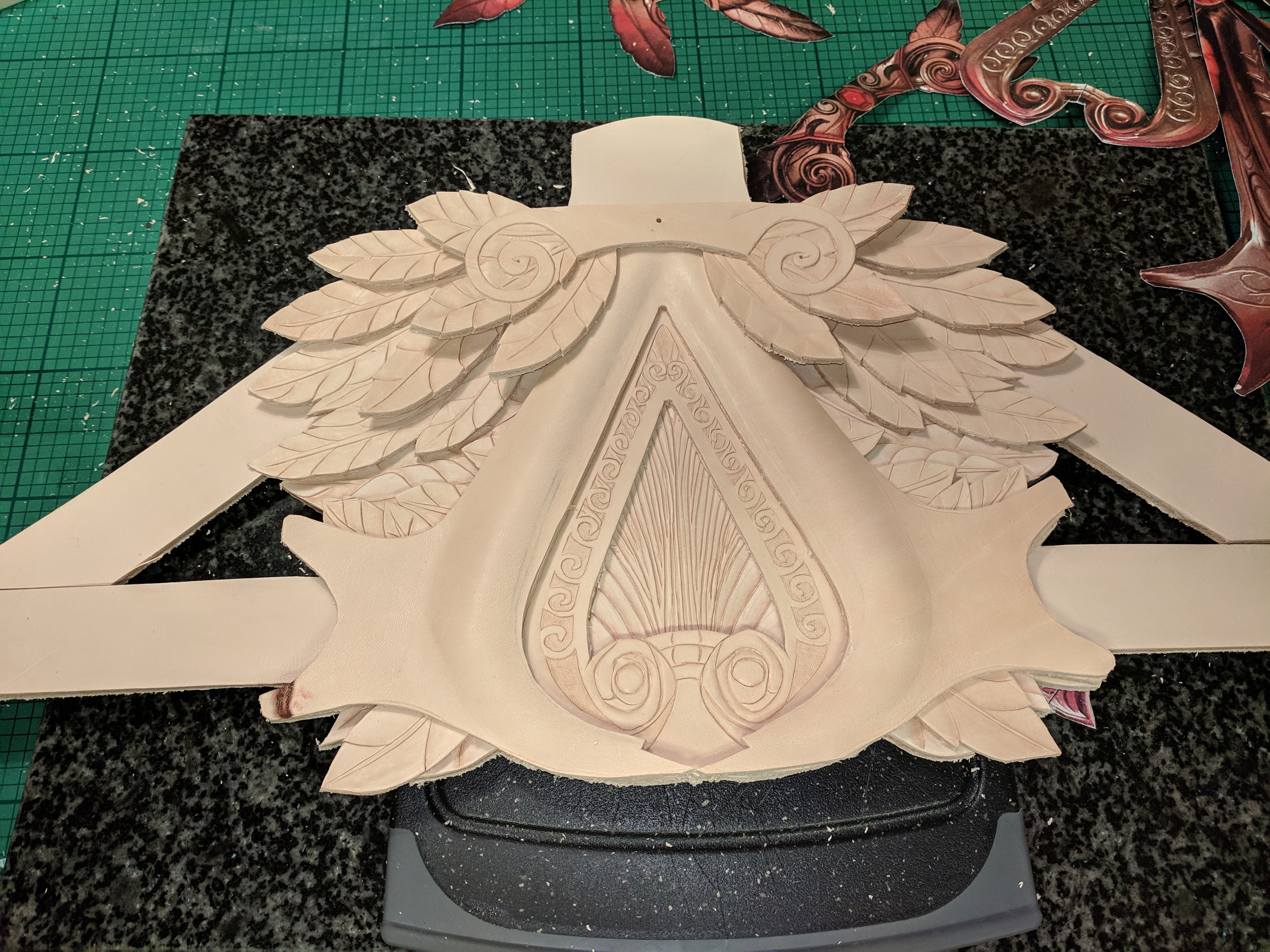

Having not worked in leather at all before, (or really anything other than dabbling with foam) I began researching and sourcing the tools and parts I thought I'd need to create the insignia and belt etc. Once I was done collecting I then got to scaling and pattern making and then I began cutting leather... with 2 months to go before the con. Loads of time right?! Nope, Rookie mistake as I have a full time job as well so not enough time at all, not even close!

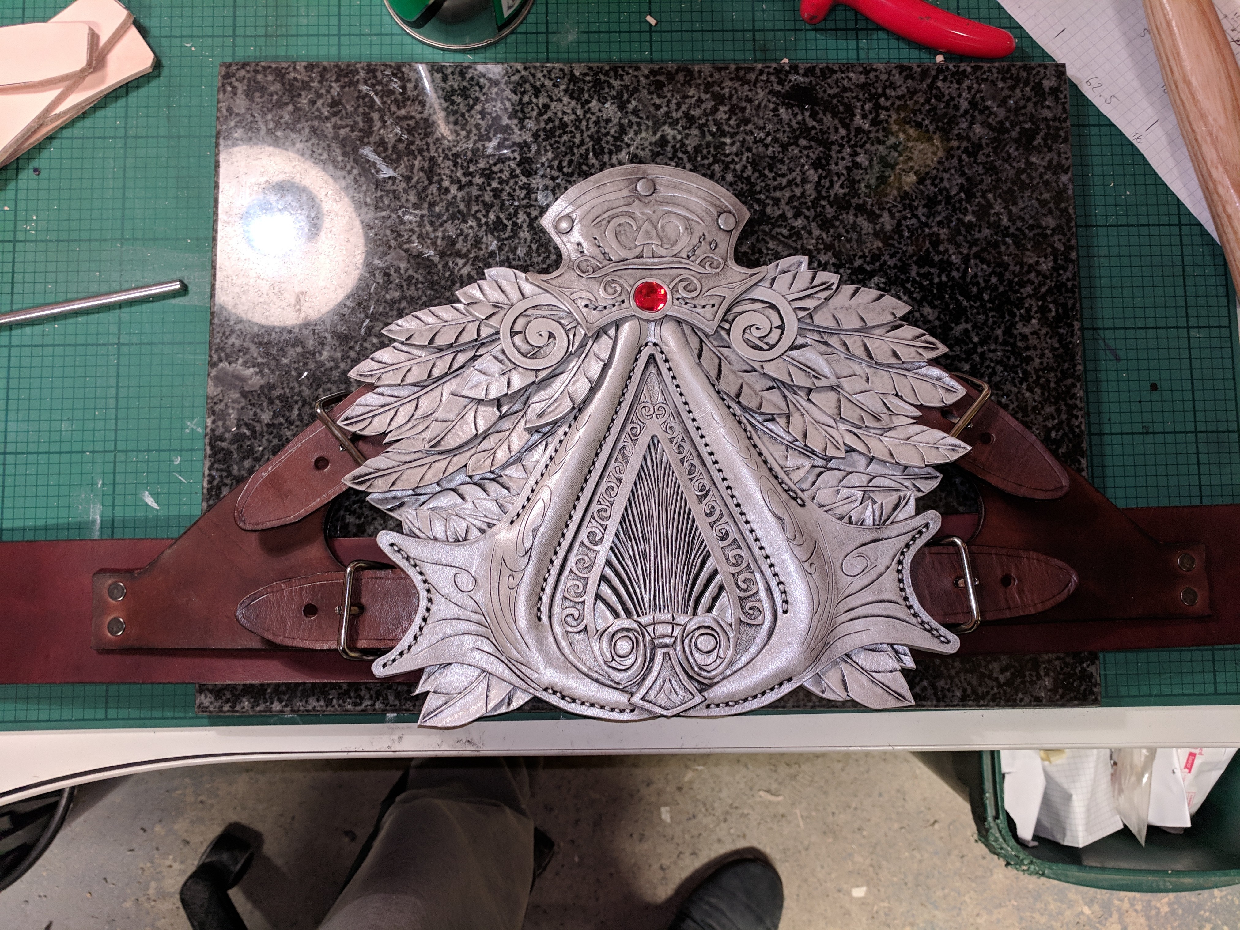

Anyway, after those 2 months and a full week off work and on the project of 15+ hour days right before the con, this was the result.

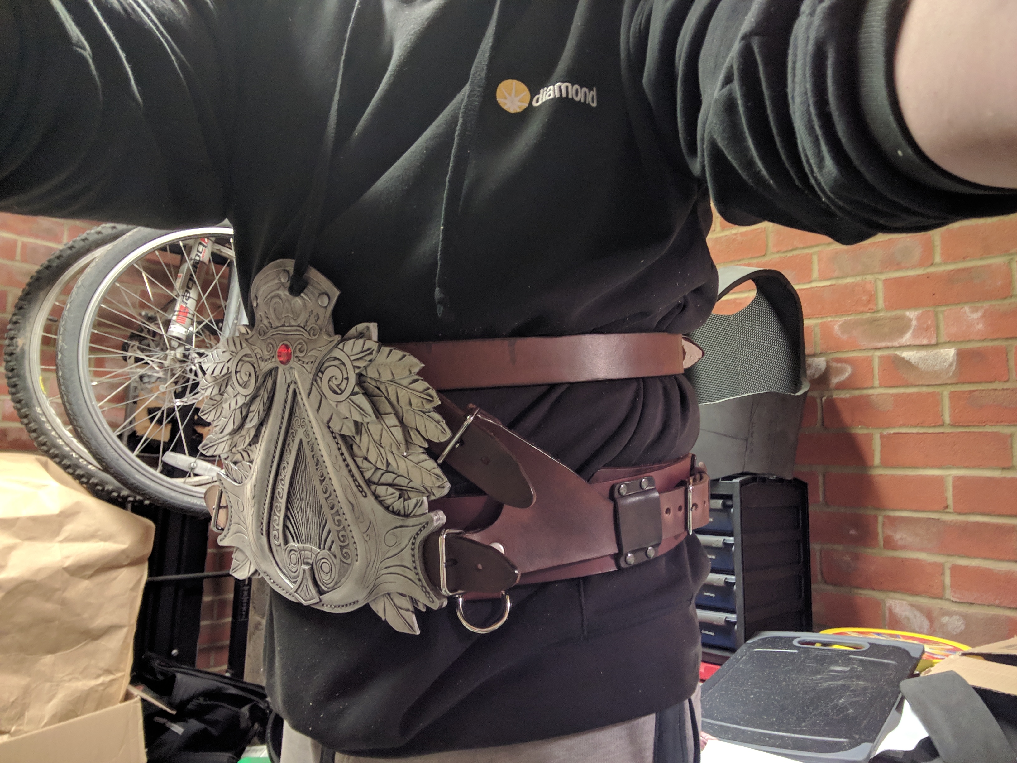

This is the finished article and me wearing it in costume after the con.
All in all I was really happy with the results and learnt so much along the way for ideas on how to do it better in future and for other projects going forward. Biggest lesson was to start a year or so ahead of the convention that I want to go to so that I have enough time to make the costume :D

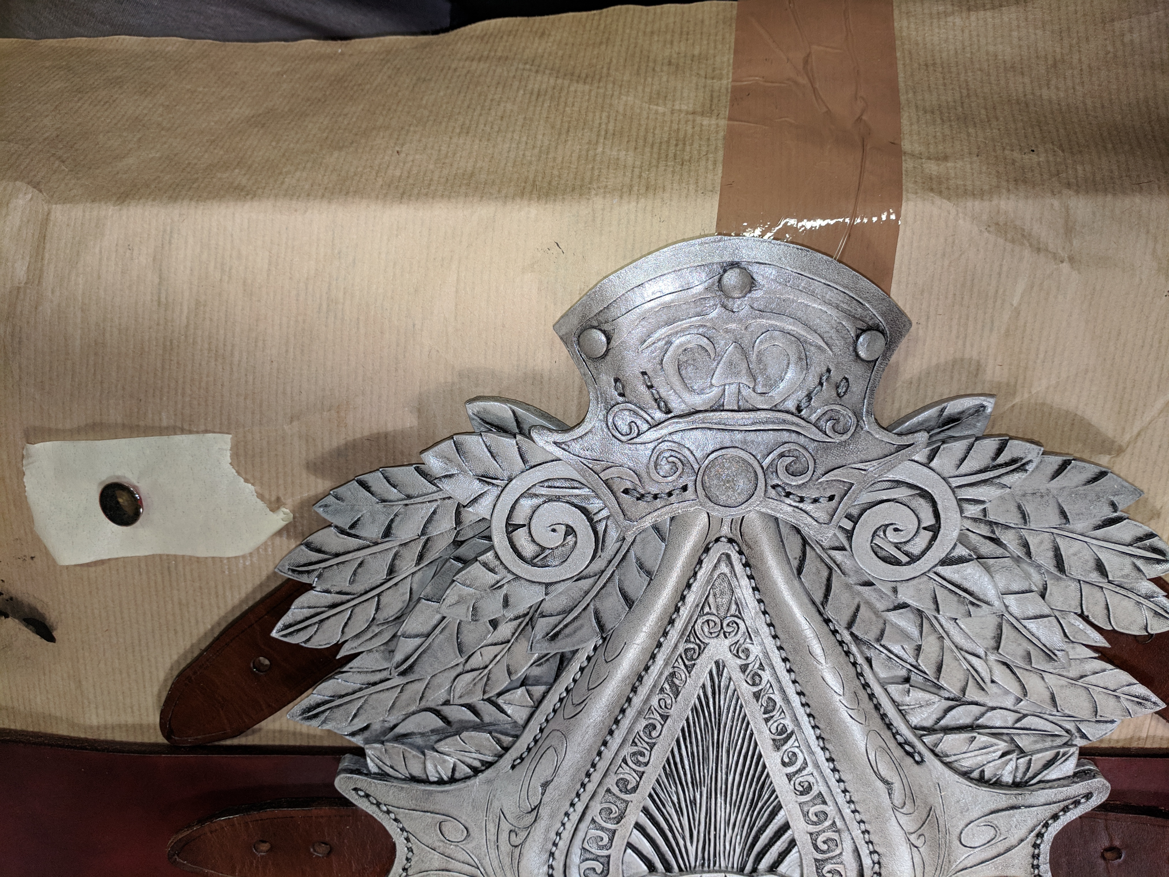

That's very well done! Did you mold the raised section of another piece of leather like making a padded belt/watch strap or just form it freehand?
Also, what kind of silver paint did you use? I made a Ezio vambrace on commission and it's interesting to compare how we approached it.
Assassin's Creed Hidden Blade and Leather Vambrace
Thanks :)

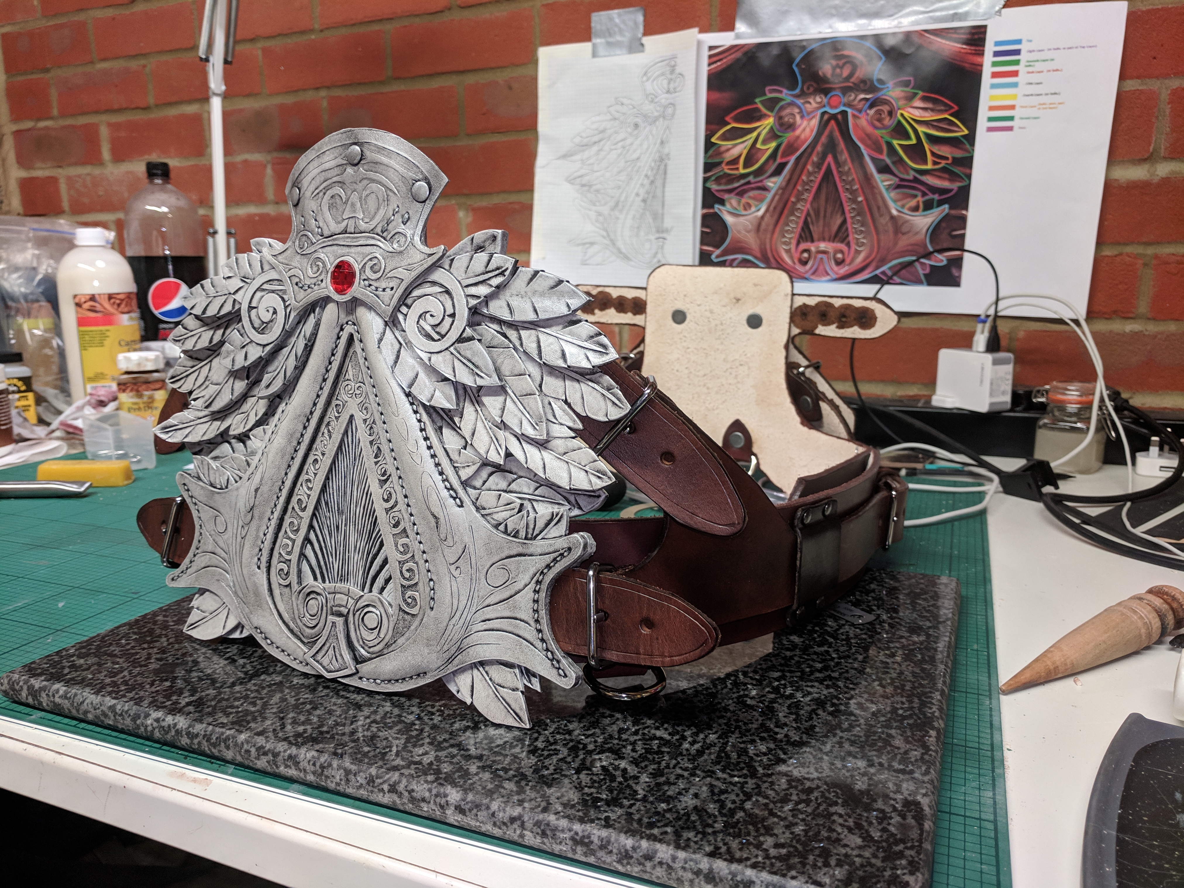

It was wet molded on a quick shape I made from EVA foam. After molding I also cut it oversized and then when I pulled it in and stitched it to the layer underneath it increased curved shape.
The silver paint I used was Eco-Flo Cova color. I had to apply about 3 layers, I think because it's thin so that it soaks into the leather but that also means you need more layers. It was then anitqued with black eco-flo gel.
