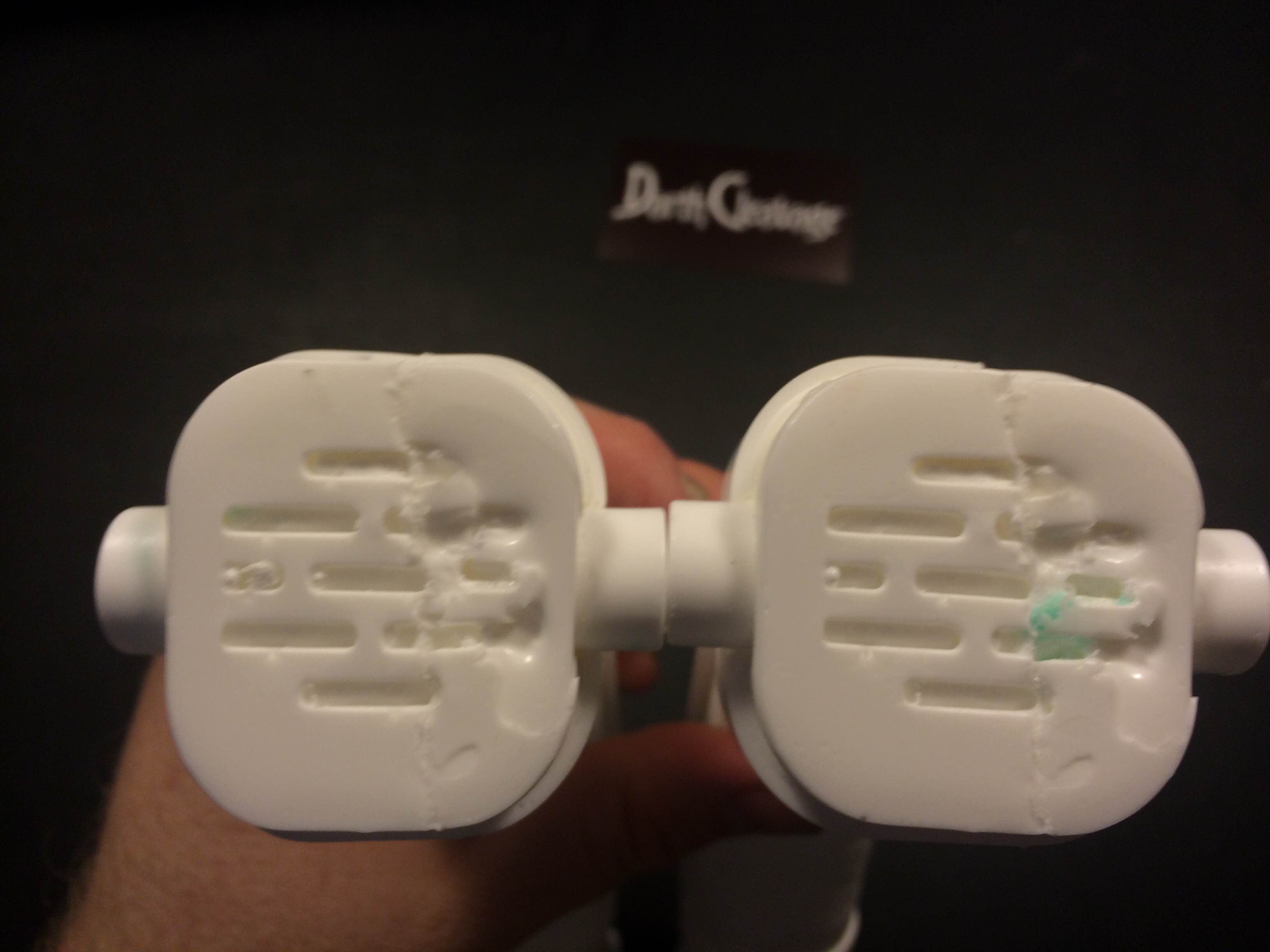

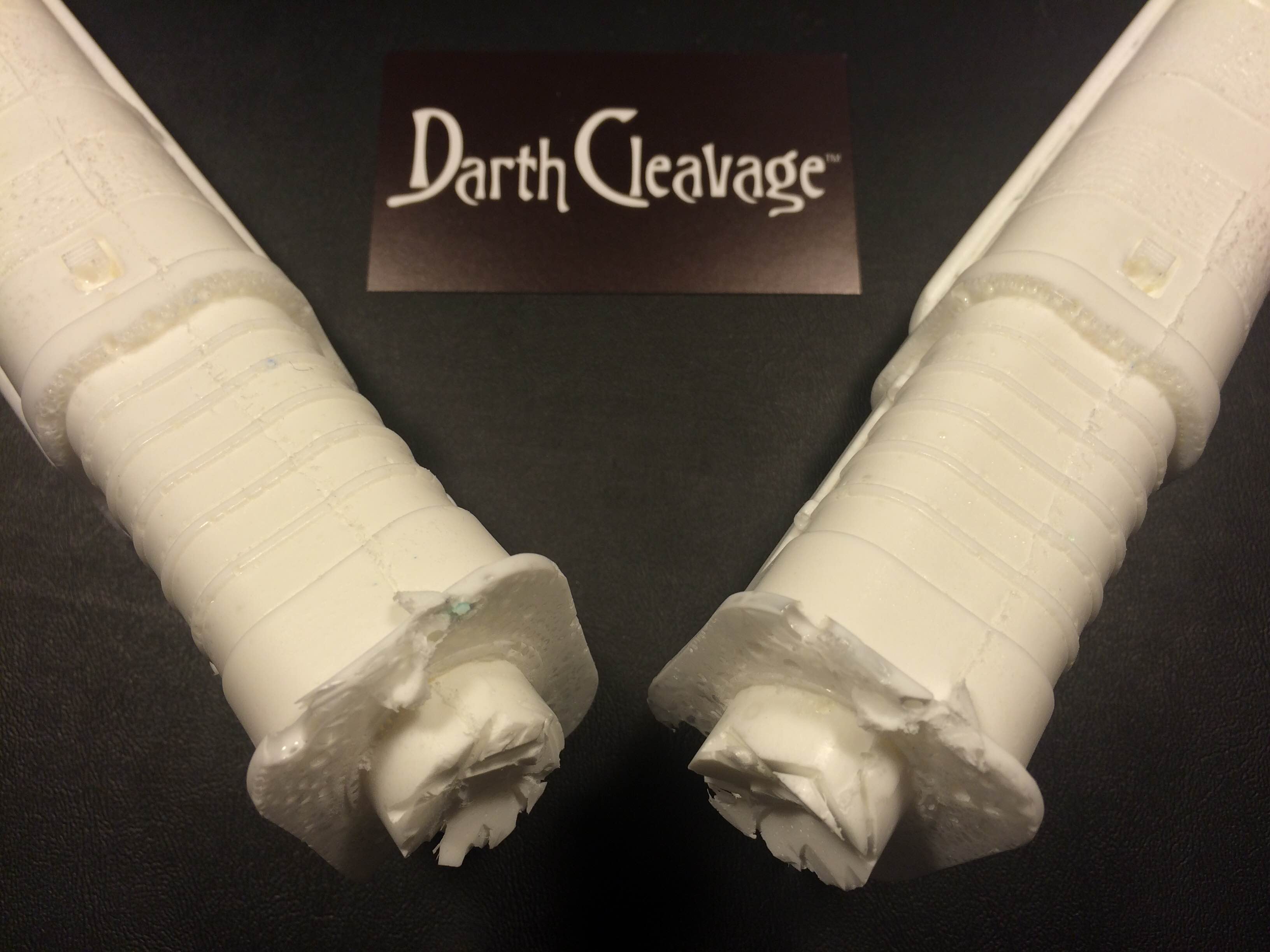

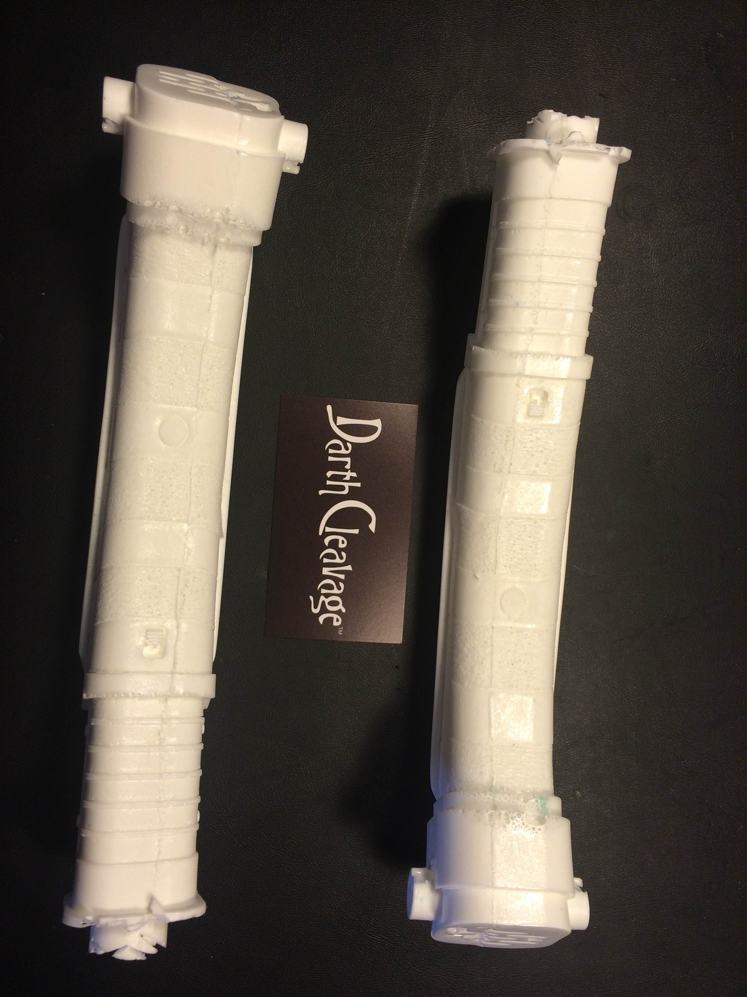

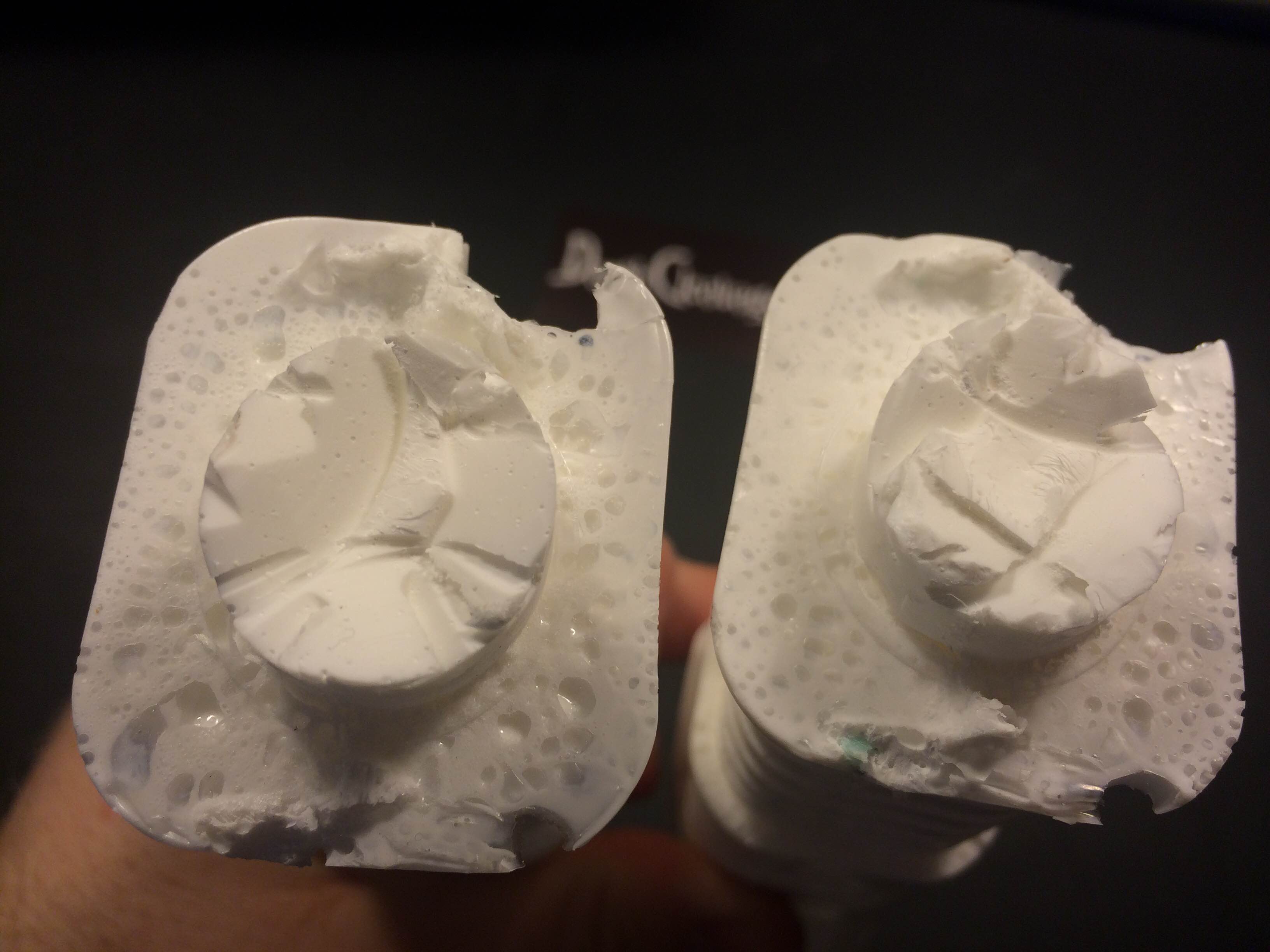

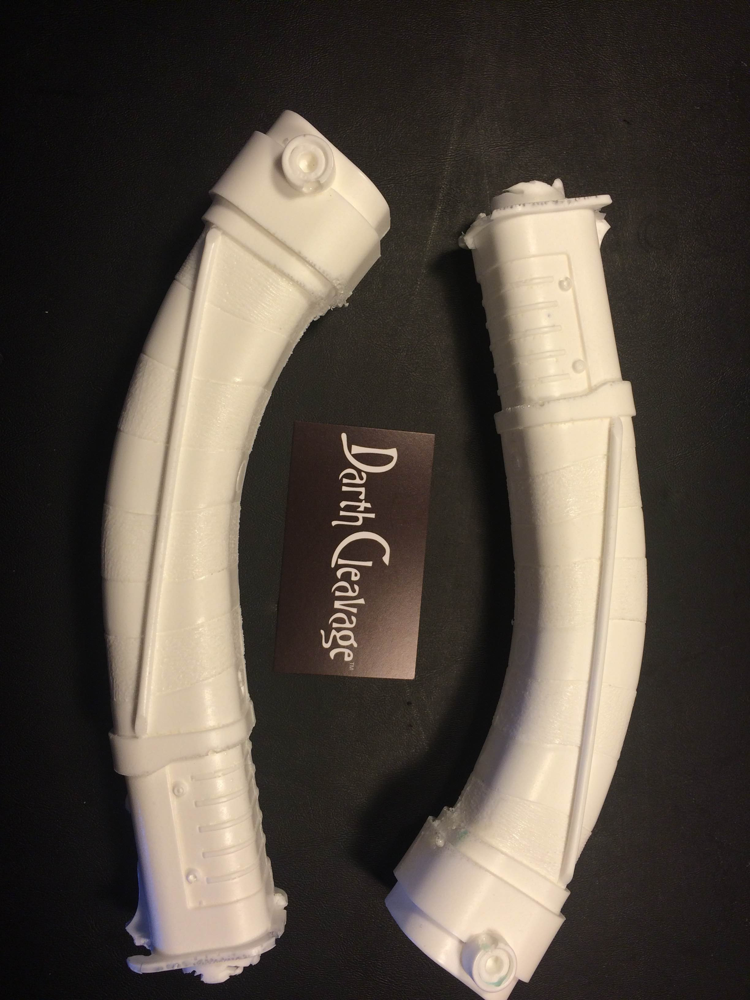

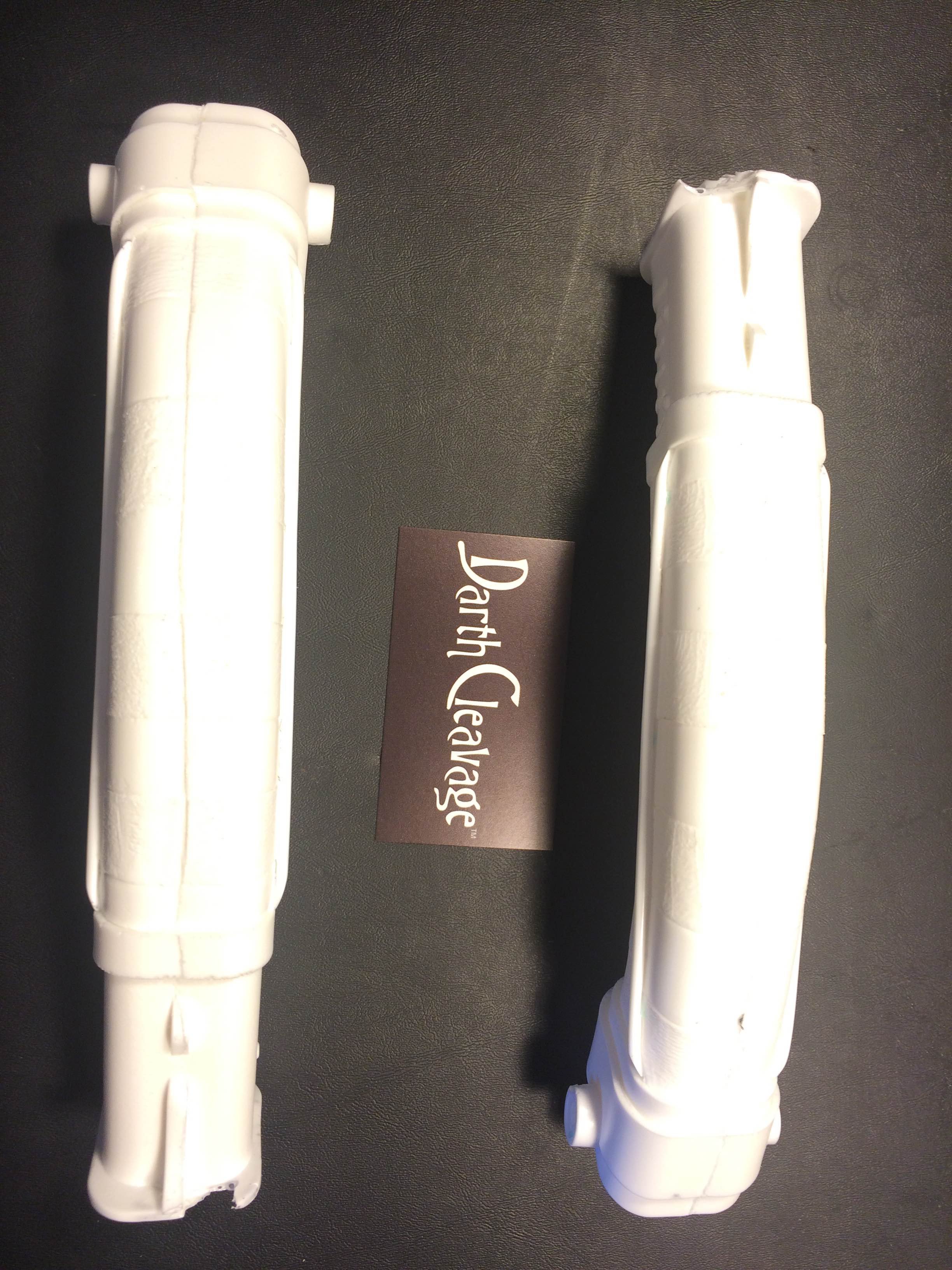

My resin lightsabers came in on Monday. As you can see I really have my work cut out for me.
IMG_1914.JPGIMG_1915.JPGIMG_1916.JPGIMG_1917.JPGIMG_1918.JPGIMG_1919.JPGIMG_1920.JPGIMG_1921.JPG
Any advice at this point would be helpful.
THANKS!

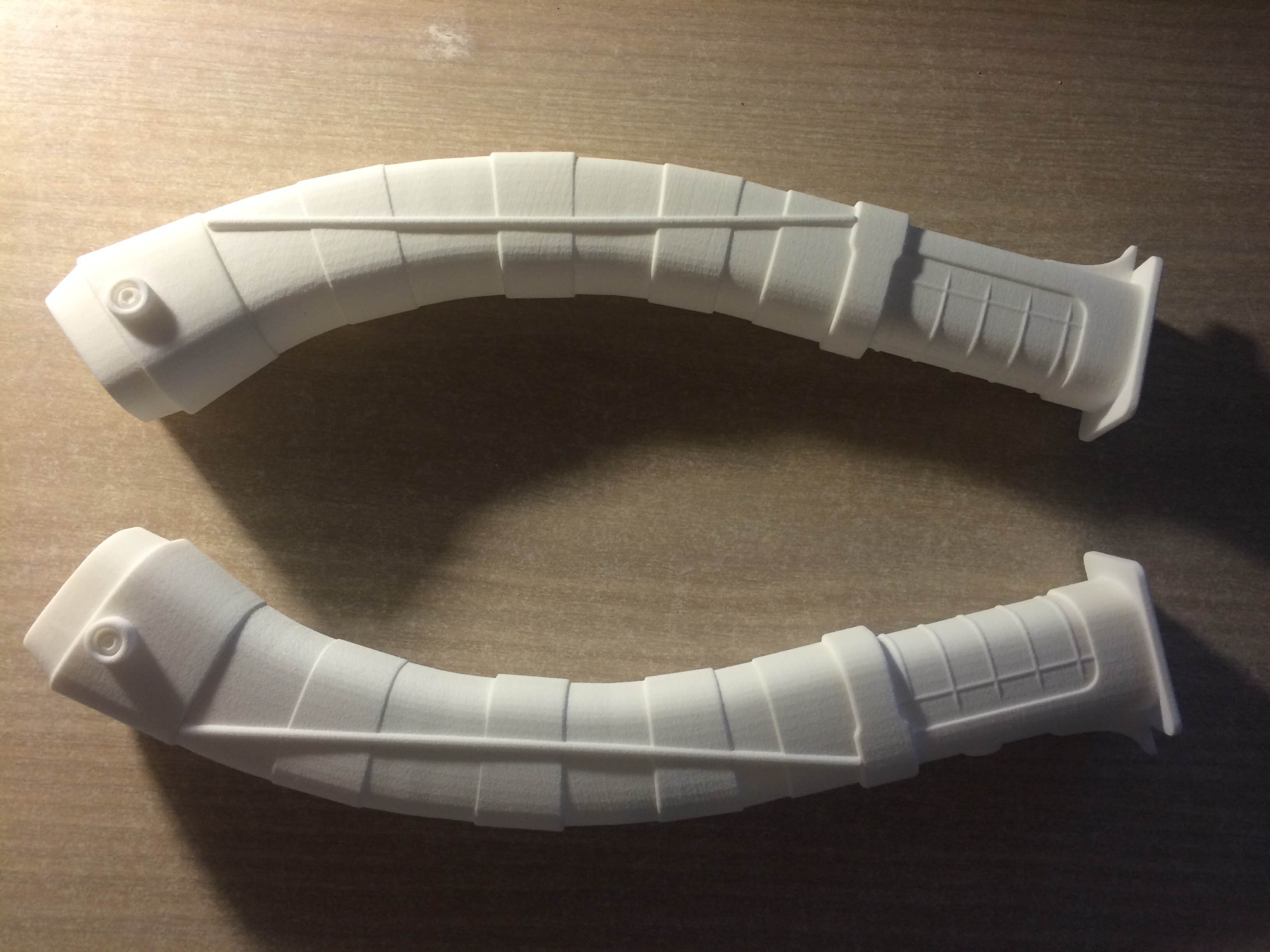

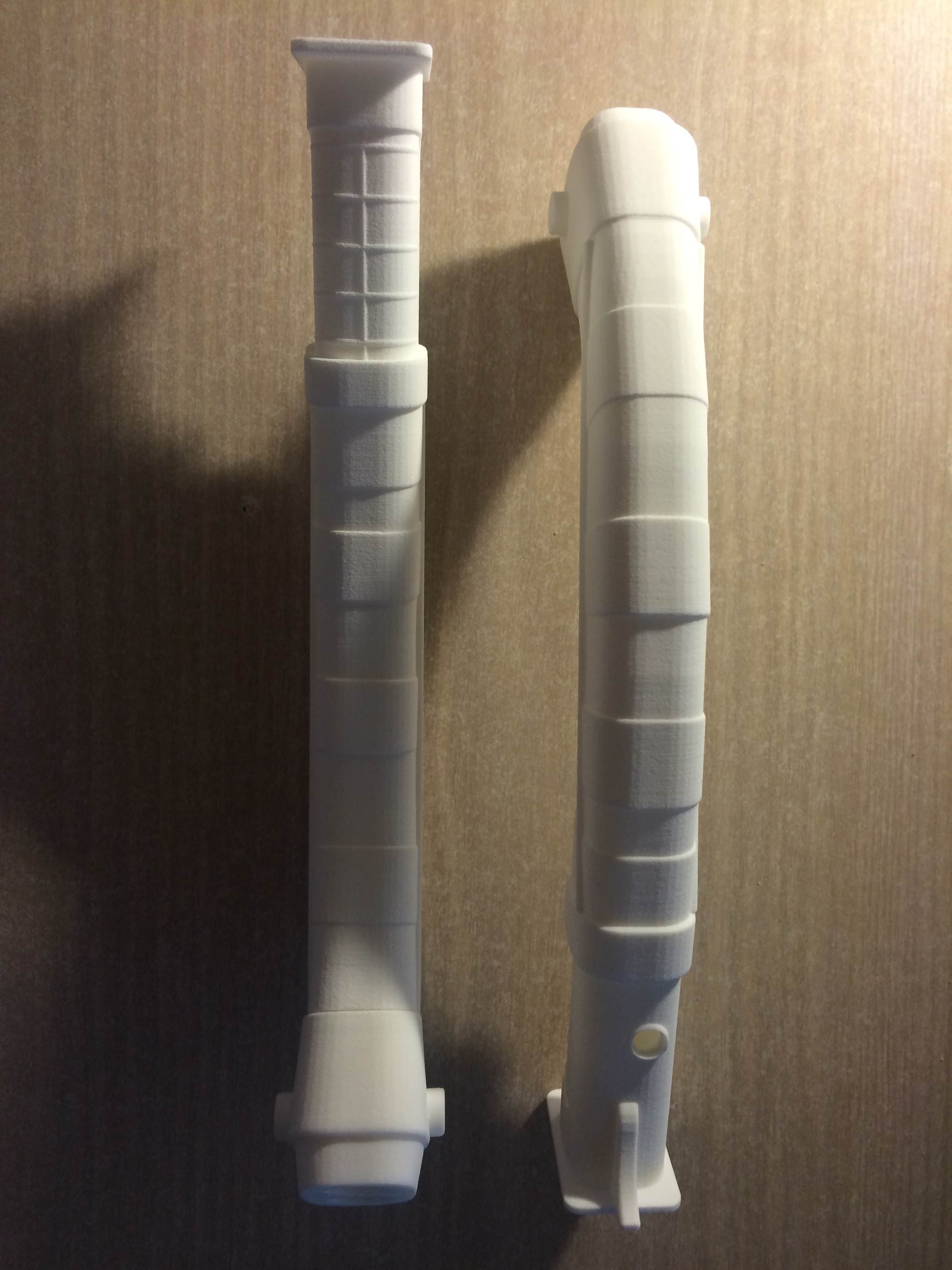

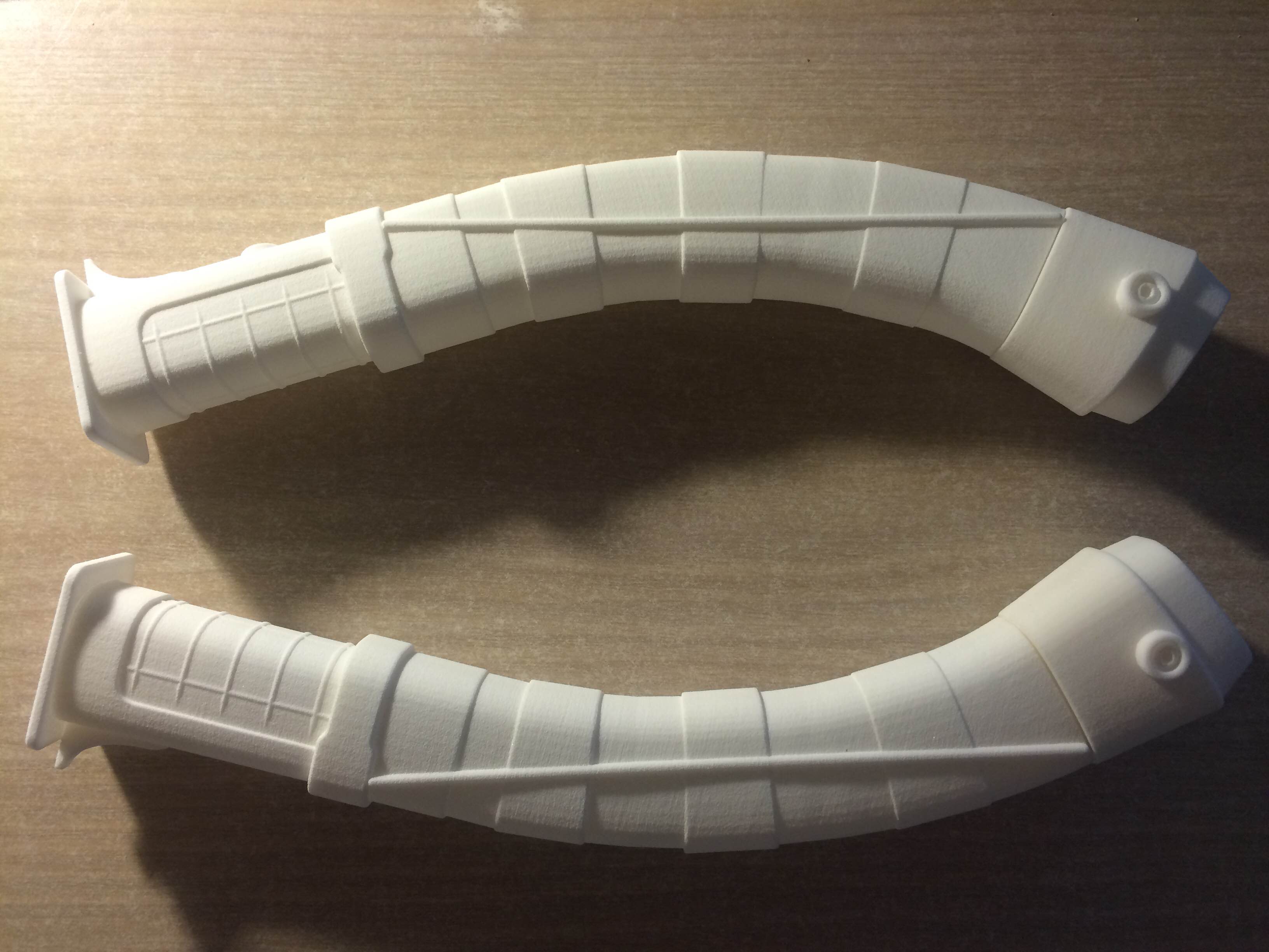

The 3d printed versions came in. They look amazing. I have the exact opposite reaction to these than I did to the others. They look so nice I hope I don't mess them up.
I still don't know what to do about that line. I think I'm just going to cut it off and then get something to replace it with if I feel it needs to be there after the hilt is wrapped. They look so Nice though, I couldn't be happier.
