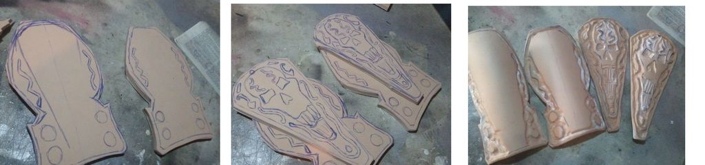

Using some paper i sketched out the general shape, then traced onto the foam. Cut and using the rotary tool, etched and sanded out the shape of the skull head onto it.
After embellishing it a bit worked on the second as well. After I worked out the size of the Ankle guards and cut them out as well. I also place general guide line as to where I would want effects like bumps , etc.
Once it was dremeled out and I heated with a heat gun. 1. to edge of the furry finish. and two semi prep for priming and painting later on. IT also help close in the open cells in the foam. its a science thing
