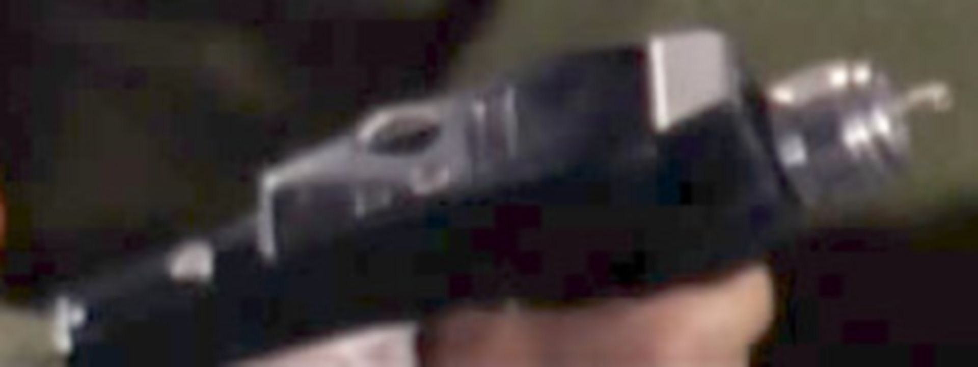

Phase pistol nice photos. Would you say this is an accurate likeness to the real B&W phaser? I want to convert one of my Art Asylum Phasers into a B&W version. With your close-up photos it should be a little easier to create.
Here are the best caps of B&W phasers.
