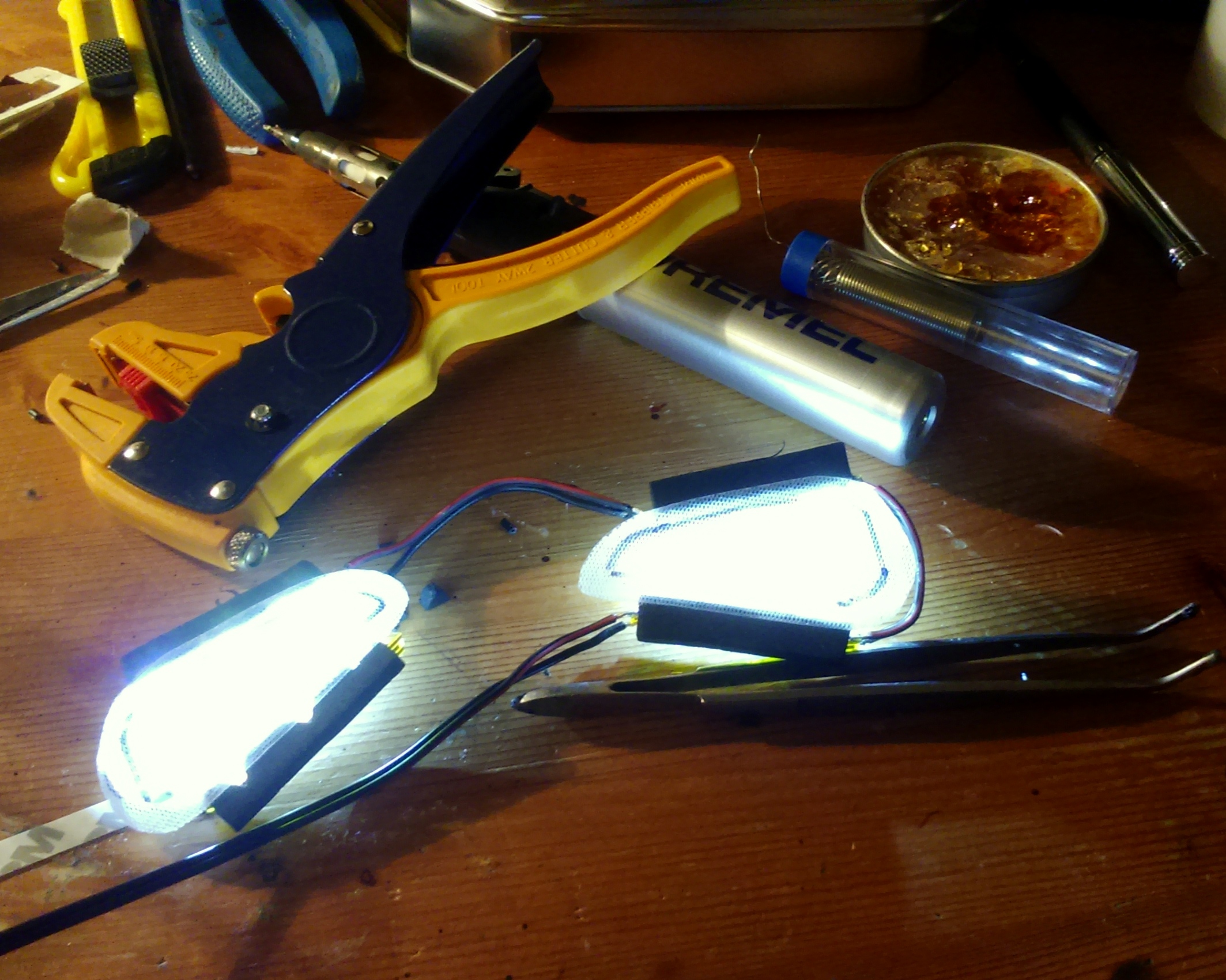

I would like to share with you my Armored Batman build.
I used eva foam 5mm for most parts. Files from Aztlan.
What do you think?
