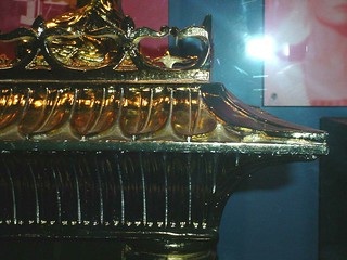

The reliefs for the PW Ark were hand sculpted so although they seem to be the absolute best available they still have some minor flaws for accuracy. There are many spots on the smaller relief that should be flatter (sky area) and are slightly bulbus.
The biggest flaw IMO is that the top leafing around the edge of the lid are supposed to extend all the way to the end of the lid but do not.
The kit was built differently that the original prop with a reinforced inner lid and box. If you want the kits interior to look exact to the film you have to do some reconfiguring to make it work.
Again, this is coming from a hardcore fan. Most people wouldn't care at all about any of this.

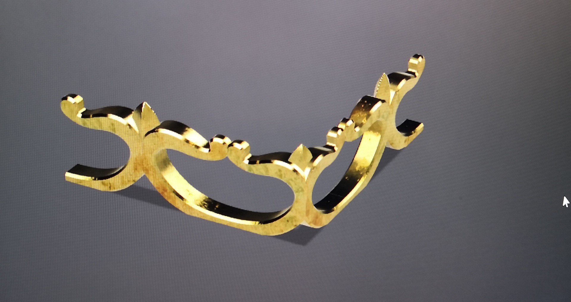

Quick update about the build. After few chats with my friend I managed to get first files for the lid decor. They are looking decent and hopefully I will manage to print them this week and mould it soon. we managed to get two different types - corner ones and side ones.
