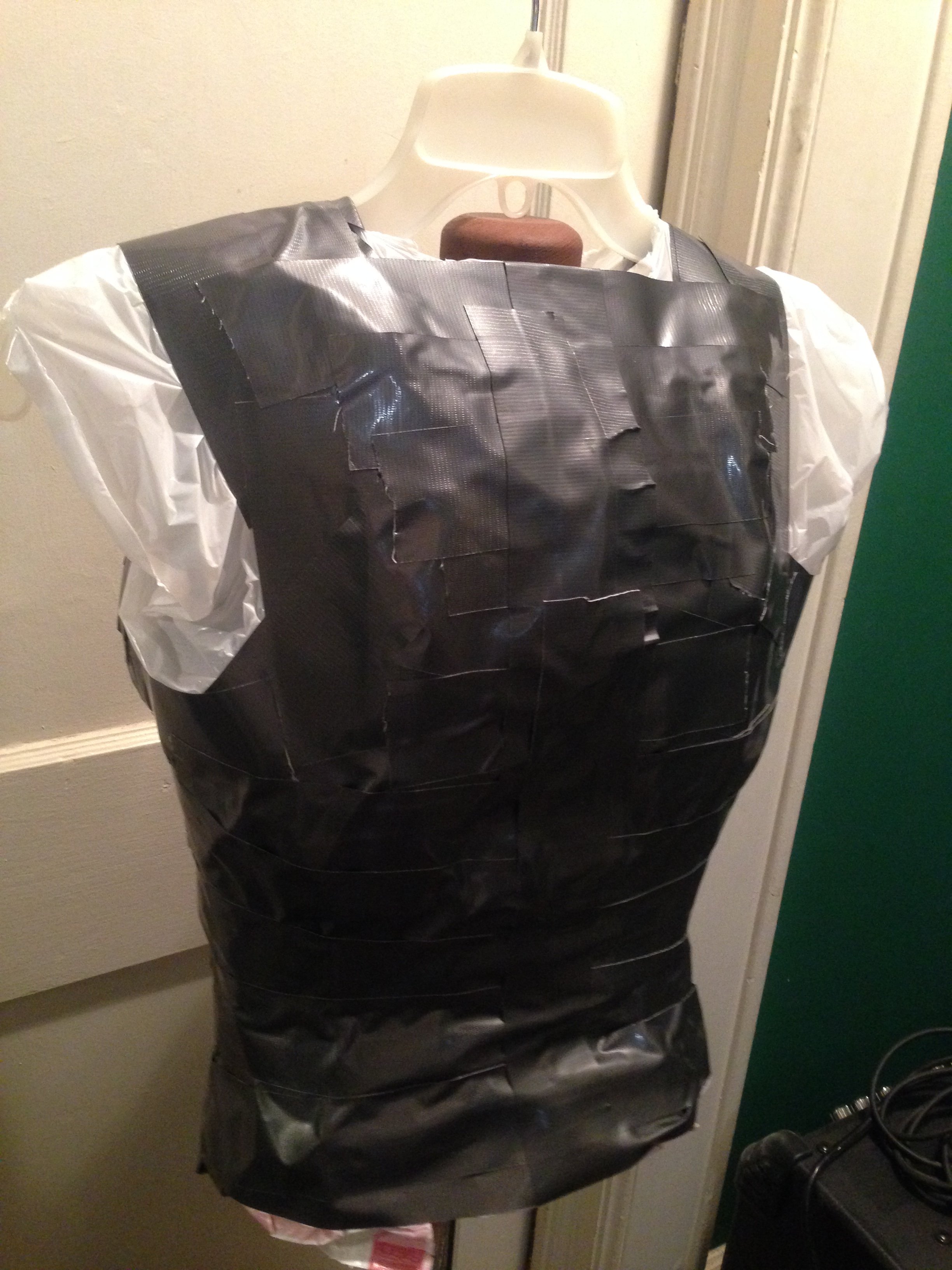

First, I stripped down and made a t-shirt / tunic out of a garbage bag. This was very simple. I made a hole in the bottom center of the bag for my head, then a hole on each of the sides starting from the corner. All of these were approximately 6 inches wide.
Next, I had my sister wrap me in duct tape. We started with a full role and ended up using about half the width of the roll. This is what I looked like:
Then, my sister cut a straight line up the spine to get me out. I then taped up the cut and had my first torso dummy!
(Can't figure out why these uploaded sideways. They're the correct orientation on my PC...)

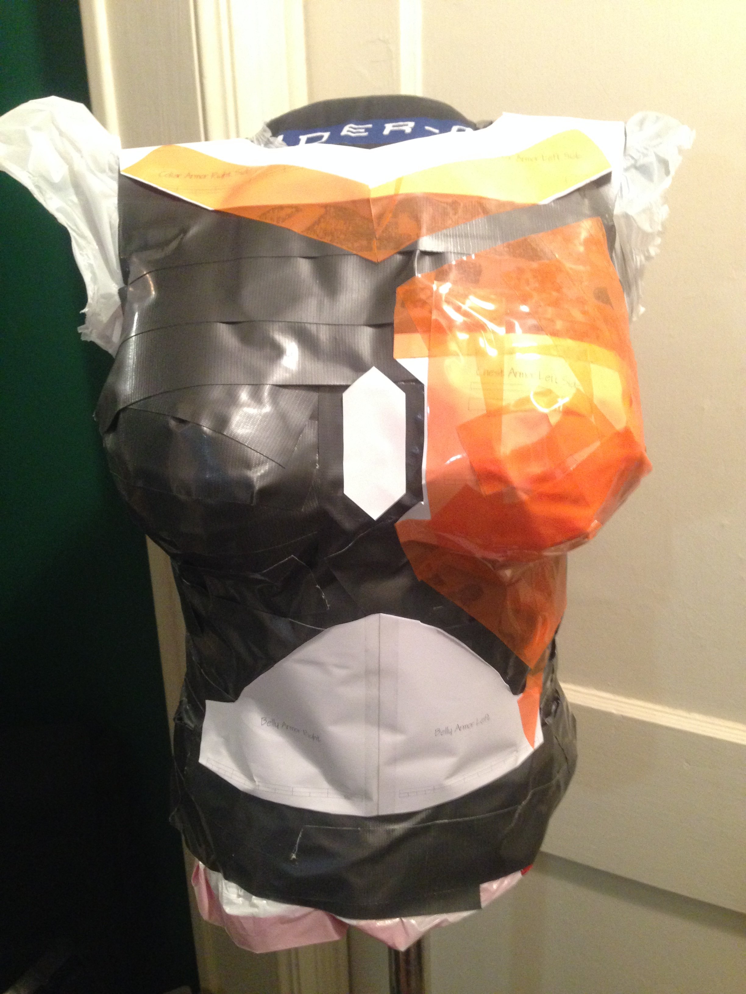

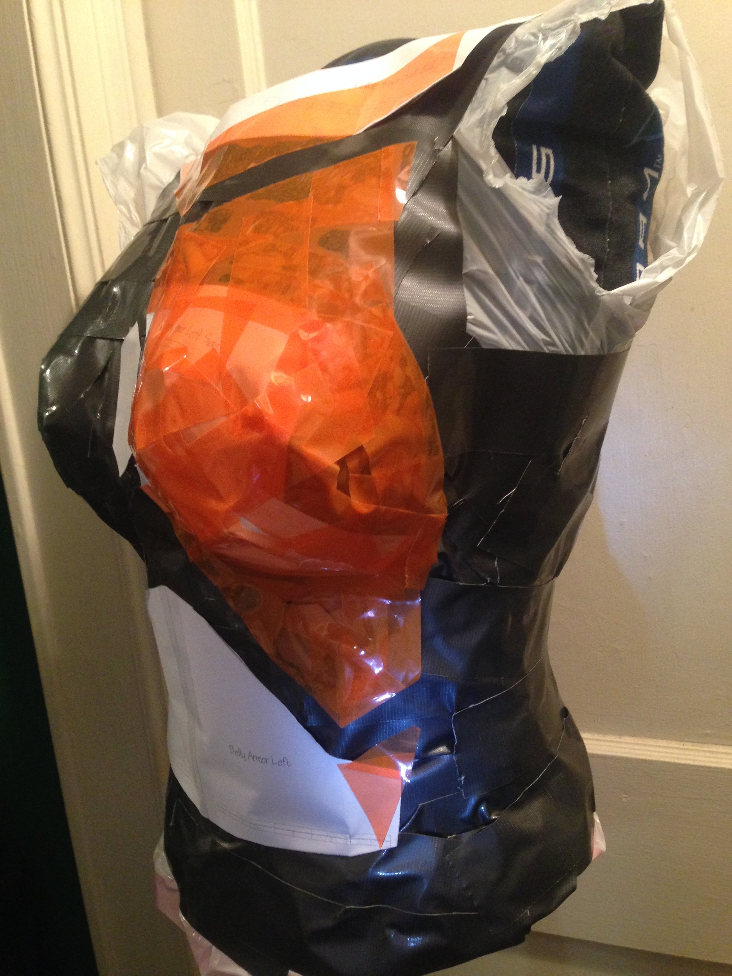

I stuffed the dummy with some pillows and mounted it on a hat stand. It some how came out to be my exact shoulder height, which was serendipitous! I printed out some of wizardofflight's Jango Fett Templates,and started experimenting with placement on the dummy. These are great, but they weren't made for people with boobs, so I had to improvise a bit. The orange tape is me trying to match the lines of the armor in the above reference photos to an actual human body. My torso isn't nearly as long as Vhonte's! And my boobs are a bit bigger.....
20150422_020759655_iOS.jpg 20150422_020708950_iOS.jpg 20150422_020908103_iOS.jpg
(Again, not sure why these uploaded the wrong way >_<)

Oh that reminds me, I should probably share legit advice! A few things: 1) the paper templates suuuuck for mockups on women as you discovered. It's pretty much impossible to size your chest pieces correctly from paper. My mando armor is metal so the advice I got from Mandalore was cut the chest a bit bigger, shape it, then trim it. Not sure what material you're using but I imagine the same method would work for sintra or whatnot. That method seemed really simple and effective! Though I had to have Mandalore hammer out my chest plates, complex curves + metal were beyond me. Heating up plastic and molding it onto a form would be a billion times easier. 2) speaking of curves.. mercs must wear flak vests, now this character doesn't seem to have one canonically, just like Sabine from Rebels, so if they recognize her you may luck out and not need to wear one at all! But they really seem to hide some things. I'm a 34 D and with the flak vest pushing down and the subtle curve in my armor to fit it properly & flush, people confuse me for a guy. If you wind up having to wear one you may wind up with some empty space but so long as you have some solid attachment points for the chest piece it shouldn't be too much of an issue. 3) Typically you'd want to go with a one-piece flight suit but consider modding some scrubs. You'll be glad you did when you've been in the costume 4 hours and you really need to use the restroom.

Thanks for the advice! It's great to hear from someone with similar body shape debacles. I'm a 34D as well. I think I'm definitely going to give the vacuum forming idea a try with sintra / expanded PVC. XRobots from TDH has a great video tutorial that he posted in this thread:
http://www.thedentedhelmet.com/showthread.php?t=42798&p=552212&viewfull=1#post552212
It's an easy enough project and best part is I probably won't need to buy much for the construction.
I like the idea of the flak vest because I think it would be easier to mount the armor pieces and get in and out of costume with it, so I may try doing a subtle sleeveless version. Scrubs are a good idea too!

Something like this is also something I see used. You'd still have the shoulders and so forth to do, but this can be broken up into all the front-of-torso stuff, including the groin armor. Some grinding and filling would be necessary. I know you've got access to a lot of costume-piece-fabricating gear. Tossing it in as an option.
As for the flak vest... Enh. The clearest images of her show she is definitely not wearing one between armor plates and flight suit. I'd suggest rubber grommets and plastic screw posts for actually attaching the armor. The post part of the screws gets epoxied to the inside of the plates and, once you've got everything sited on a "waster" flight suit pattern-test garment, you glue in the rubber grommets in their respective spots on the finished piece and you only ever have to take the plates off when you clean the flight suit.
For fit and shaping, one option is you can run cotton webbing or elastic either: through slits in the flightsuit from backs of he armor pieces near the side edges; from the front shaping/princess seams; both, to 1) keep the whole thing riding where it should, and 2) hold the flightsuit snug to your shape without having to be made of a stretch material. A quick glance at your blog shows you've got the tailoring chops to get it fitted right. A long hidden back zip in the flightsuit, and two low-profile-buckle straps in the back for the inner rig/harness/whatever -- hips (groin plate) and above the waist (kind of like a bra strap except for the rest of the upper-torso plates). I'm basing this on how the Deep Space Nine/Voyager Starfleet uniform jumpsuits were put together. Tailoring to get it so it fits like a glove when it's riding where it should, and elastic at strategic points to make sure it does ride where it should.

The mannequins are a pain if they don't fit just right since they don't change shape well to adjust. (I know from failed attempts in the past)
There is actually a shop that makes female forms for us female mandos. I bought mine from him and have been quite happy with it. Since it is vac formed, it will adjust easily with just a little heat from the heat gun. He uses HIPS to make the forms. I can pm you his page address if you are interested in checking it out.
Yeah, it can be hit-or-miss. If you've got something close to the right shape -- and the OP seems she might -- it can make for a lot less work. You have the leeway of cutting into the rough section and adjusting positioning before trimming to size, so even if it's not an exact fit out of the box, only fairly minor work is needed to get to the point of finishing work. If it works, you've saved many hours of work. If it doesn't you're out twenty bucks and are no worse off. *shrug*
