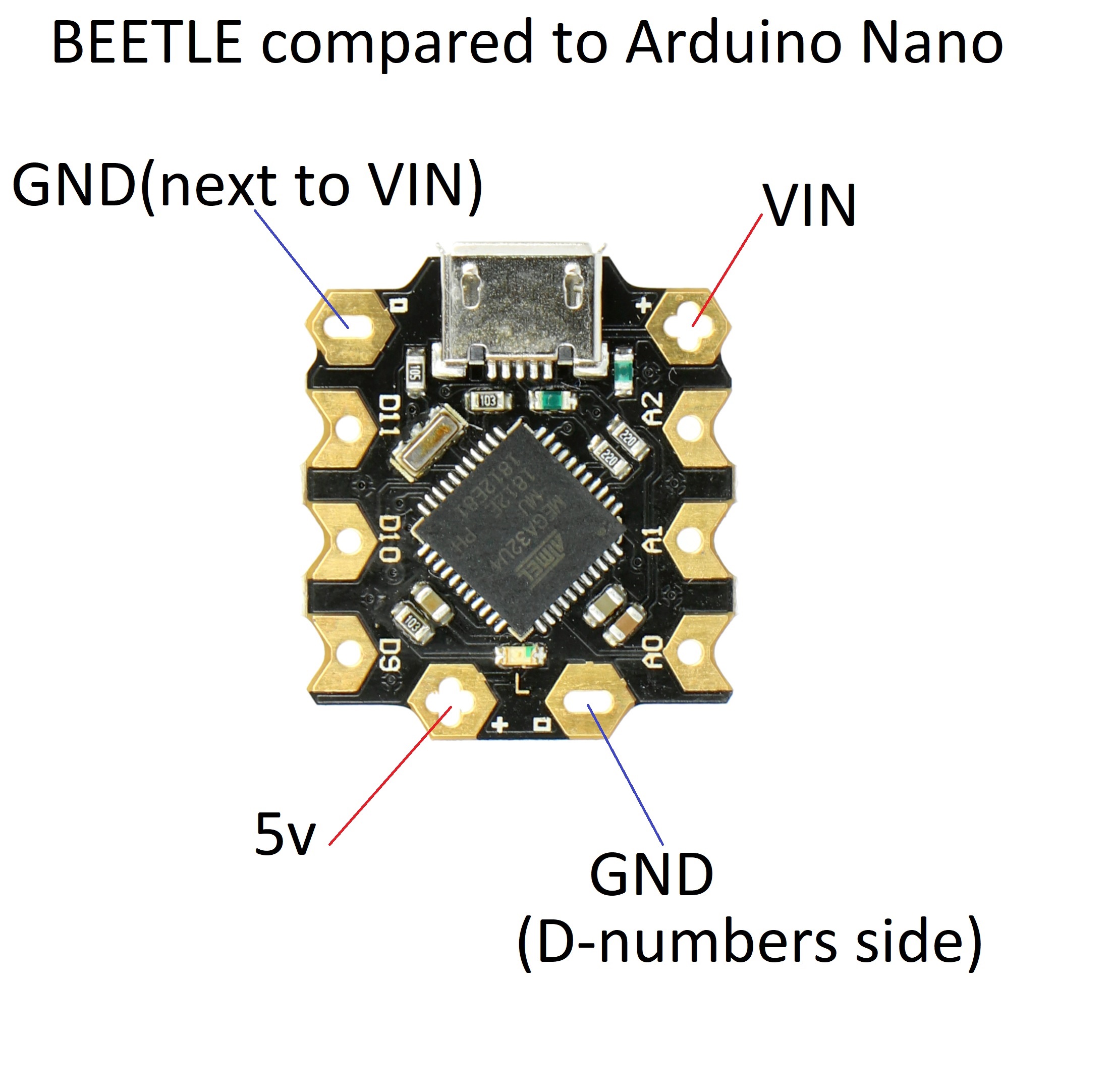

I looked at the datasheet on the beetle. I've fixed the code so it will work. I changed some pin numbers to make it work with the beetle. I do not have a beetle, so I can't test this new code. Please note, the beetle needs to be run on +4.5 to+5V, it won't run on anything else. +6V will damage the processor. Let me know how it works on the beetle, I'm really curious. I might want to try the beetle for a few projects myself!!
DEVICE BEETLE PIN
LED1 A0
LED2 D9
LED3 D10
LED4 D11
Switch A1
  • LimeyBuilds_Beetle_Sketch.zip

I couldn't wait. Worked first time! You're a genius.

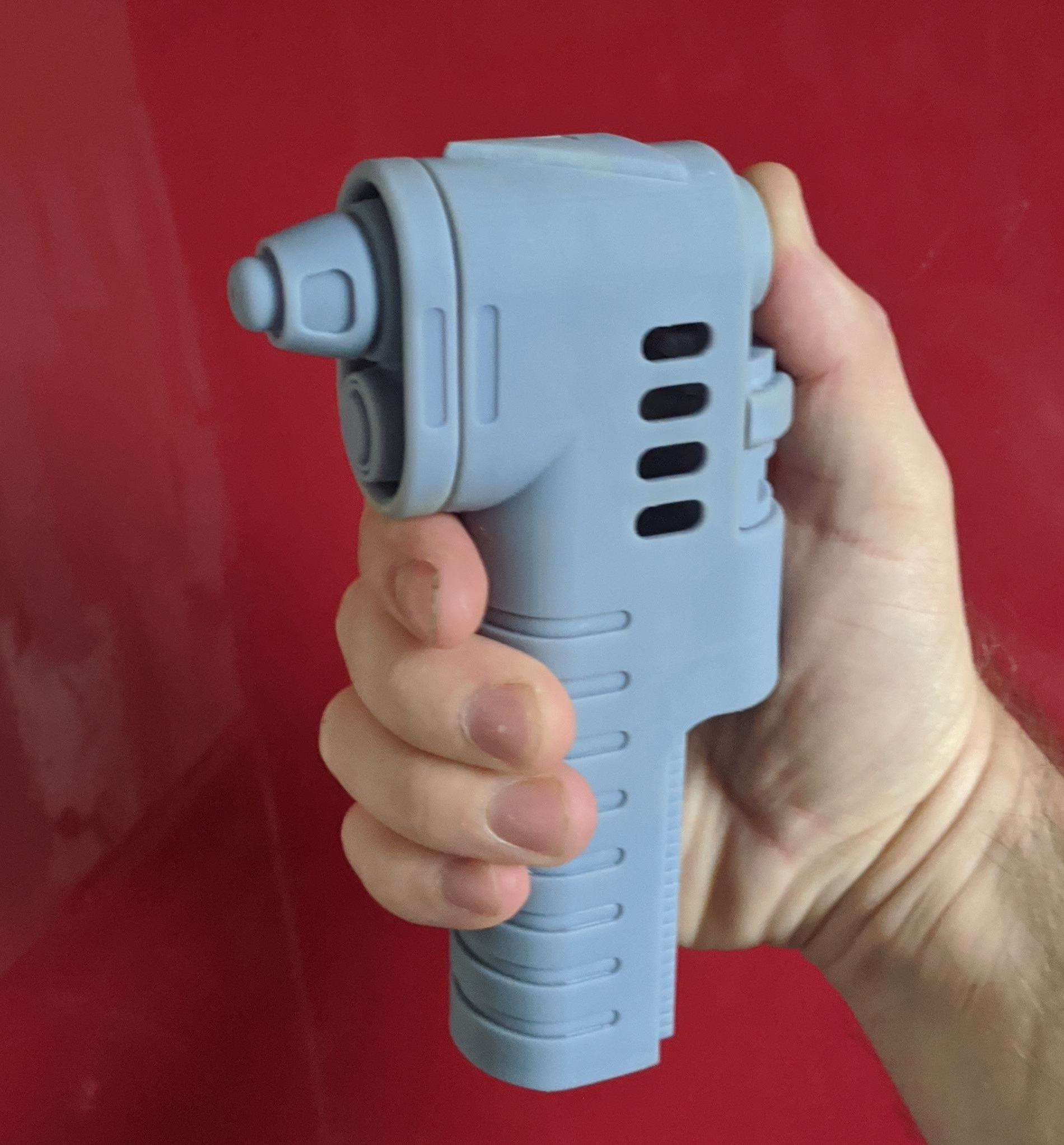

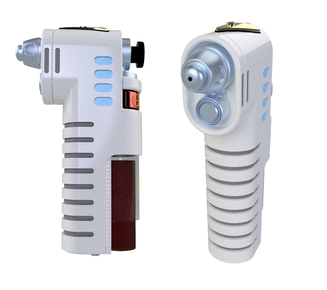

The SNW medical Hypo:
