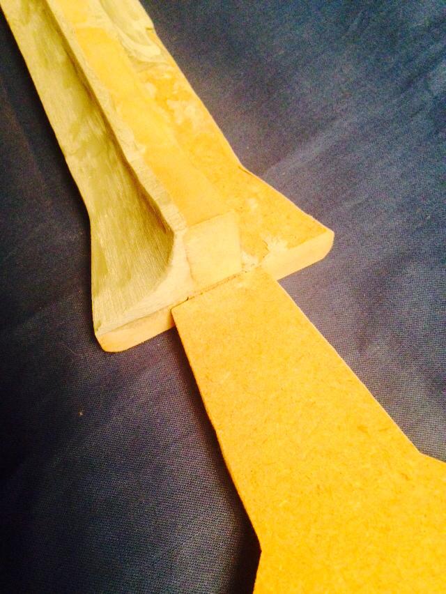

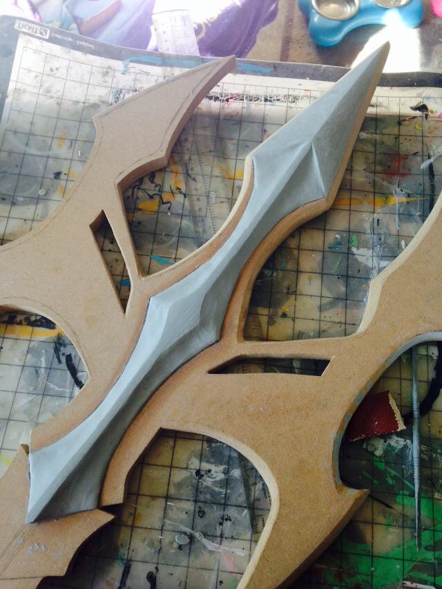

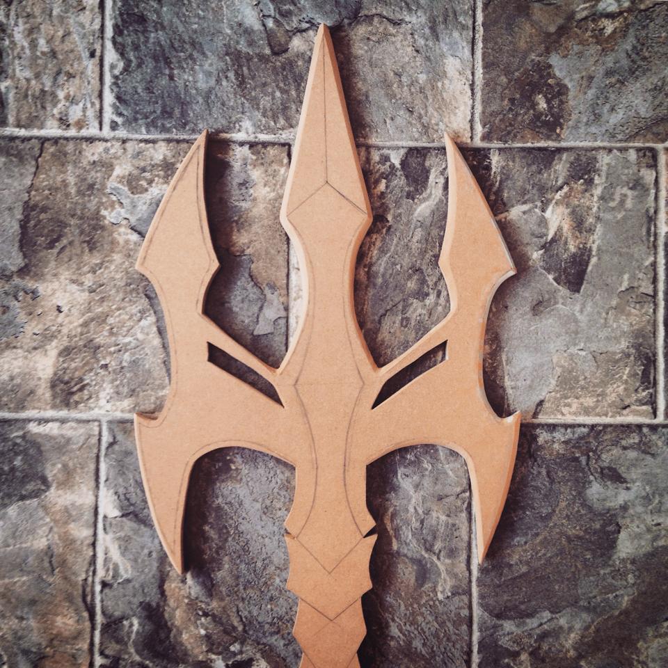

Working on an Aquaman trident right now, (not the new Jason Momoa one) but probably one of my favourite trident designs from DC's Injustice Gods Among Us videogame. It's awesome and proving to be a real challenge which I always love.
Not sure how to get full sized images on here yet, so please bear with me, but here are some build photos so far.

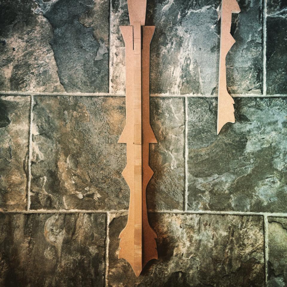

I'm building the master out of MDF with apoxie sculpt detail, and once I've figured out the 3 joints (it's over 6ft 1" in height!) I will finish the detail, sand it all to within an inch of it's life and then mold it with silicone for casting kits.

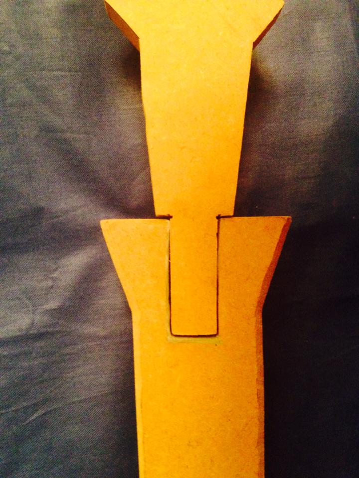

Would love to hear what people think- and also an ideas for the joints! There are temporary mortice and tenon joints at the minute, but i think i'm going to replace it with some kind of screw joint..
