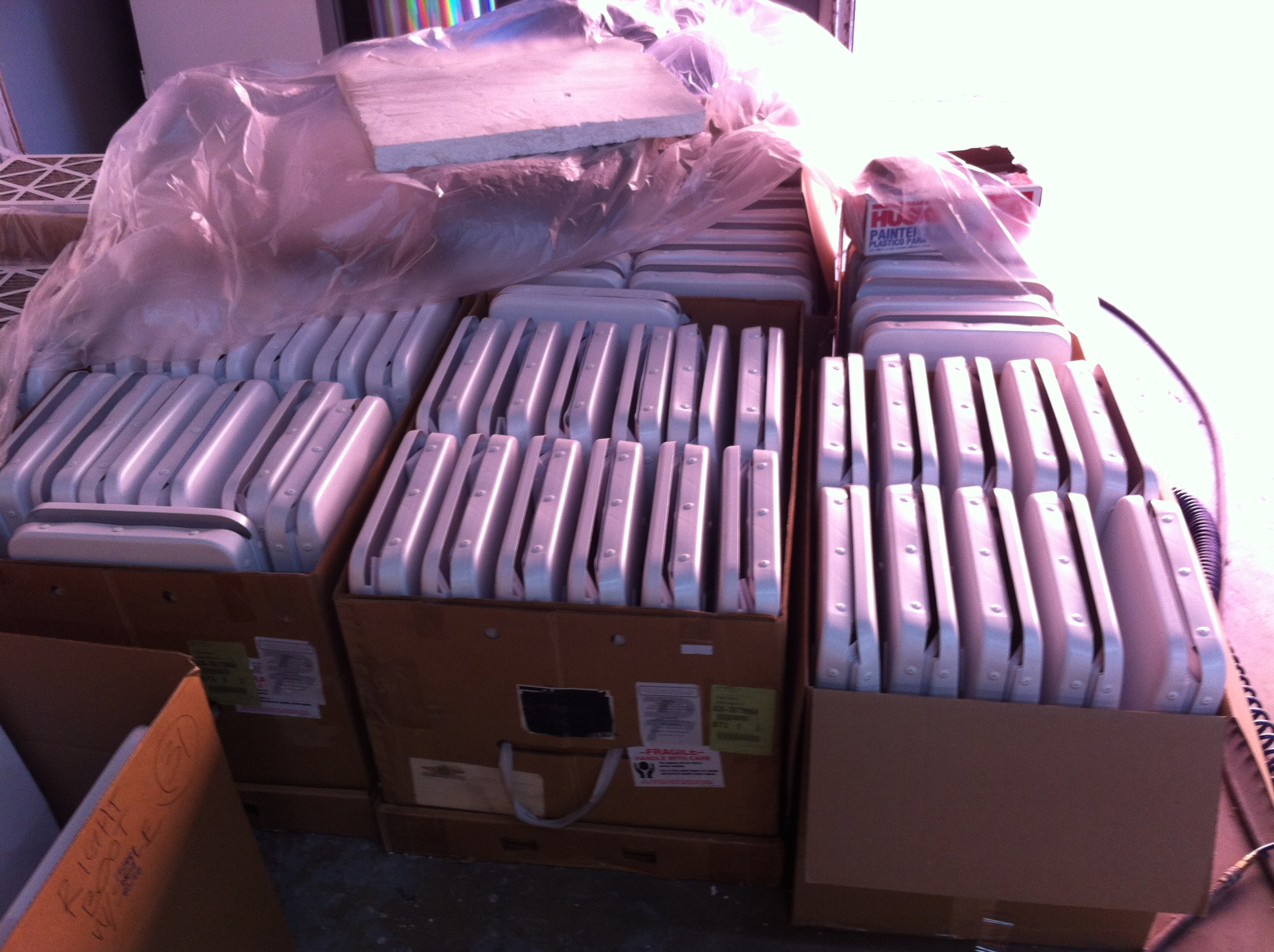

We designed special collapsible PLSS (Backpack) since these were shipping all over the world and this shipping cost was huge.

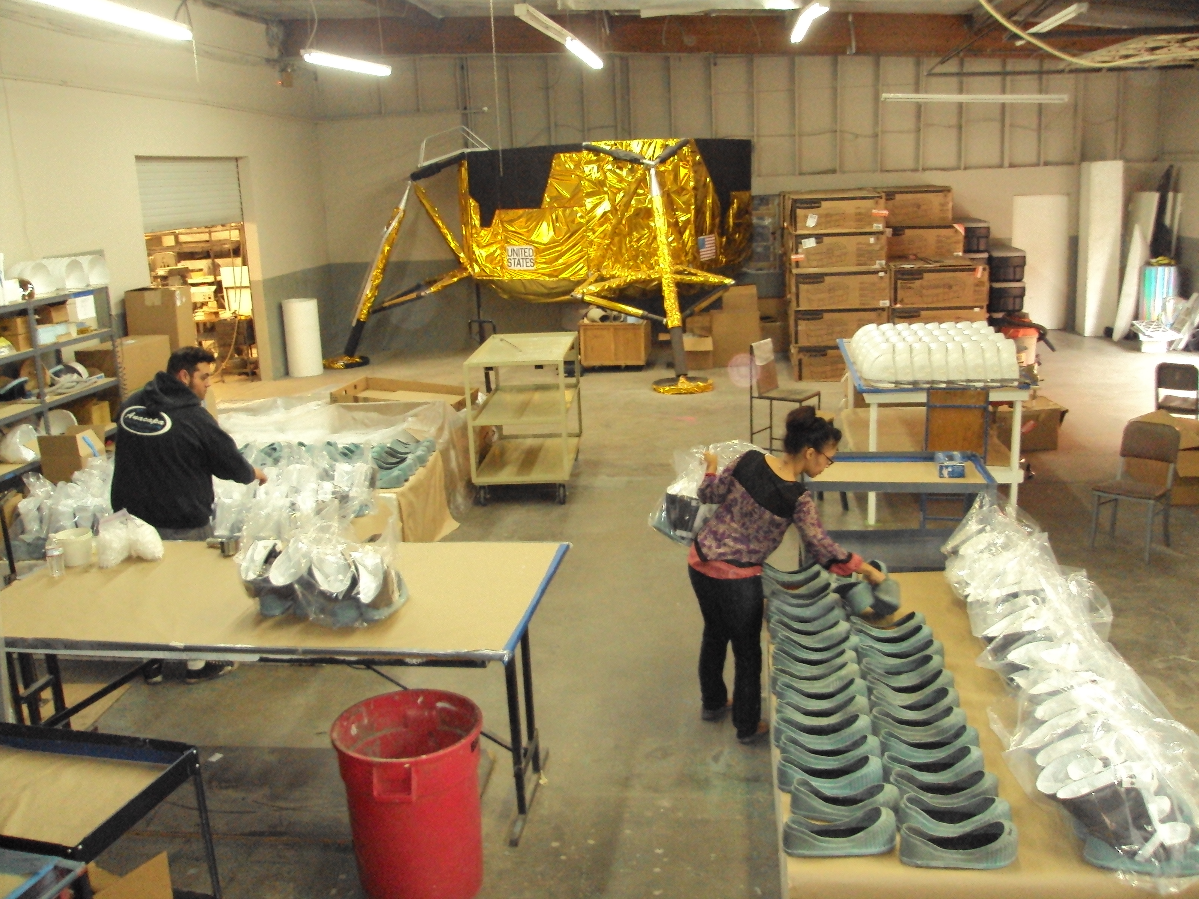

That's our partial full scale LM replica we made for Ron Howards office in "Arrested Development".

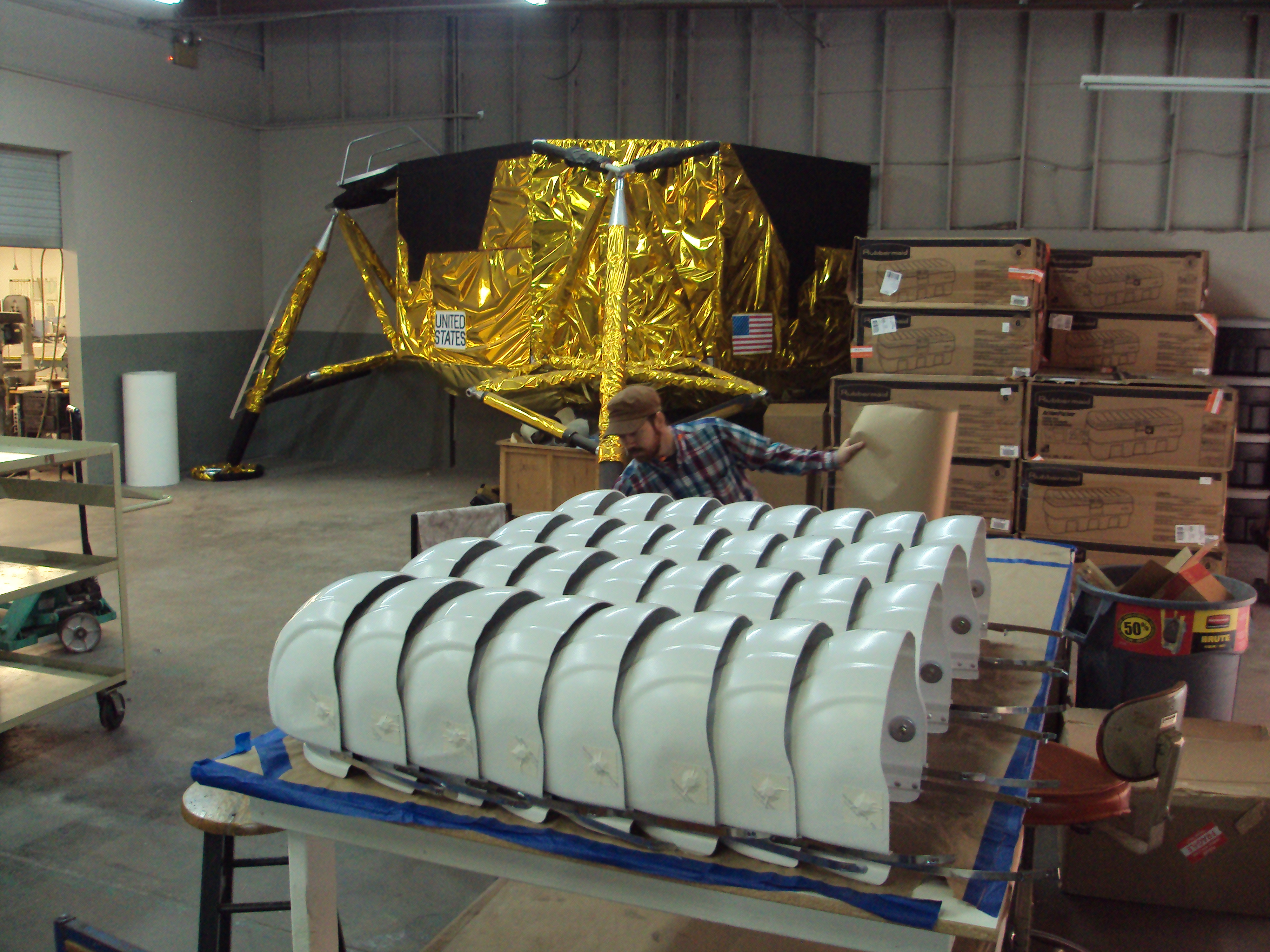

The LEVVA shells are actually Shuttle EMU shells. We used these to simplify the whole helmet system, since we only needed the gold sun visor and an integrated fan system. The Shuttle EVA shells have a front piece, in addition the the back shell, these are thermo-formed at the same time, with 2 complete helmets formed on the machine at a time. The "AA' powered fan system is made of it's own thermo-formed sub-assembly and screwed in place.

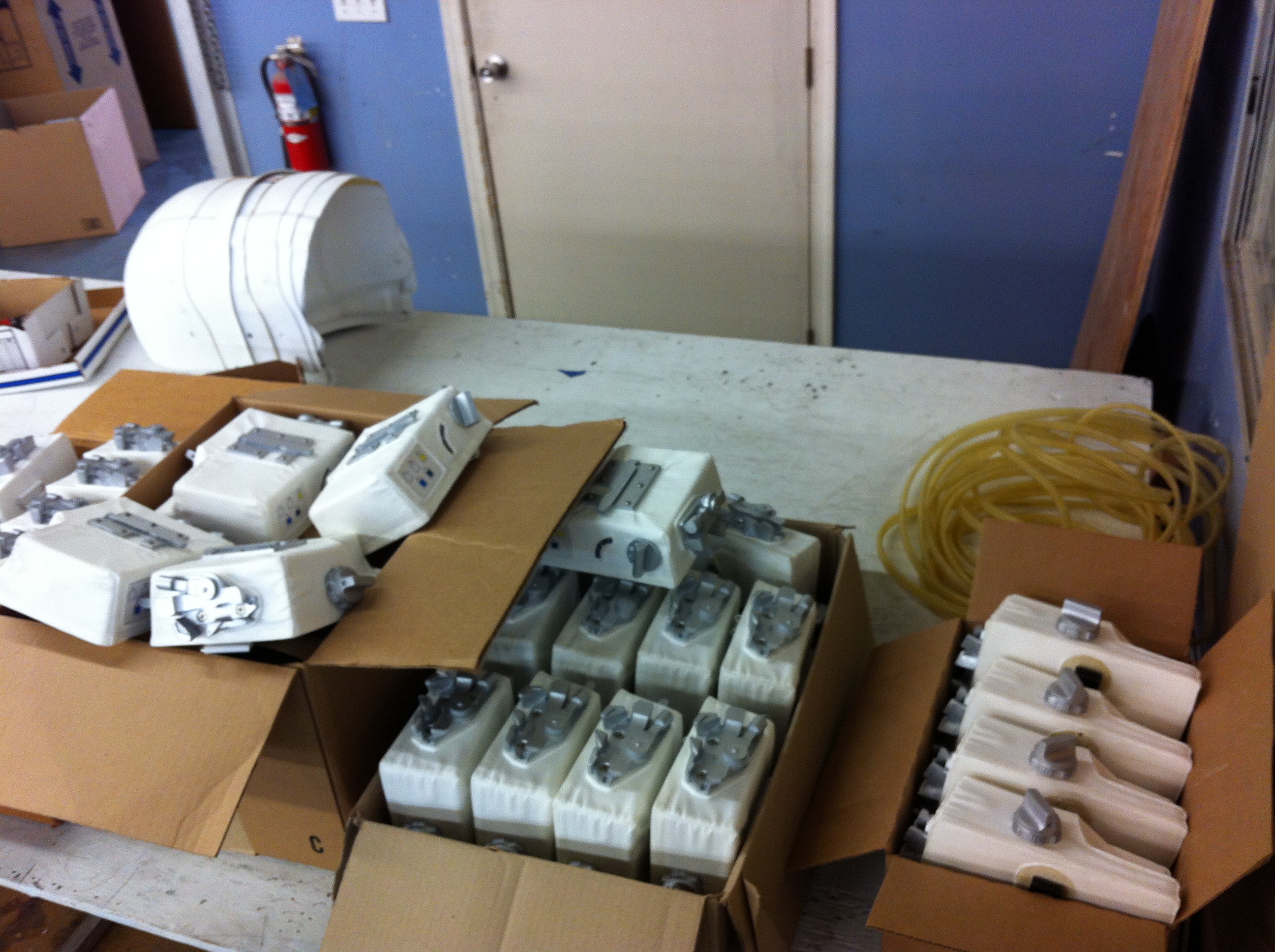

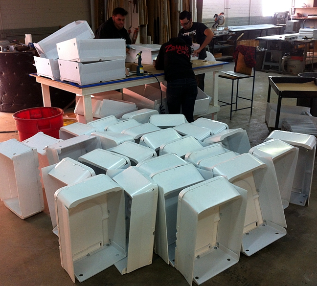

To get the detail the client wanted but to keep the price down, the RCU (chest box) was silicone molded from a complete fabric covered unit and then the production ones where roto-cast as a nearly finished units.

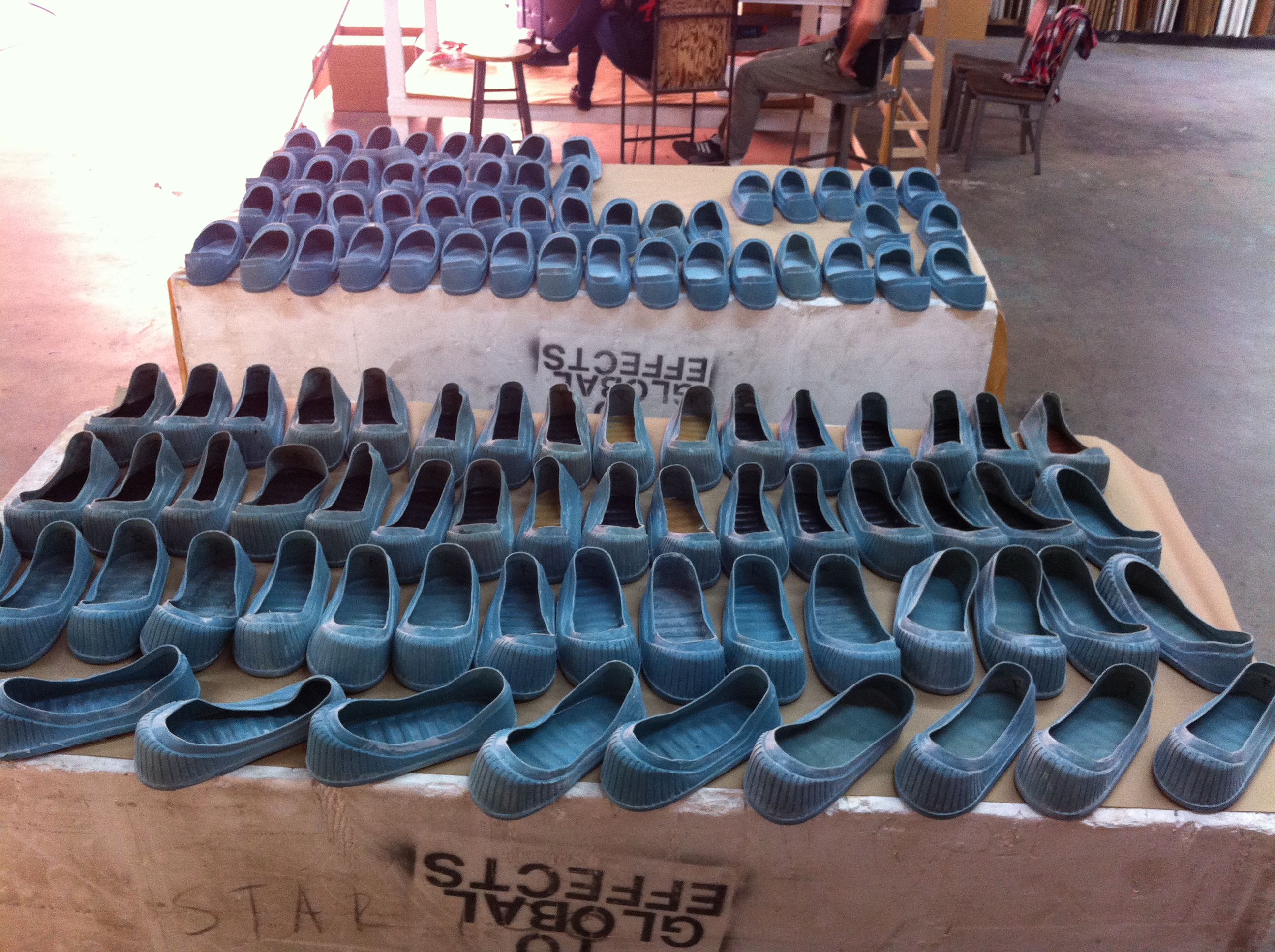

LEVA over boots were cast in latex

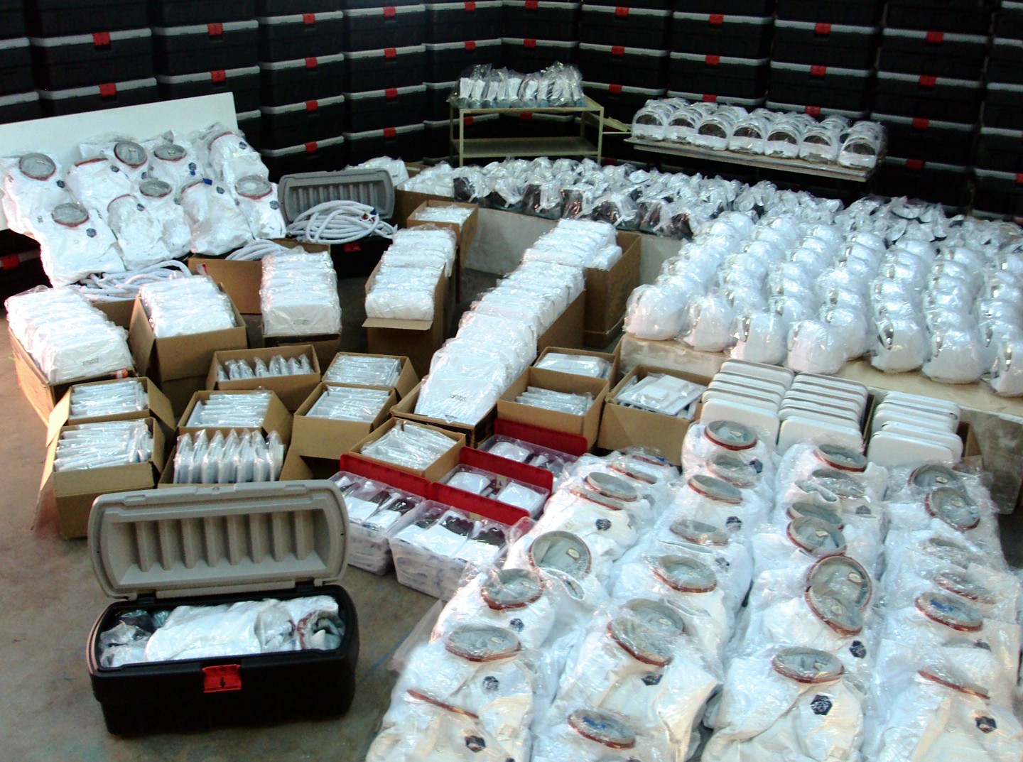

Here is the first shipment, with their cases (in back)
