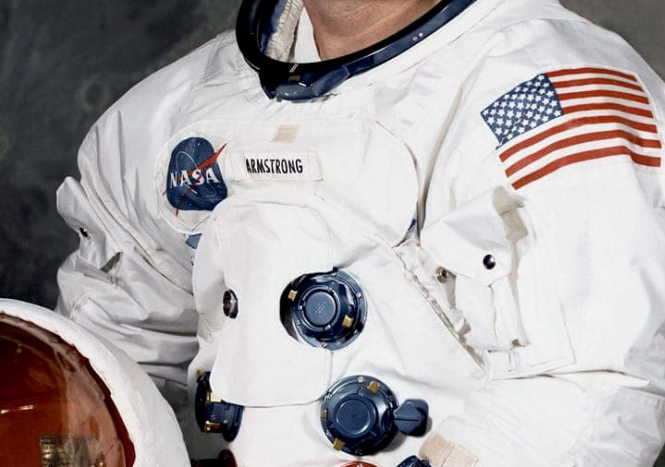

Can't say thanks enough Ken. I have my wife working on getting a suitable sewing machine. I'm still on the fence whether to buy a 3D printer or just source that out. My first piece comes Monday so I can at least see what I can expect quality wise form a local guy. Fingers crossed. But I'm on my way! Ive made a list of tools and materials and can't wait to see progress. While looking at your suit templates and research photos I came across this shot of Neil. Its not the landing suit as his neck ring is blue and nothing looks right. Pockets and fastners etc... But what I do see that didnt add up till now is the cover that goes over the front. Am I right? Is that what the velcro on the chest is all about? Is there a piece we don't see in the Smithsonian pics of a piece of fabric that would fasten atop all this gear??
Hi James,
Yes, there is reference in manuals etc of a cover of sorts. To my knowledge it was never flown and the velcro and snaps are vestigial like an appendix.
