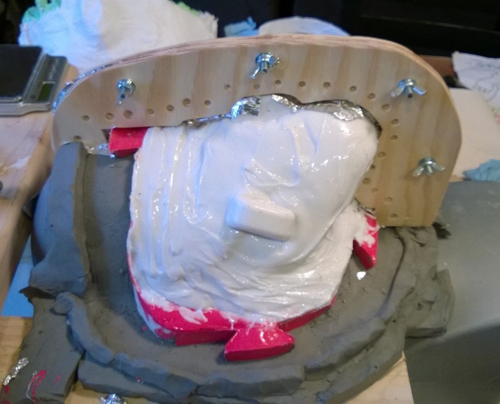

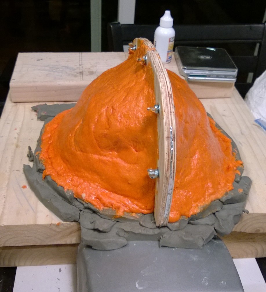

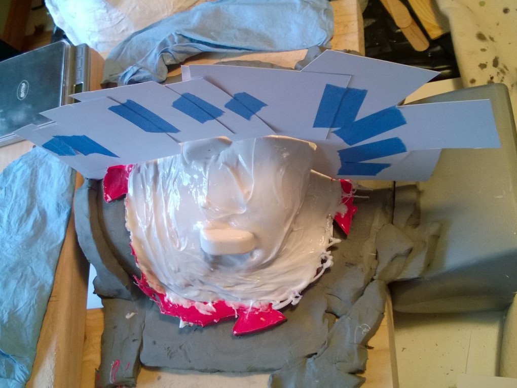

I tried out a new technique with the 2-piece support shell, by creating the dividing line with 2 pieces of plywood, bolted together beforehand. This worked out exceptionally well! Plastipaste II was used for the shell, and sticks to the plywood very well (I drilled some shallow holes in it to help with adhesion).
Card stock used to get the profile of the mold, which was then transferred to plywood, and cut out.
The aluminum foil wound up being unnecessary. It was my first thought for closing the gap, but didn't work right. I wound up putting a bead of hot glue along both sides, to close up the gaps. Why orange? No reason.
