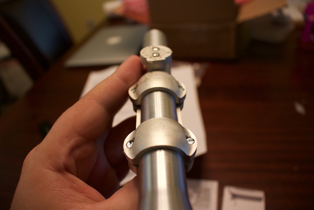

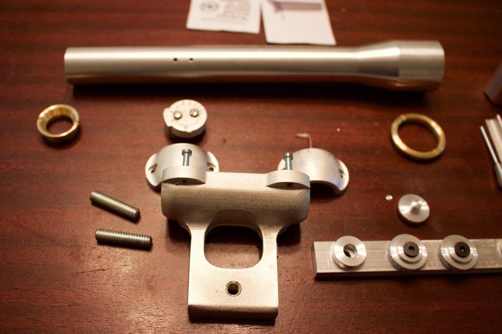

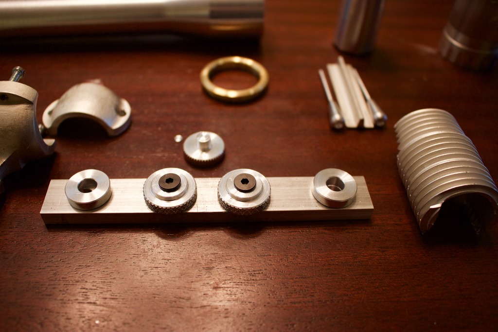

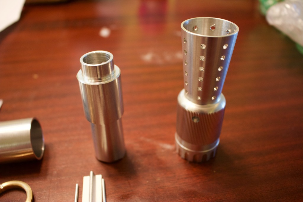

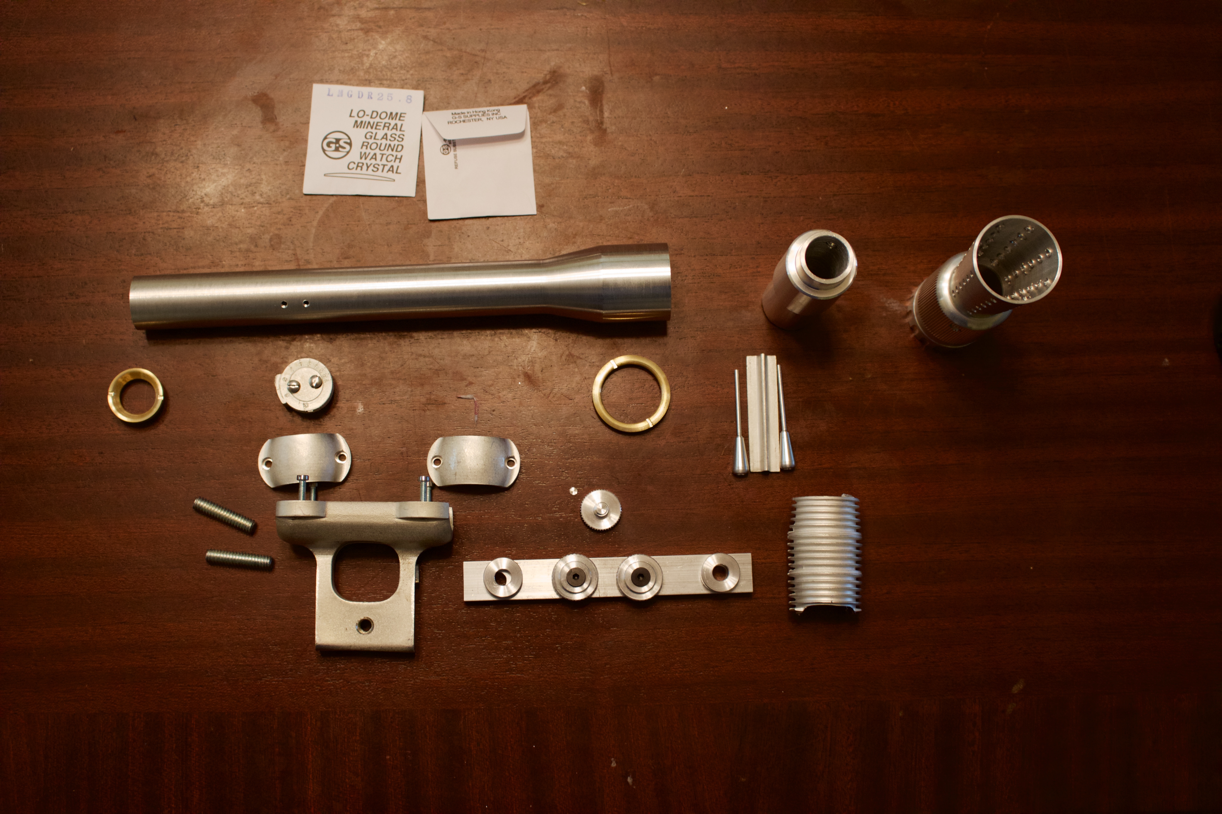

So here is where we stand. The kit has been unboxed and all my parts are laid out on my table for another inspection and I really couldn't be happier with how everything arrived.

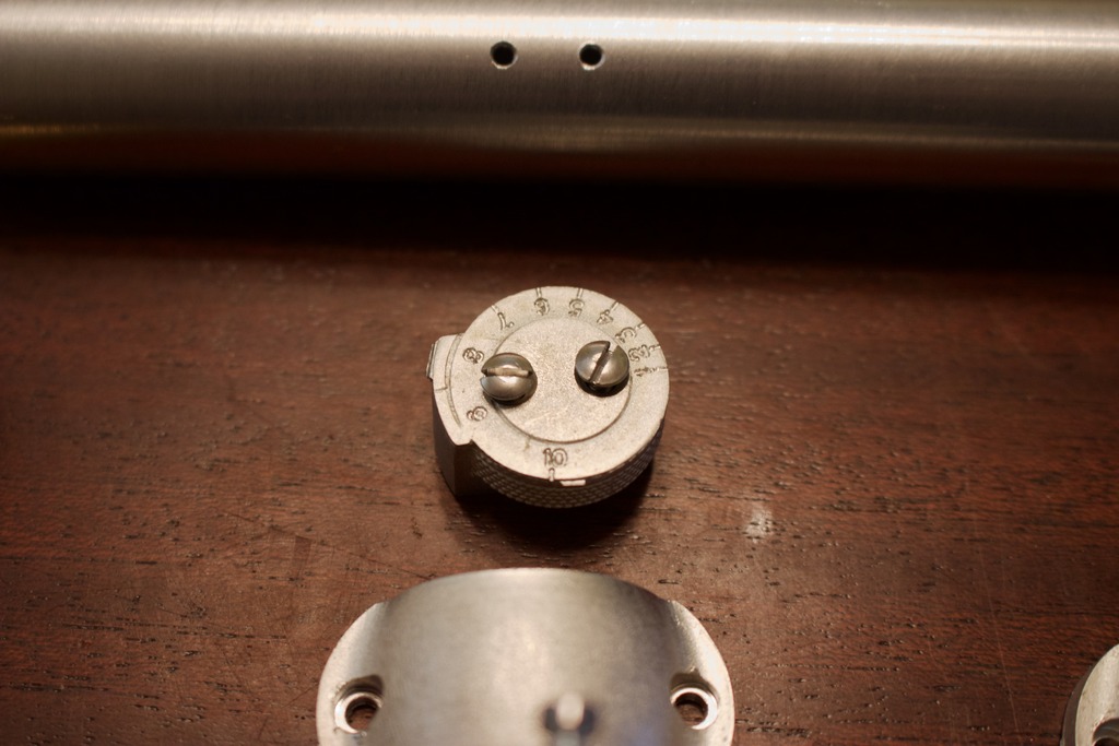

All of the parts and astounding. The pewter casts are almost perfect.

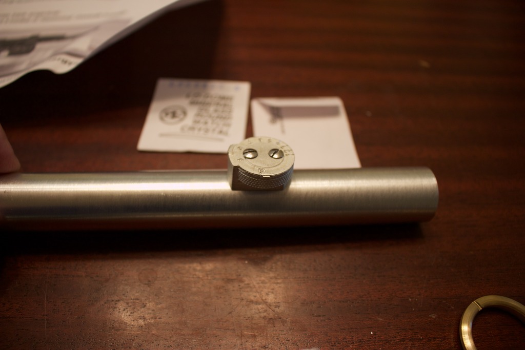

I was slightly saddened to see that the top knob (above) is a solid cast piece and not moveable but realistically... when am I ever going to do that?!

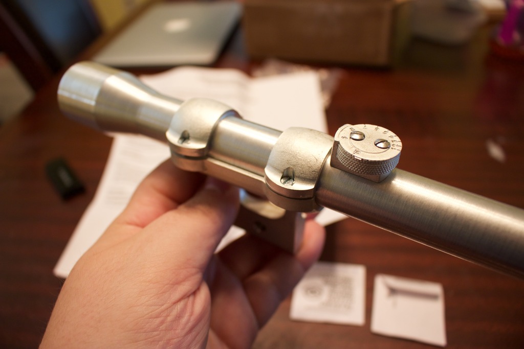

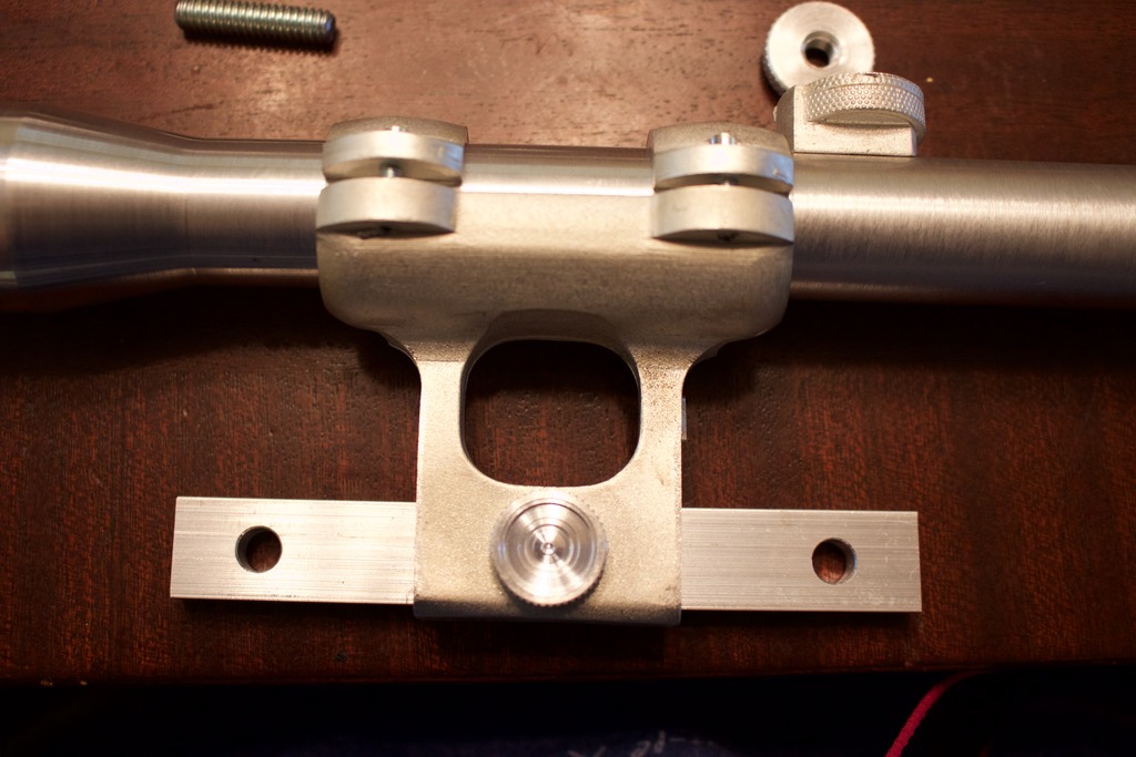

I grabbed my jewelers screwdriver kit and got to dry-fitting the pieces. So far, everything fit with little to no work.
So that is it for now. I lost the M5 screw that holds the Flash Hider to the Bull barrel assembly. Need to get myself some wet/dry sandpaper and go to town on the pewter casts and make sure everything is as smoother as absolutely possible before adding any kind finish. The instructions included in the kit say the Mount, Caps, Grill, Track, and Scope Knob are all pewter and the rest are aluminum (Scope, Flash Hider, Bull Barrel, Sights) So I'll be picking up wither some Pewter Black or Super Blue for the pewter parts and some Aluminum Black for everything else. I don't have my Mauser yet as I am waiting for Boba Debts run of accursed Mauser's. This is probably going to be a very slow process, but I am more than excited to get it going. Any insight from those who have built these or any general knowledge that I might find useful is MORE than appreciated!!

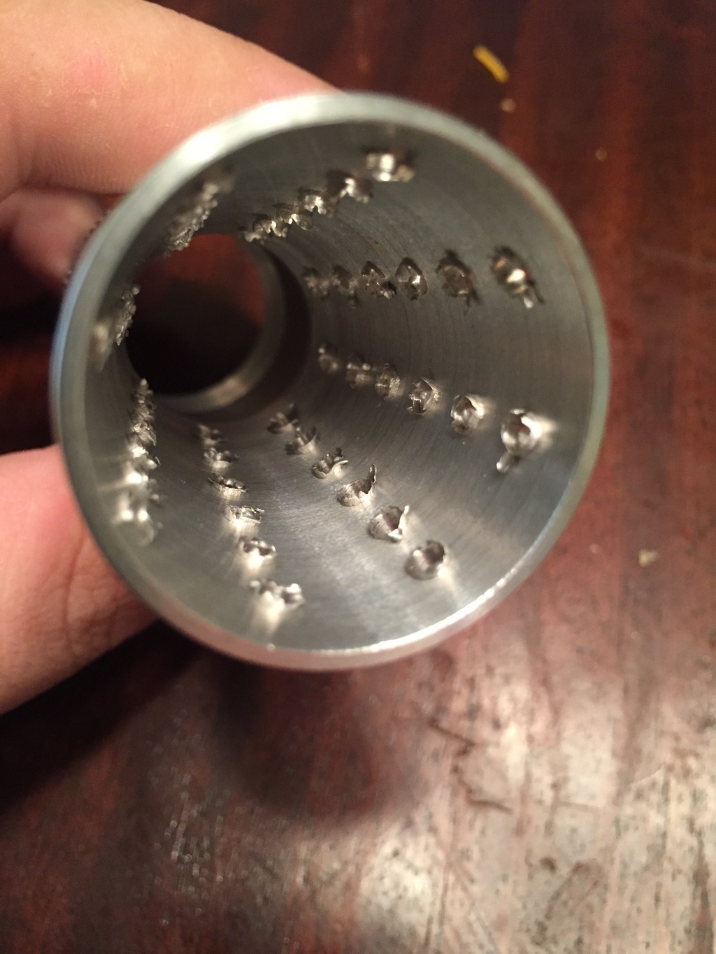

My goal for today was to at least get the bull barrel and flash hider blackened, if I got to any of the other parts then great but the Flash hider and bull barrel were a must. So First I had to de-burr the holes on the inside of the flash hider. Used a simple file and then some sand paper.
Before:
After:

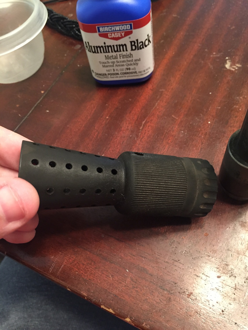

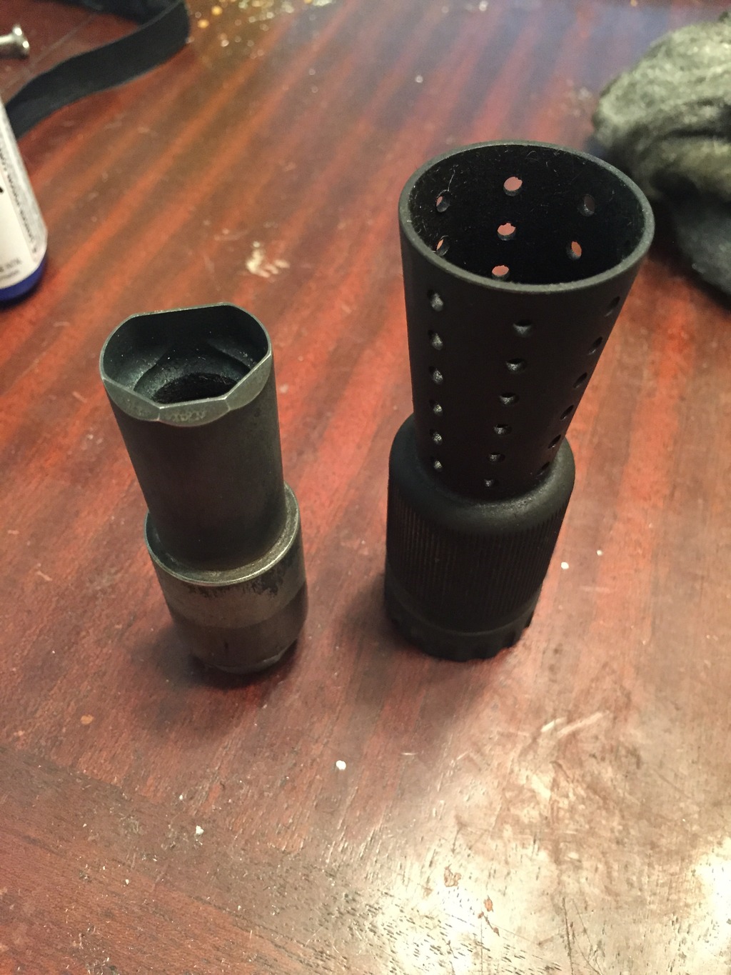

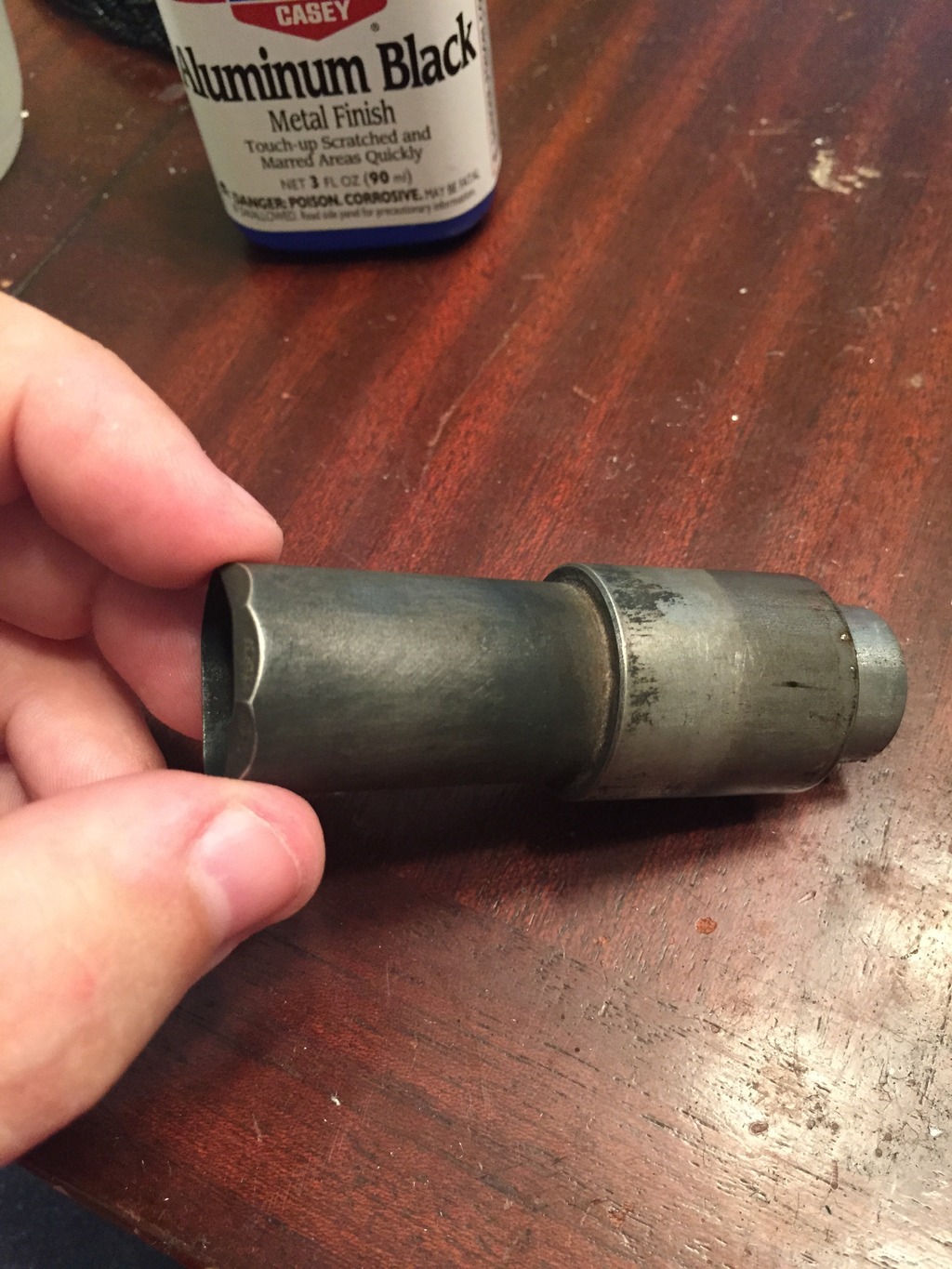

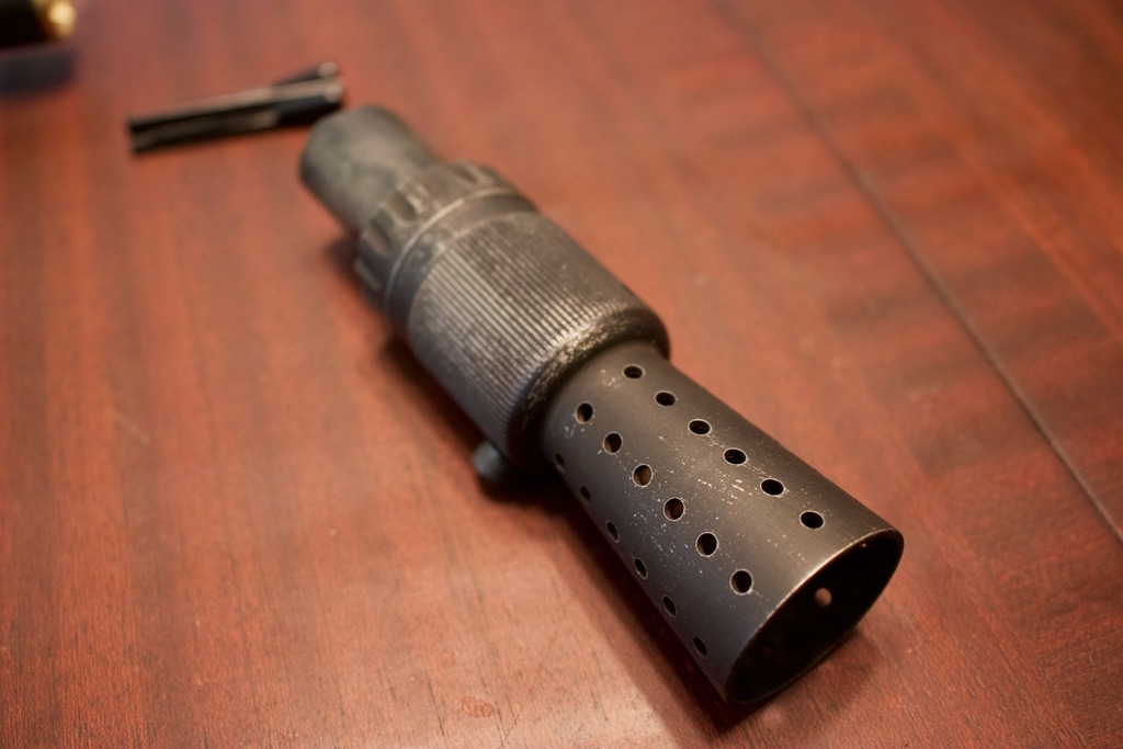

Then I gathered my supplies. The back of the Aluminum Black bottle says to clean with Denatured Alcohol and then water... so I grabbed a smaller thing of water and some denatured alcohol and got to work.
I have blued gun parts before and always used the wipe on method: Using a rag or dipper into the bluing solution and rubbing it onto hot metal. That didn't work very well with the blackening solution so I went with the tried and true zip-lock wash method. Here is something worth mentioning: Either wear a mask or do it outside. The blackening solution greatest a gas that will burn the inside of your nose and throat... nothing BAD, the same kind of uncomfortable burn if you accidentally snort some pool water... oh and the part gets warm during the process. After 3 or 4 dips in the bath and using steel wool to buff it a bit, I was very happy with my results:
I rubbed off more of the surface color on the barrel than I did the flash hider, but I like the way they look.
Bull Barrel:
Flash Hider:
As I was sitting at my table starting to work on the scope mount, I kept looking at the flash hider and noticing it was starting to rust! Grabbed my steel wool and carted off the rust and it hit me I forgot to oil/wax the parts so this doesn't happen. Well, I didn't have any WD-40 on me but I DID have a can of boiled Linseed Oil. Done and Done.

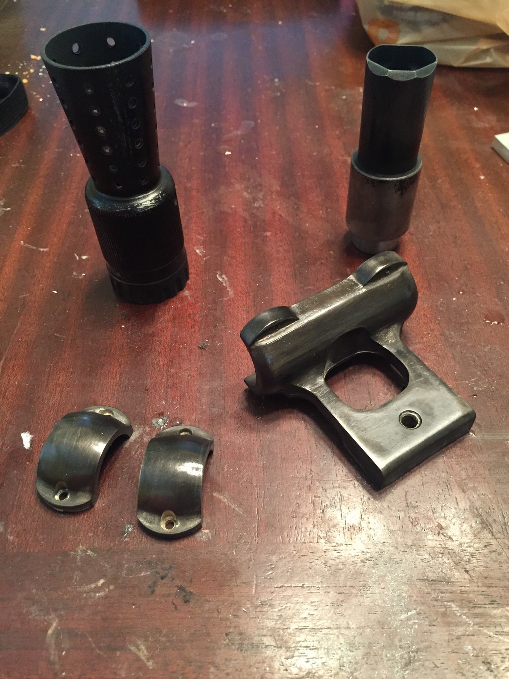

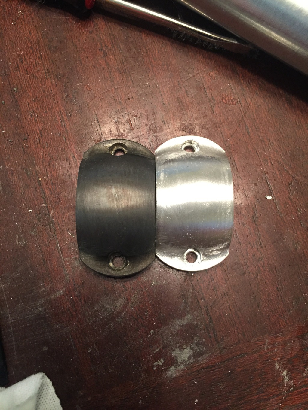

I got the scope mount and rings sanded down with 400 grit sandpaper and again, cleaned them up with denatured alcohol. I used Birchwood Casey Super Blue for this process, again going with the zip-lock bag wash technique.
Blued vs. polished:
The super blue worked like a charm! I freaked out a bit initially because when I first pulled the scope ring out, it was totally brown and rusted, but after a dip in water, a paper town took the surface rust off to reveal a nice black underneath. This process was much cleaner and easier than the aluminum black process. I am very very very happy with the results!!

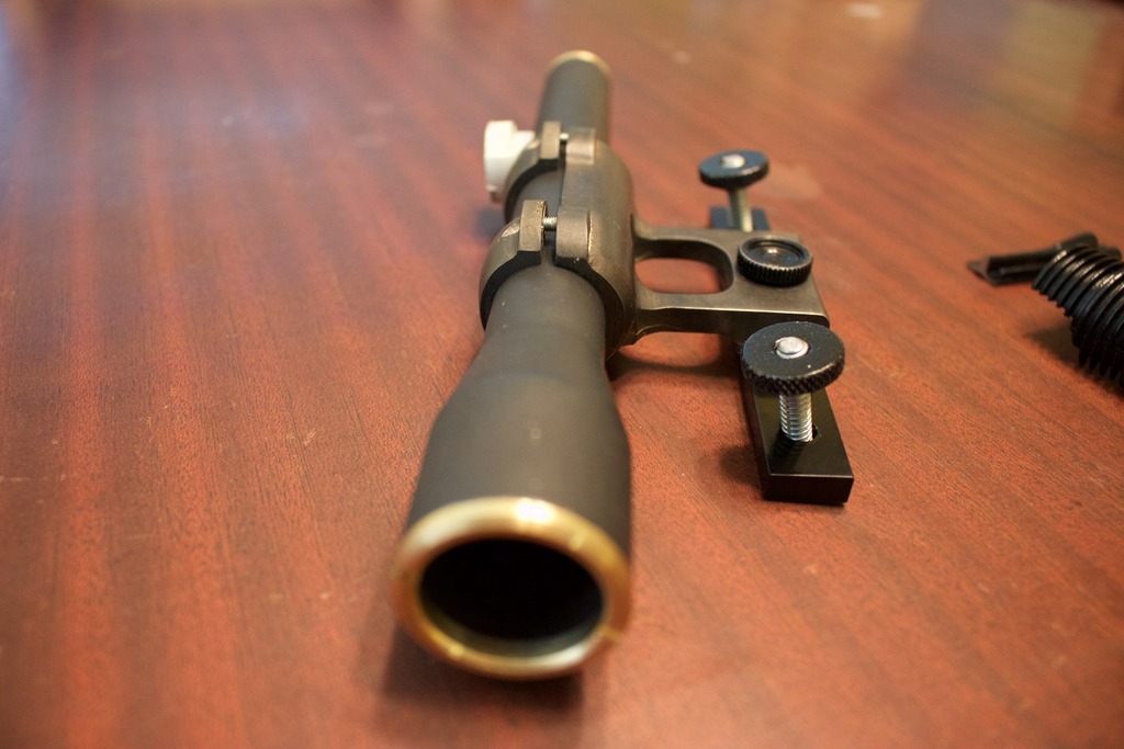

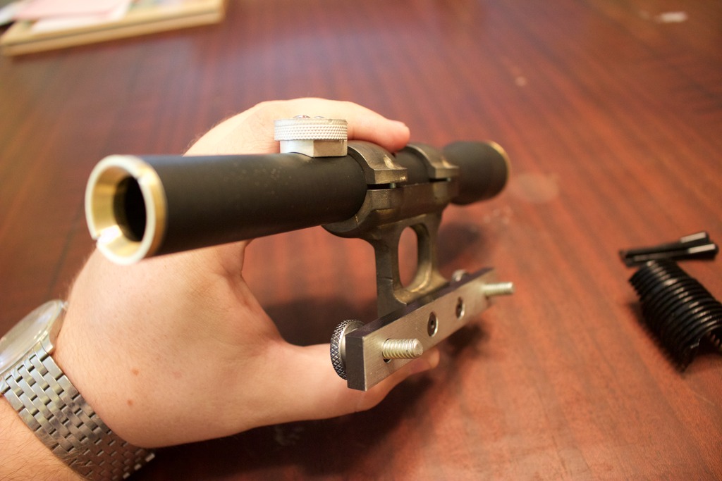

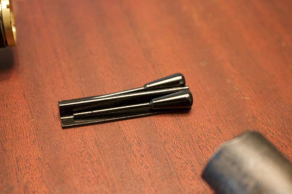

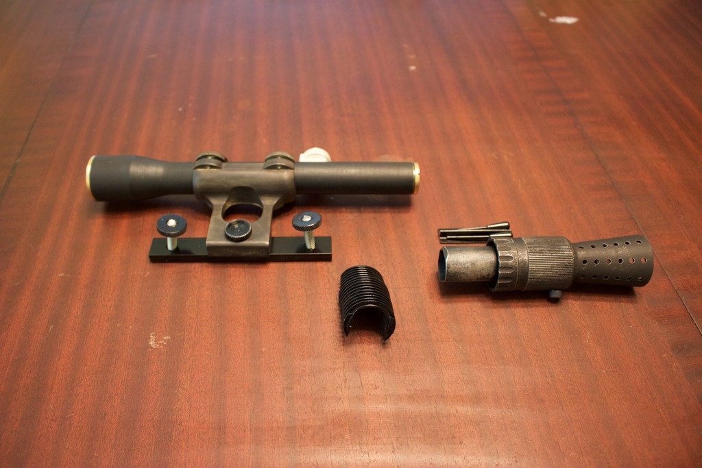

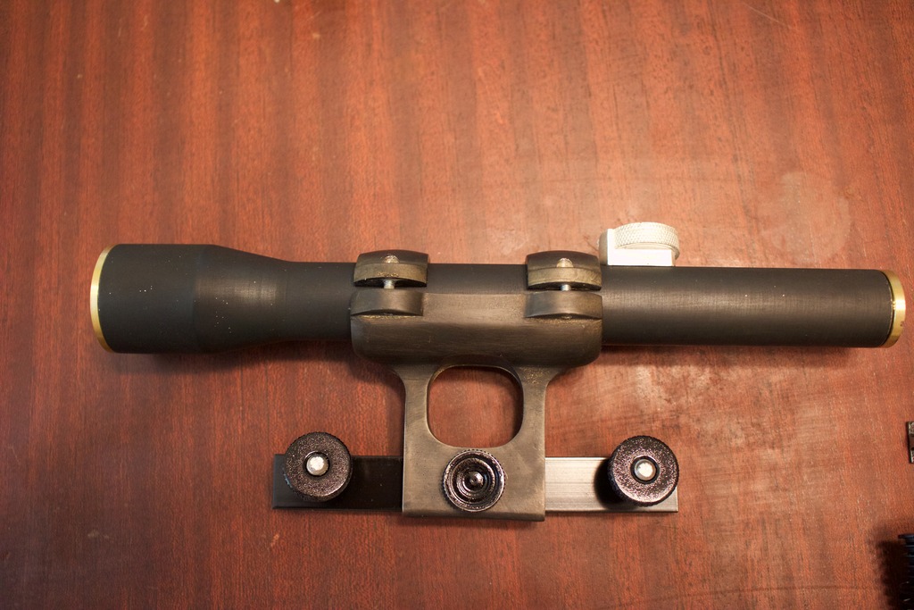

Speaking of which... I pretty much finished all the parts today. One thing I kept reading was that the scope needed to be blued, that it wouldn't take to the aluminum black... well I had just the opposite happen. The blueing wouldn't do a thing, but the Aluminum Black did exactly what it was suppose to do. I only did two baths in the aluminum black to get the color I did, then used some steel wool very lightly and finished with the boiled linseed oil. Got a really nice matte black finish that will weather REALLY nicely. I also went ahead and painted the front grill, sight greeblies, mounting bracket and knobs for the bracket with Rustoleum Satin Black. Very happy with the results:
All the parts laid out
Flash hider and barrel screwed together. I am REALLY happy with the finish on the flash hider. Its nice a weathered.
The painted front grill
Sight Greeblies
And a few shots of the scope and mount
We are getting there. I still need to paint and weather the brass rings and the adjustment knob on top of the stop and add the lenses. Once I get the mauser this bat bad can be finished and played in its display.
