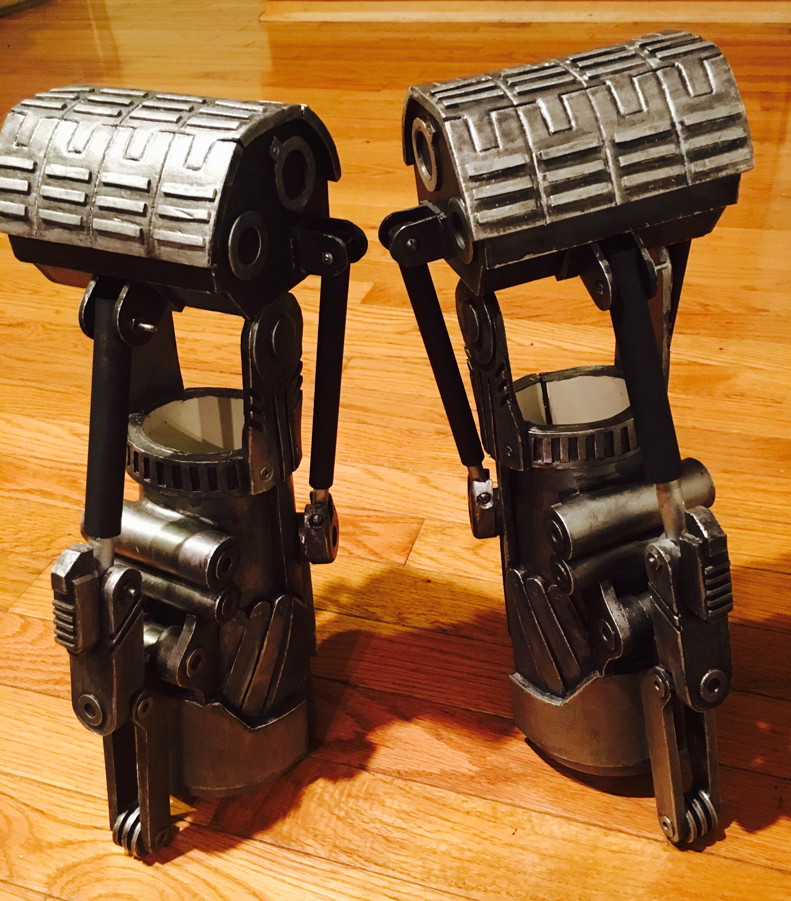

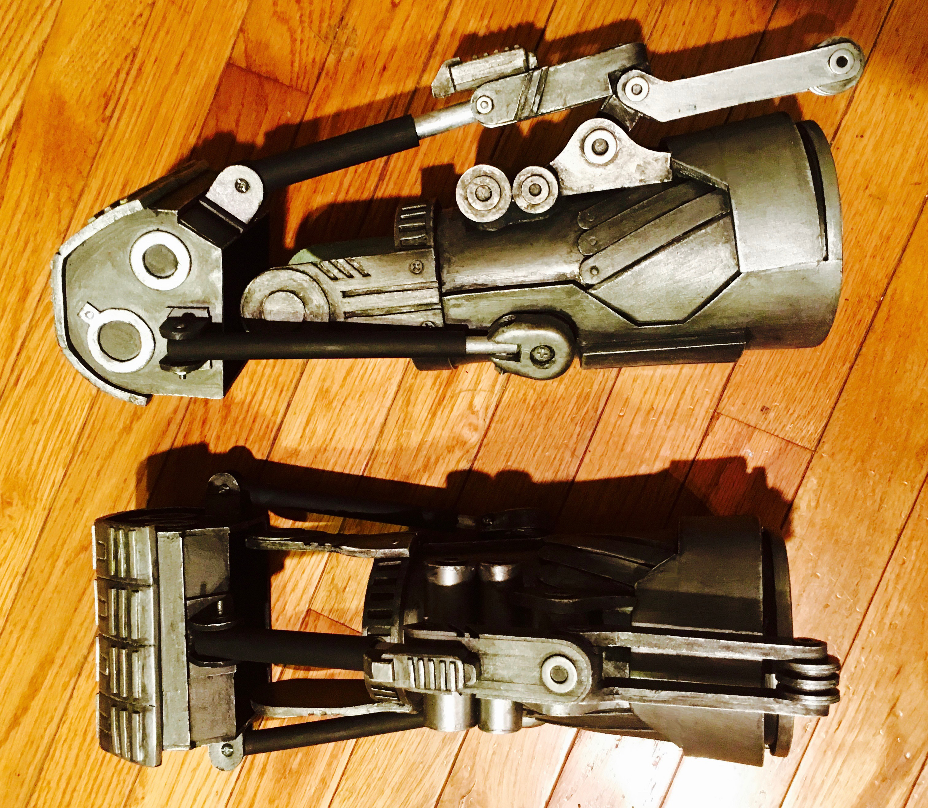

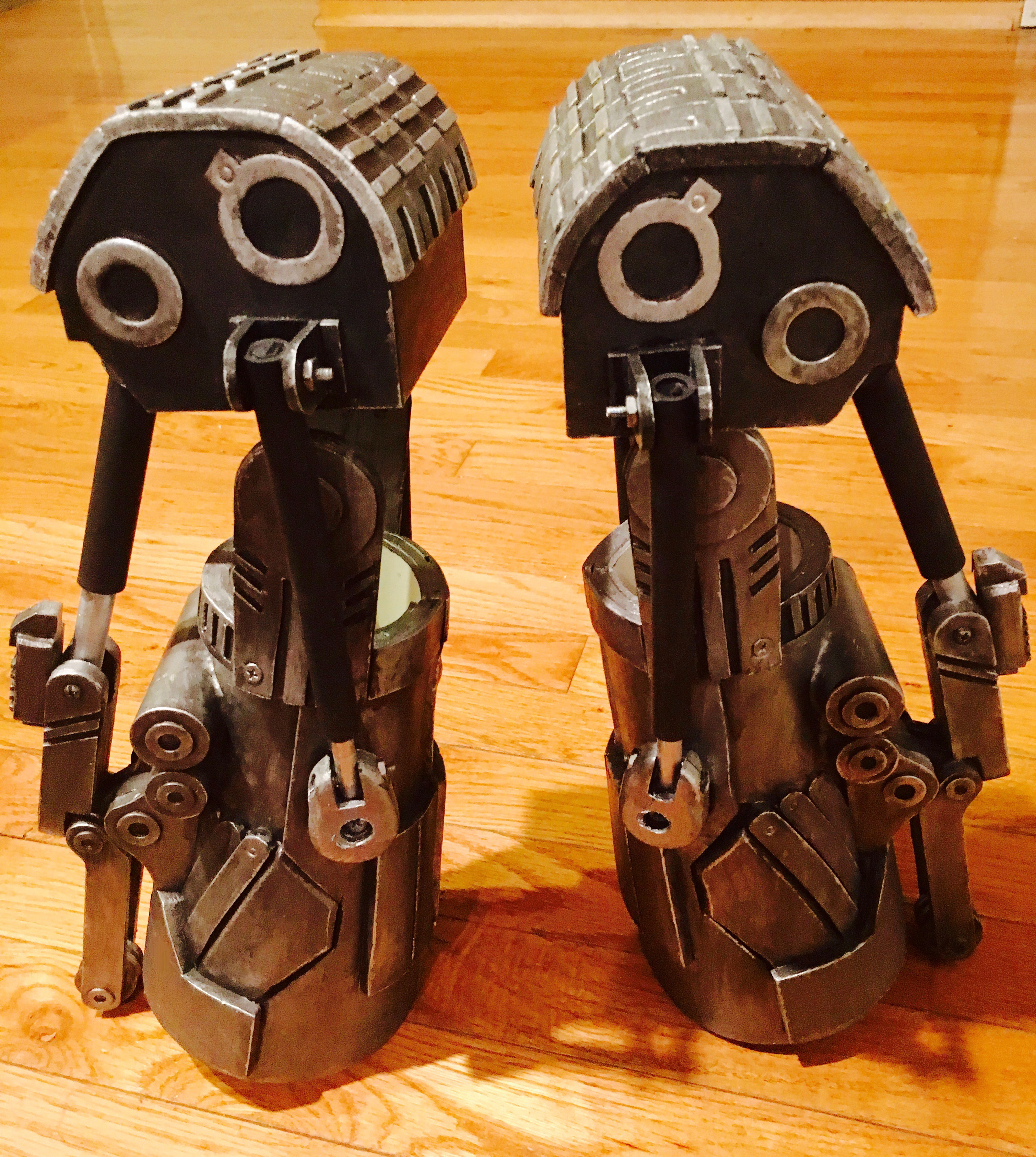

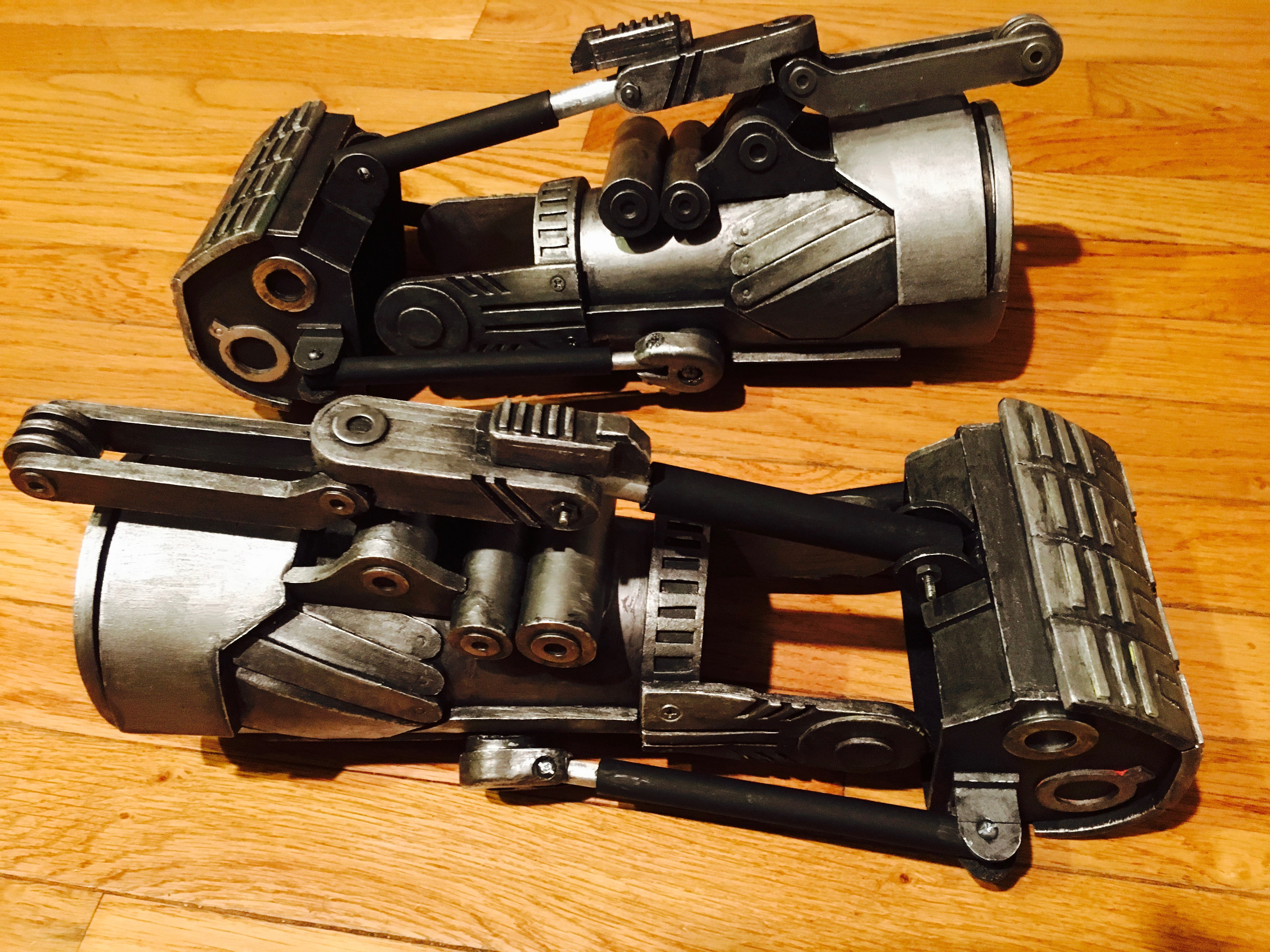

Here are photos of my scratch build of the most critical prop in terms of selling the costume. The Power Gauntlets
They are constructed of
• PVC Pipe for the main sleeve part and tube elements
• 3mm Sintra board
• 1mm and 3mm craft foam
• wooden dowels and polyethylene tubes for the pistons
• various sizes of metal washers
• nuts and bolts to secure the pistons.
I'm in the process of painting now. I'll post some completed images soon

Wow! Those look so good! cant wait to see them painted up.
Looking forward to seeing other aspects of this build also.

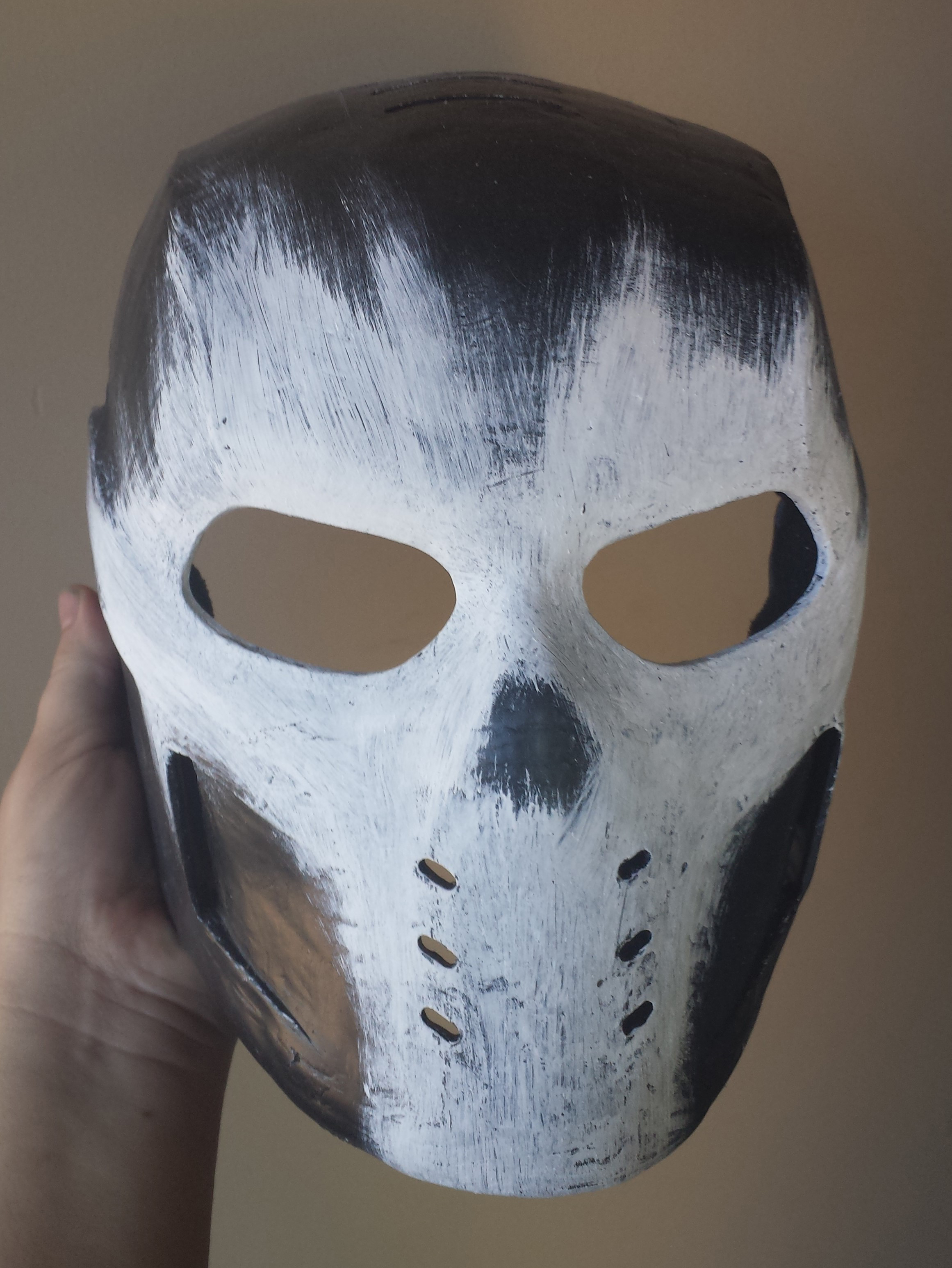

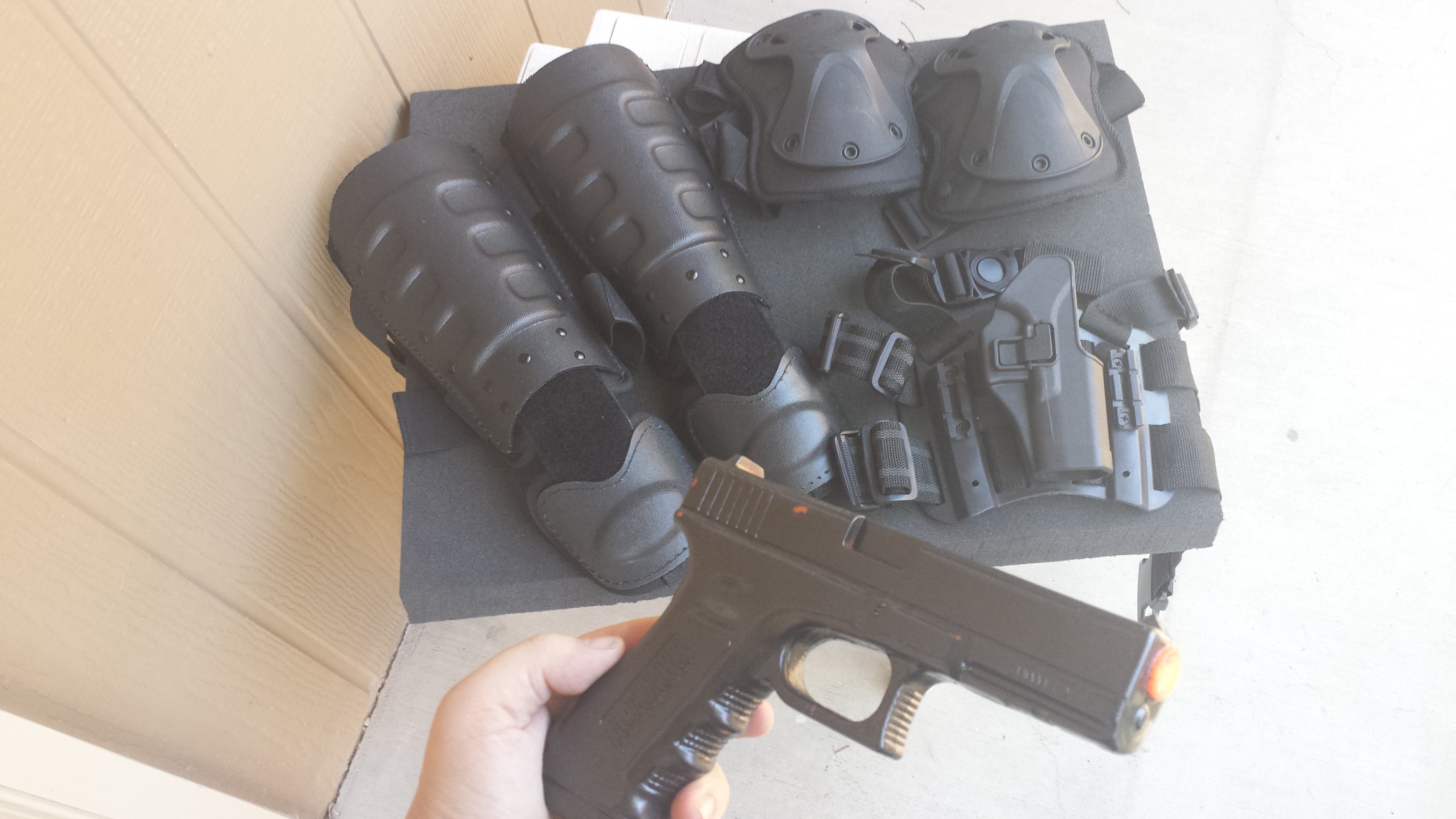

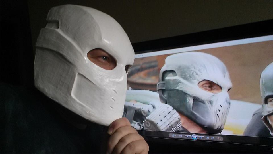

I had a huge head start from a purchase in the junkyard. here was the contents
Knee pads and shin guards are very accurate as well as holster

All of the painting was done with only two paints a small bottle of silver and a small bottle of Black Gloss Liquitex latex paints.
• The base coat is a blend of the two to make a medium gray.
• Then I did various washes of darker grays and blacks and dabbed off with a paper towel.
• Lastly I took a very fine brush and highlighted the edges with straight silver to simulate raw metal where the paint has scratched off
