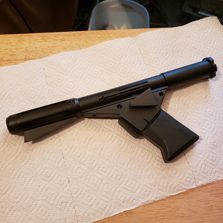

Thanks :)
I used what paint I had on hand.
It was either my Krylon semi flat black or the flat black (I have both).

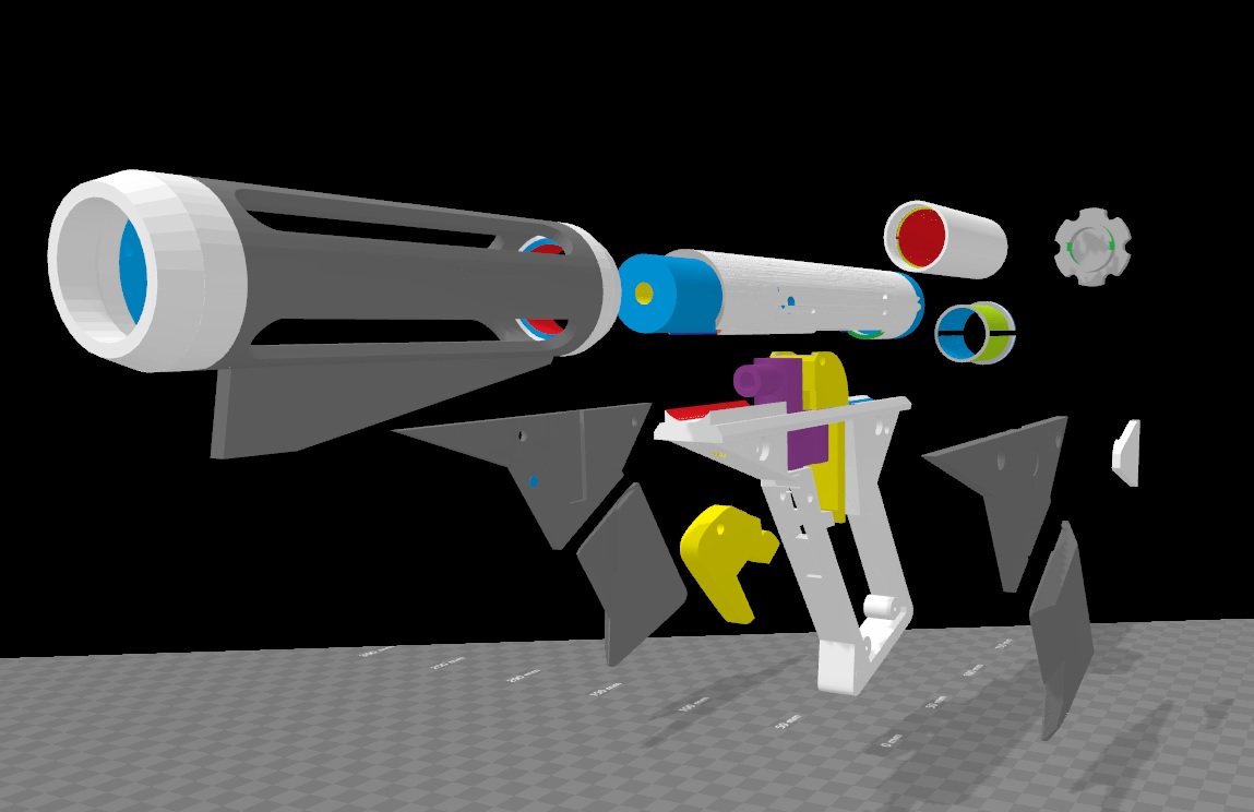

Here is the current exploded view:

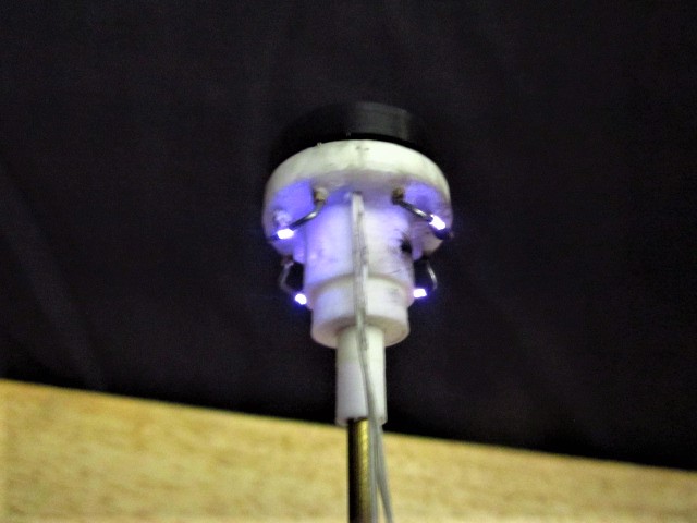

Here is a picture of the 4 spark ignition that I finally got to work last night.
It ignited the acetylene gas as predicted while doing a test run. Whoo Hoo!

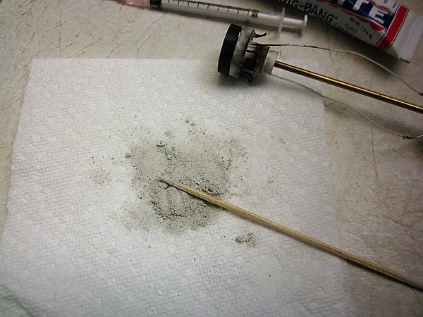

Not sure how the CC pea grade reacts with water or what byproduct is left, so I can only speak for what I know.
When properly mixed, it seems that the byproduct (after the gas is expelled), is a dry, off white powder that simply falls out
before re-setting for the next run.
When I did add too much water, it ended up mixing with the used white powdered CC and creating a kind of wet paste.
I did read somewhere that 2 cc of water is used in the real deal, so that goes to show just how small my reaction chamber

Through trial and some errors, I have finally settled on the means and I have completely assembled all the individual
components to make this happen. There are no external influences to make this prop function the way it was intended.
It uses a single very small rechargeable 4.7V Lipo battery and a modified miniature high voltage supply to create the
high voltage to make 4 separate sparks for each flame nozzle (not easy, but possible) and all has to fit into the grip.
The high voltage must travel to the 4 spark gaps at the nozzles manifold using only 2 wires without crossing over (touching),
which would cause a bit of a short and high voltage plasma release.

Well, here it is, a working, "unique, one of a kind internal design" Logan's Run 3D printed Flame pistol.
Due to more recent technology, this design was made possible.
Single 3.7V rechargeable battery.
HV power supply.
Quick "gas renewal" set up.
Light weight PLA material 3D printed body and unique gas delivery system (leaving room for future internal additions).
The design of this version has 4 individual flames (one at each nozzle vent port) like you might see on a real flame style pistol
of the future, leaving the center barrel tip for future upgrades.

Earlier this evening, I wanted to shoot my Logan's Run Flame pistol, so if anything happens during this round of firing,
I thought I would video it's function for future reference:
Here is the result. (It worked GREAT!) :)
