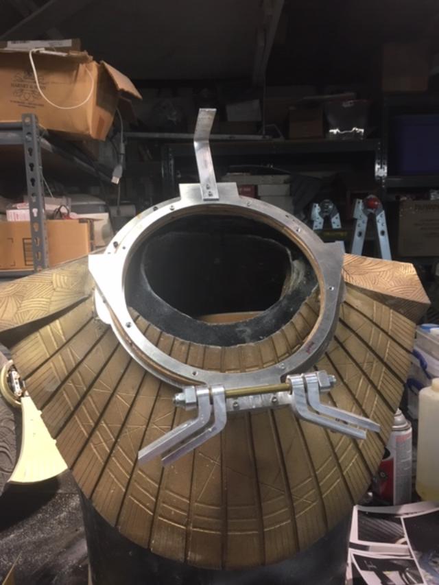

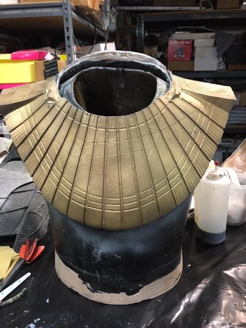

Finally got off my butt and started to finish this.
Ill be posting updates shortly.
Here are a couple of teasers. the collar, is just base painted. Its case urethane, so it has some flex, like the original. The Metal base, is all taken off the original mask.
