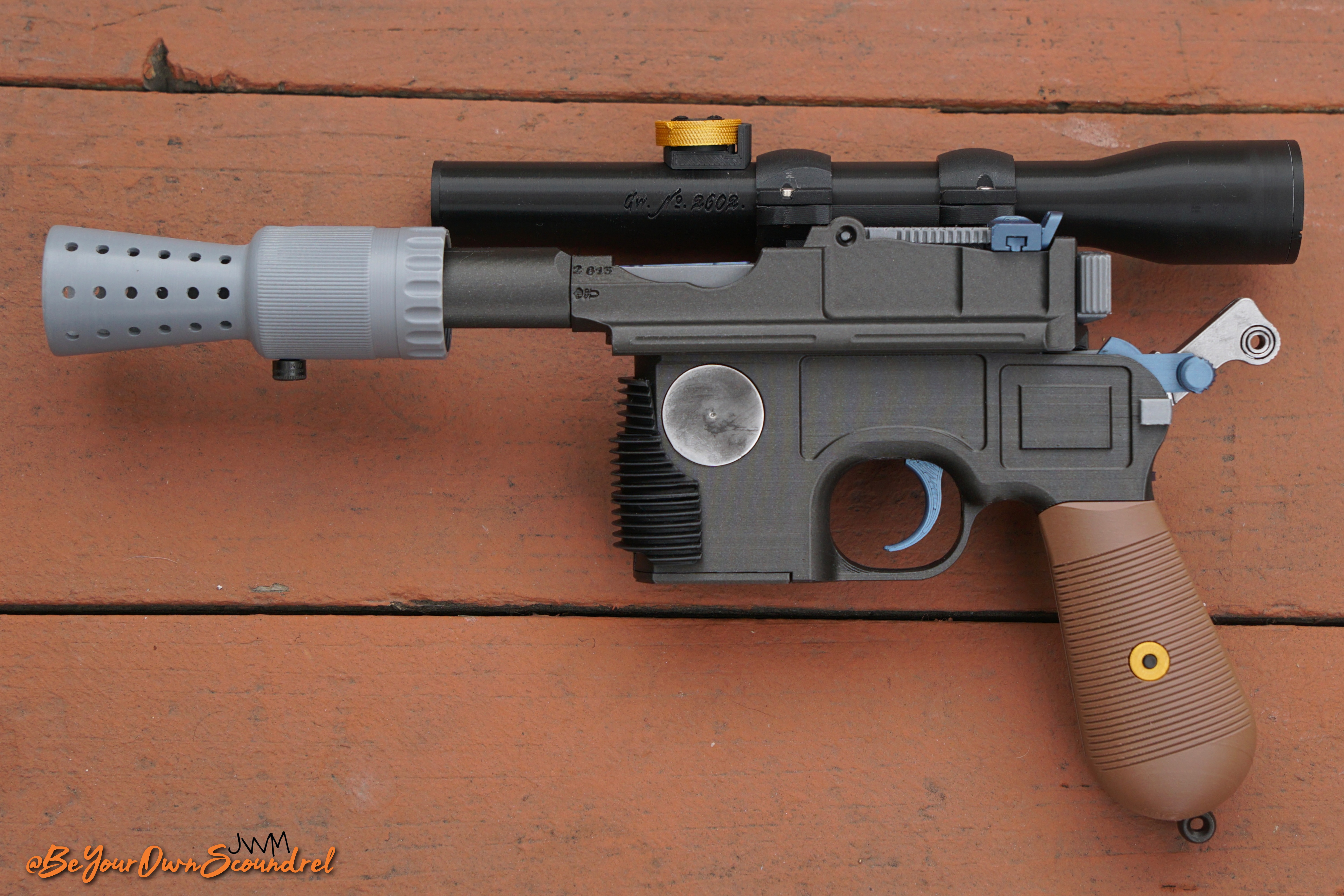

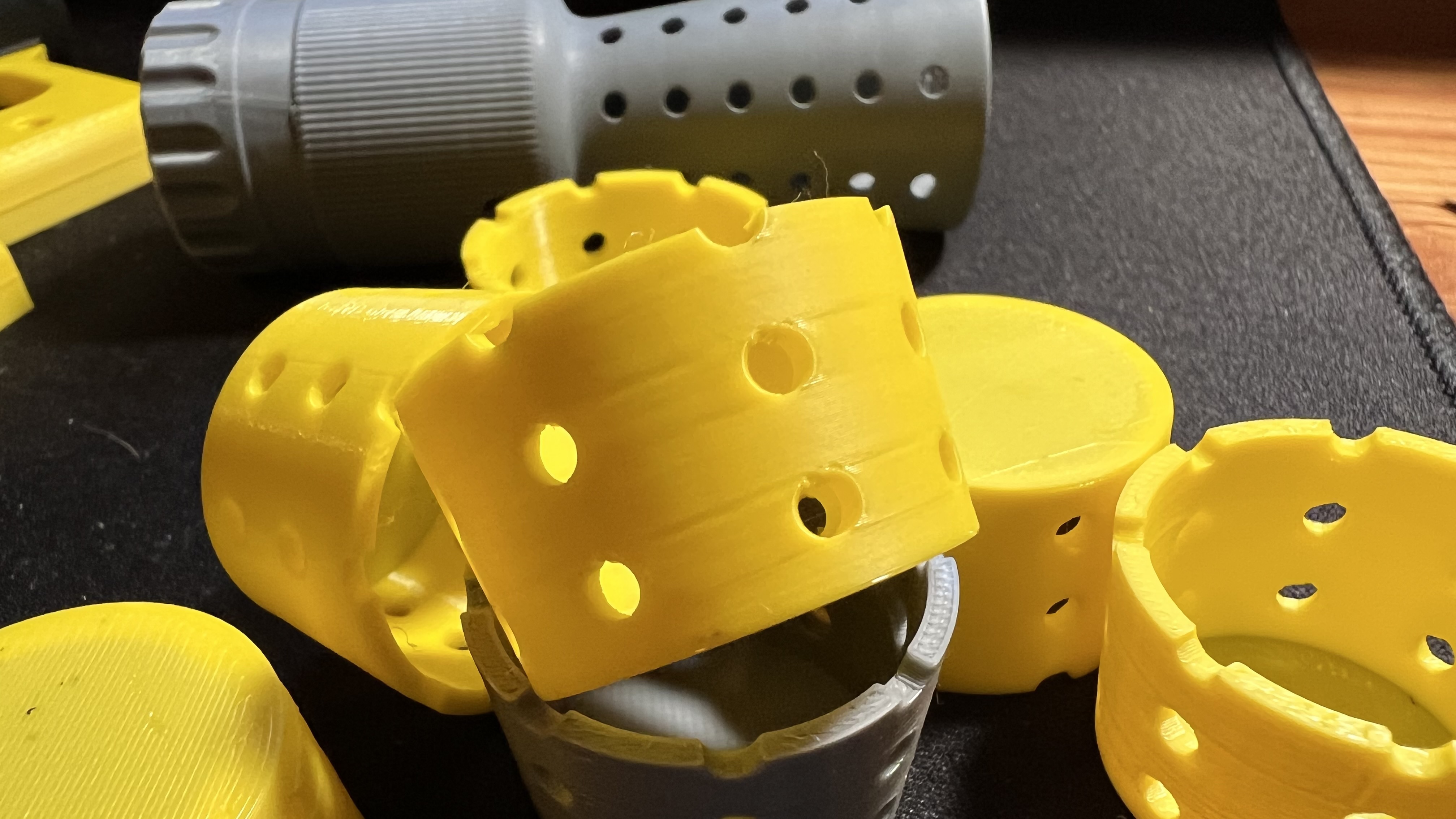

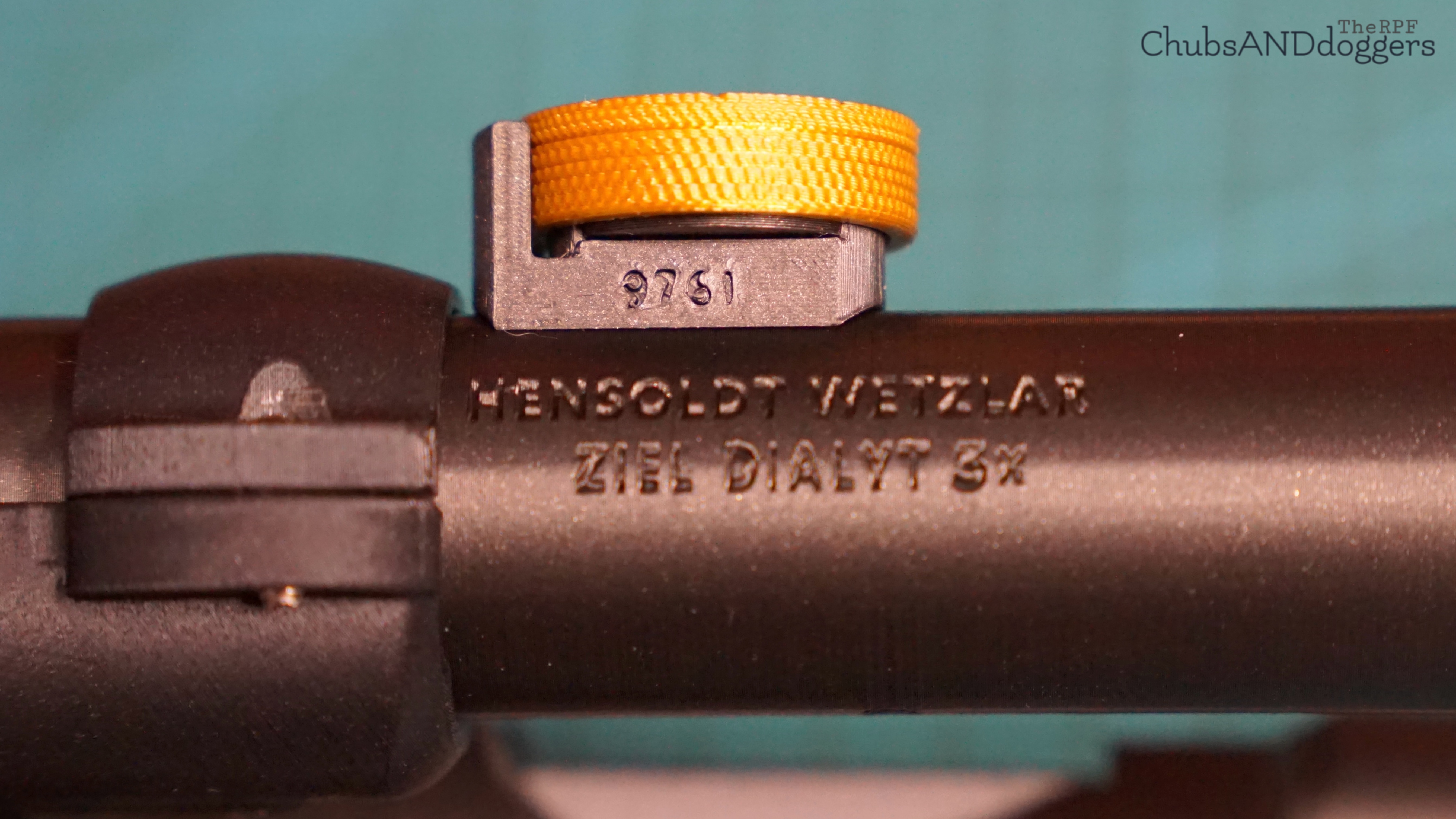

Slow progress and there some issues I’m trying to work through. One of which is the FH because of the holes it won’t print smoothly. Even slowing it right down lines still appear. I experimented with light sanding and adding primer which matches the PLA gray pretty seemless which works but rather it be simply smooth to begin with.
Slow progress and there some issues I’m trying to work through. One of which is the FH because of the holes it won’t print smoothly. Even slowing it right down lines still appear. I experimented with light sanding and adding primer which matches the PLA gray pretty seemless which works but rather it be simply smooth to begin with.View attachment 1763284View attachment 1763285View attachment 1763286View attachment 1763287

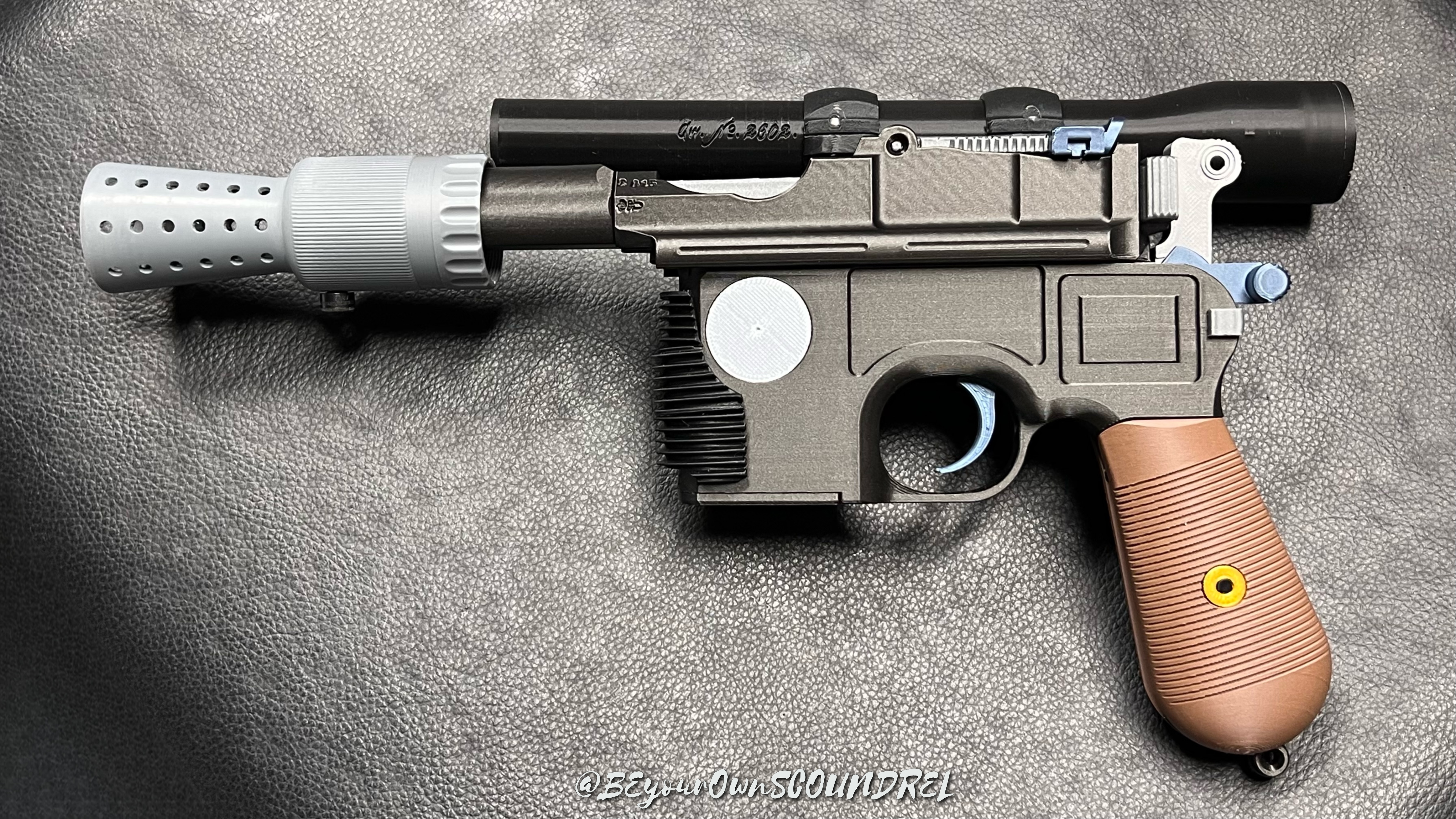

Also this Hero print is looking excellent! Seeing it built with all the little details like Carson's lump just make it look RIGHT.
Thanks Vanitas. In all honesty if one wants the perfect representation of their own design, MJF is definitely the way to go. These FDM prints are really nice but it’s hard to get them perfectly clean with supports. There is scaring in certain places but that’s inevitable I guess. It’s still a bit of a pill to swallow though if ur an aspiring perfectionist.

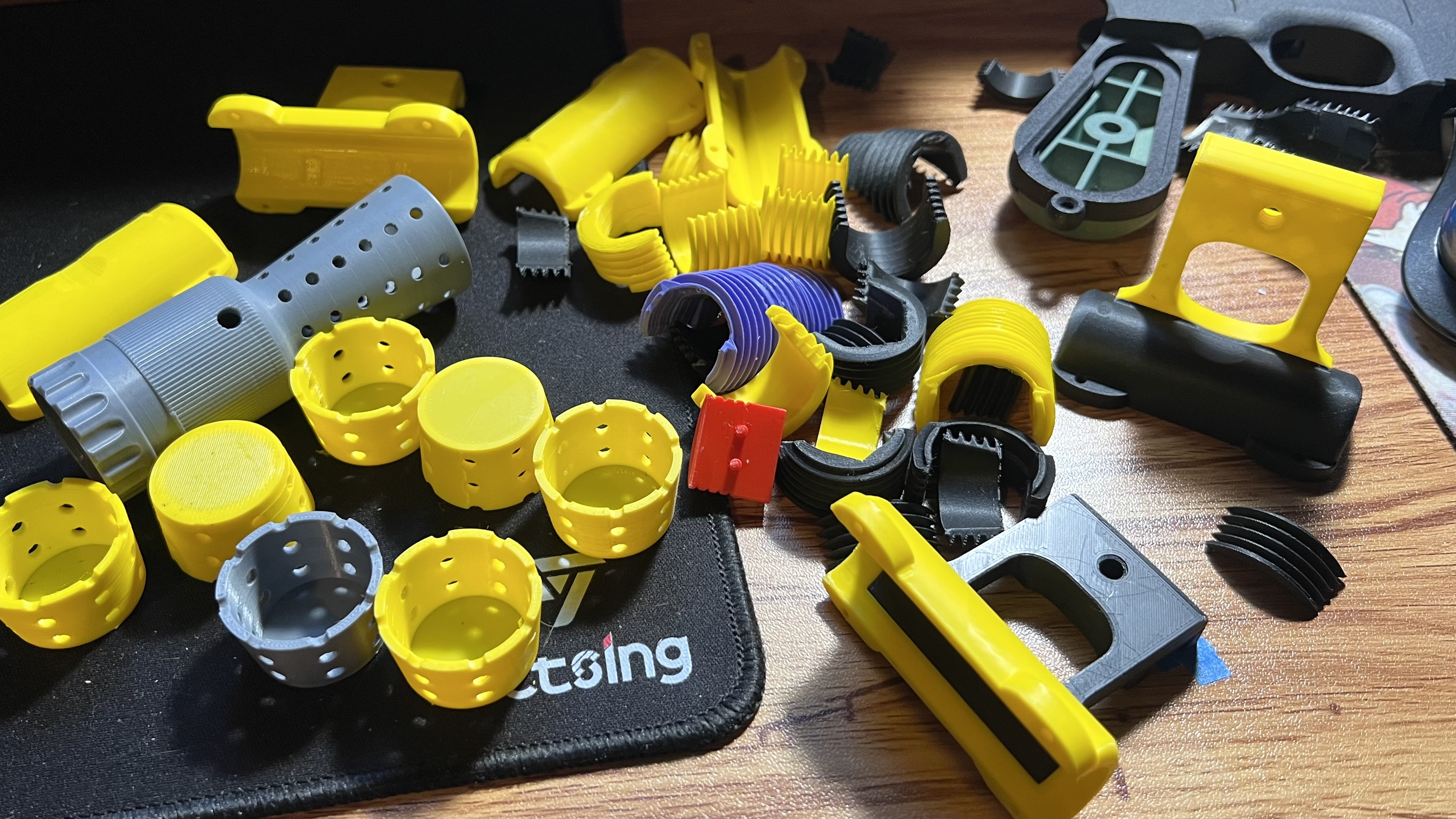

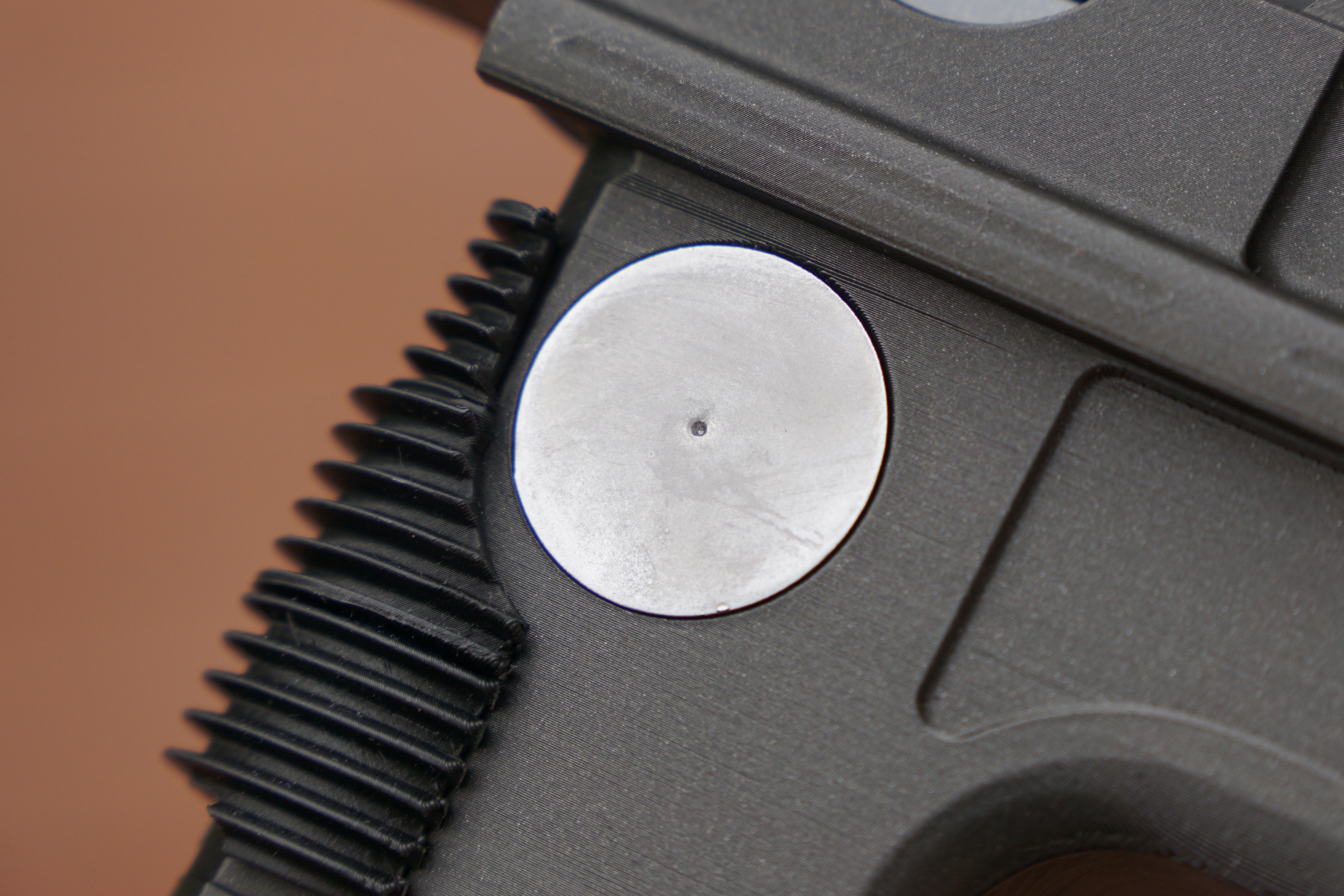

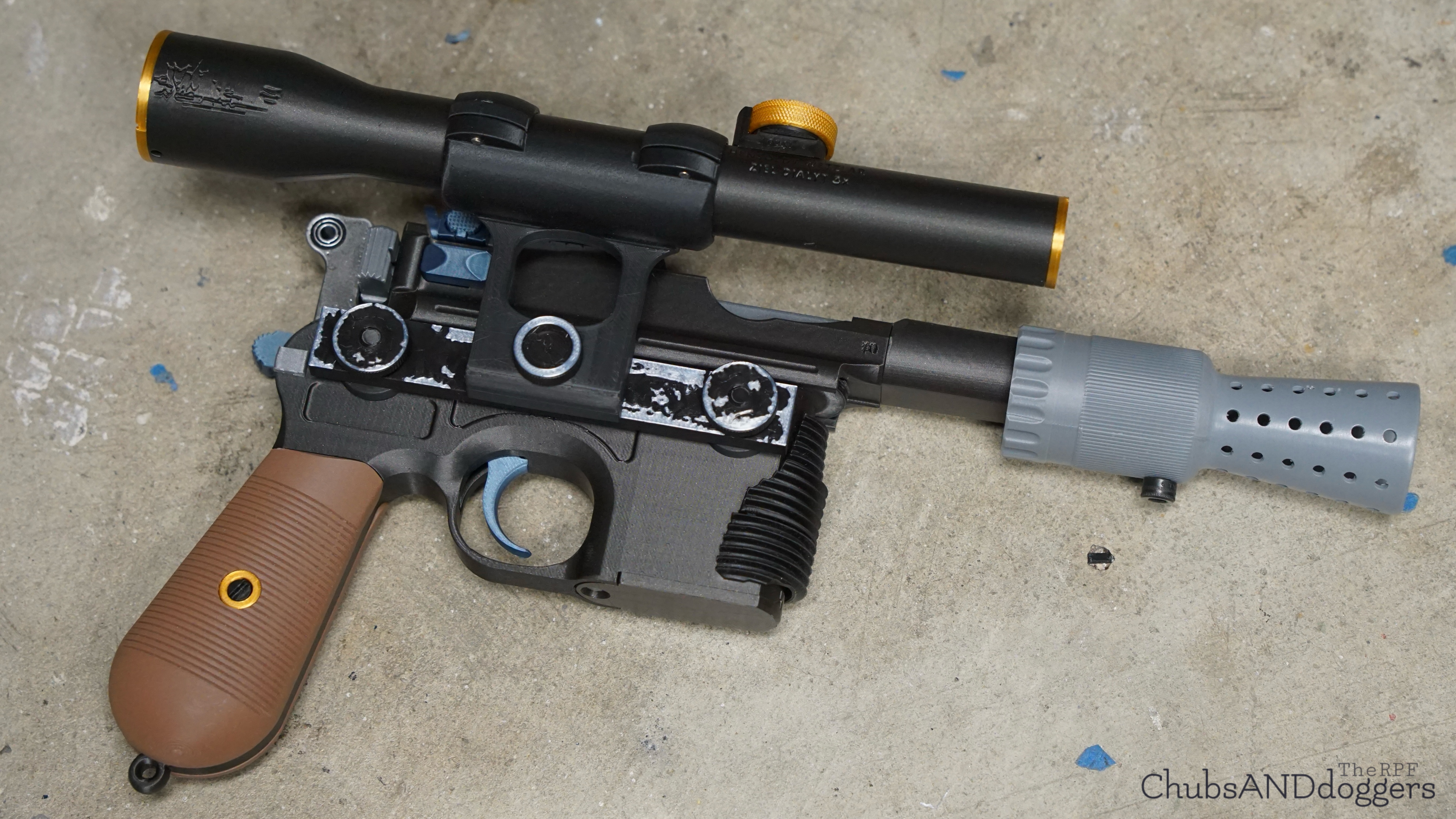

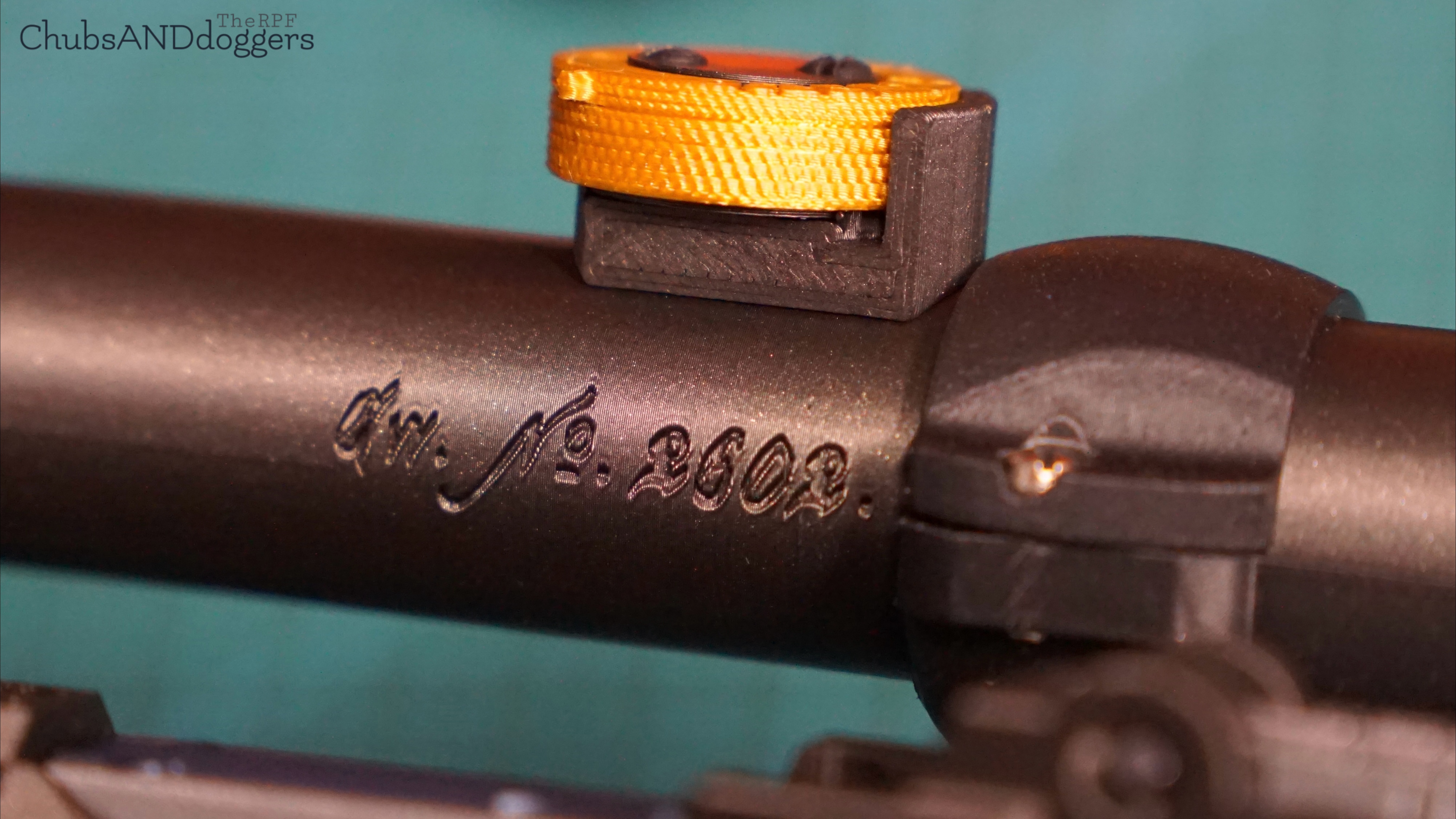

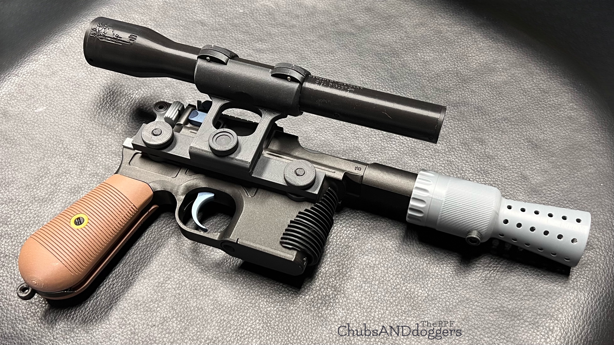

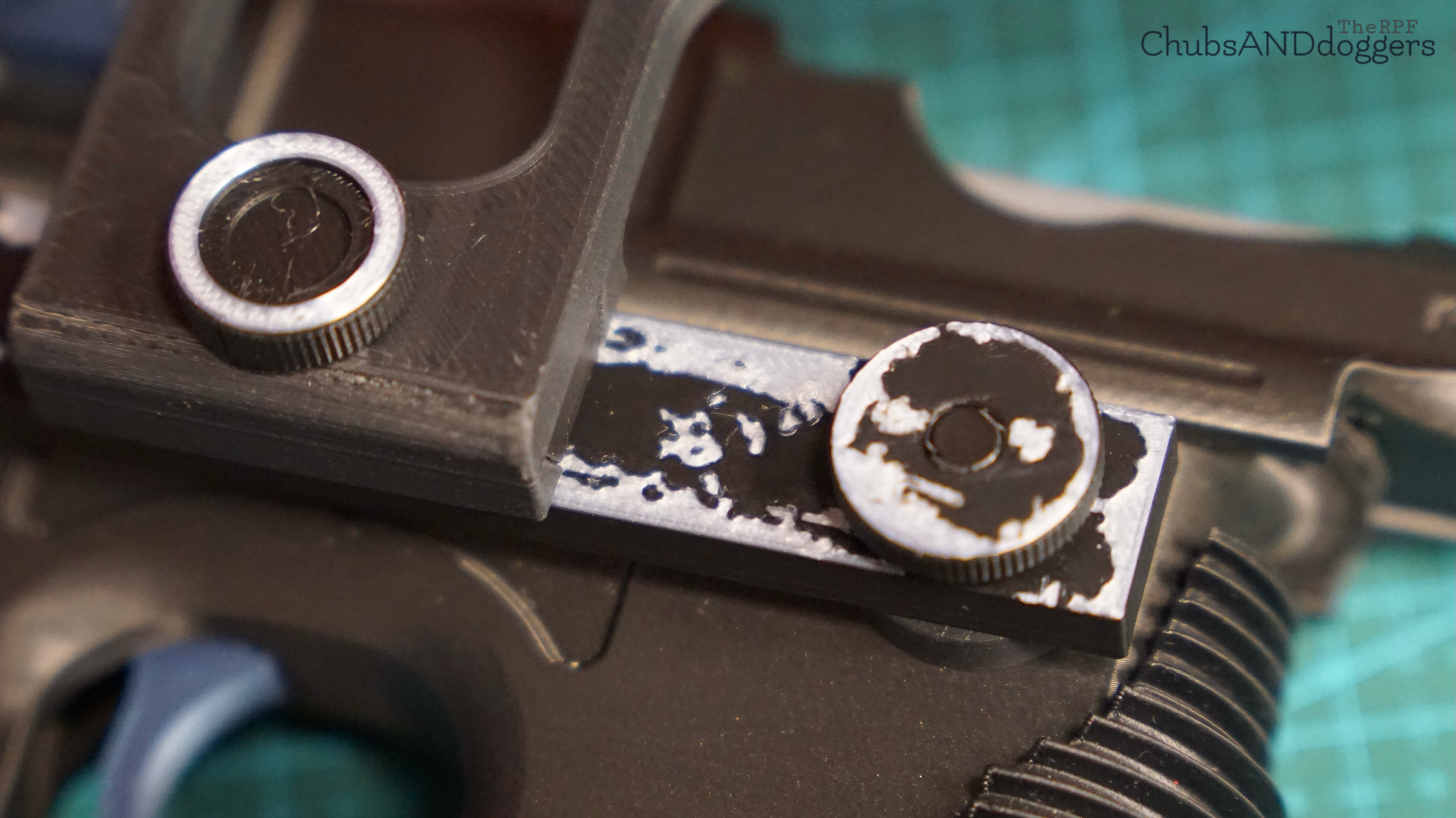

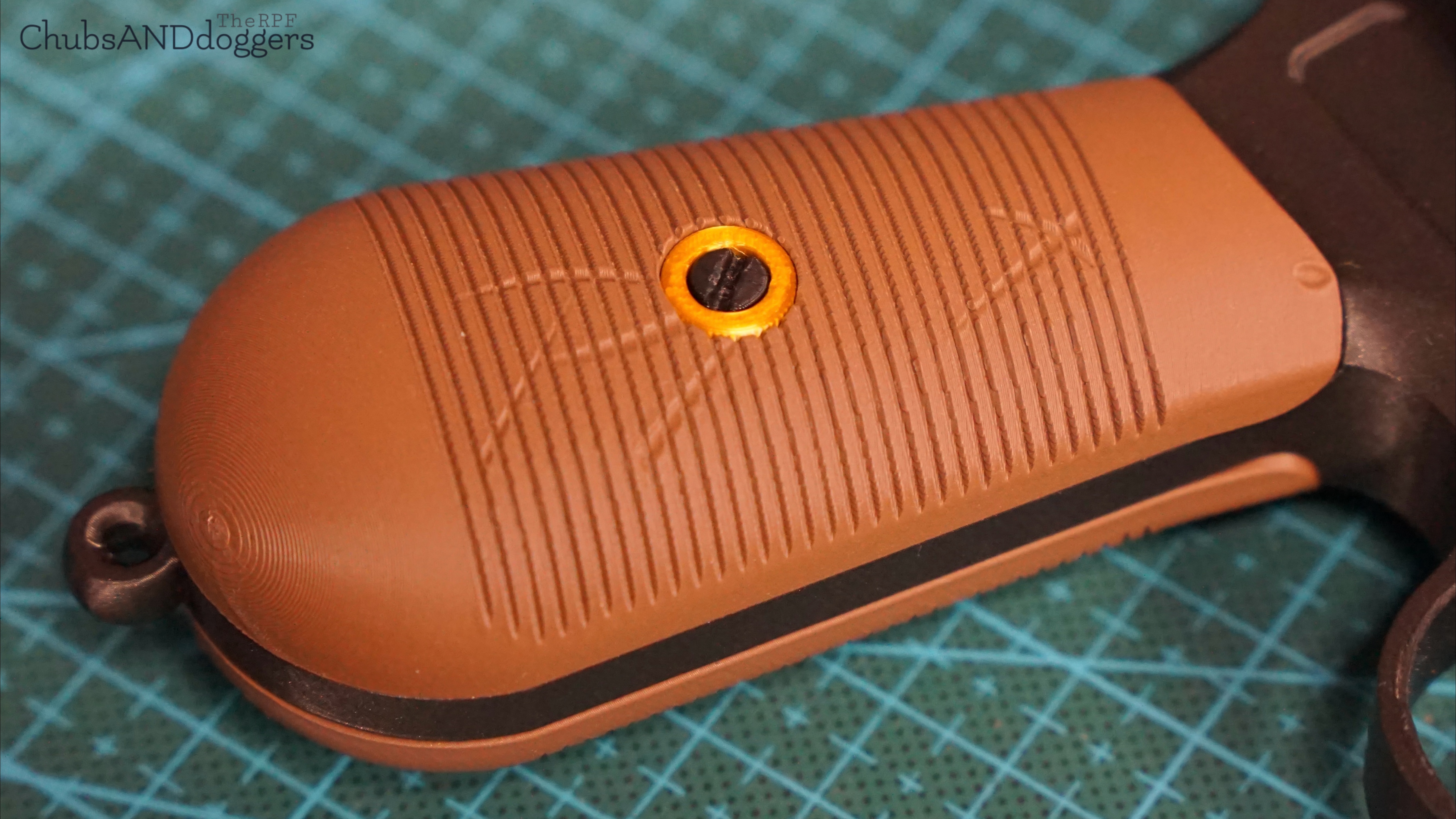

So I’ve pretty much finished the first draft of this FDM ANH Hero blaster. It’s not finished by no means but it’s certainly coming along. One thing that bothers me is when things are not printed on an angle you can see how the filament is layed down. I try printing everything on an angle as much as possible to reduce this but needed supports makes this very difficult for parts that require cosmetic perfection. Like for example the hammer and mystery disk. I tried printing each on an angle but I don’t like how they came out. I know this is back side of the disk but still..
I’ve been curious how these parts would take to painting so I primed each and painted them really quickly. To my pleasant surprise they came out great. The last pic you can see the hammer with and unpainted one for comparison..
Now I need to add some threading and modify some parts to help improve the prints themselves but so far so good. Got the whole OT Hero’s lining up..
