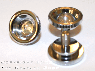

I also ordered a reproduction glass eye from http://www.graflexshop.com/ does anyone know if these are passable? My G R A F L E X didn't come with the glass portion of the eye.
