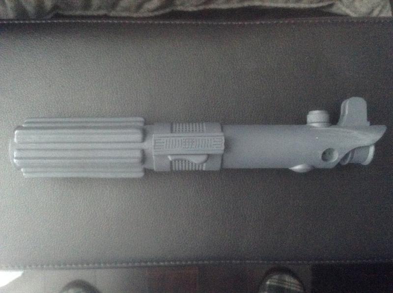

Despite having the Master Replicas Limited Edition Anakin ROTS saber, I decided it would be nice to have a "stunt" one to be able to handle and such. Just a fun little project for winter, y'know? I was tempted to look for the EFX "stunt" replica, but it seems more than a little hard to find.
So, I recently acquired a cheap resin casting of the saber (which looks to be molded right off of the MR). It's a good casting, but I plan on tweaking it to make it a bit nicer. I'd like to remove the resin grips, and replace them with rubber ones. I have a set of ANH grips, but they feature angled edges instead of rounded.
There was a time when everyone made and used round-edge grips. Now, it's all accurate, angled grips. Anyone know where I can find some cheap rubber grips with the correct ROTS edges?
I also got a Covertec wheel to replace the resin one, and will be getting a brass circuit card for the control box.
While it would be nice to get the saber chromed, I think I'll have to settle on chrome paint, with aluminum paint for the center band. Any good chrome paint suggestions? Also, any suggestions for the copper button and eye color? Looks like more of a reddish copper on the MR than a goldish copper.
Thanks!

Hmm. Those wannawanga grips still look to have angled edges. Alternatively, I suppose I could just clean up and paint the resin grips. Maybe even coat them with some sort of liquid rubber.

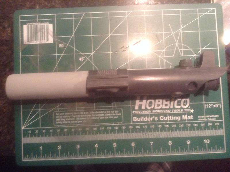

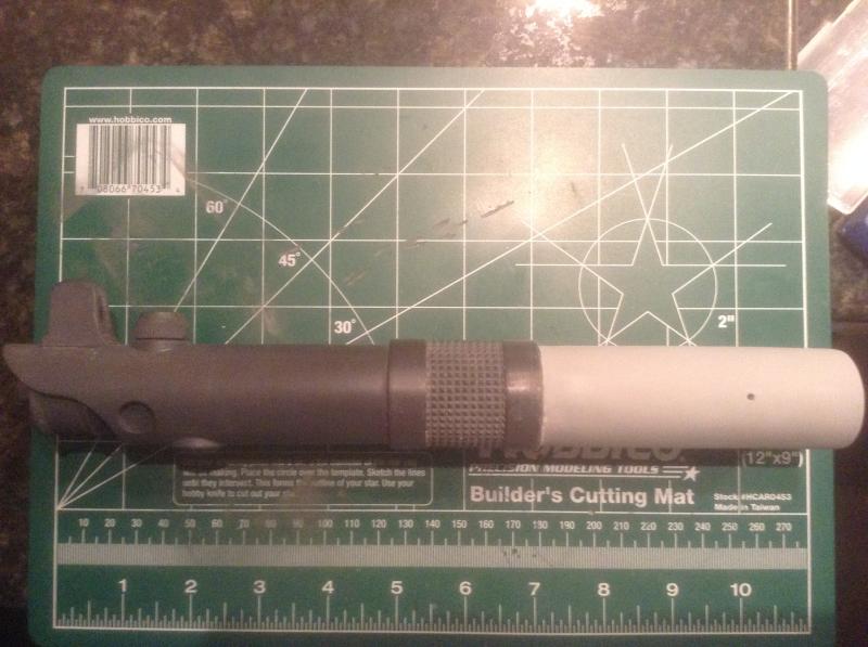

Dremeled off the resin grips. Now working to fill and sand the lower body nice and smooth. Before removing the resin grips and Covertec, I drilled a hole down into the body, through the resin screw at the center of the resin Covertec. This will allow for accurate placement of the real Covertec, later on. Acquired some spray-on rubber, and began scoping out chrome paints. Again, any suggestions for the best faux-chrome finish would be appreciated.

Some progress photos. Been puttying and sanding the lower half, which has now received a few coats of high-build primer. And I removed the resin circuit board in the clamp section to make way for a real one, and scribed the rings into the bottom end. Also note the Covertec hole.

Nice work on the bottom! Was it difficult keeping a consistant profile while removing/puttying?
good call on the greeblies too
Gregatron
It it just takes patience. I used a sanding drum in a Dremel to remove the bulk of the grips. Then, lots of elbow grease with sandpaper and files. Once the grip sections were essentially flush with the main tube body, it was just a matter of applying and smoothing out generous amounts of putty, then sanding some more. Lather, rinse, repeat. Then filler primer, and more sanding, followed by more putty. Lather, rinse, repeat! What you see in the photos is the result of a mere afternoon's work. It was much easier than I thought it would be.
