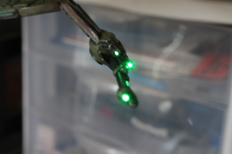

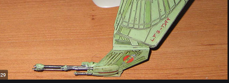

I have seen several builds where the side guns are hollowed out for fiber but I can't for the life of me figure out how to do that with my pin vise. The drill isn't nearly as long and no videos explain how they did it. The piece is a long tube...short of cutting it off into two pieces and reattaching (which will look awful) I am at a loss unless they had a very long pin vise bit
Honestly the easiest way is to replace the barrel with tubing, cut the existing part so you have the "bracketing" and drill the bracketing to accept the new barrels... then you can feed the fiber through. Its not for the faint hearted. Alternatively you could try to scratchbuild the part using the original as a guide or - cast it in clear and paint it up removing the need to insert fiber... But I'm not really sure why you'd want to put fiber there... it did not exist on the studio model and the movie shots were purely sfx... seems like too much trouble for little effect to me... but those are the techniques I'd try if I were to go that route.
