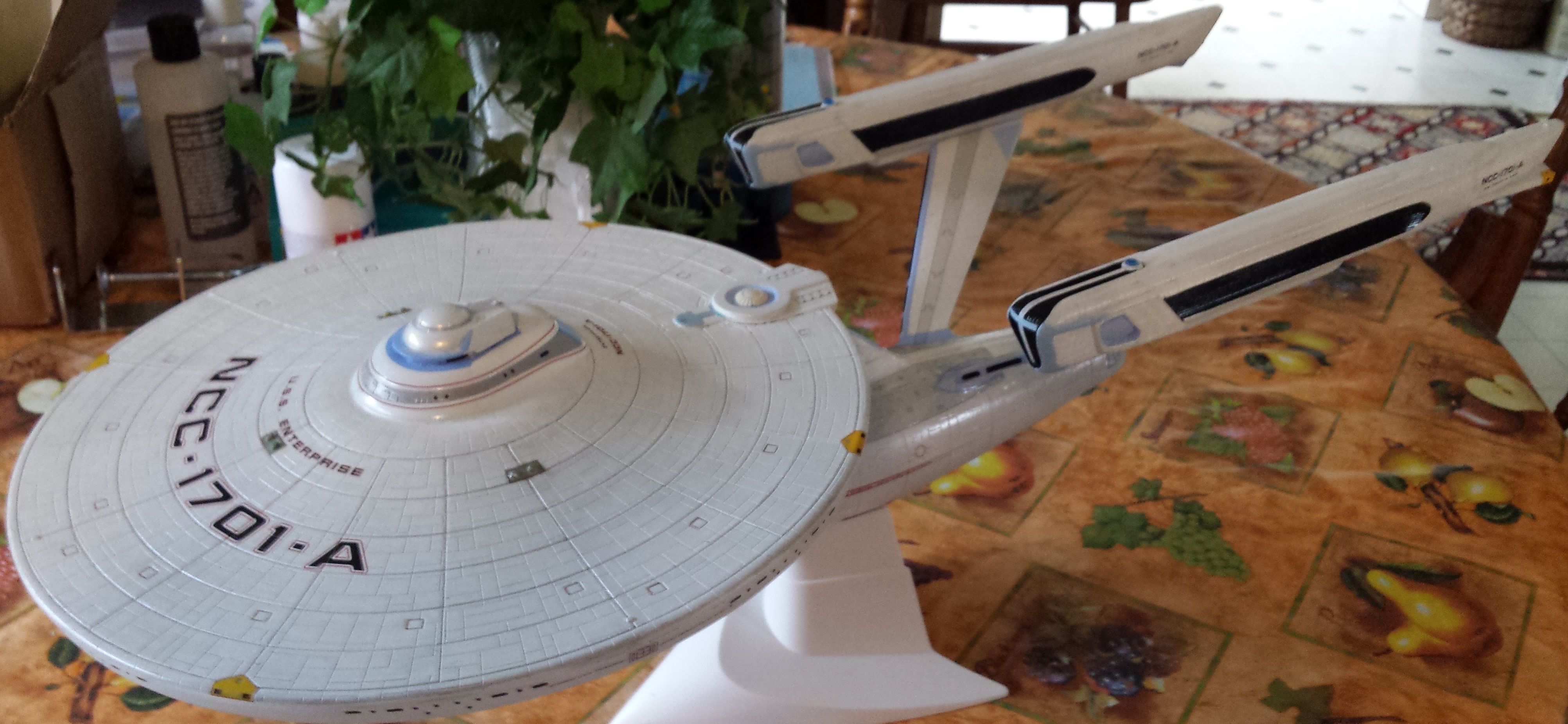

Here's one I built a while back. I didn't fill in any of the lines. My only goal
with this one was to make it look better than the one I had when I was 11.
Even with the grid lines I think it turned out OK.
