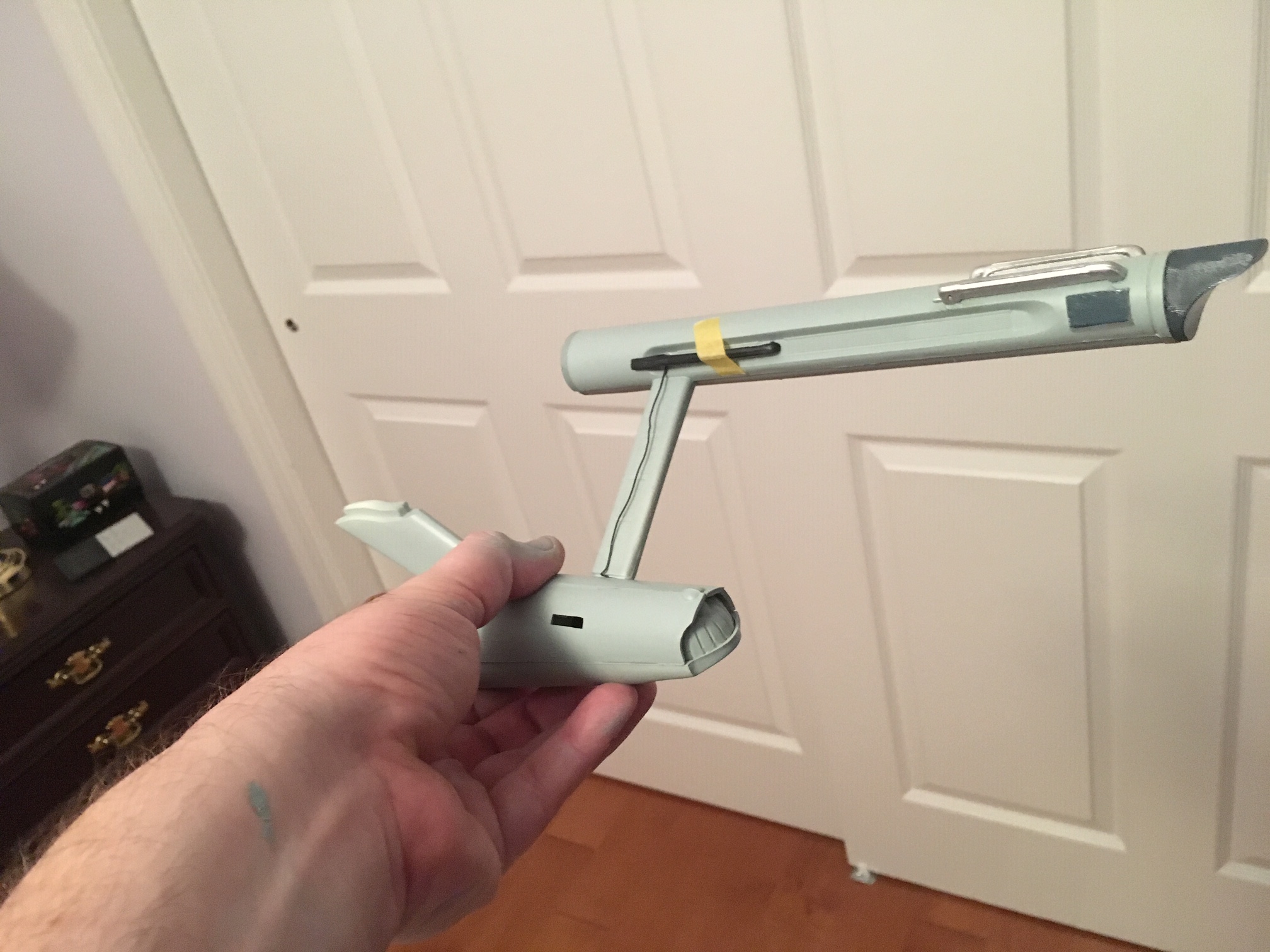

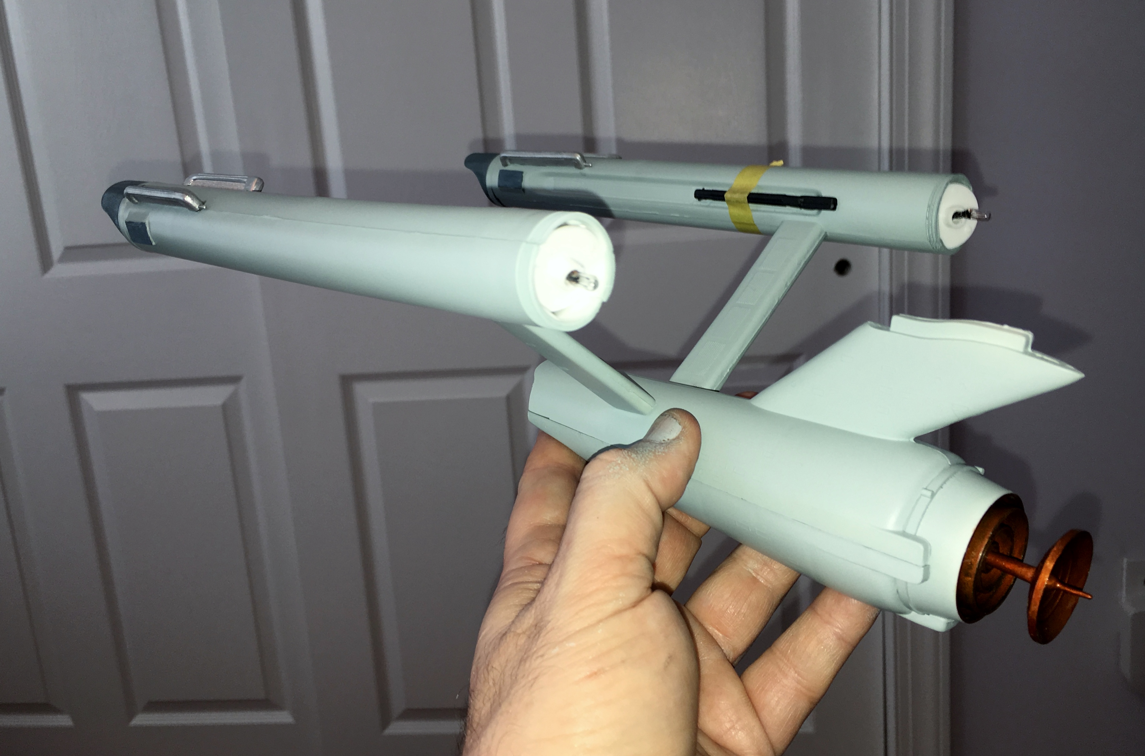

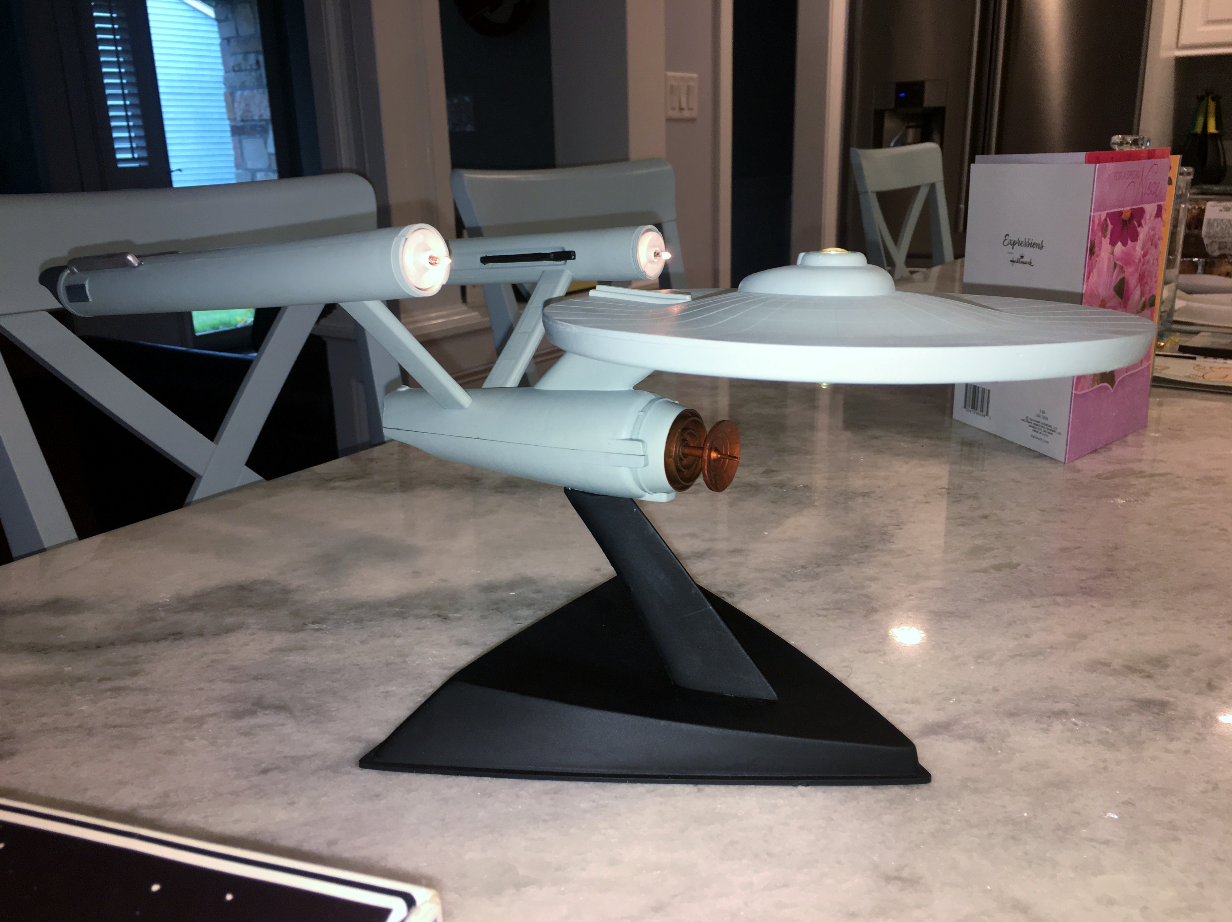

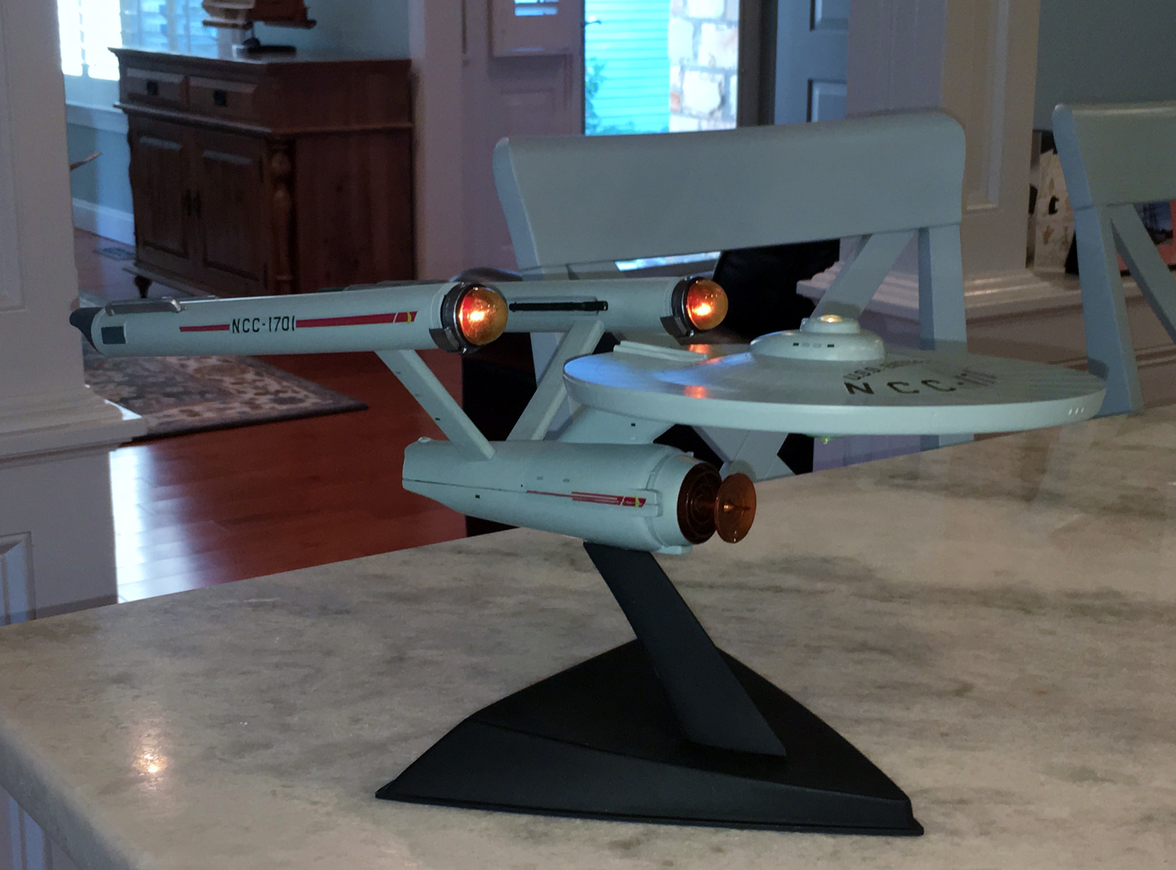

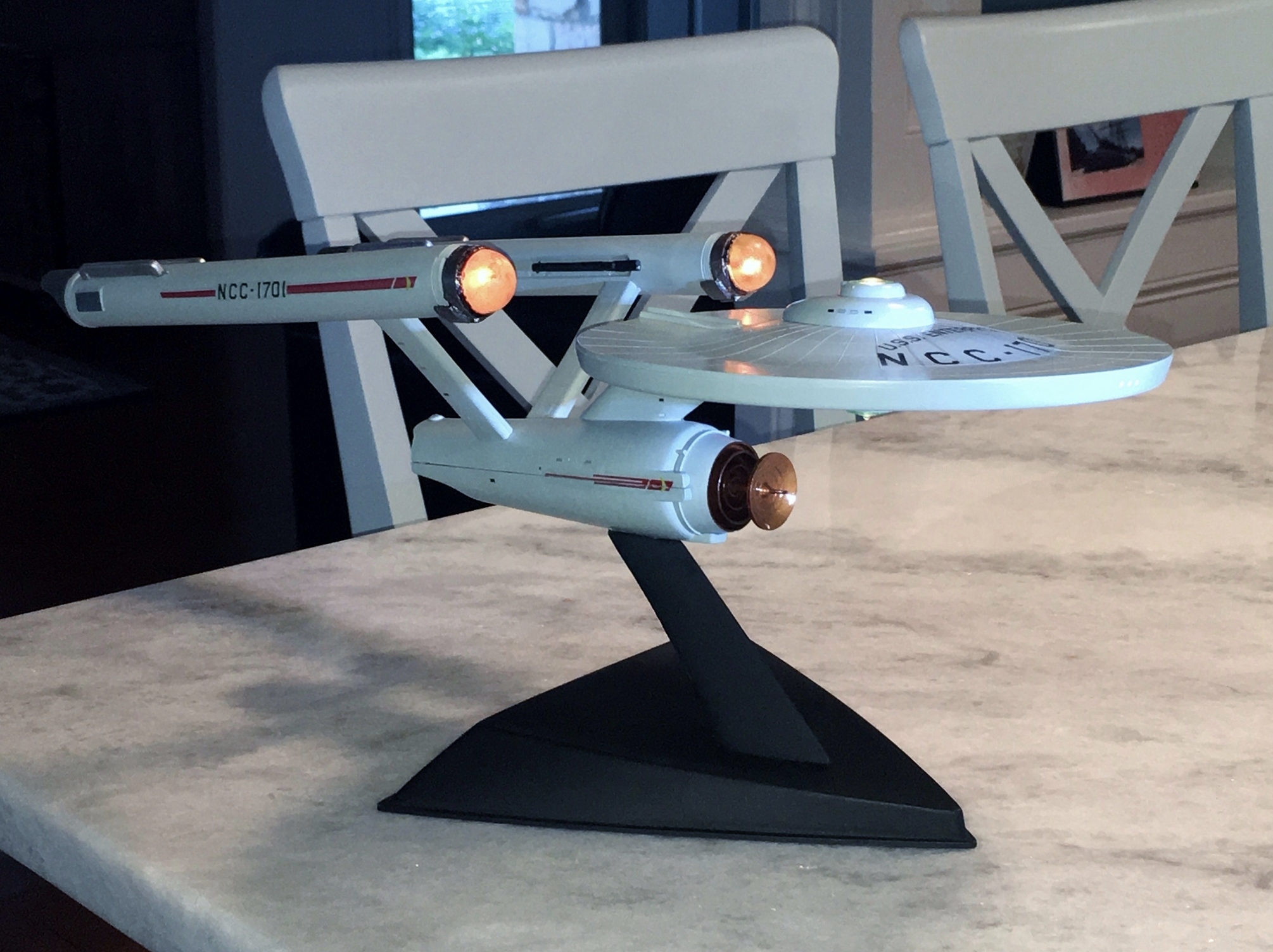

So here's what I have so far:
1032497
1032498
1032502
If you are wondering about the wire...I guess I could claim it is an homage to the filming miniature, but the truth is, I managed to snap one of the wires coming out of the base of the pylon and can't seem to fish another up.
That was screw up #1. Which pales in comparison to screw up #2...I ruined the amber domes trying to dull-coat them. The dull coat also reacted with the metallic paint I used for the "rings" They are now a combination of melted plastic and paint mottling that is too unspeakable to say much more about, much less post a photo.
So I now need to buy ANOTHER kit, just to get the plastic domes. EXPENSIVE mistake. And one that may not be solved in the near term, as who knows when the next one will rear its head on Ebay. Anyone with a spare they'd consider selling or a lead on one, please PM me.

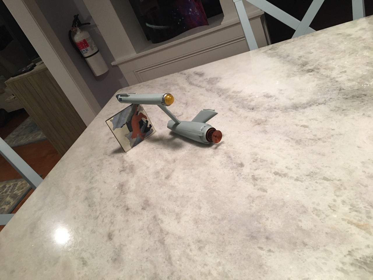

Ah, the heck with it, here's a photo of one now-horrific dome (taped in place). I shrunk the photo down to limit my embarrassment. Next time, I will simply paint the rings and perhaps use a red marker on the bulbs or some other (red) bulbs or even LEDs to try to better match the effect on the box art.
All advice regarding my paint choices, etc. is appreciated.
1032504
Thanks; it's getting there. Lights (52 year old bulbs and all) even work as they should, twisting the the deflector housing to turn on and off like a flashlight Just waiting on the new decal sheet. Oh and buying another kit to replace the domes I ruined. :(

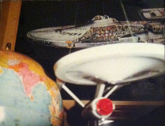

Here's the end result last time I built the later version of the kit (in my teens):
1032870

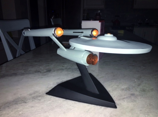

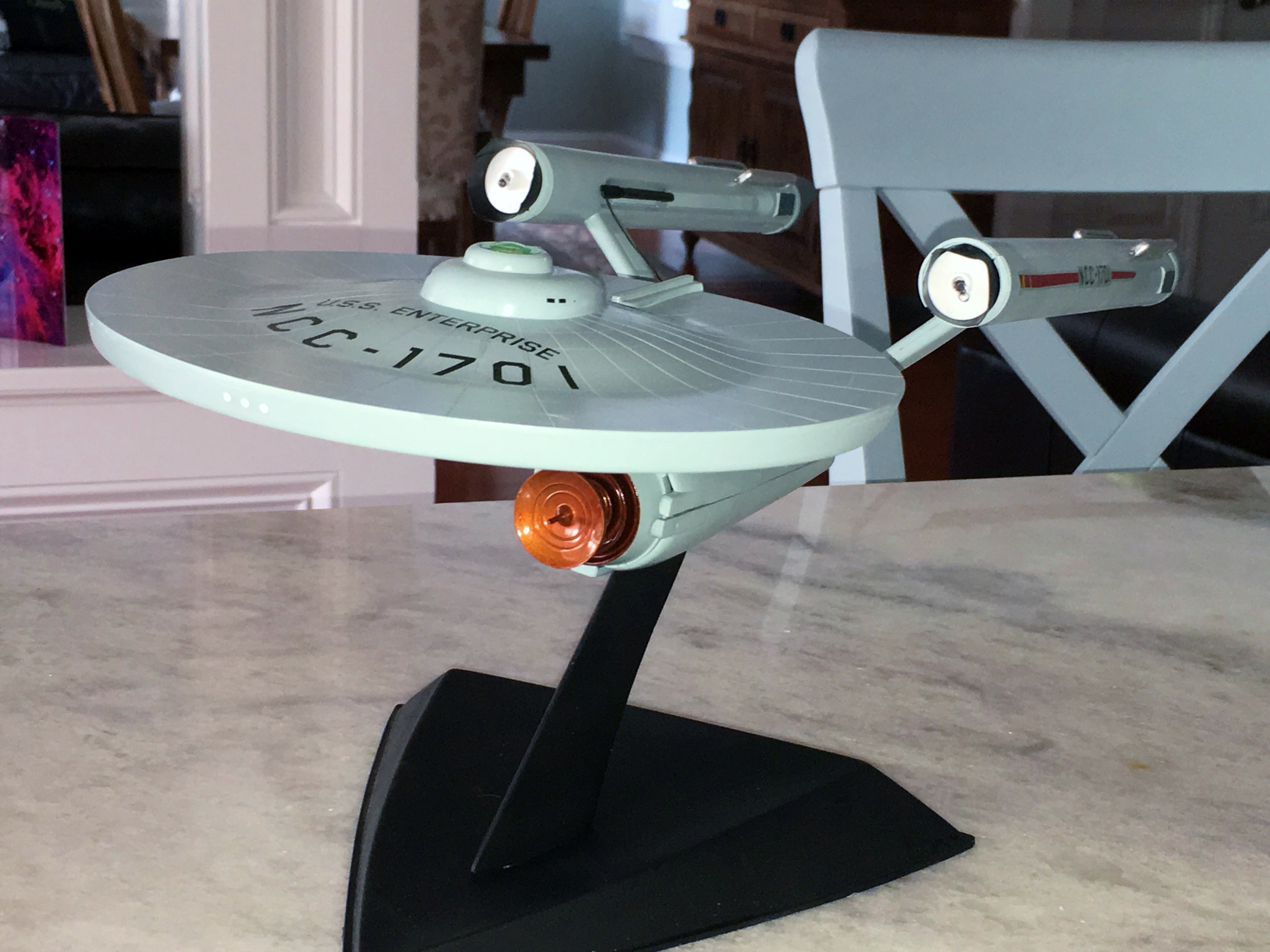

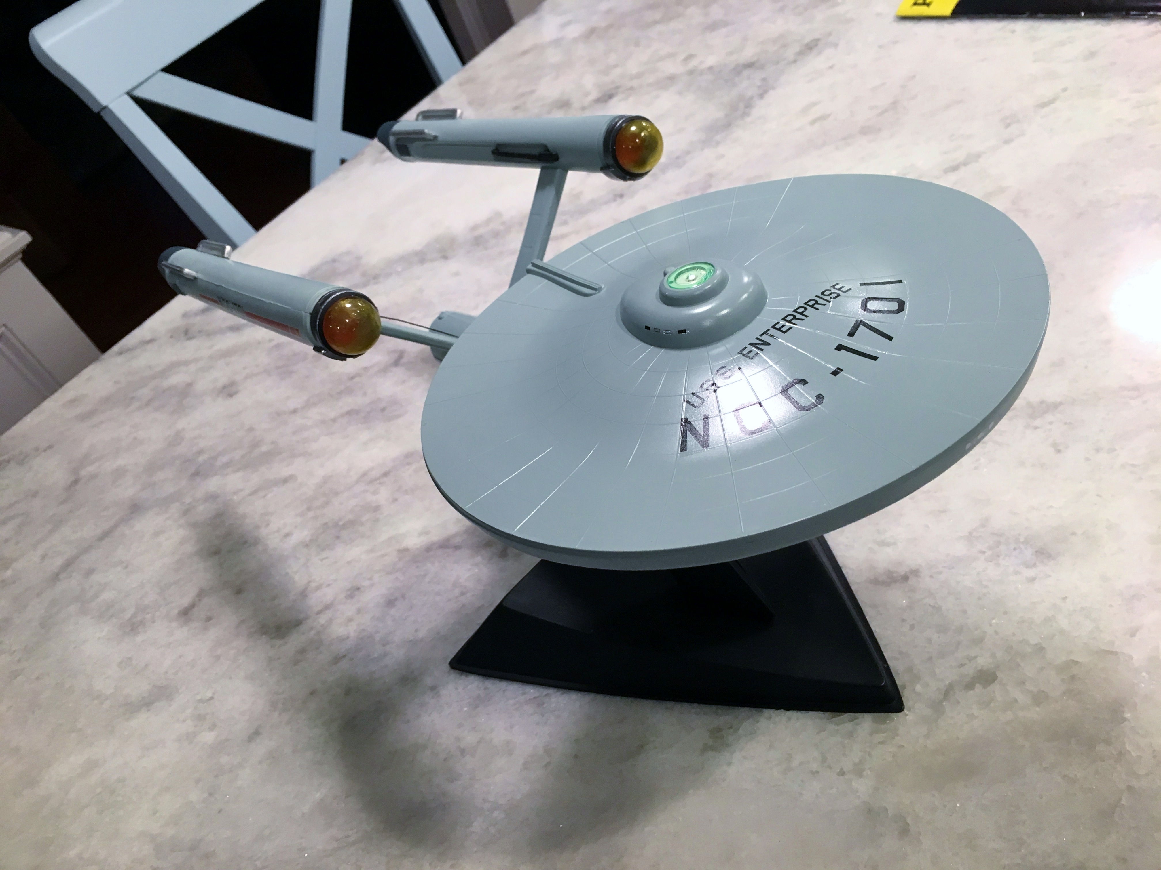

OK, mocked up the nacelle domes for a low-res photo so as to limit showing how messed up they are. It's a gestalt thing, just looks like the Enterprise now, kit inaccuracies and limitations of the builder aside.
1032872
Most kind, esp. since what I'm doing involves no special skills.
Sprayed the upper saucer with Tamilya gloss clear today. Its likely the only part of the ship I will do this to, just to create the right level of sheen to match the box cover.
The black electrical tape wrapped on the insides of the nacelle tips does a good job of light blocking, will allow the caps to be put in place without gluing, and works well to seat the light bulb base plates again without gluing.

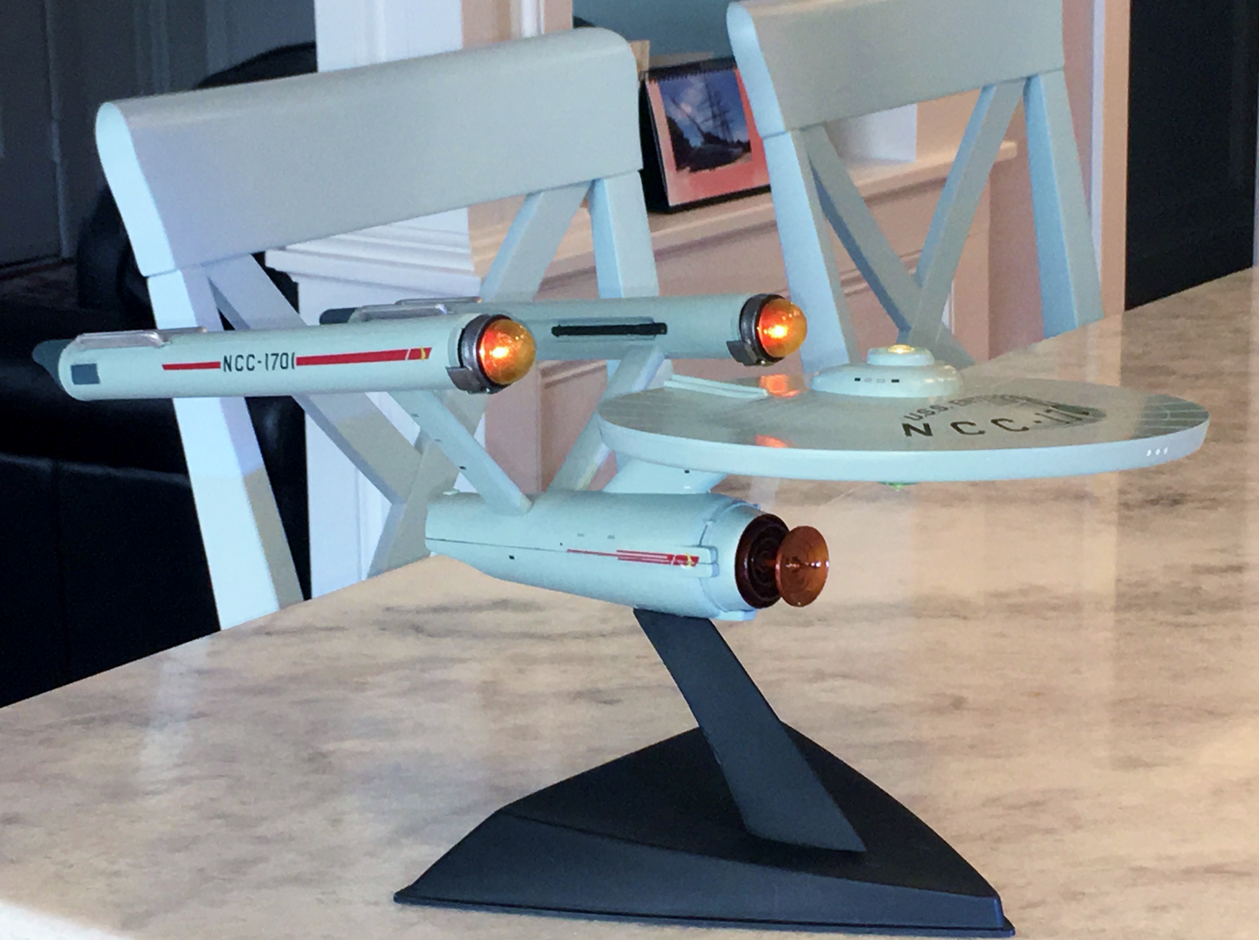

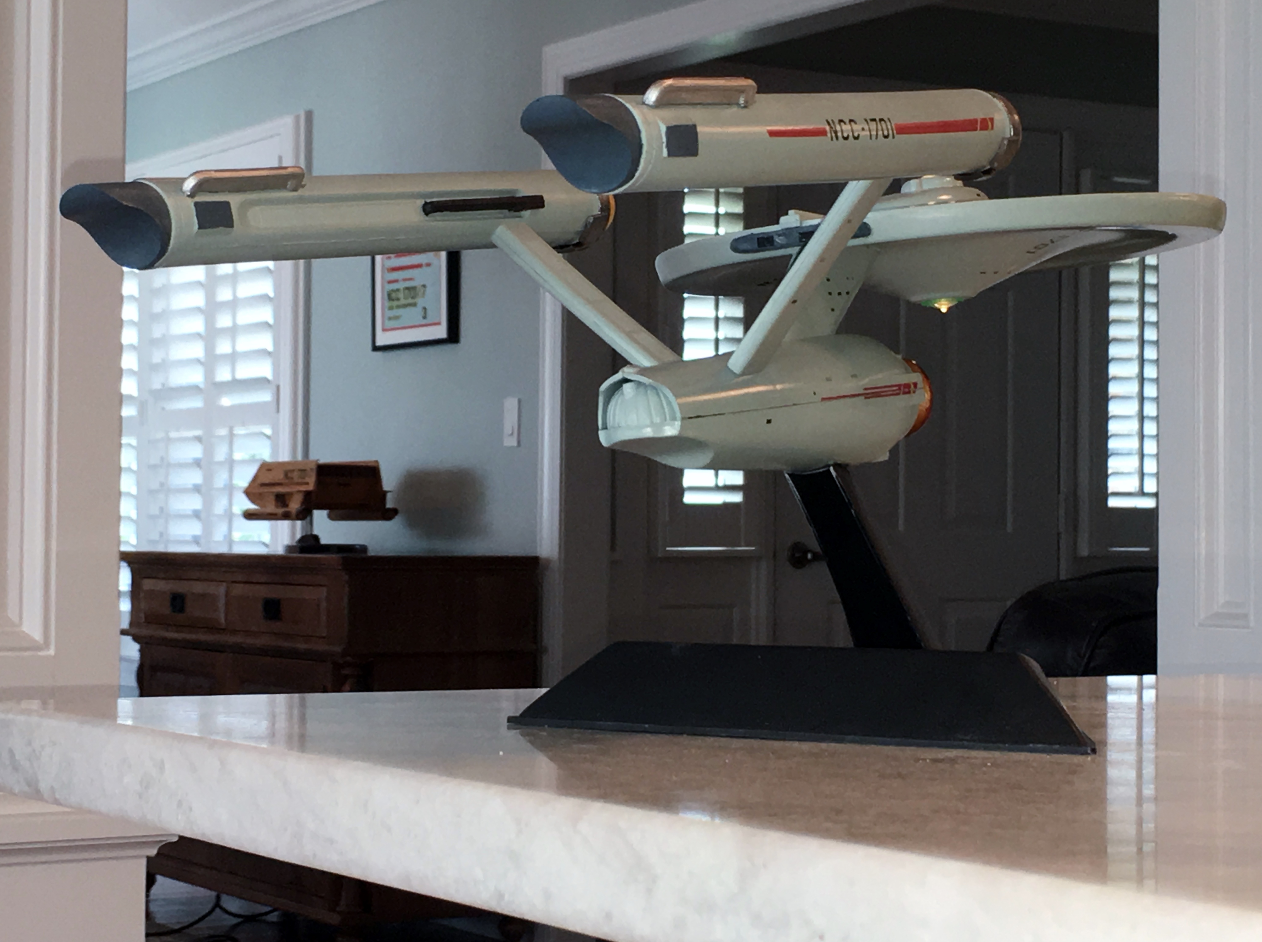

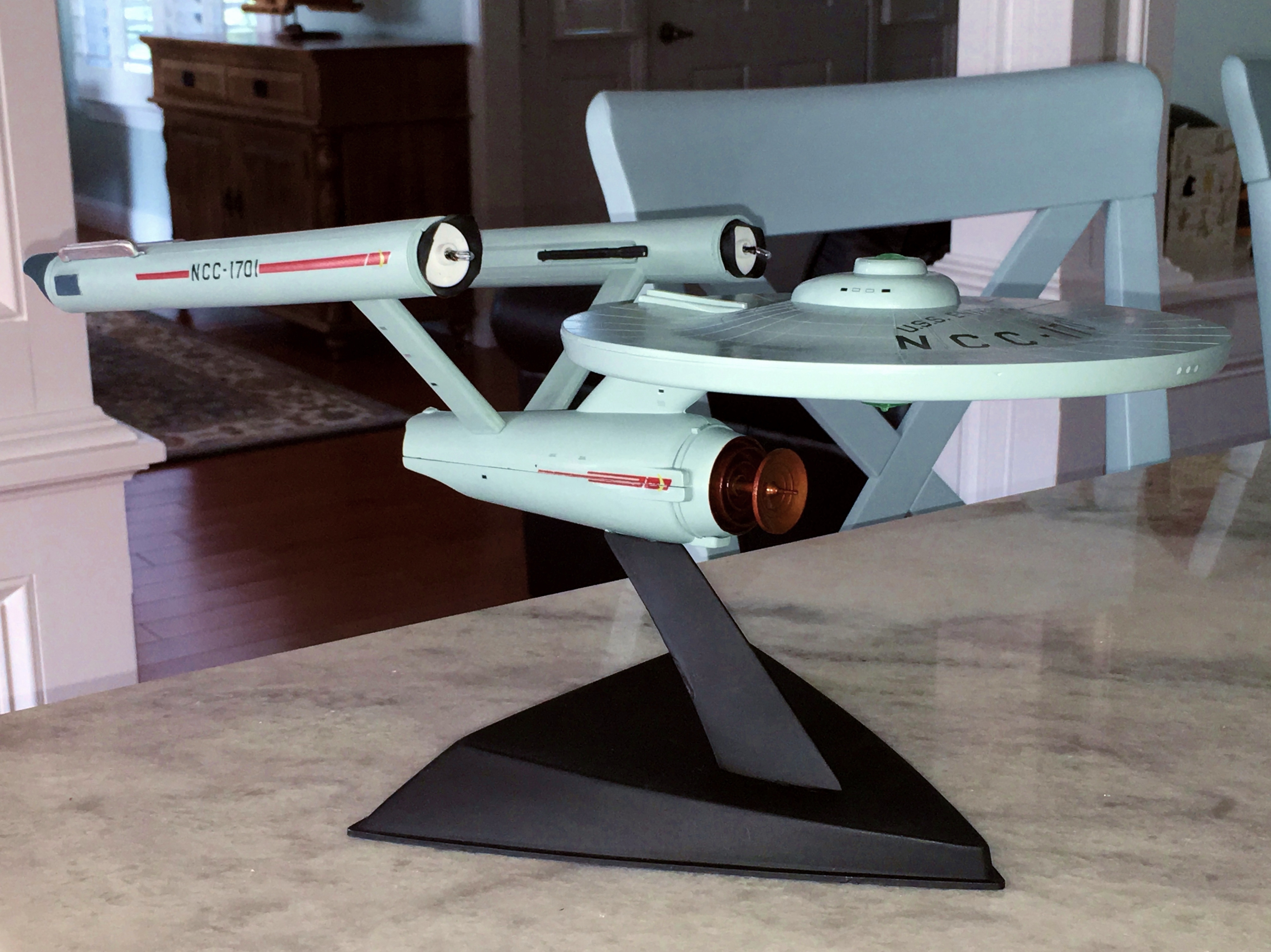

ON EDIT: Decals finally arrived (by pony express I think), started applying, some tough decisions based on what I think I see on the box, what is obscured by the saucer, and by the shadow at the top of the starboard pylon...
1033652
(couldn't resist tweaking the color saturation in these shots:cool:)
1033655
1034381

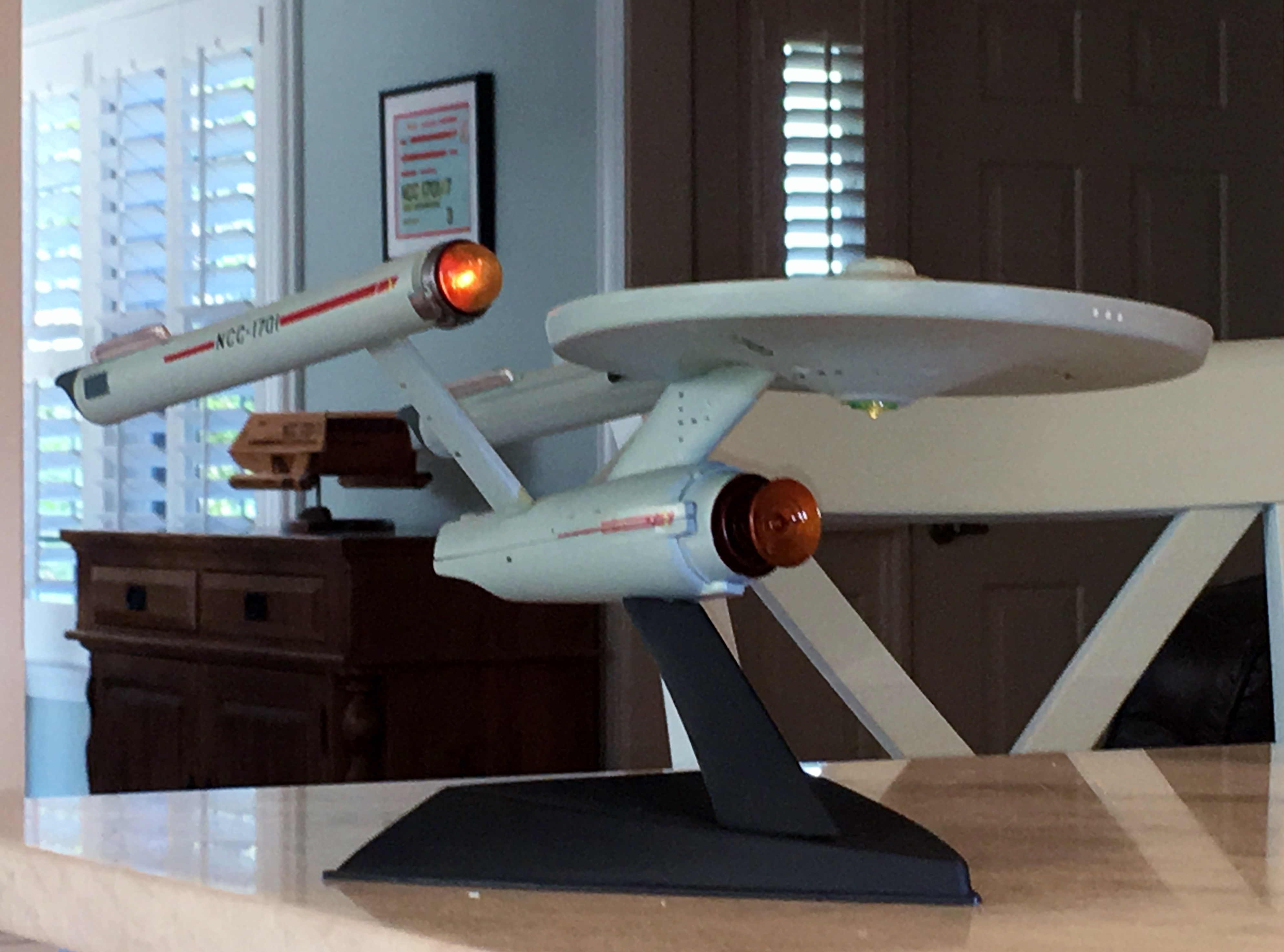

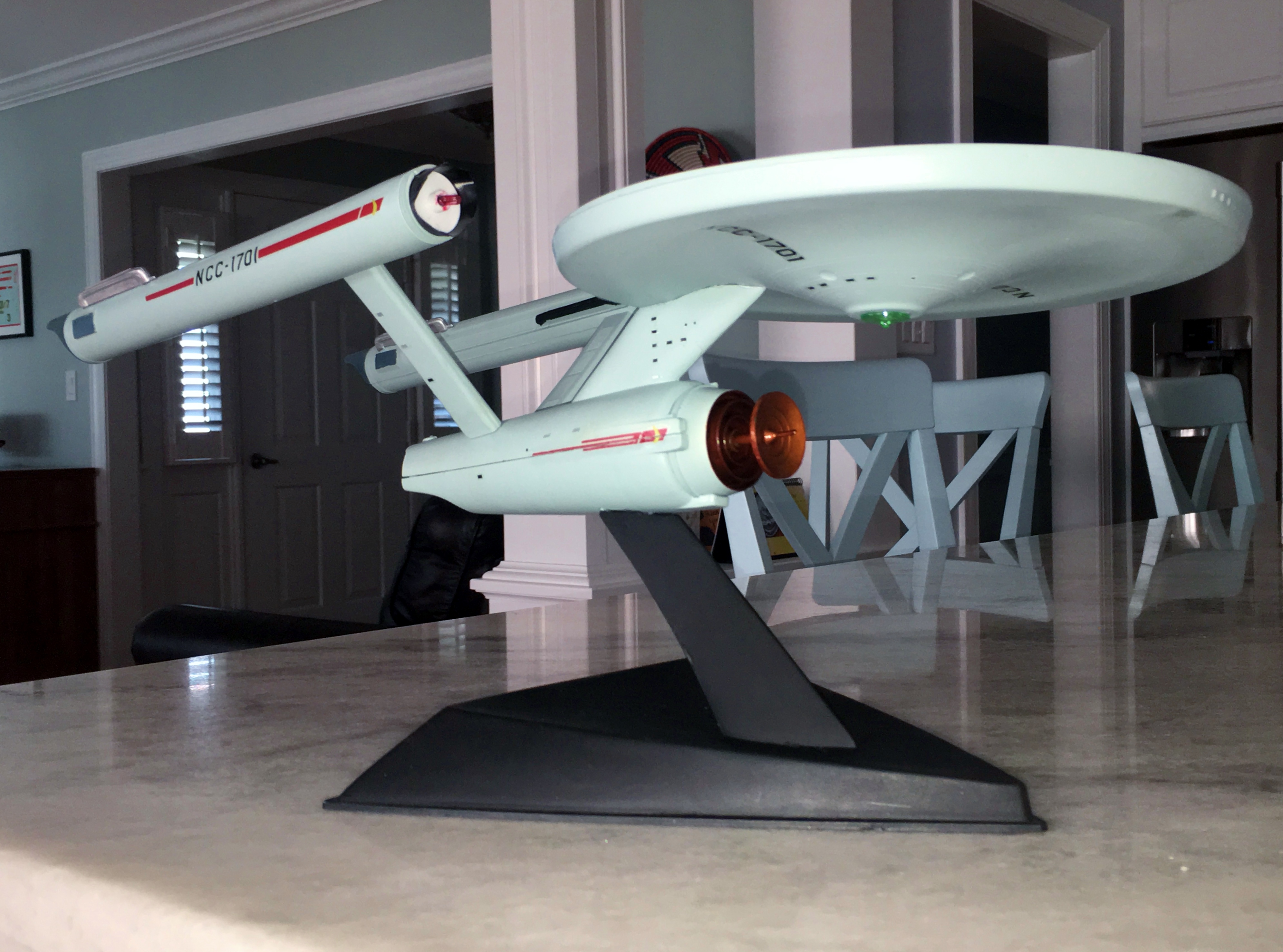

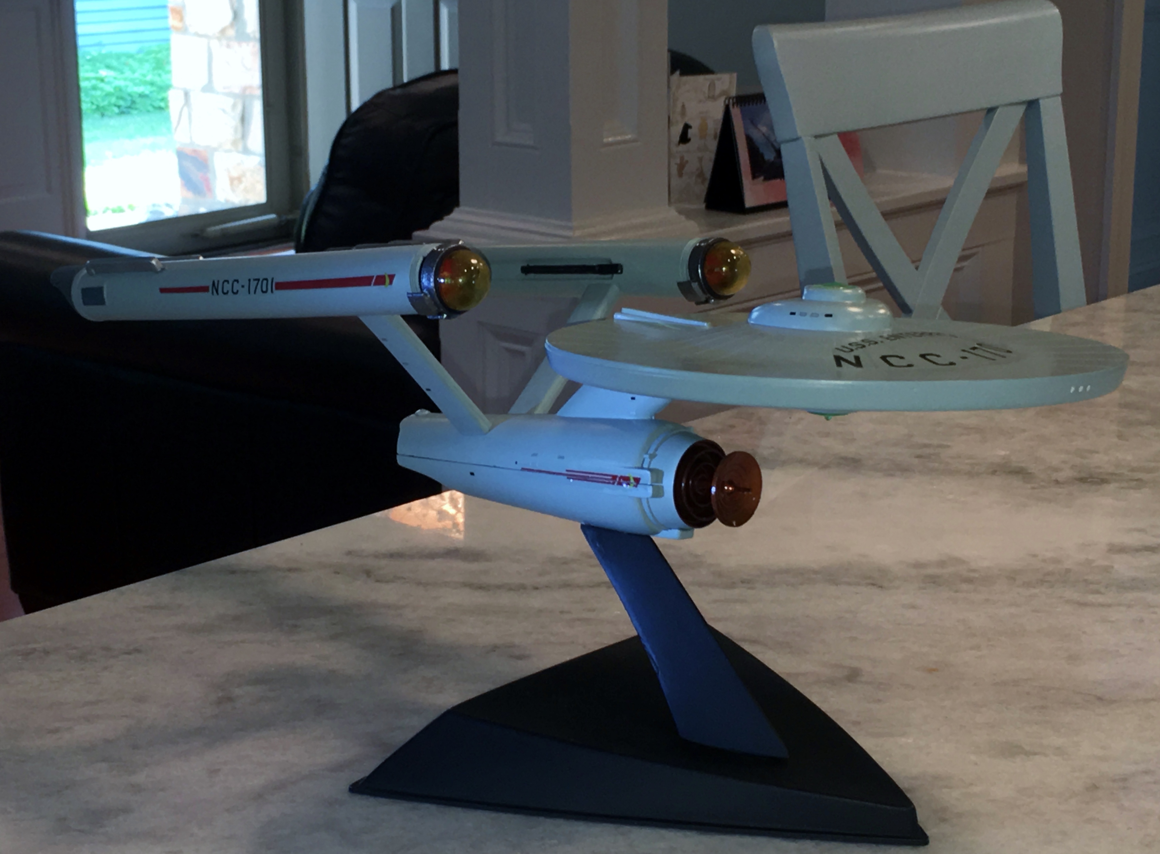

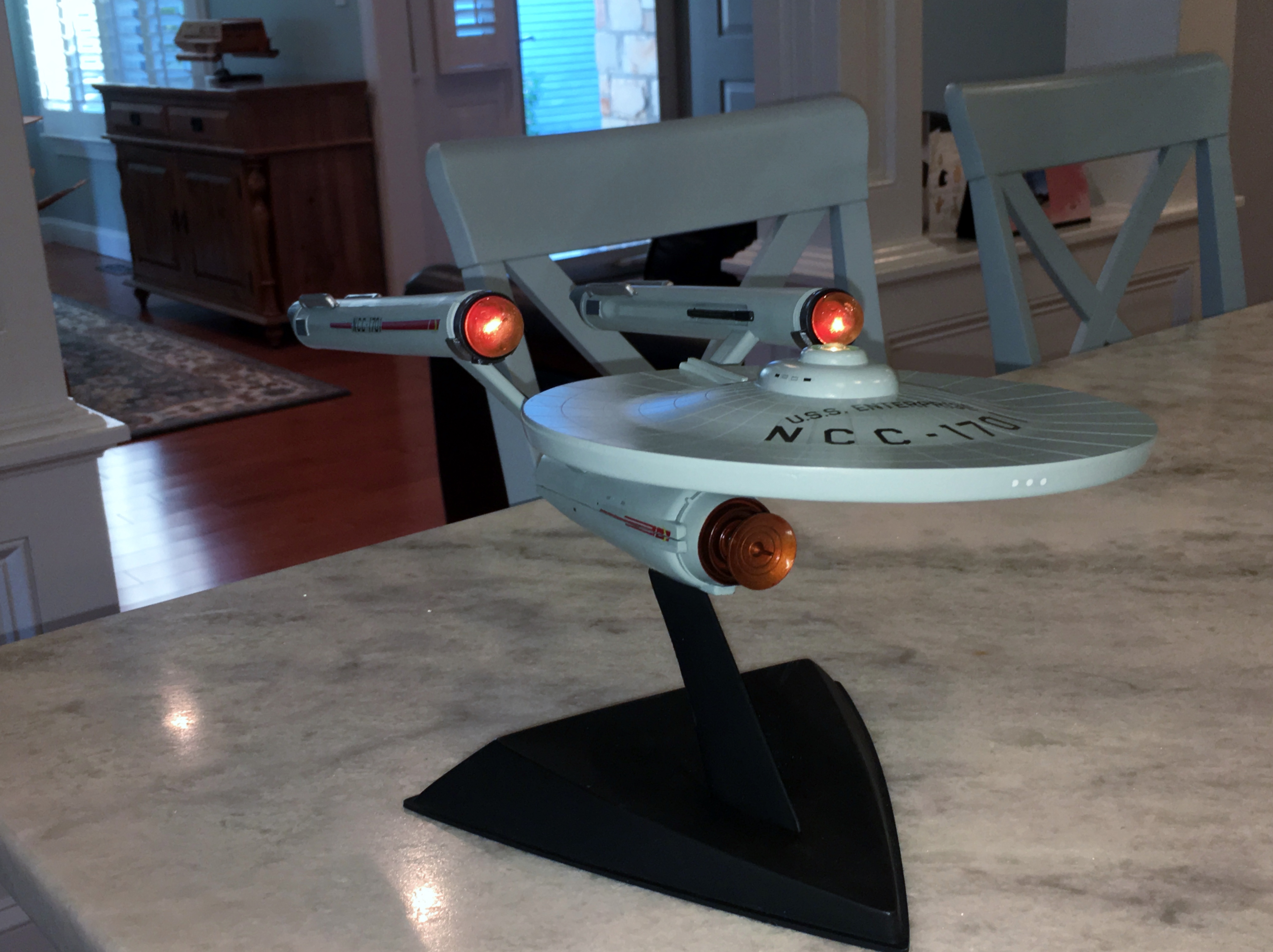

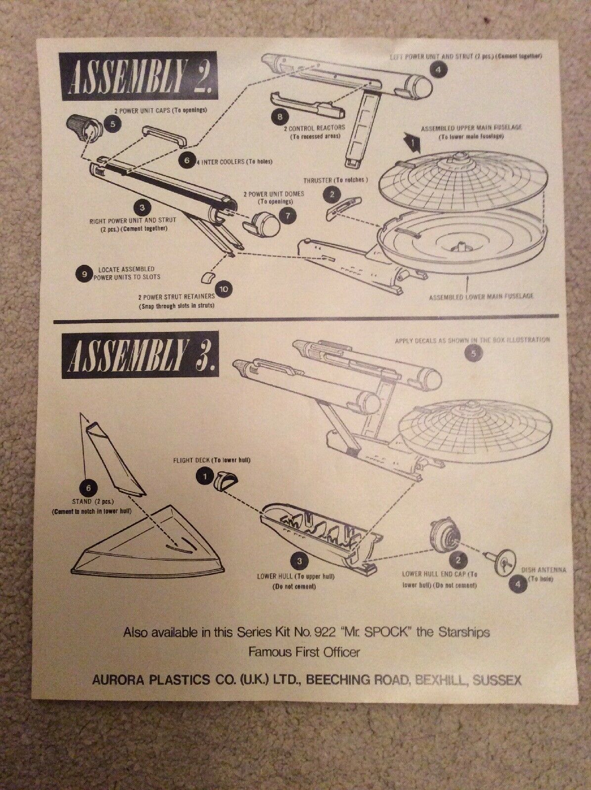

Was able to find another early kit with the orange domes; interestingly this kit did not have the lighting. I had read that some AMT kits (and I guess the UK Aurora issue as well) still had orange domes to "use up stock" even after the lighting was deleted. Oddly, they still advised in the instruction sheet not to glue the lower secondary hull in place, which I can't understand since the only reason not to do that (and to have to slice the starboard side pennant in half longitudinally) would be for battery access.
Waiting on the second set, but here's another test of nacelle domes - the first ones that I ruined - more for color than anything else (using a red marker on the bulbs didn't really make much difference). Also since they were ruined anyway, I experimented with a black marker to achieve a crisp transition around the edges of the lighted domes - an effect I will try to achieve (with better results I hope) using paint when I get the second set of domes.
Still, kinda close to the Enterprise I remember as a kid...
1034695
1034646
1034647

But...they just snap in place. See “Assembly 2” in instruction sheet screenshot above. No glue necessary. And benefit of that is you can pop the bottom seco. hull off and easily remove the nacelles (say for storing the model safely). Maybe that is why the unlit Aurora kit instructions above also say not to cement the lower secondary hull in place.
