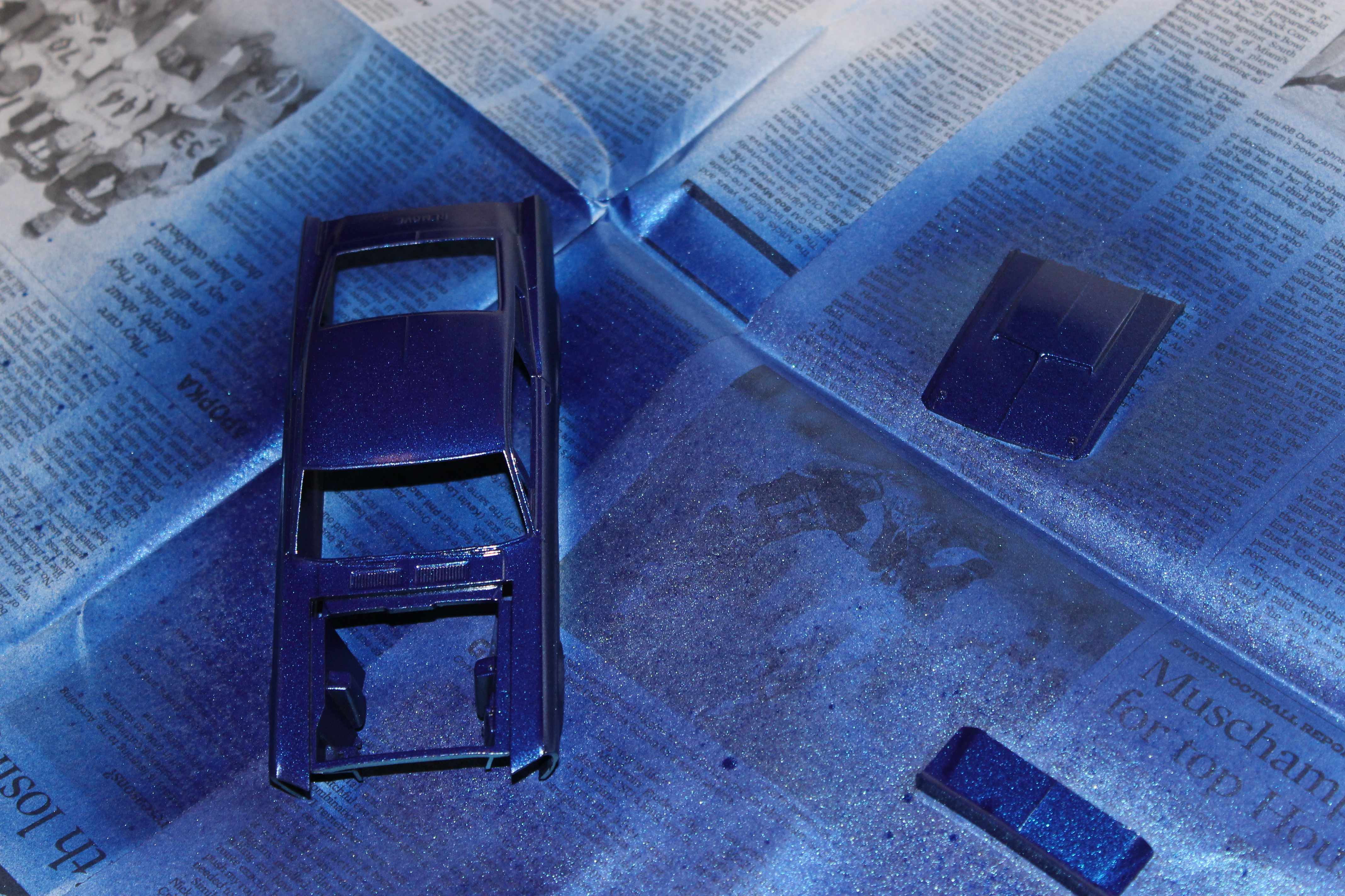

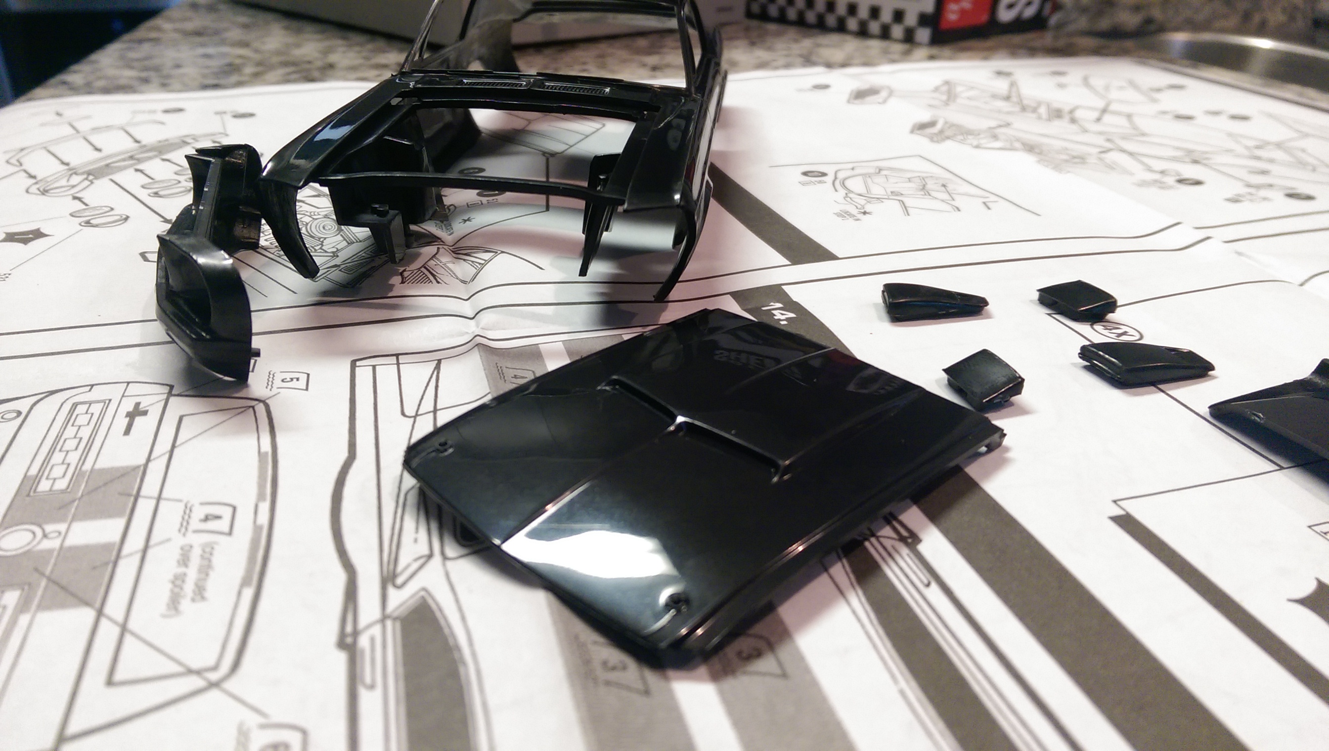

Hey all, long time RPF stalker - first attempt at modeling.
I've always loved this car - and since I'll probably never own a real one, I figured this would be as close as I could get.
I've only painted it thusfar. pics below :)
Also, any suggestions or tips would be greatly appreciated!
Disclaimer: I used my phone to take the unpackaging shots then my DSLR for the painted portions. The DSLR made it appear to sparkle a bit more than in actuality.

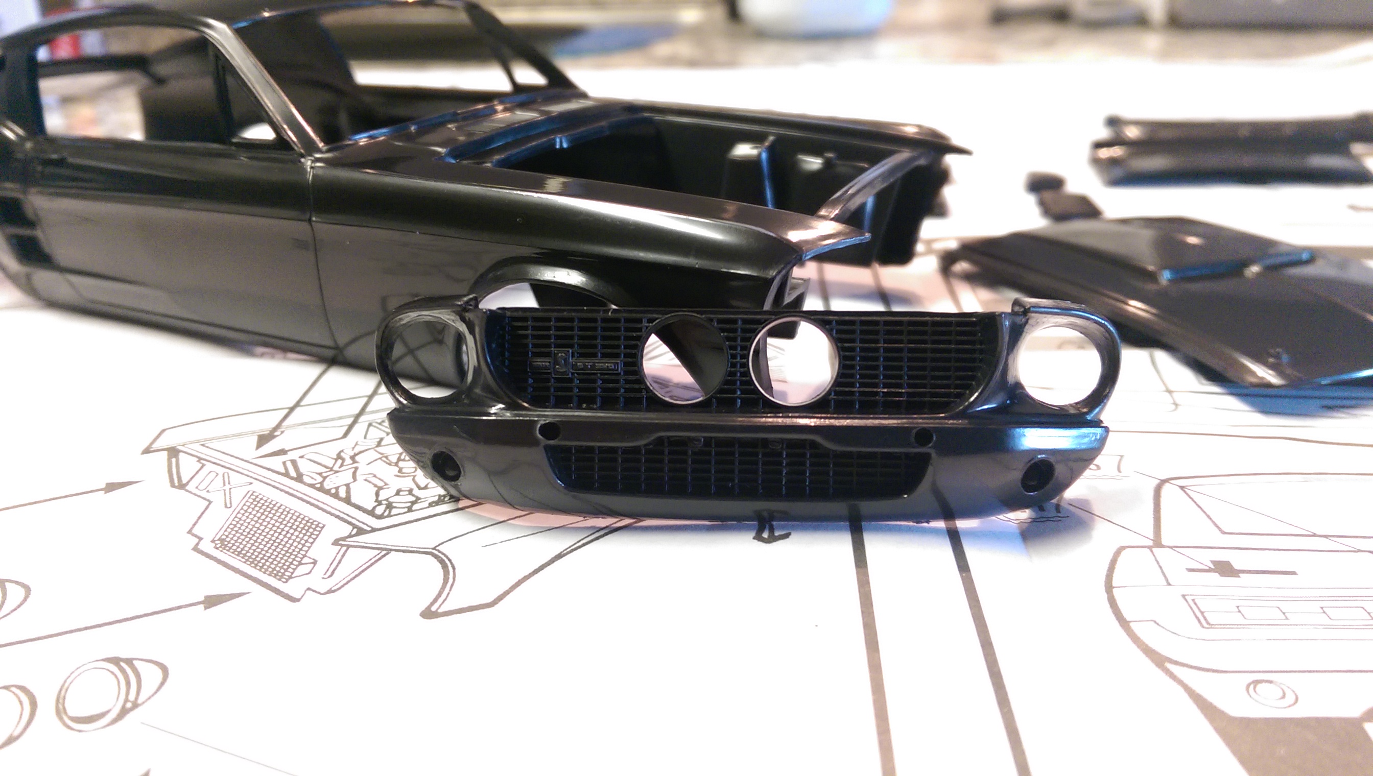

So I've accidentally over-spray painted the grill and nuked the Shelby logo :(
Here's hoping I can xacto knife it back
If need be, you could get the 10-minute Easy Off oven cleaner and use that. I've used it many times to clean off spray paint that didn't come out great, but will require some scrubbing off with a toothbrush for those hard to reach spots. I'm sure others will give better suggestions on how to clean off such parts.
But so far, it looks really promising and can't wait to see the end results. :)
Thanks for the tip! I tried some nail-polish remover - no avail. So the grill logo is just gone for the time being :(
Also learned to glue (plastic cement) parts before painting, while putting the engine together :p
Now I'm "unpainting" the engine...

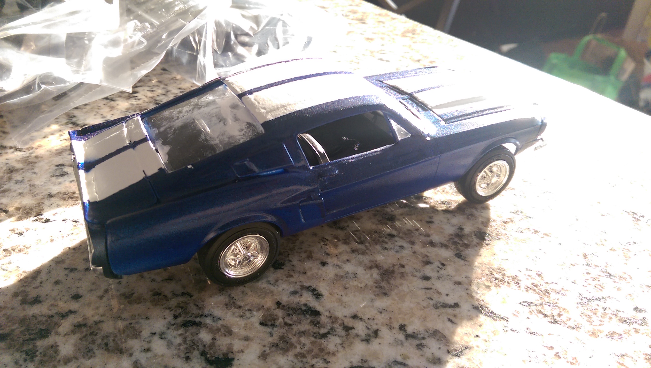

A few progress shots.

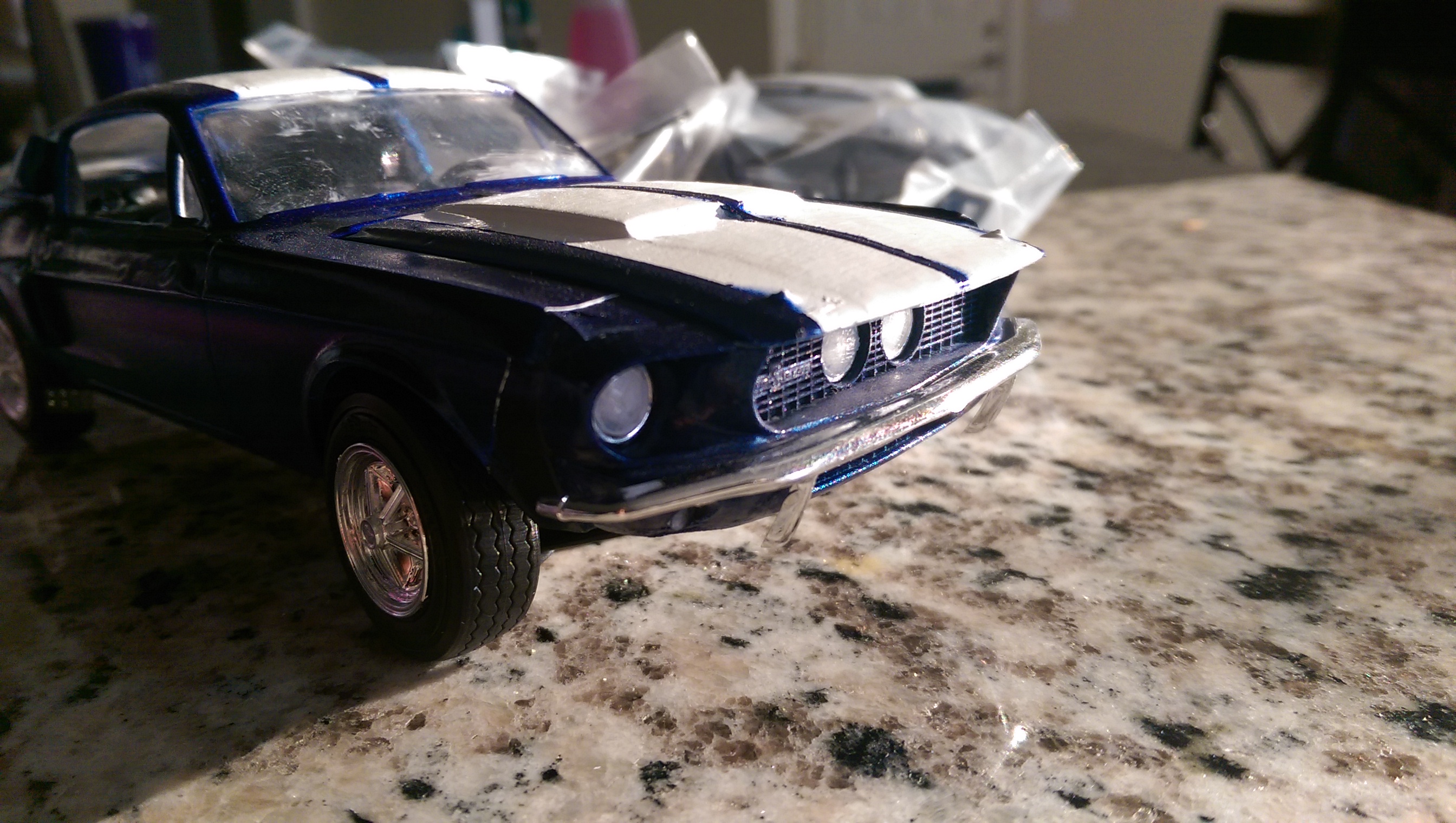

I'm kind of at a standstill due to not having super glue on hand. Apparently the chrome pieces don't care how much liquid cement I use on them lol
In this shot, you can kind of see where the Shelby grill logo used to be.
I also screwed up the front windshield a bit :(

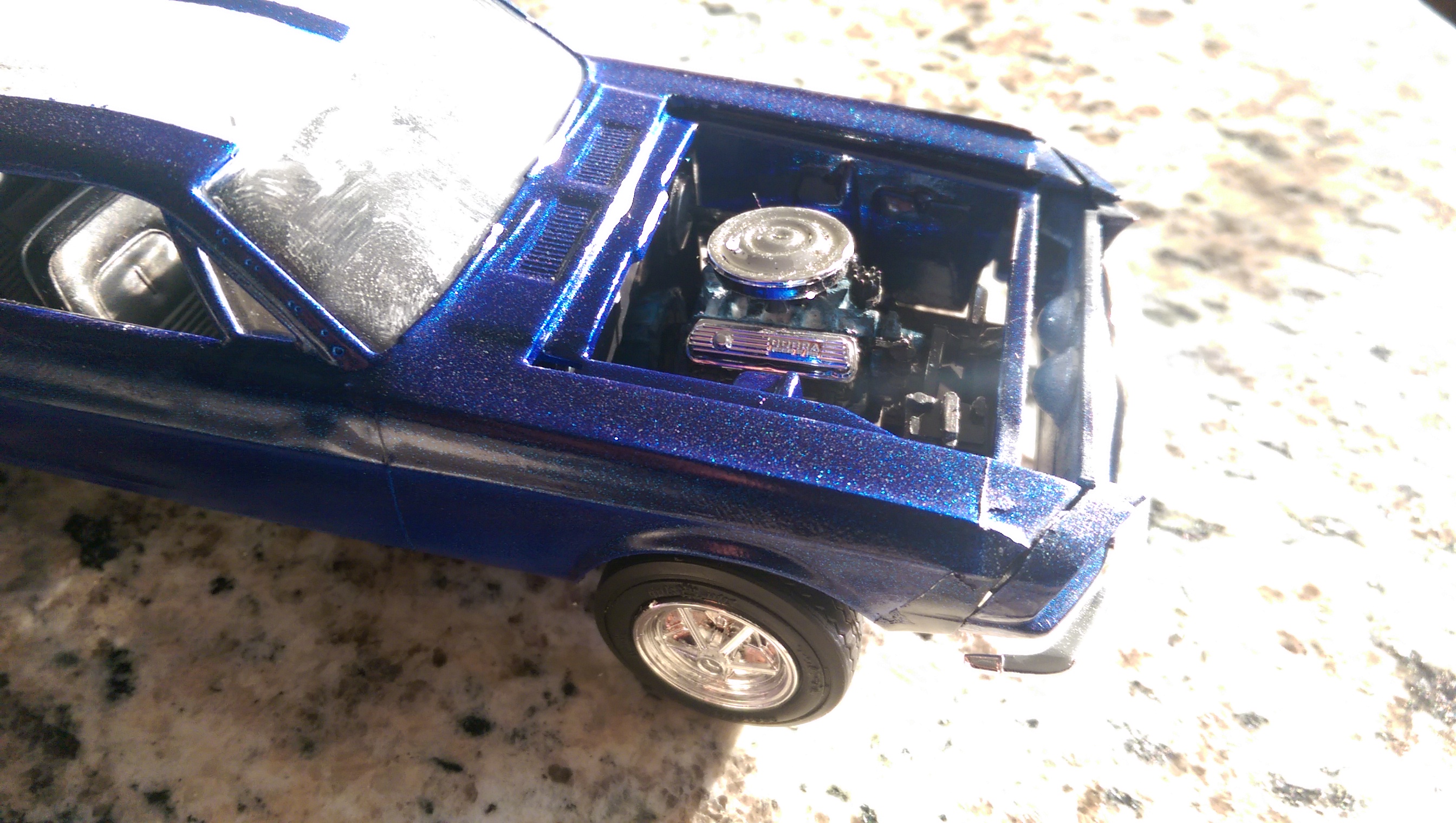

It's apparent in this shot that I should have glued on those intake parts before painting the body - now they're a bit inconsistently colored.
Just to let you know, the Easy-Off is primarily best for large parts, but a small piece like that shouldn't be a problem, but it's best to get off as much paint as you can in between rounds and then repaint it all over again (that's why I recommend the 10 minute Easy-Off, because its a shorter timeframe to work with. Using a toothbrush, or maybe a scrub brush to scrub the piece as good as you can so to try to get as much of the paint off of it. It may take a few times to do the trick though).
No super glue required. The chrome must be gently scraped off with a blade exposing the plastic in order to adhere. If you use super glue, eventually the bond between the chrome and plastic will break down and the part will fall off anyway.

I feel like stripping all the paint will only damage the unit further; and is probably a bit more involved than I'm currently capable of. So I've abandoned all hope but, I'm okay with it as a first project. It was an absolute blast to work on. I'm sure I'll buy a new kit after I've racked up some more experience and (hopefully) make a true beauty :)
Posting a few images of the final (really crappy) product.
