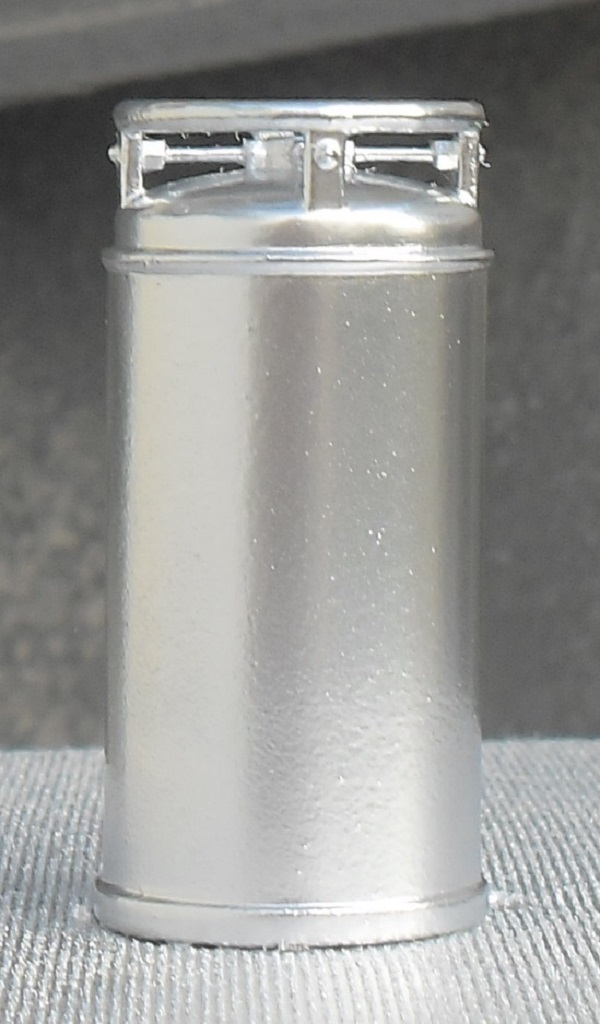

I've found that Halfords (if you're UK based) do a very good chrome spray paint.
You need to prep the surface so it's smooth. I found using a plastic primer filler then a black gloss as the undercoat is best. I made the mistake of putting a second coat of chrome on too quickly on this item. So when I picked it up the paint was still malleable and it dulled the effect on the top.
But you can see that it's pretty good and in the bits I've not touched with my fingers it's highly reflective.
