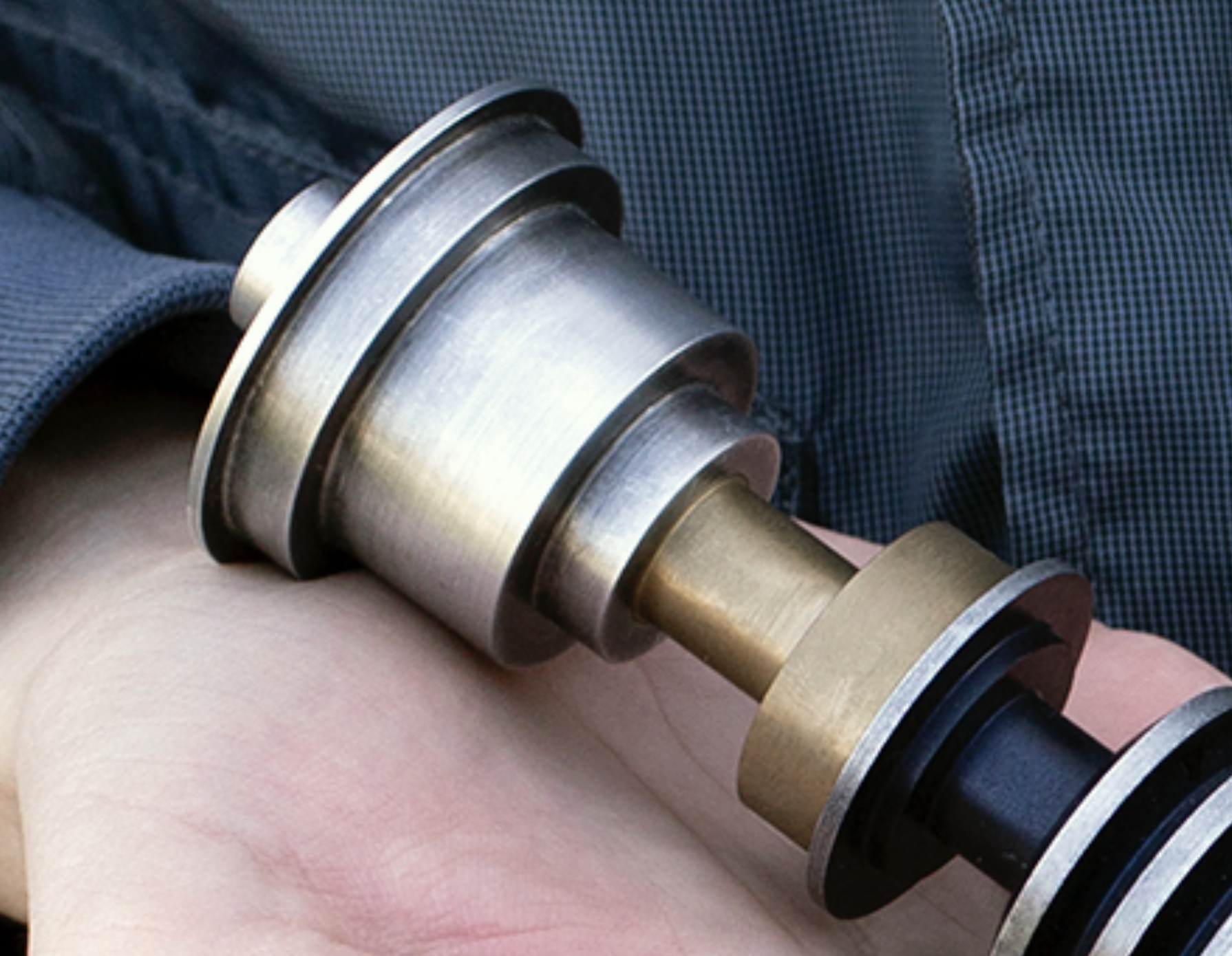

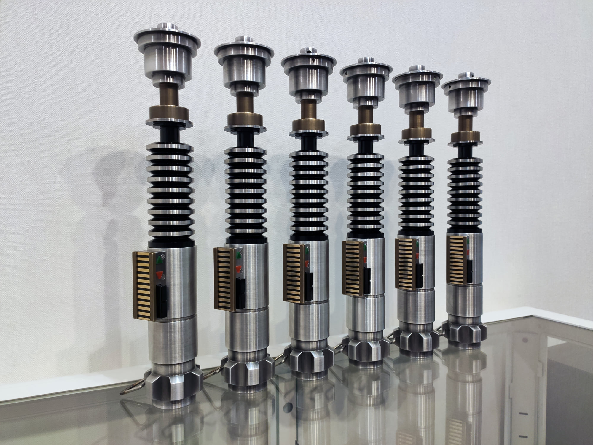

One thing I love doing is weathering, but there's a technique out there, I simply can't replicate no matter what I try. Even aluminum Blue, I can't seem to get this close, it's wonderfully even, and this looks to be something different then just aluminum blue and removal. Any thoughts how I can achieve this look, exactly? The subtle look and gradation is beautiful.

The photos you posted look like parts were darkened and then put on a lathe to spin - that is how you get the even finish. You can achieve similar results by running long bolts through various parts and spinning them with a hand drill. Outside of that, I have learned to dilute whatever chemical you are using (brass black, aluminum black, etc.) and applying multiple applications to get your desired finish. Fine steel wool is also your friend here.

The best results from aluminum black I ever had were from putting a few drops into a small container filled with water, rubbing the part all over with steel wool, then dropping it directly into the bath. It slowly, slowly darkened and once it was at the level I liked, I pulled it out, rinsed it off, and gave it another rubdown with the steel wool. The results looked very similar to the OP's photo.

You're not right, we didn't use a lathe or a drill. Also this was made not by steel wool :)
I can't tell about our secrets but the main: you need to prepare all the parts before using any chemistry like Alu black (we don't use this compound btw)
