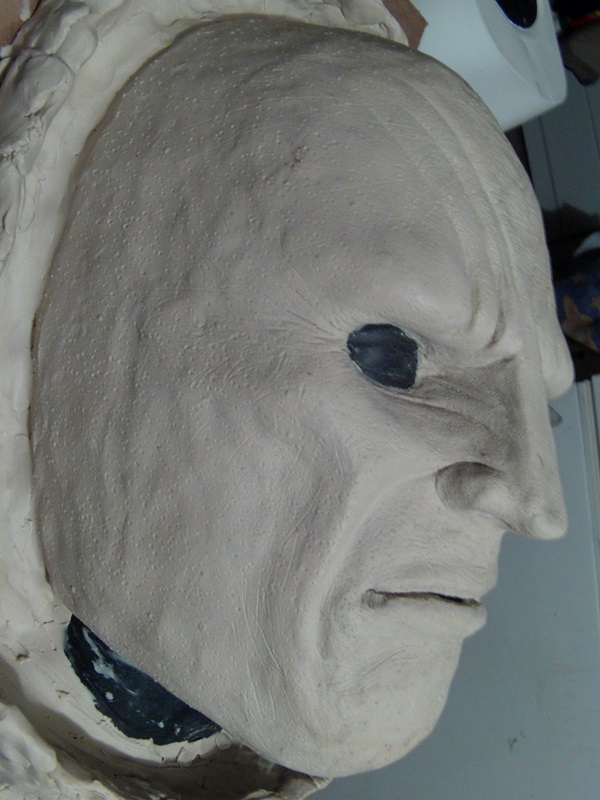

Here is the sculpt.
I changed the nose a bit. I saw where the sculpt was going and noticed it looked a bit like Street Fighter's Akuma/Gouki. So I decided that after this costume, I will cast another mask as Akuma. So this is going to be a one face works for all sort of things.
Also I left the expression in a neutral state, but I left creases, and folds in areas were that would increase expression.
I plan on punching hair, and adding a custom wing.
I did not use a life cast of my face. This is a mannequin head. If I need to I will add foam to form fit the cast were needed.
I hope to share more as this costume progresses.

After looking at the pictures decided to cut an inch off of the lower chin.
I also added a slight brow ridge over the nose to be a bit closer to the source material.

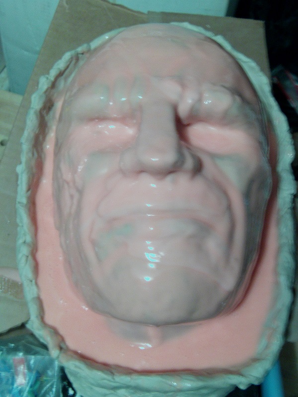

Molding has begun.
This is just the print layer. It has good coverage, so the next layer is going to be slathered on with some thivex.
It is pretty tedious molding a sculpt. It has to be my least favorite step in production.
This is the first time I have made a channel/mote/ clay wall around my sculpt. Most of my molds are glove molds.
So seeing how much silicon just washed down the sculpt was interesting. I used about a pound of it.
It is a bummer more of it couldn't stay on the face. Even so the strength of the molds edges should be pretty sturdy.

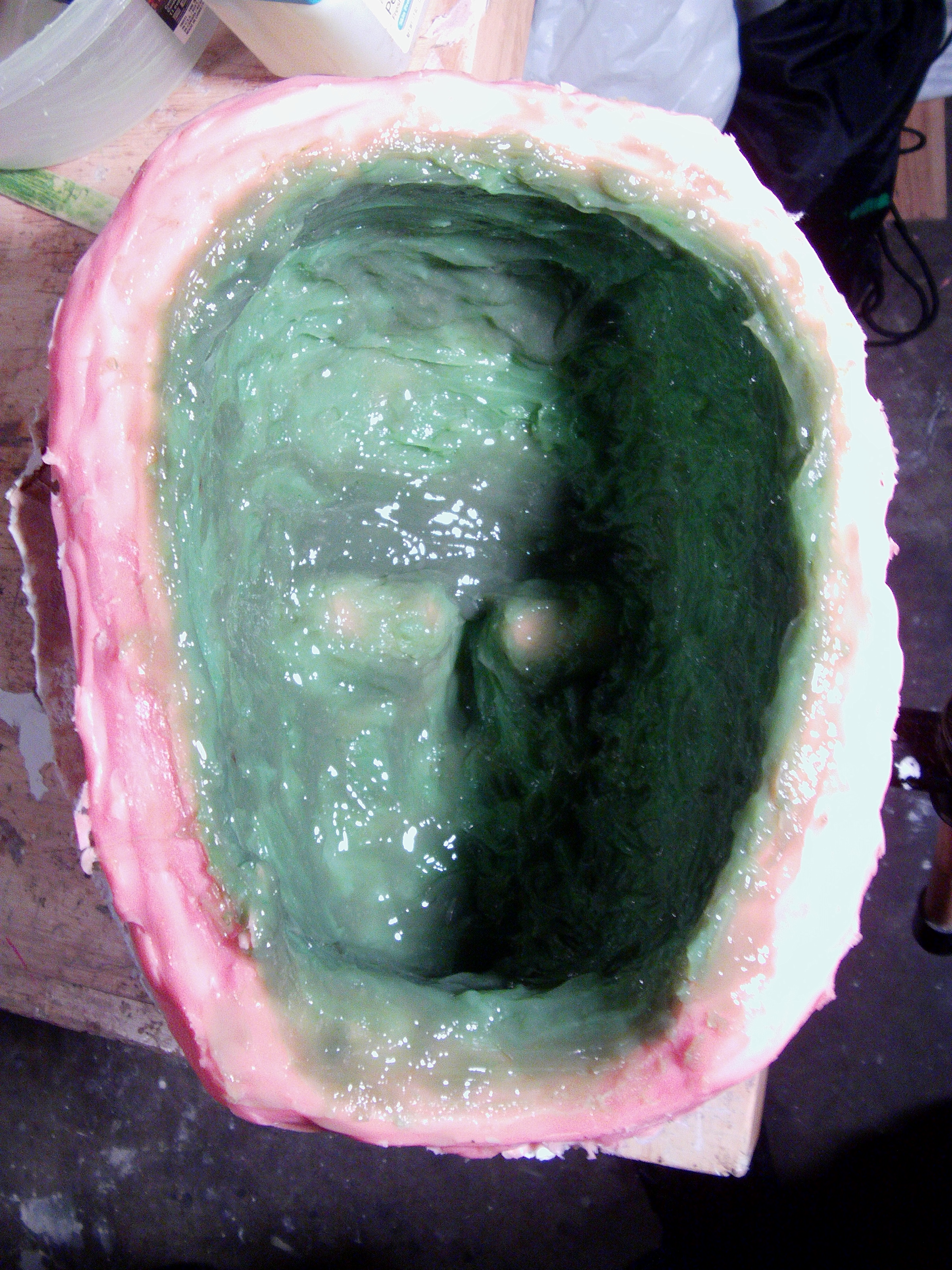

I just finished the mother mold a few days ago. I used plaster bandages, but didn't rush things. I let it dry after applying the bandages two days ago.
This morning I did something different and brush plastic resin over the mold to give it extra strength. Not a lot of plastic, just enough to give it a M&M shell.
I just finished brushing Smooth-on Dragonskin into the mold. I used about 1 and a half packages of 2 pound Dragonskin.
I could unmold it now, but I will wait until I can set up to paint it.
I hope I didn't get any air bubbles.

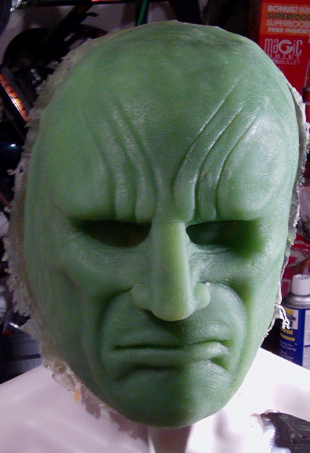

I finally pulled the cast. It turned out better than expected, but not perfect.
I have air bubbles but there are no air bubble holes. Since the silicon is transparent you can see some pretty big air bubbles right under the surface of the skin.
This is because I did not put Thivex (silicon thickener) into the dragonskin for the print layer. I just sloshed it around the cast. The other batches of dragon skin had Thivex and I just pushed it around the best I could. So there is at least a thin membrane of silicon all over the mask. When I paint the mask the air bubbles shouldn't even be visible.
So it came out 94% perfect. From the color to the thickness. I have put it up to my face and everything seems to be lining up great with my nose, eyes, and mouth.

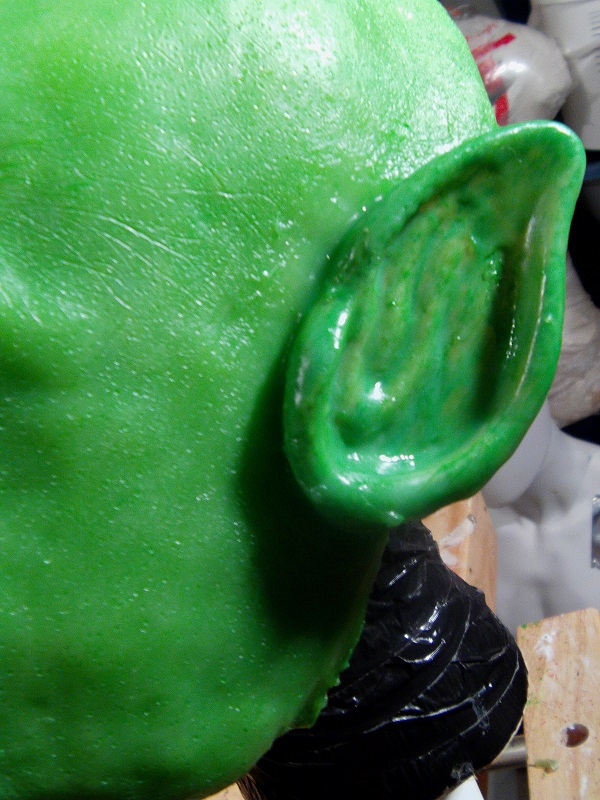

I ended up pinning some ears I purchased to the head. Then painting precured dragonskin over them. This attached the ears to the head, and it allows be to paint them with the same paint as the mask.
I tried airbrushing, but I either cant get the paint thin enough to run through the airbrush, or the little compressor I am using is not putting out enough air.
I brushed on the base layer. I think I will brush on the rest. I will try using the big compressor, but it is so loud I am second guising it.
