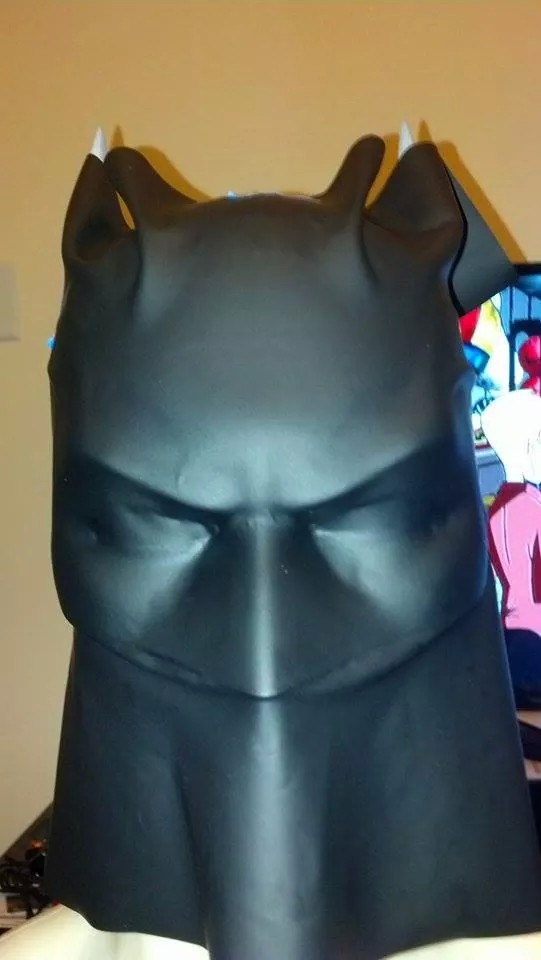

I want to make a fabric suit that fit within my version of Batman. I didn't want to make a full spandex suit like the comics and as I stated above I didn't want a rubber suit. Also I was trying to achieve the Holy Grail with the fabric cowl. My first suit was wet molded leather backed with upholstery foam sandwiched between two layers of fabric to get the muscle/armor appearance (attachment below, sorry I couldn't find a better picture). As for the cowl it was what I wanted but I just need to refine the technique for making it.

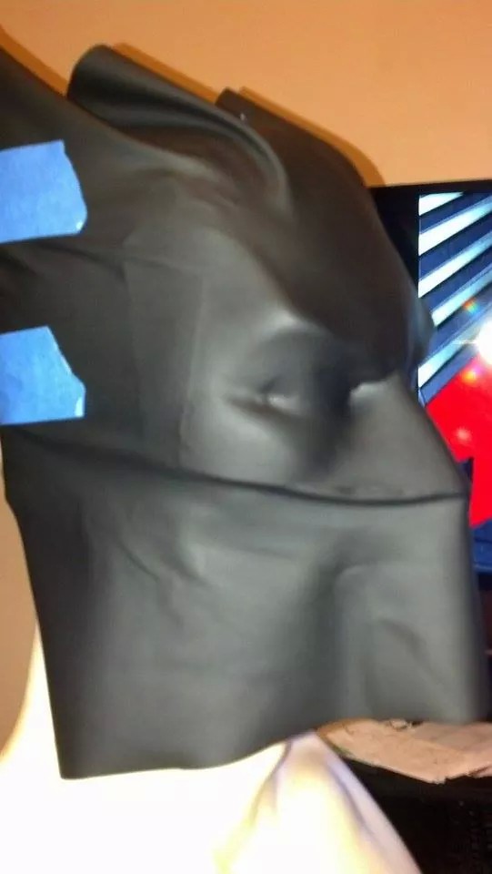

Cowl: I will be using the same idea for this cowl as my first (the attachment below) which is a 3D printed under shell that I skinned with 4-way stretch vinyl. This time around I'm going to skin the cowl in one piece of 4-way stretch pleather instead of 3 separate pieces (face, hood, ears). This should help eliminate the seam you see running down the center of the cowl. The cowl is great, you can slip it on and off like the comics/cartoons and pull it over your head with a little discomfort. I think I've figured out a way to solve the discomfort when pulling it back, I'll have to test it. If you're curious I had the shell modeled by Jordan over at Jordan's Ironic Armory.

I'm really digging that cowl bro! I'm a huge fan of the fabric cowls as opposed to the rubber ones. They look more natural, well depending on the suit someone would be going for.
joeed29
I purchased the same cowl shell from jordan, but have yet to start working on it.
How did you apply the fabric to the shell?

Thanks! I actually have a Reevz Arkham cowl which is what I originally planned to use for my first suit but then the look I was going for changed.
kashi41
It was a pains taking process, I have some pictures on my phone I'll email to myself to upload here. I did a small section at a time covering it with DAP contact cement and then applying the fabric. I had to make sure the fabric was pulled taught so there wouldn't be wrinkles but not too taught to pull away from the adhesive.
That suit looks awesome man!
