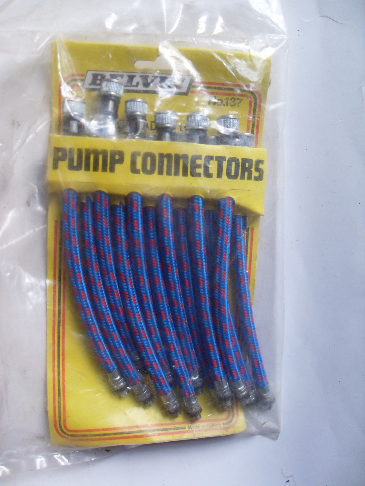

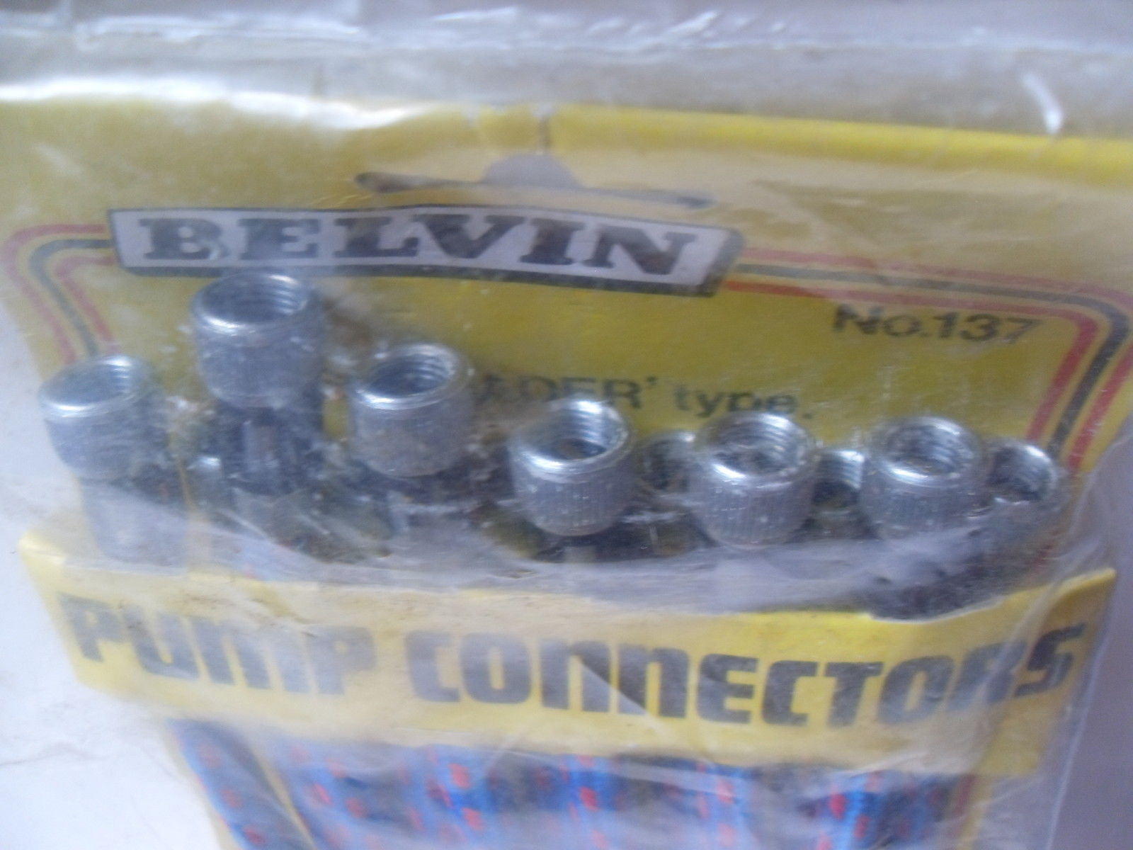

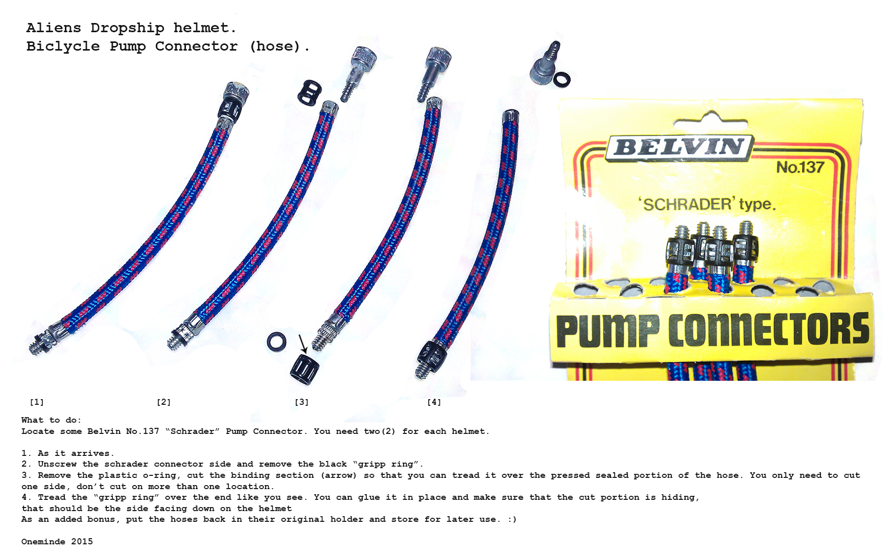

I have searched the internet wide and far, up and down, for the bicycle pump hose that people have been using, which also could be the very original one found on the helmets. I contacted multiple members regarding the hose, but no one really knew anything about the manufacturer. Well, I found that information. The producer is Belvin, an Italian company. I bought 4 of them because I intend to produce both helmets. Why one when you can have two.
There is more good news. As I'm writing this, there are 2 left on ebay. But at least now everyone know what to look for :thumbsup
Here is the ebay link: http://www.ebay.co.uk/itm/181662982579
9934448-792-640x478.jpgBelvin bike hose No.137 - pump connectors 1.JPGBelvin bike hose No.137 - pump connectors 2.JPG
And now there are zero left ... lol, kinda had a feeling that would happen once I informed RPF about them ... ha ha

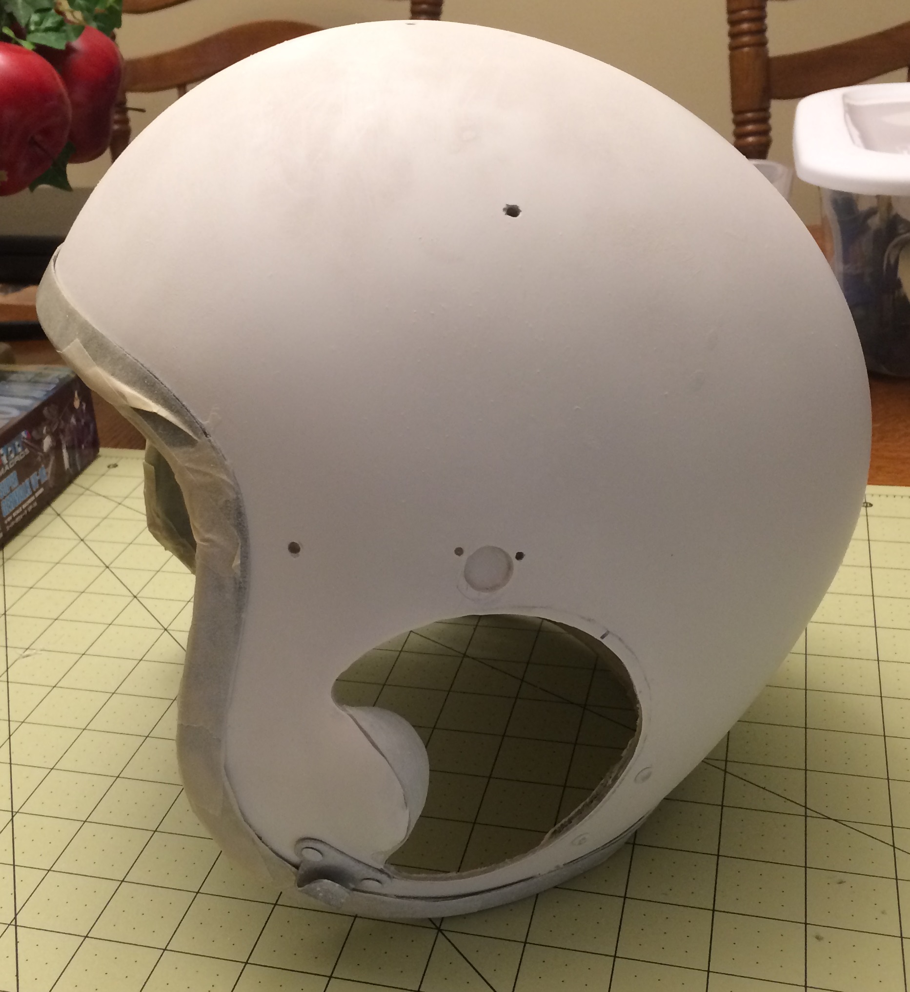

Thanks for the heads up on the cables. I am about to start work on my dropship helmet. I am going to be a little less picky about specific parts and am settling for resin casts of many items. I am also not going to chop up a vintage army SPH4 helmet but rather a much newer white one that has seen hard times. This cable info is def new to me and since I don't have those yet I will be looking for em.

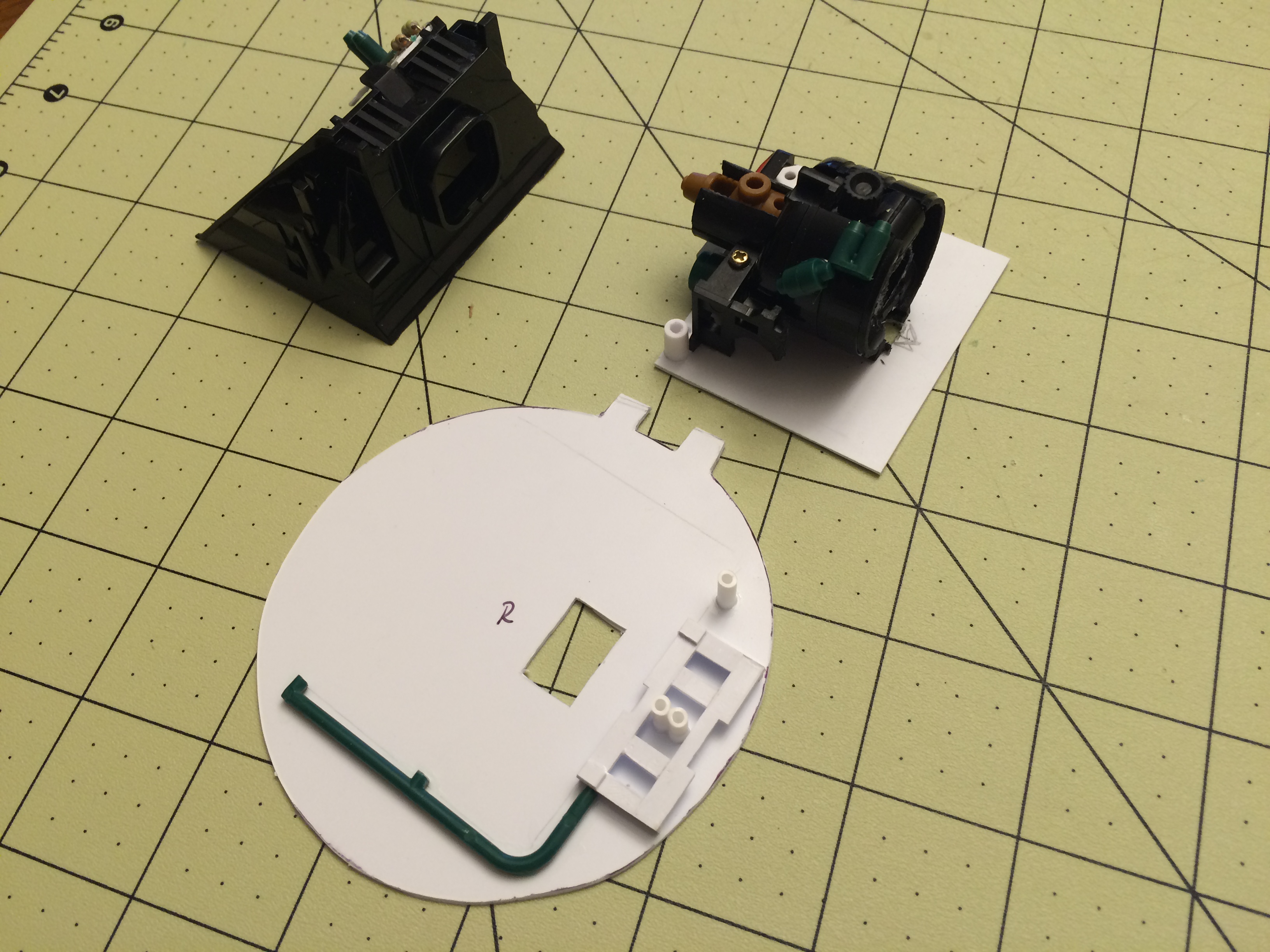

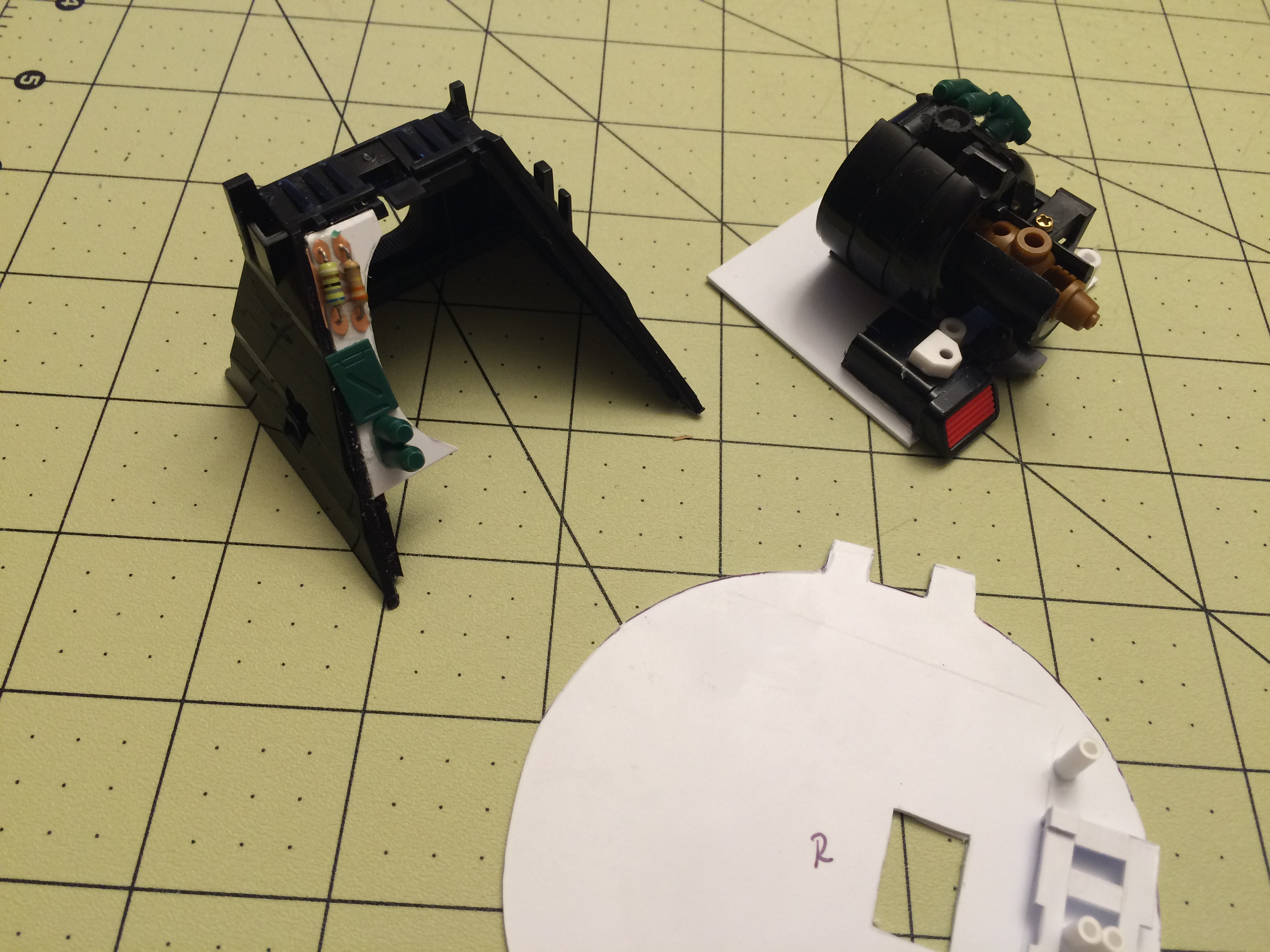

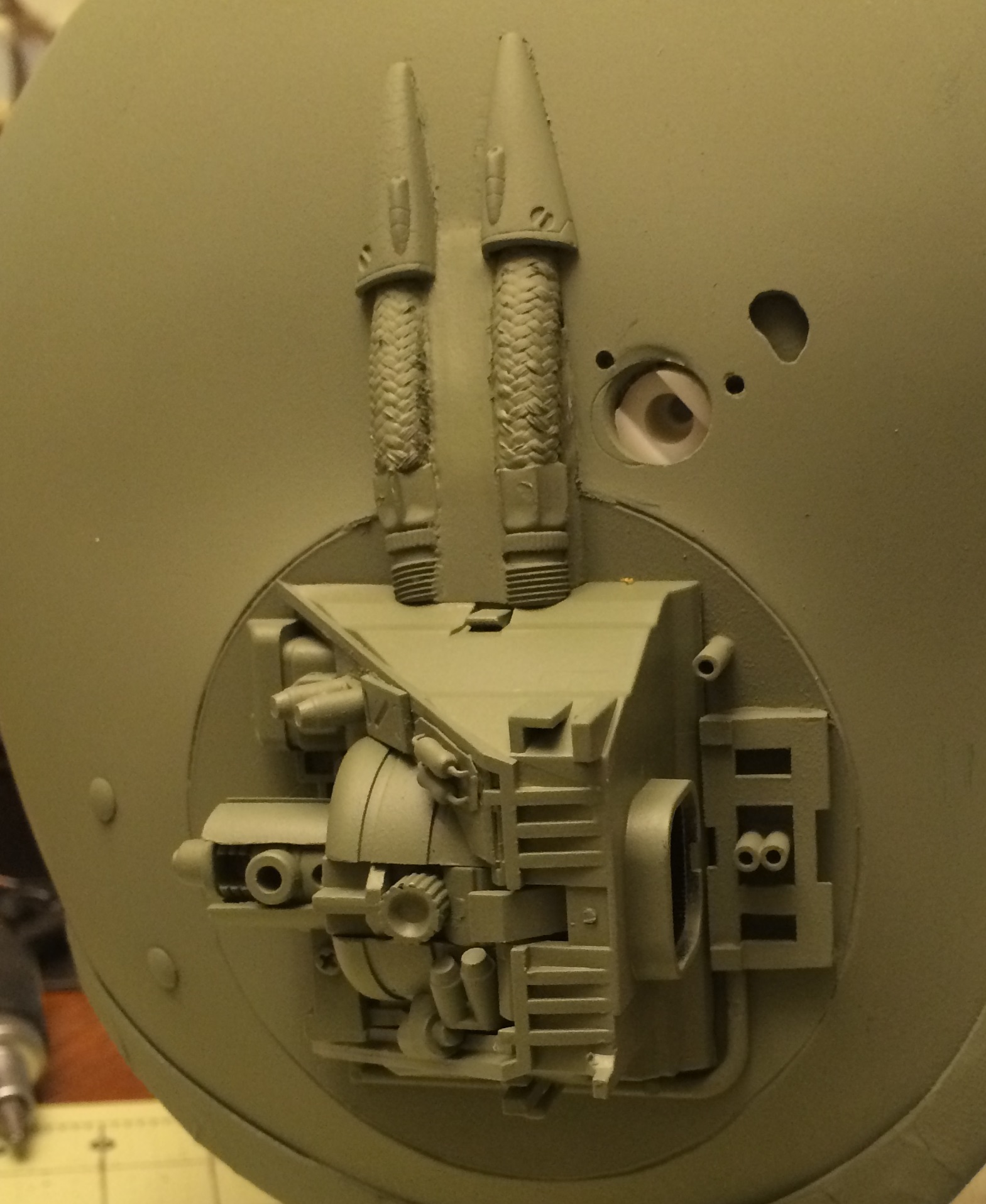

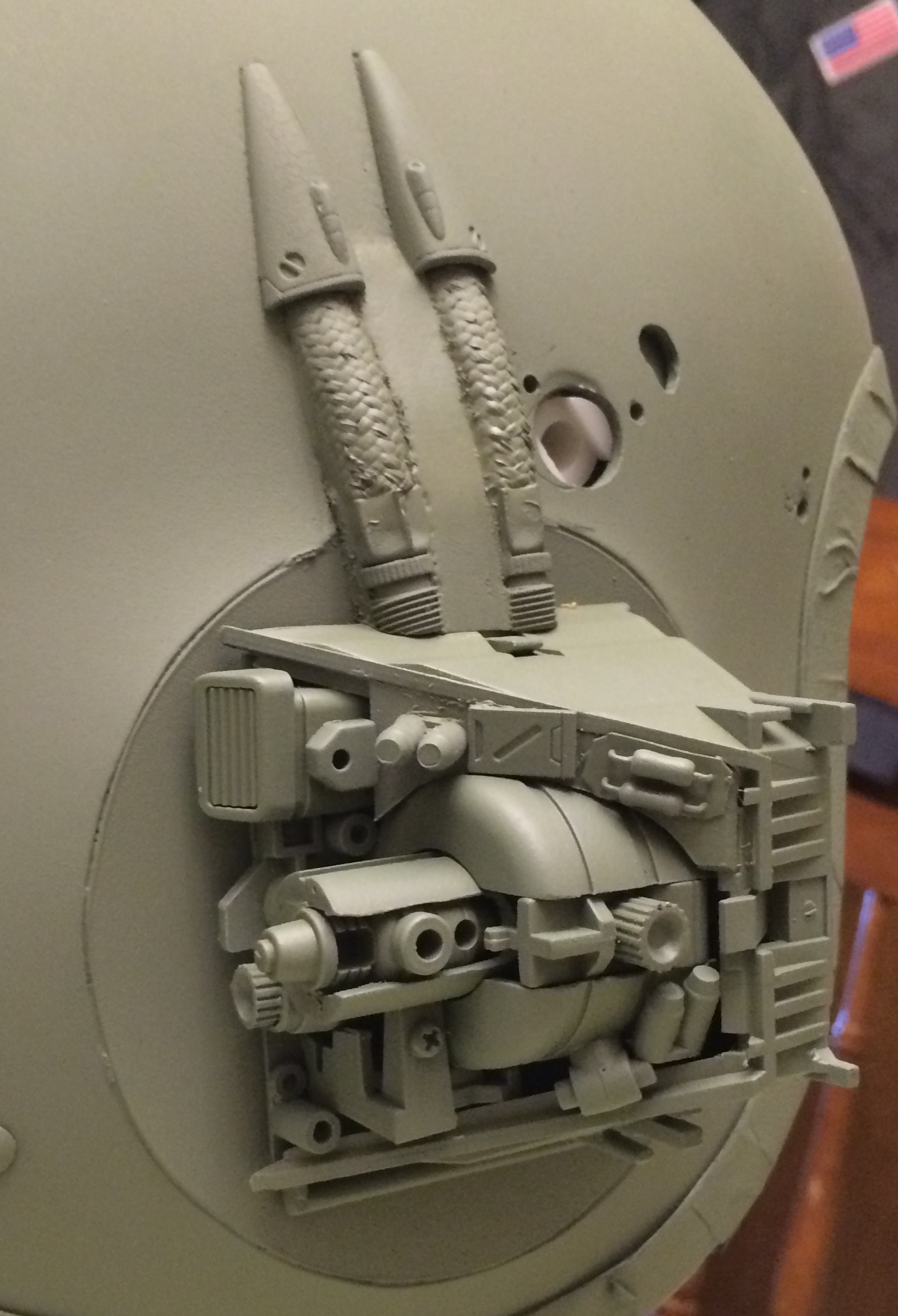

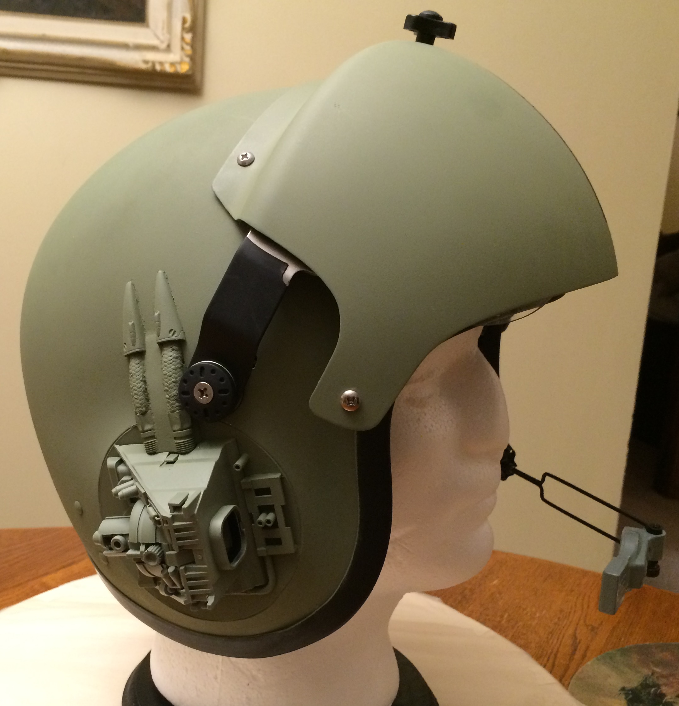

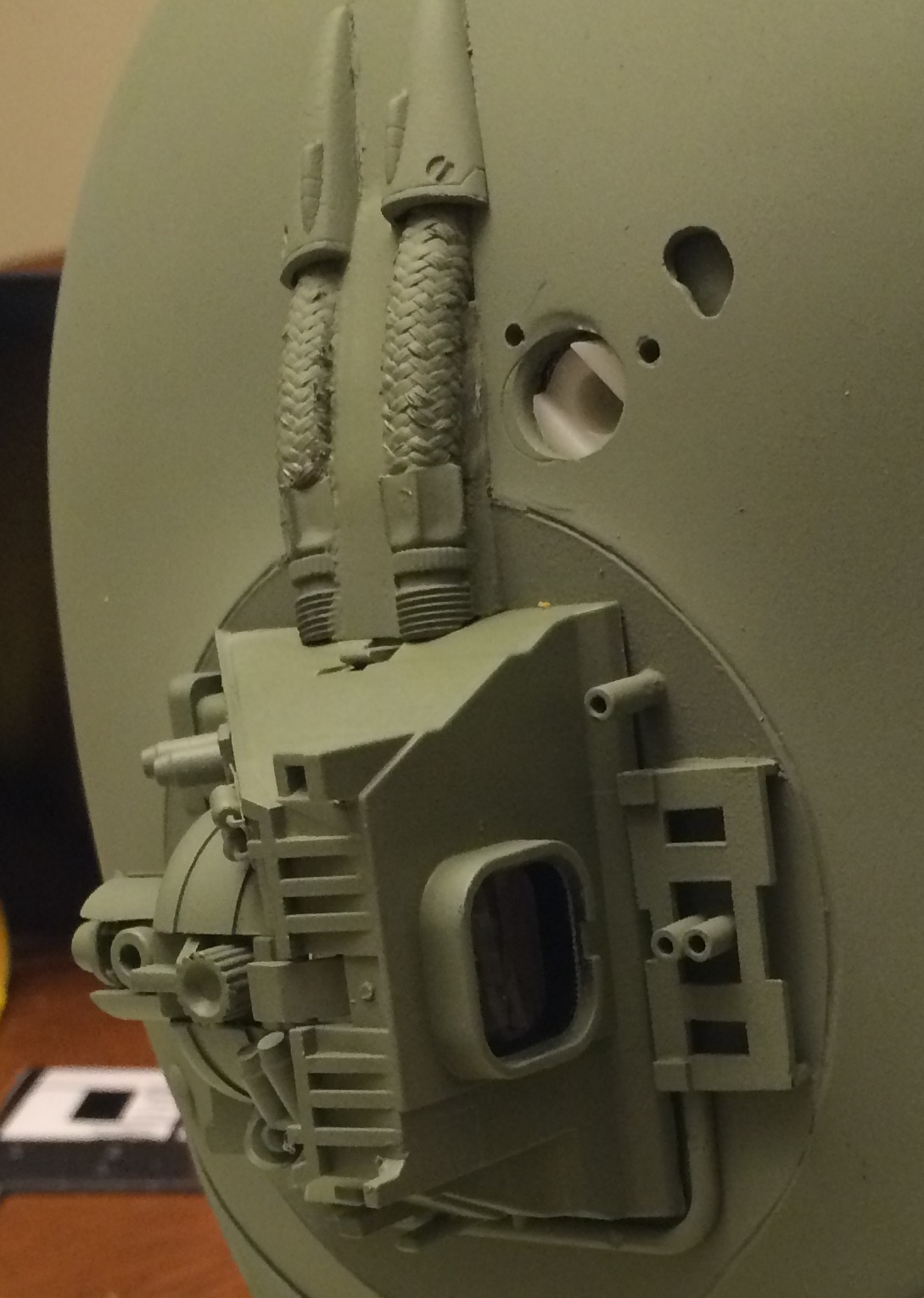

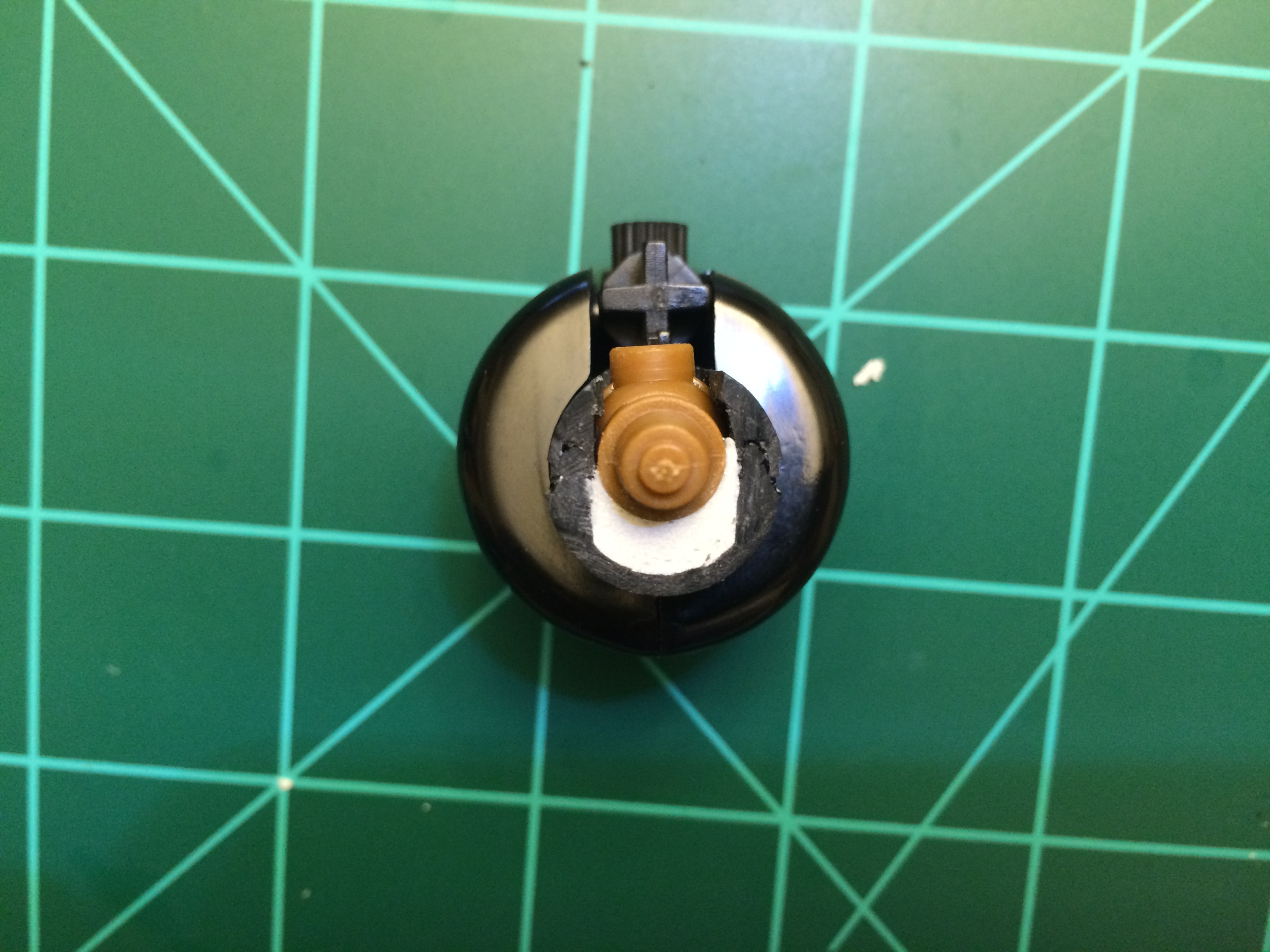

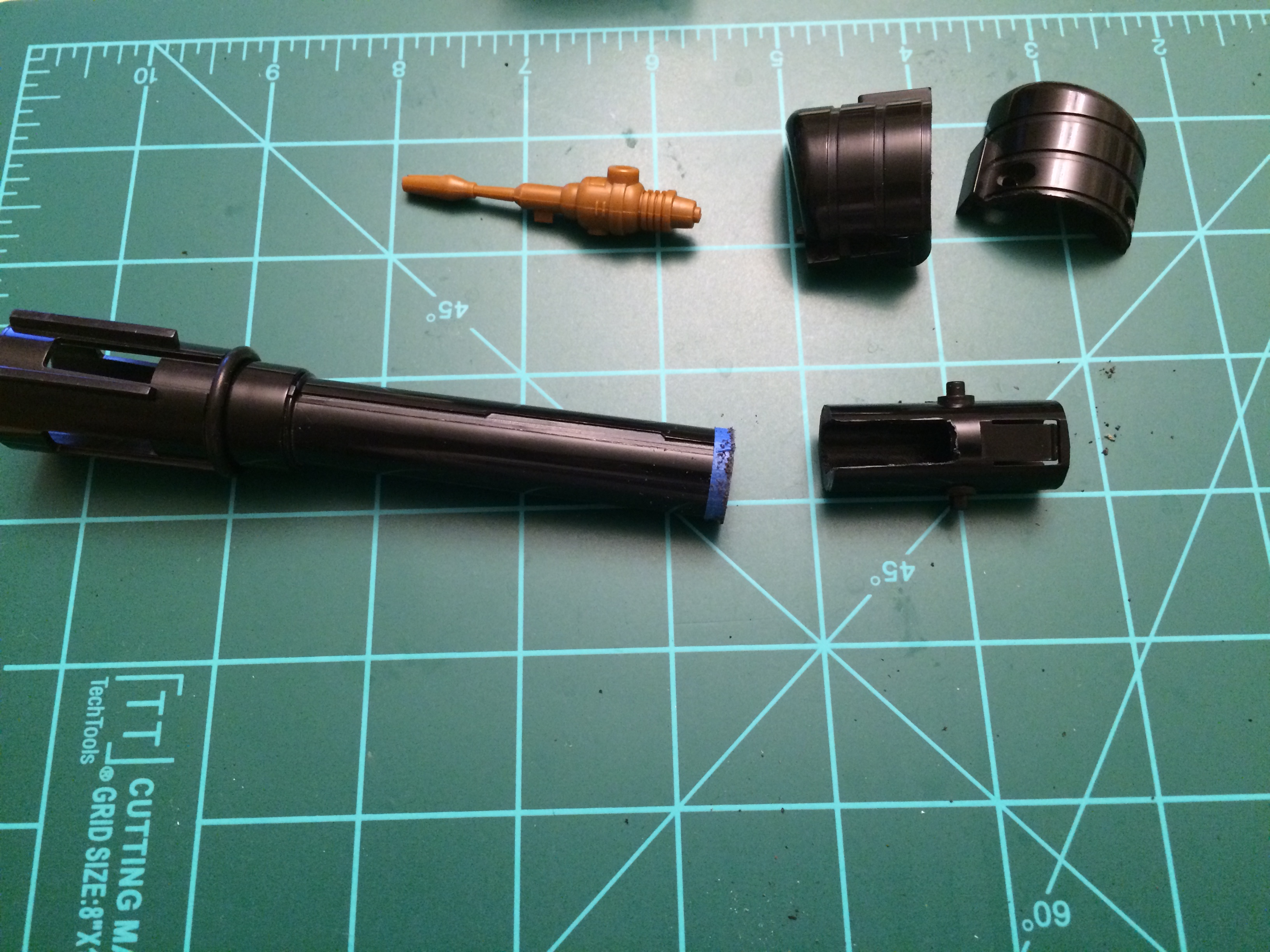

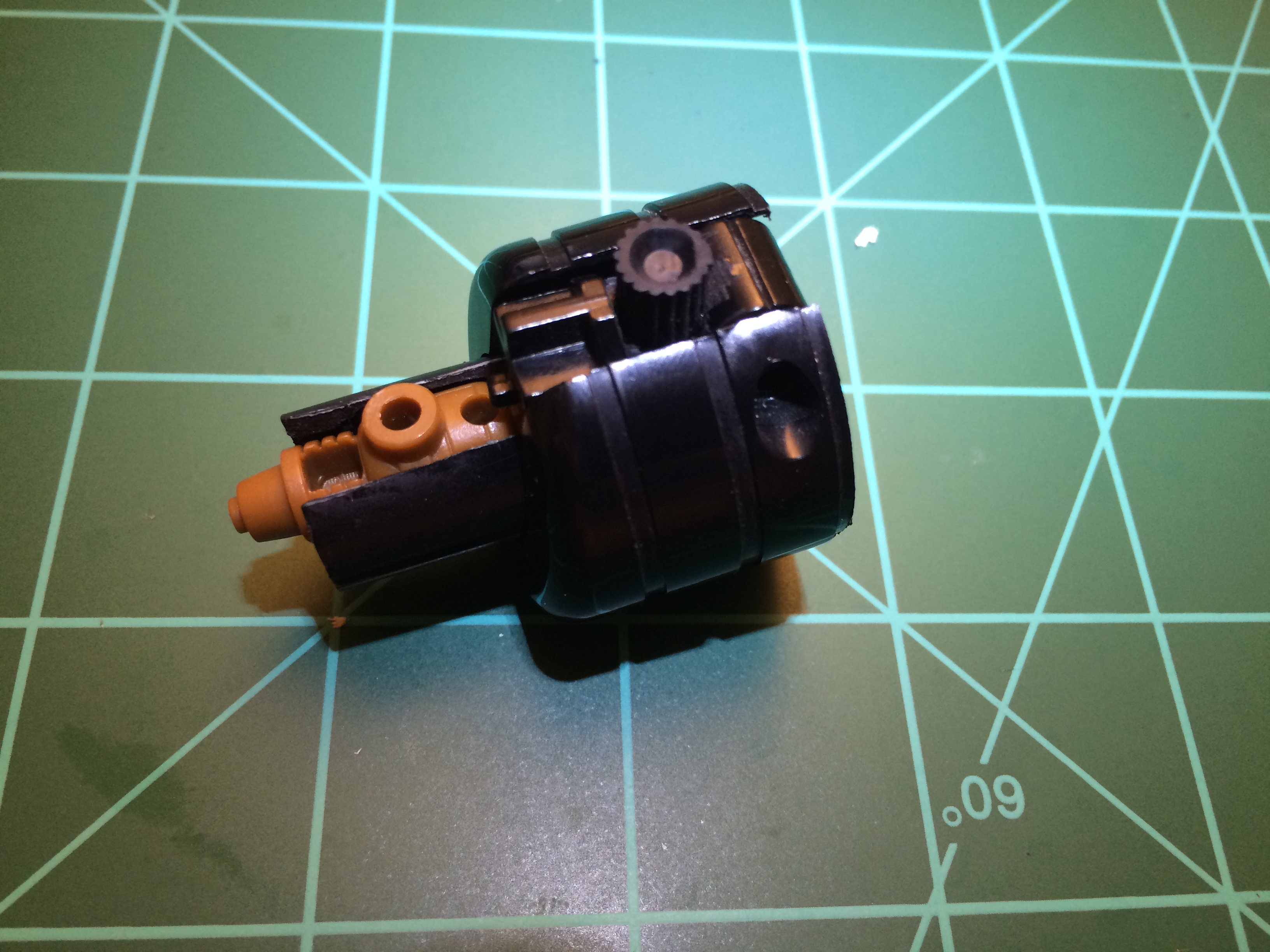

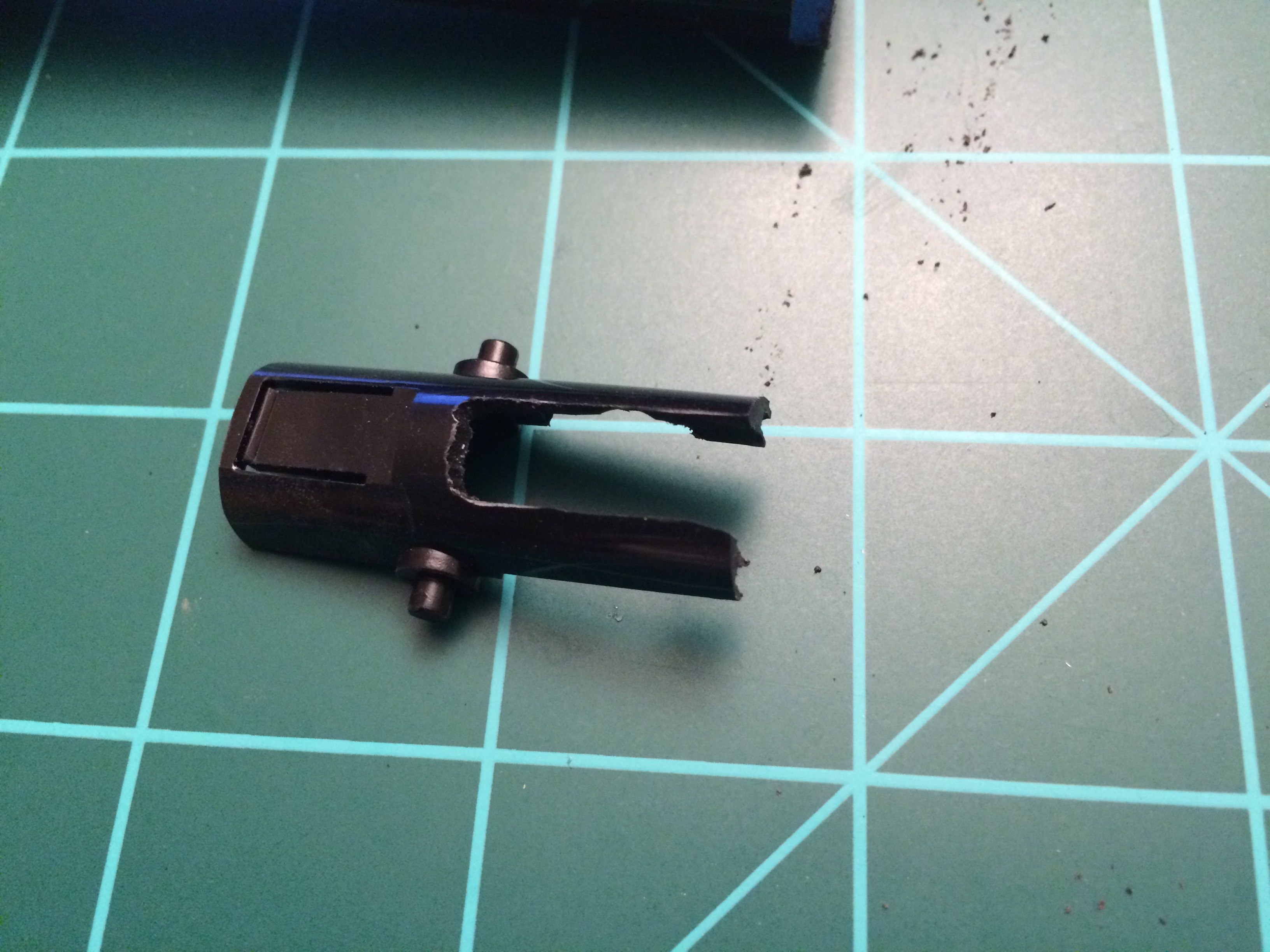

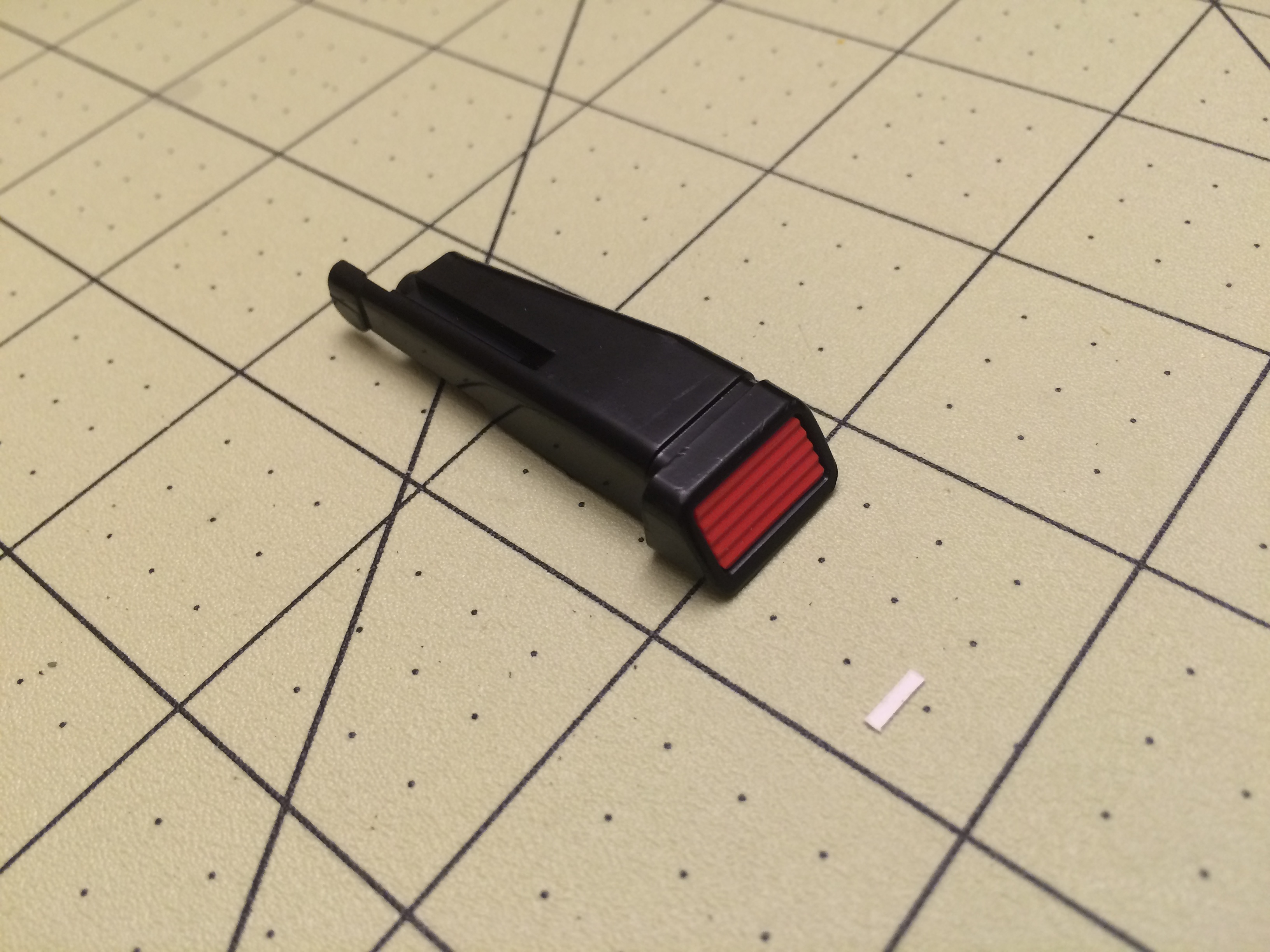

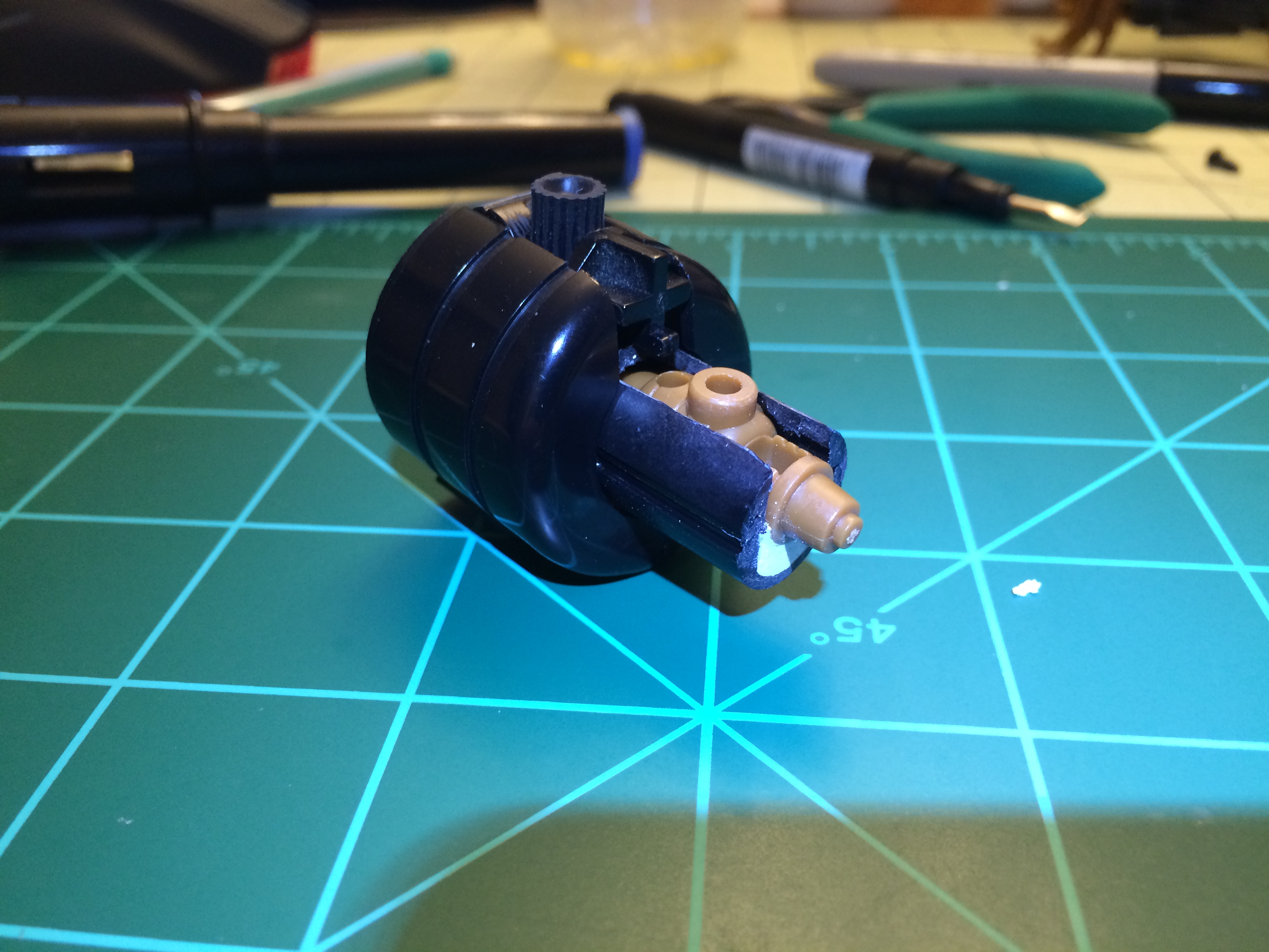

I have started to throw together a LOW budget drop ship pilot helmet, and as many of you can understand, being constrained by little time and limited monies, its not anywhere close to being accurate. But I thought I would share it any ways as perhaps something I come up with might help someone else along the way…. So I pick up ahelmet for just under $40.oo, a polaroid camera, a Robotech VF1A model kit,cheap used Zoid, I wasn’t able to score the adapter for the Megatron gun so I settled for a barrel as it was only $5.oo
I cut up the barrel to get it about the correct size and left the folding arm that attaches to actual correct Megatron part. A little glue, epoxy putty, and a Zoid gun and its time to cut up a Polaroid Camera.
I used Styrene as a mounting plate and added a few extra odds and ends just to put my own little spin on it.
IMG_3044.JPGIMG_3045.JPGIMG_3046.JPG I used the front nose of the Robotech model in place of the finger nail looking parts on top of the air pump hoses and some expoxy putty to tie it all together. So far Im pretty happy with it.

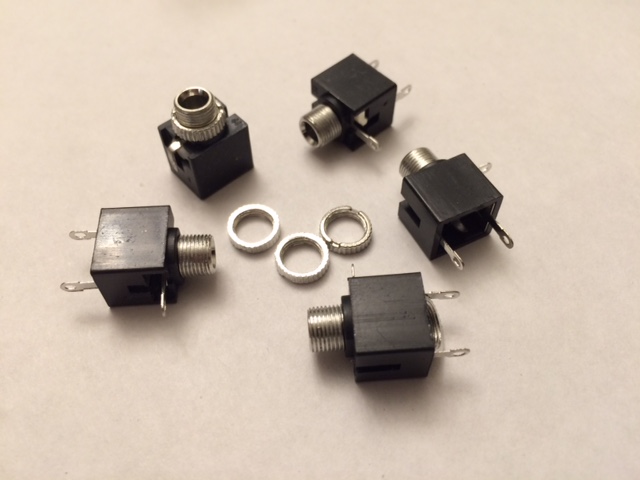

IMG_3053.JPG these finally came in today, not sure I am going to bother mounting one now. If anyone needs one let me know.
