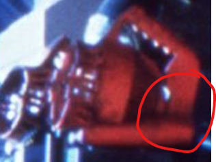

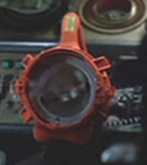

The back cone and light housing look like found parts to me, but the handles for both the portable and set-mounted versions look like custom jobs to me. Maybe made and vac-formed from individual cobbled elements originally, but how they look to mount to the light piece seems to be a custom build.
I will say that I spent a lot of time trying to locate a similar flashlight to no avail. Nothing even close.
I feel confident that it's a found part, or a compilation of a couple of found parts. Maybe not originally red, but nonetheless, not fabricated from scratch.
View attachment 647592View attachment 647591View attachment 647593
These are the best reference pictures I was able to find. Any ideas? This is one I've ALWAYS wanted. I thought about fabricating it. It's not THAT difficult a build. It'd be better 3d printed tho...

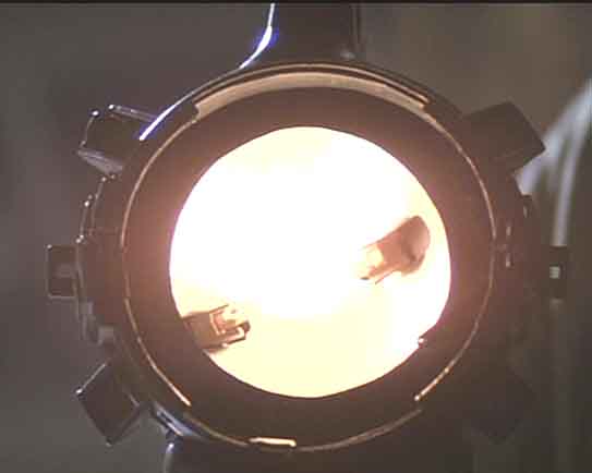

Now that I look closer, I think that the front part is actually the rear part of a car headlight mounting system. The part behind the grille. The tabs visible on that front part look to me like the adjustable part of a headlight system.
Savage I think your on to something. the tabs do looking adjustment screws from an old 60s or 70s car. the rea looks like a sieve or maybe a fan housing. Roger Christian mentioned using car parts in his book.
Here was the one used in Romulas

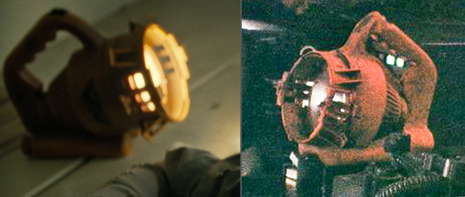

So, now that I have cross checked my references and yours, here is 2 major differences that I have spotted between the 1979 movie and the last opus, "Romulus" :
1/ Intersection between the main frame and the "legs" :
1979 :
a lond fillet.
2024 :
no fillet... and some kind of knob.
2/ And of course, the color !
Orange in 1979
Yellow in 2024

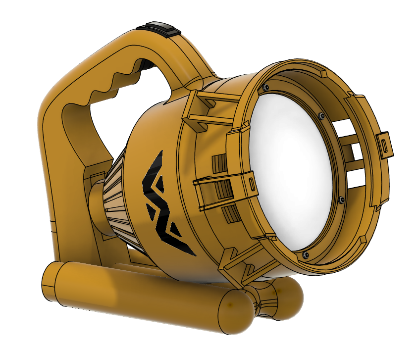

And now a glimpse of my "secret project" :D:
I think that the front bottom part is not as defined as your design...but more like something looking like a knuckle;)
I may work on both model (1979 and 2024), but for know I'll just focus on the Romulus one, aka "the Yellow" :D.

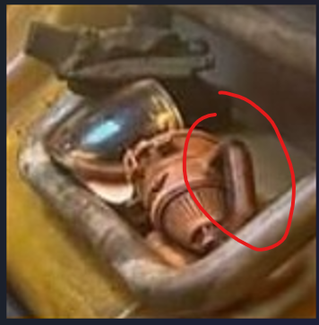

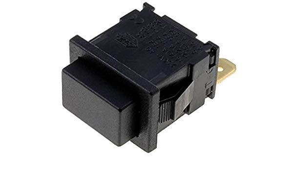

What type of Switch is it, in your opinion ?
Looks like this one :

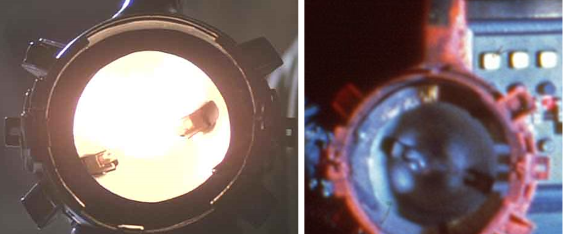

Should I stick with the old school "halogene bulb" on both ?
1979 :

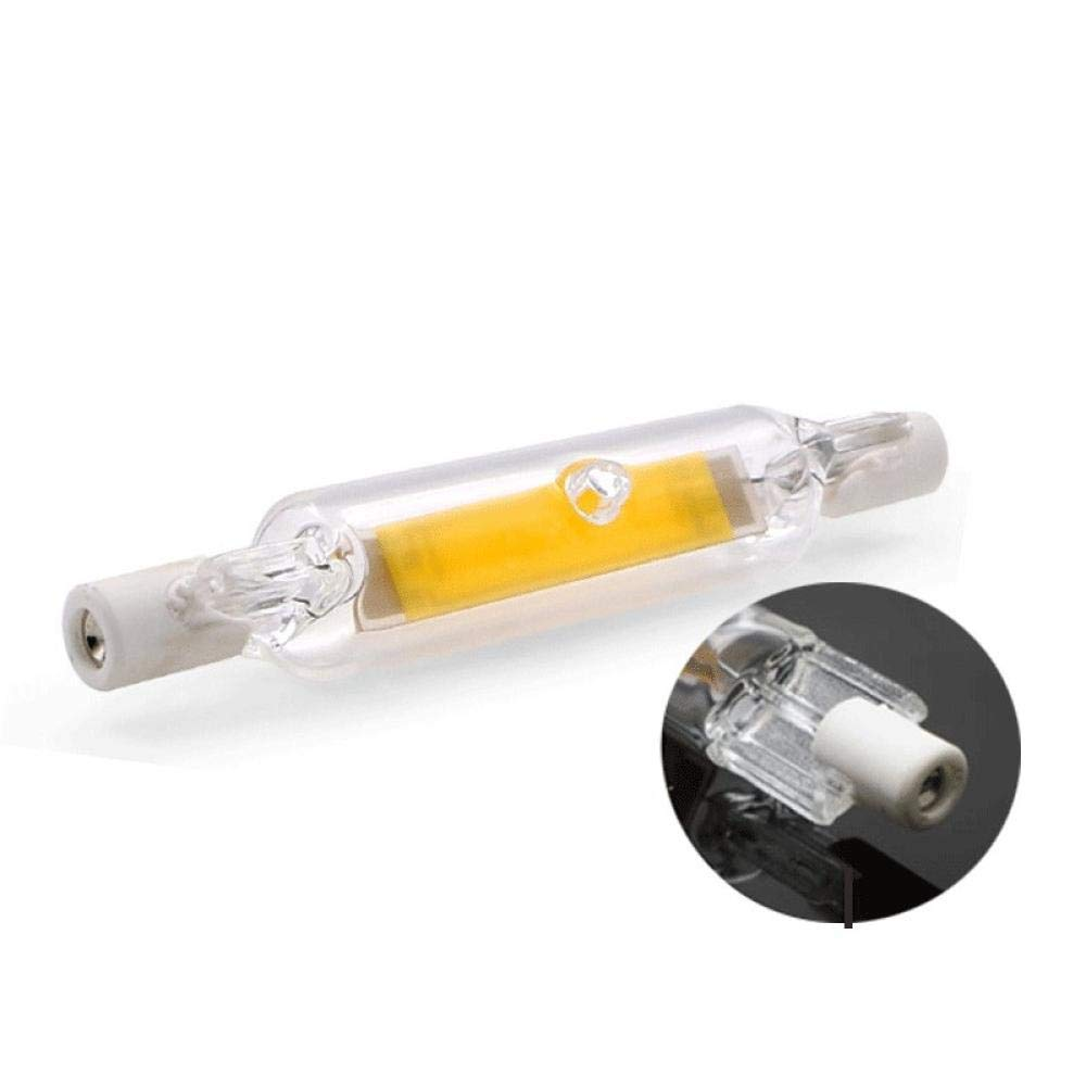

They make modern compatible ones (LED COB R7S) :
The 78mm one would fit perfectly. But they work on 110/220V ...

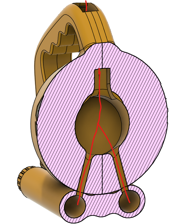

Consider the placement of the batteries please
I am ;)

The switch seems to be the correct one

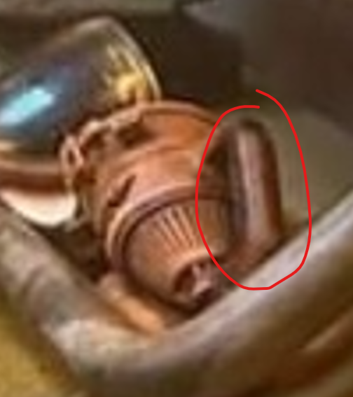

Regarding the bulb, I put a fake original size bulb in my EVA helmet flashlight and illuminated it from behind with a powerful LED
Yeas but I can find any size in the specs + it works for 110-220V and are not cheap.
I'll start with a fake one.

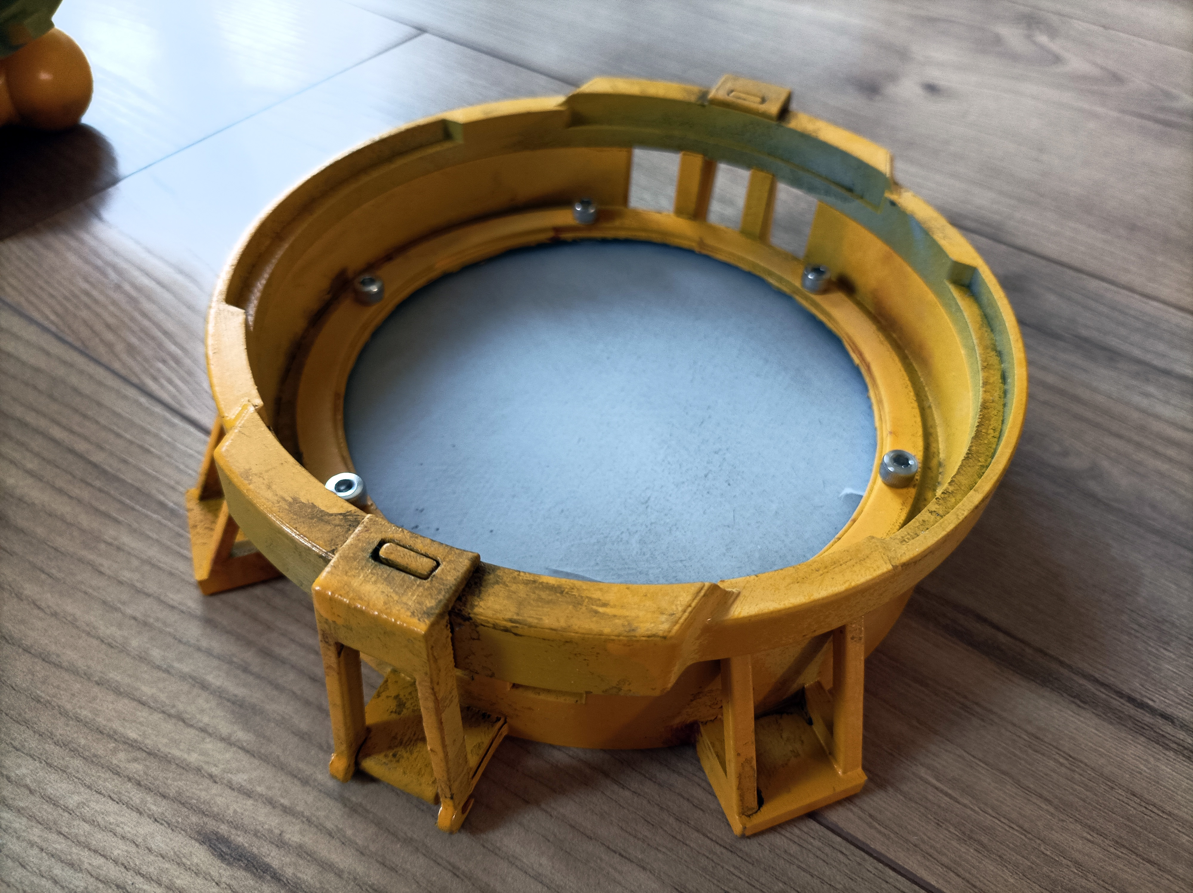

As this image shows, I think I'll stand with a white, or "frosted glass" screen bolted to the front part (and a source of light hidden behind).

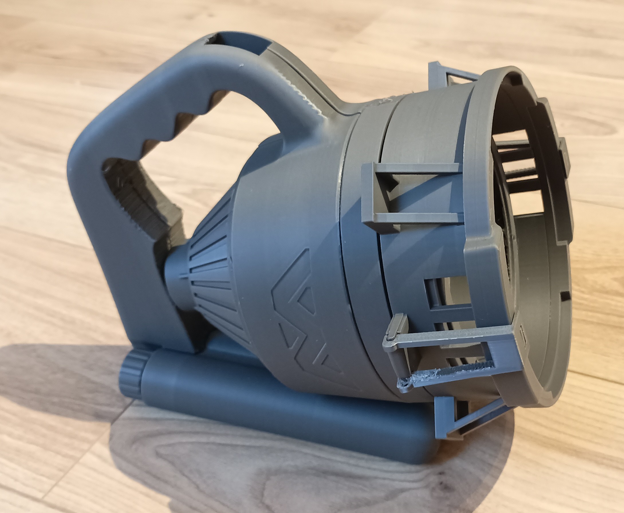

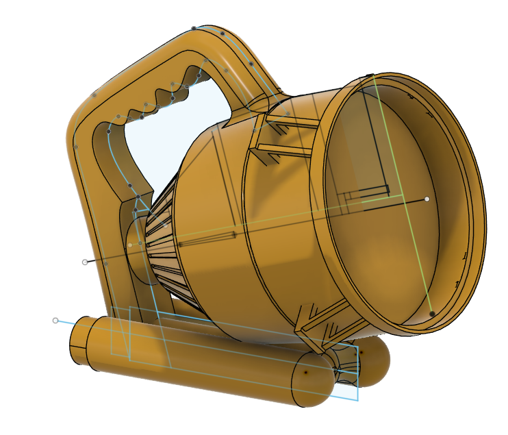

Do you see a groove here in the back part of the handle, or not ?
I am ;)

As this image shows, I think I'll stand with a white, or "frosted glass" screen bolted to the front part (and a source of light hidden behind).View attachment 1876183
Seems like it's on the side of the handle, nothing on top(y)

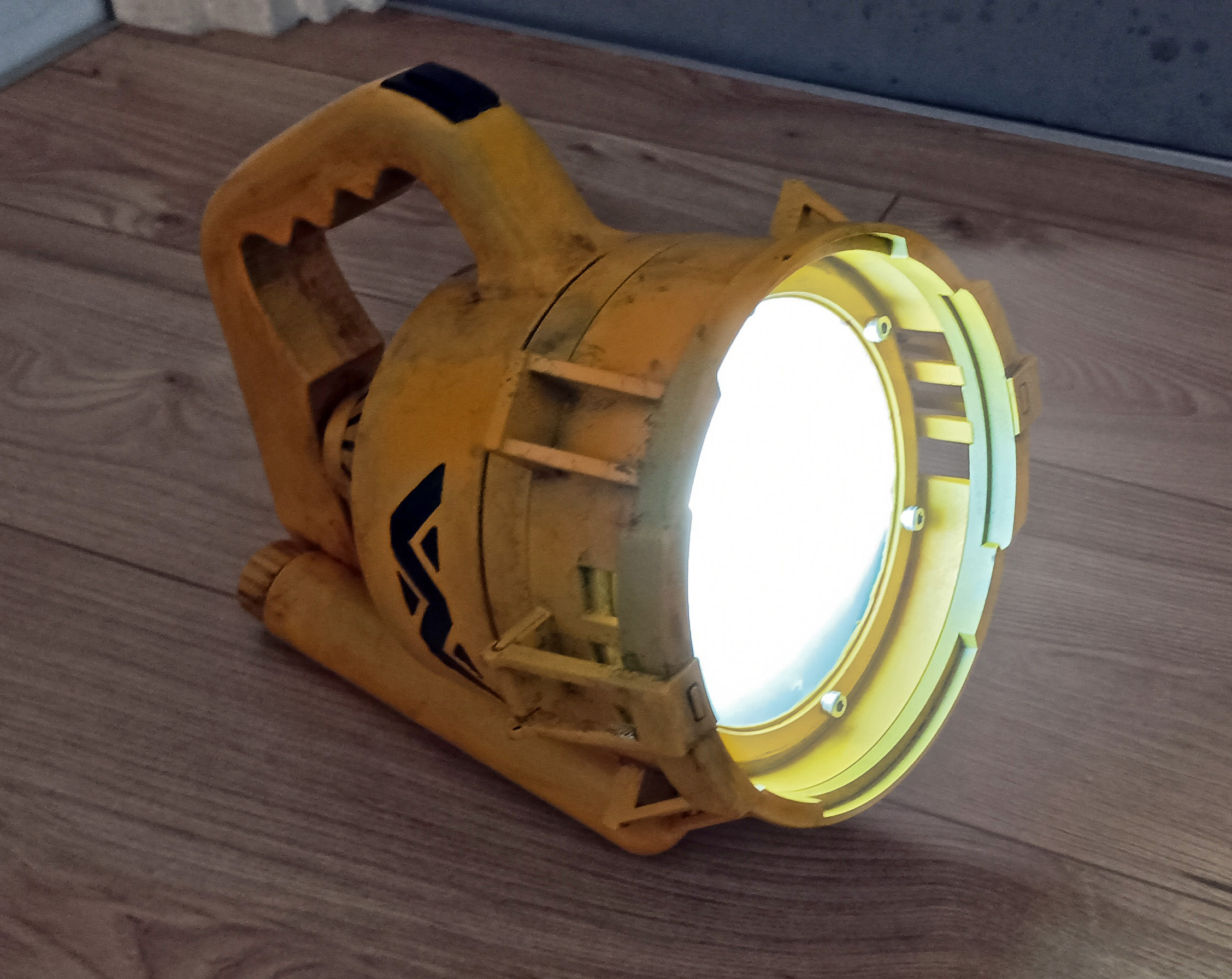

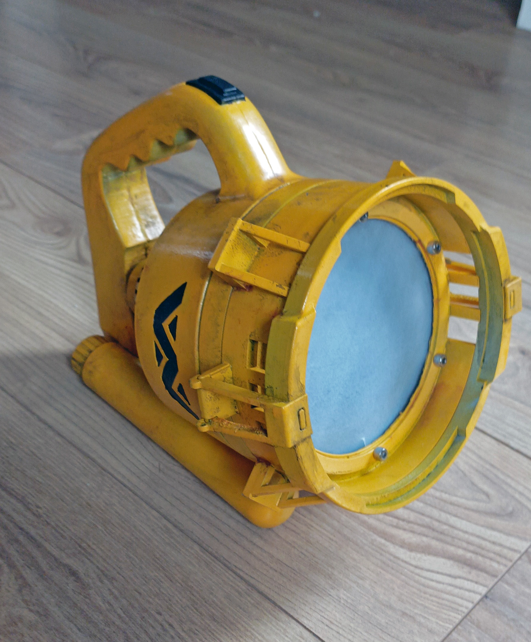

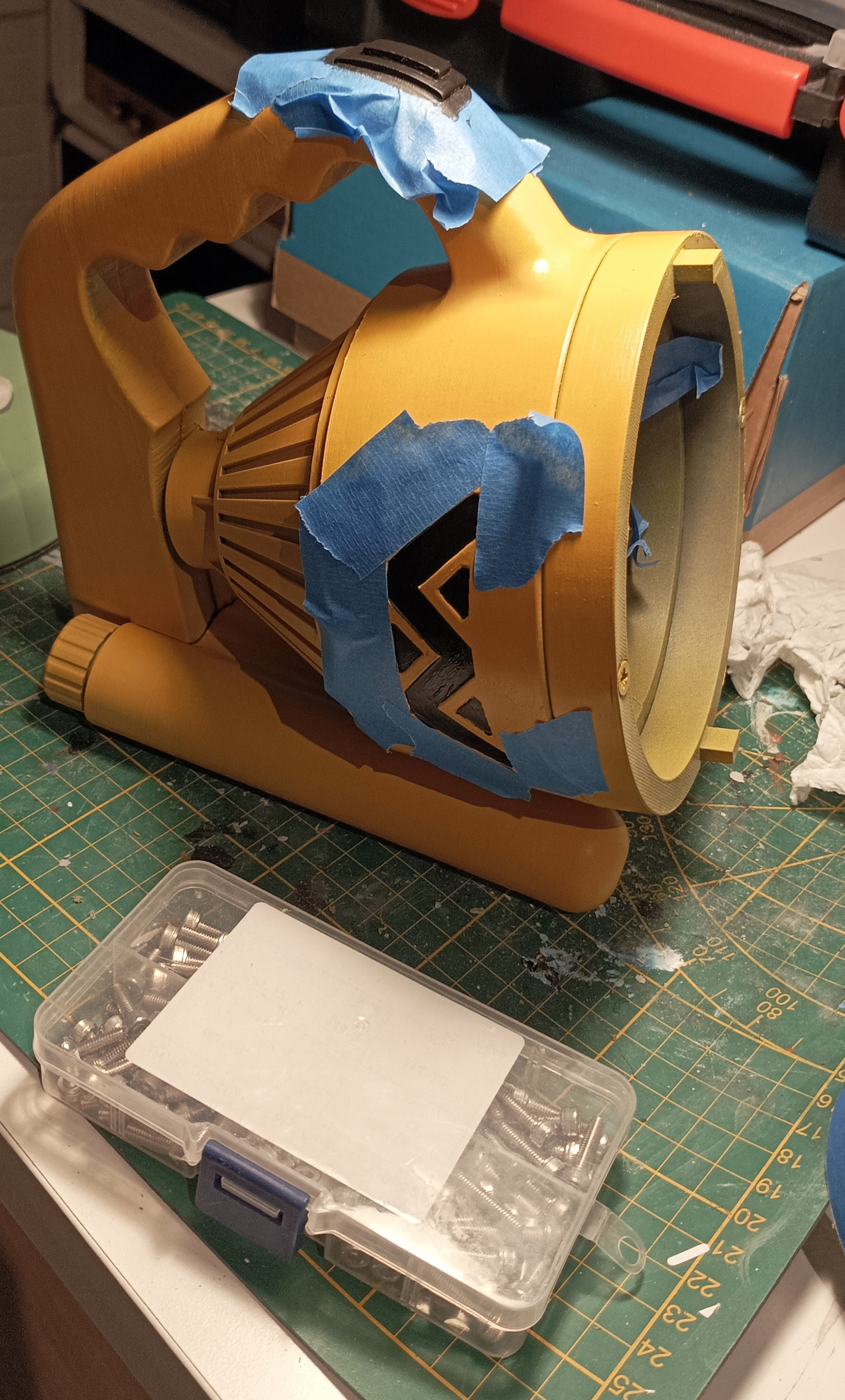

Proptotype complete !
Yellow paint+protective layer :
Wheathering :
I cutted a 2mm Acrylic sheet, then I sanded it to get the frosted effect.
Bolted with real M4 screws.

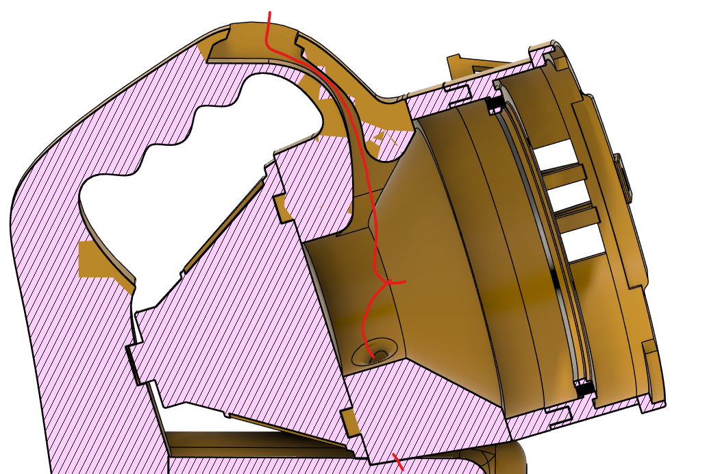

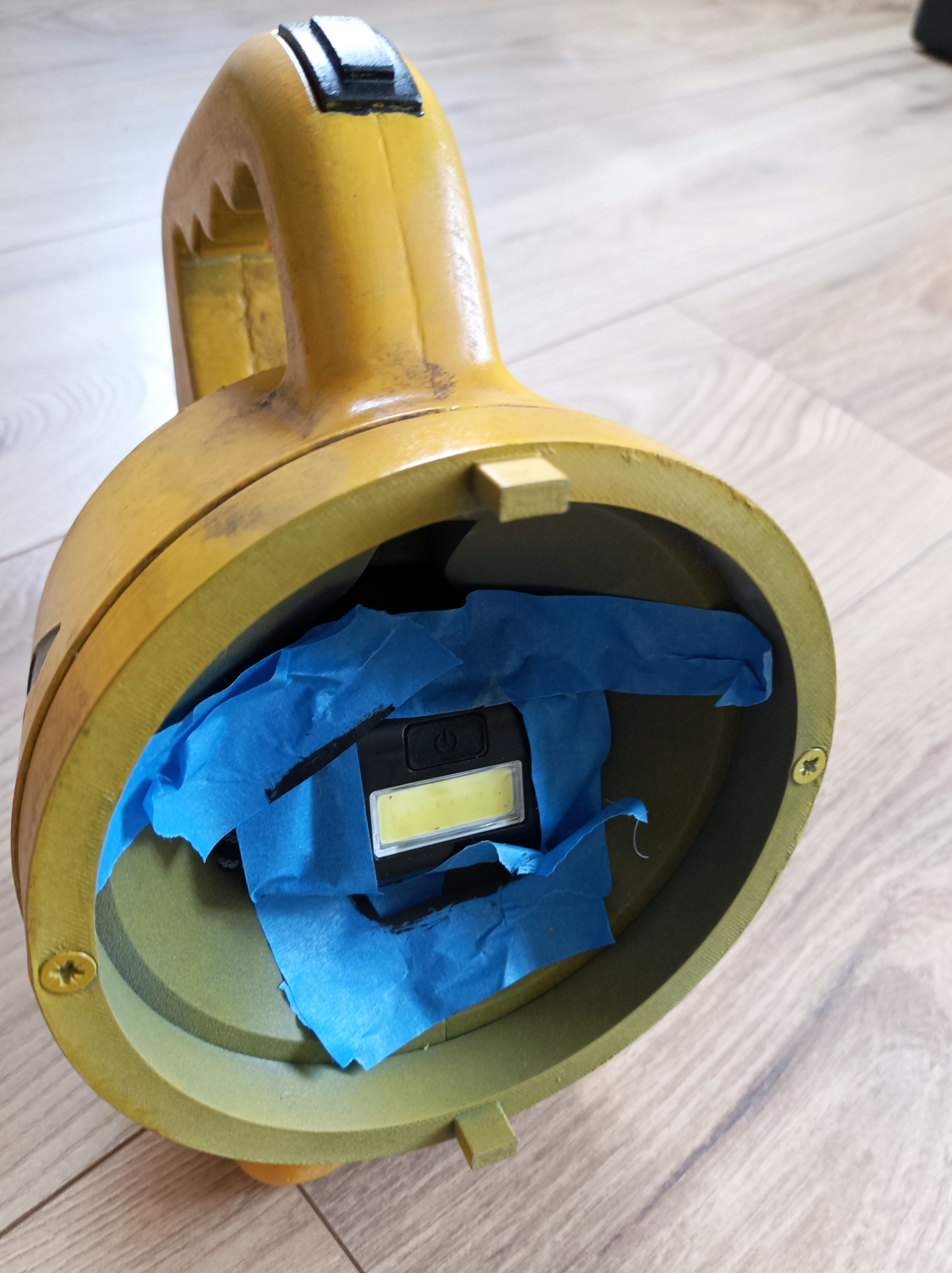

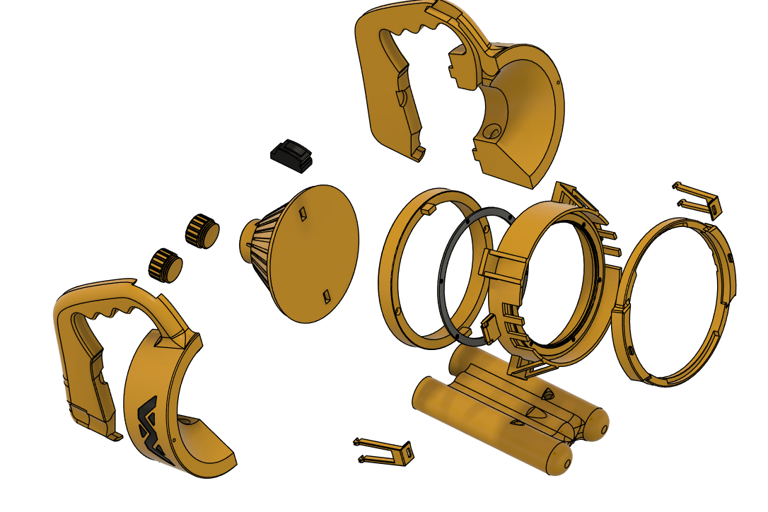

I made my prototype quick and dirty with a simple frontal lamp taped in.

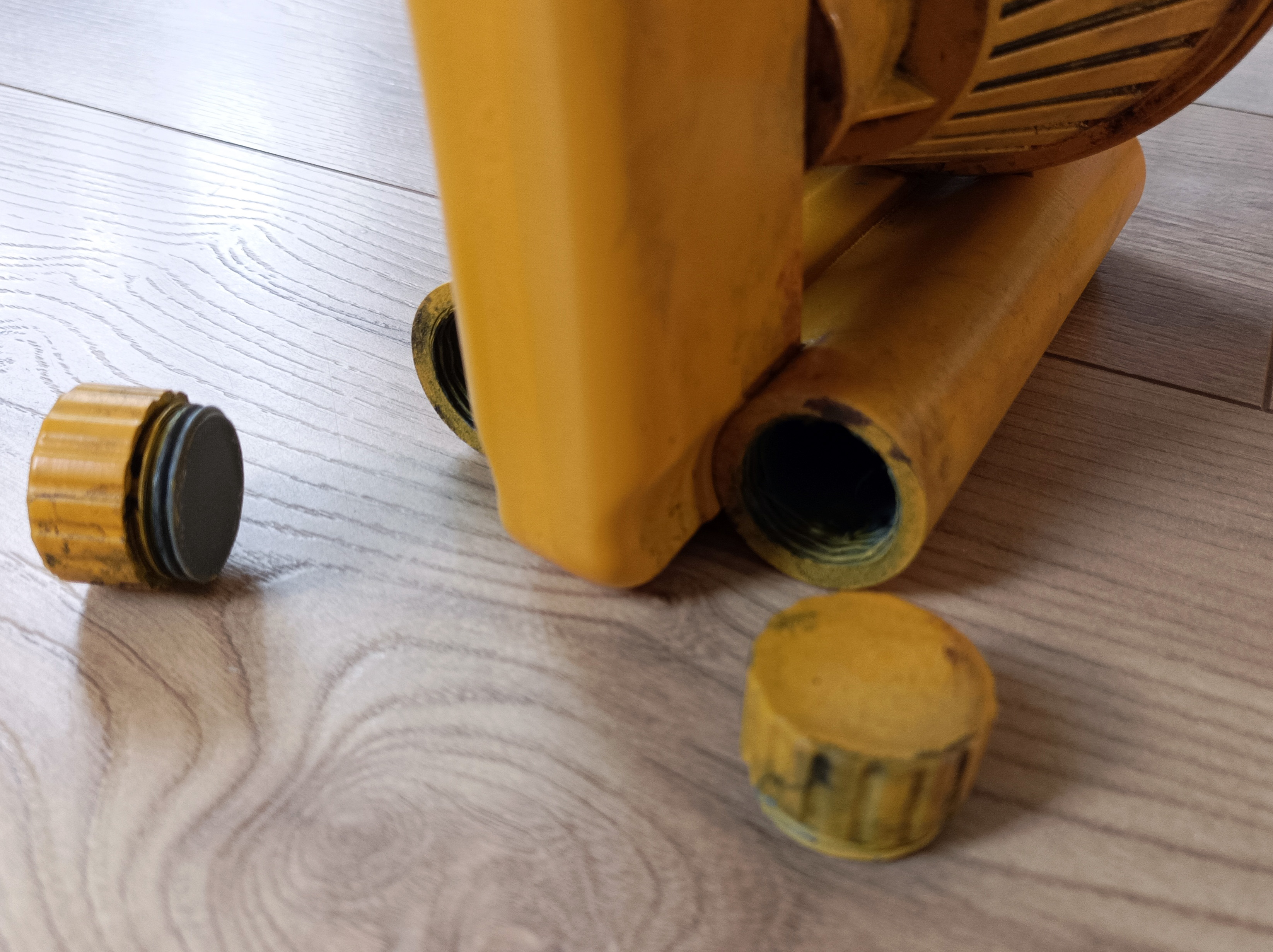

I used a fake 3d printed switch, and obviously didn't use the hidden "leg" compartiment for batteries...
But I made room for those who will put real electronics and batteries in !
Batterie compartiment :
Lighted up !
As you said post processing will add that groove on each side of the handle?:cool::cool:(y)(y)
I didn't look into that, cause I haven't enough reference material at the moment.
Maybe I'll work on a V2, when the real prop will be shown properly.
