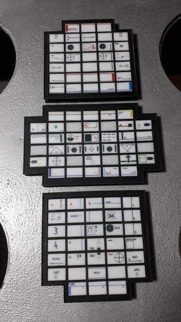

Wow! Incredible work.Another step closer...really chuffed with how these keypads turned out. 2 of the buttons have momentary switches which activate a central locking system that pops all 4 activation bolts simultaneously
Thanks dude...So, I did the graphic and had it printed straight onto an opal acrylic sheet. Then I used the 3d model of the keypad to generate a template to produce SVG files to laser cut the buttons. To operate the release mechanism there are stalks connected to a central locking system and to finish it off I used under cabinet flat LED lightsWow! Incredible work.
How did you end up creating the buttons? Individually printed opal acrylic pieces? What are you using underneath them to make them work? How are you lighting them?
Sorry for all the questions but this looks fantastic!

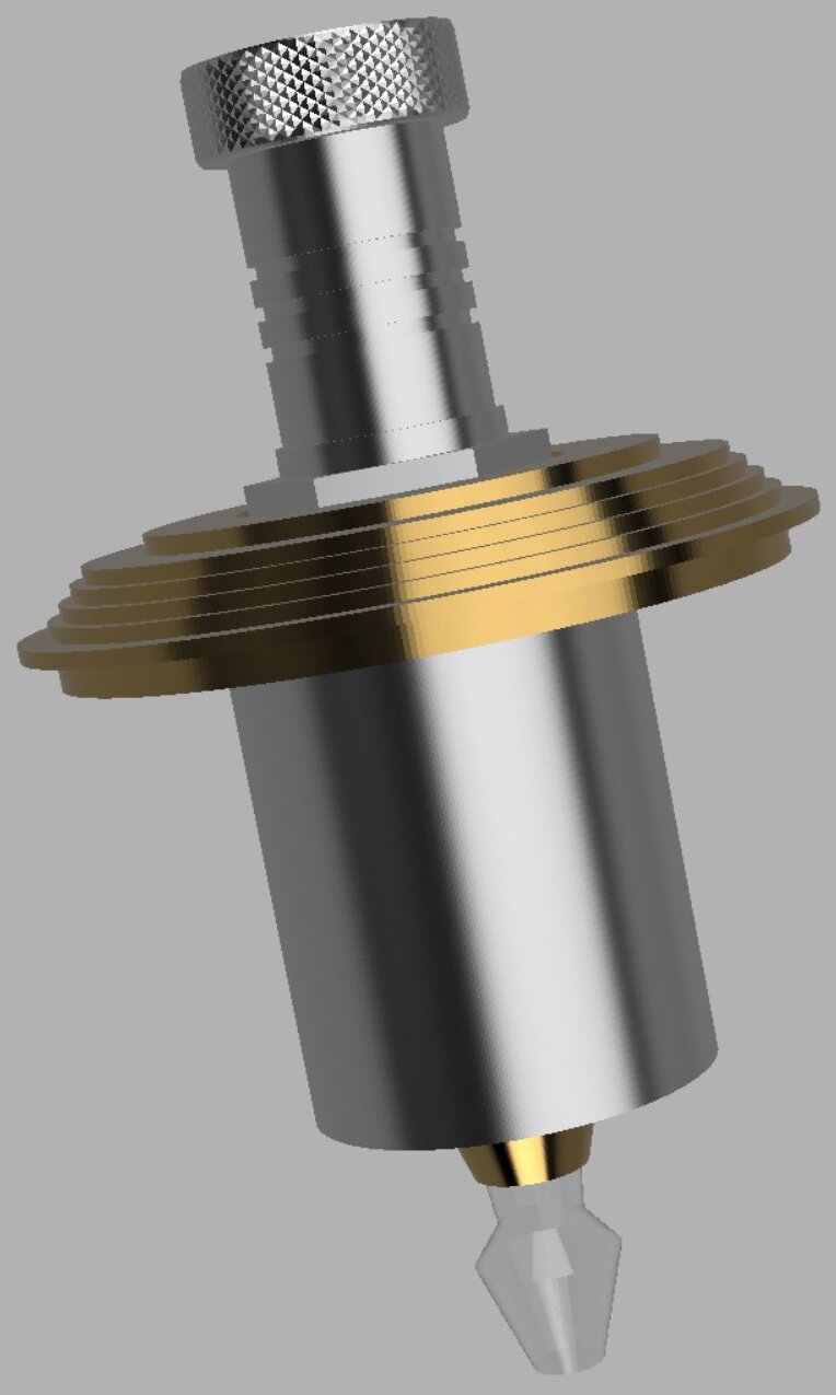

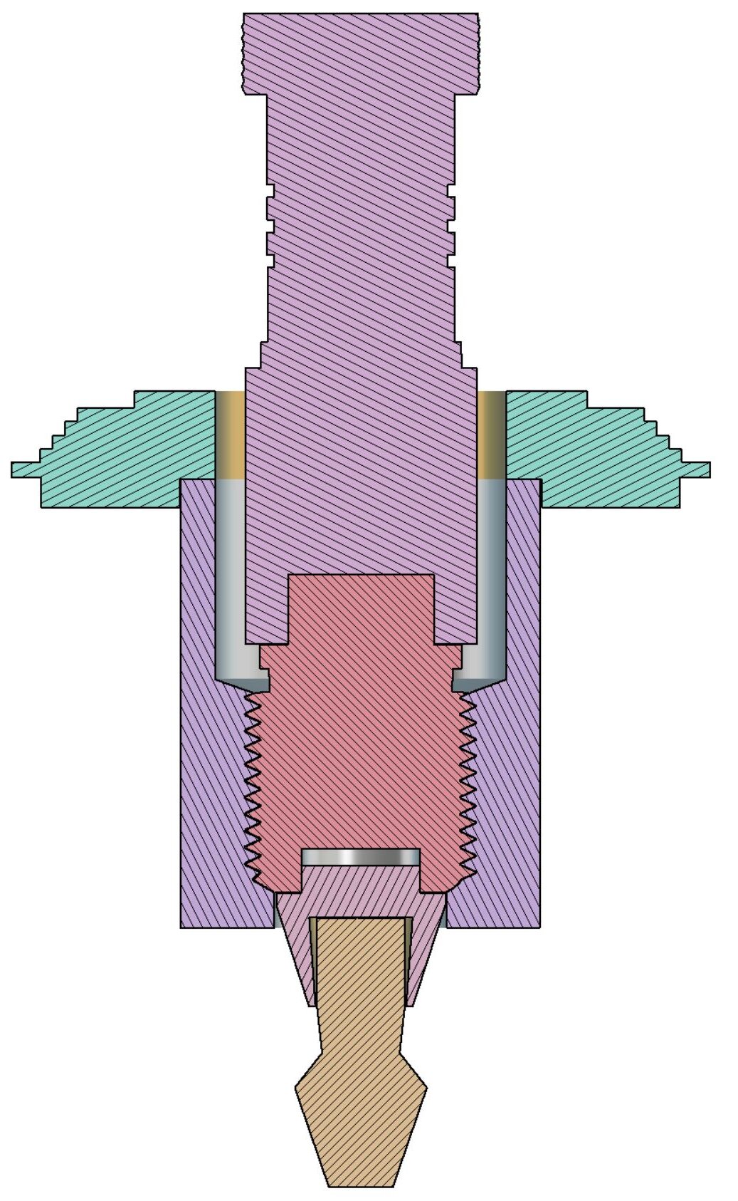

Do you happen to have the vertical dimensions for the activation bolt? I only see the diameter dimensions. Thanks!Here are a coupla CAD screenshots for the first CNC parts to be done...
TFS Neil...now we see and we know![]()

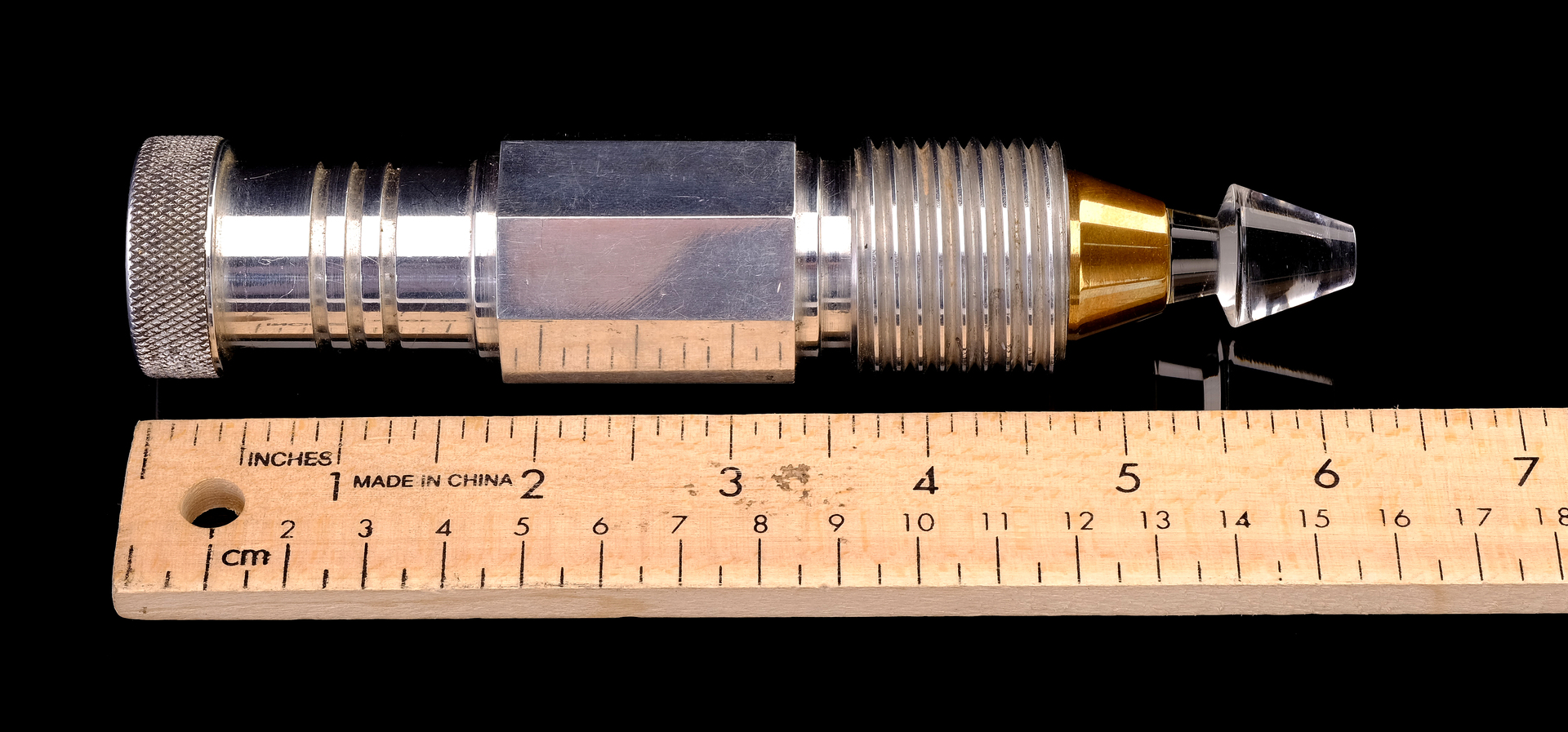

Lot #9 - ALIEN (1979) - Nostromo Detonator Sequence Bolt
Lot #9 - ALIEN (1979) - Nostromo Detonator Sequence Boltpropstoreauction.com
