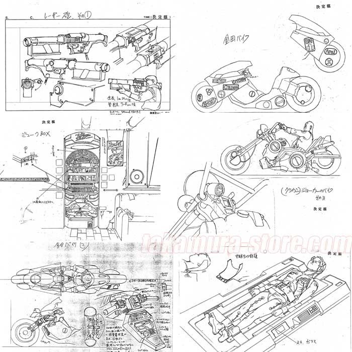

Hi Guys! I don't know if this is the right forum to post this on, but I figured theRPF is THE most awesome building community so I wanted to post it here. last year I finished my electric motorcycle conversion (The Mark 1!) and after testing it out I came to realize that electric motorcycles can take other shapes different from ICE bikes, so I finally decided to start The Mark 2, which will be an electric motorcyle based on the visual concept of Kaneda's power bike from the anime Akira. For those unfamiliar with the bike here are some pictures:
Akira - Kaneda's bike render by Asgard Knight.jpgAkira - Kaneda's bike rendering side by Evan Davies.jpgAkira - Kaneda's bike side animation archives.jpgAkira - Kaneda's bike side live-action concept art by Christian Pearce.jpgAkira - Kaneda's bike side live-action rendering by Tim Flattery.jpgAkira - Kaneda's bike tech specs.jpg

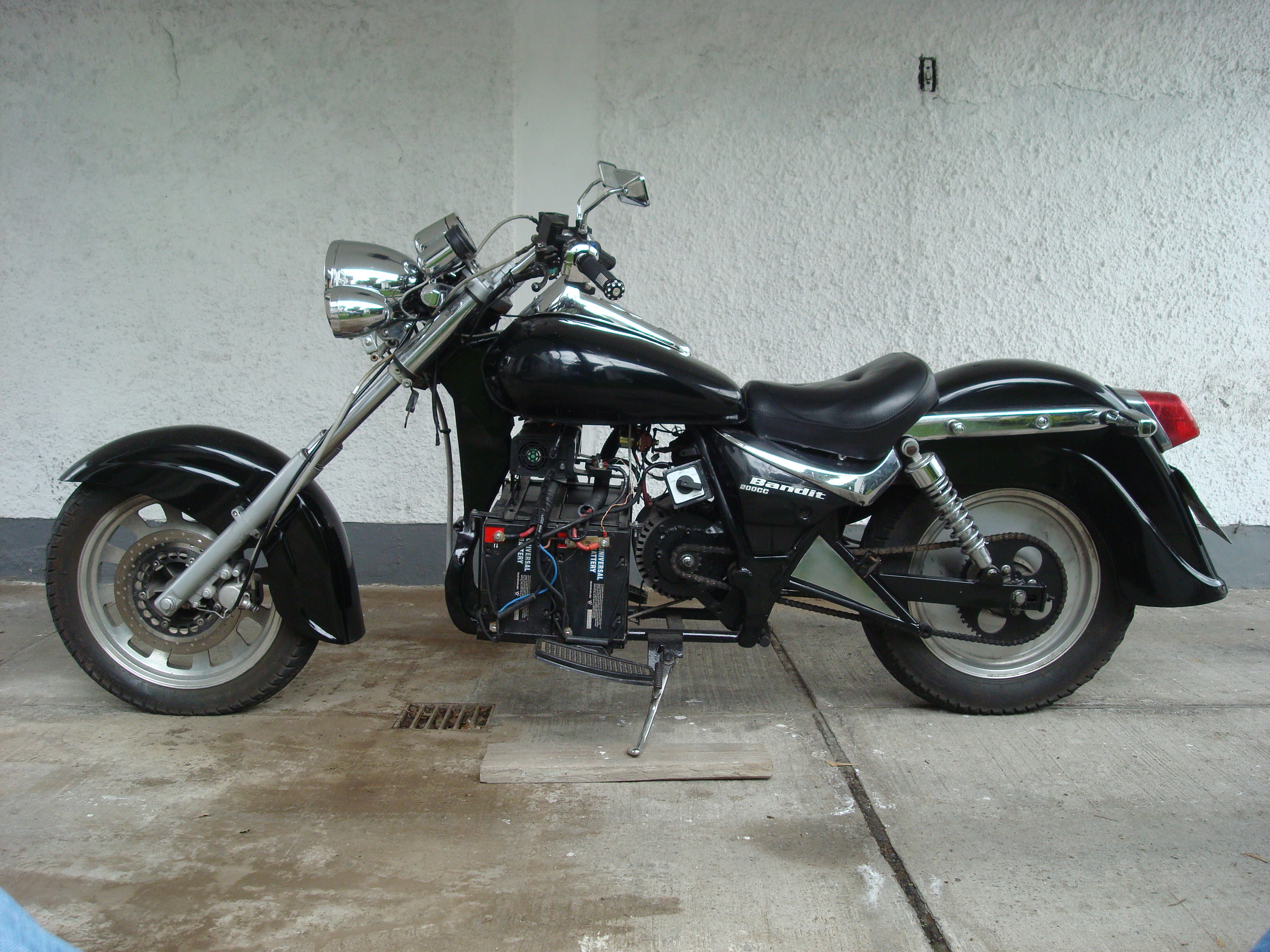

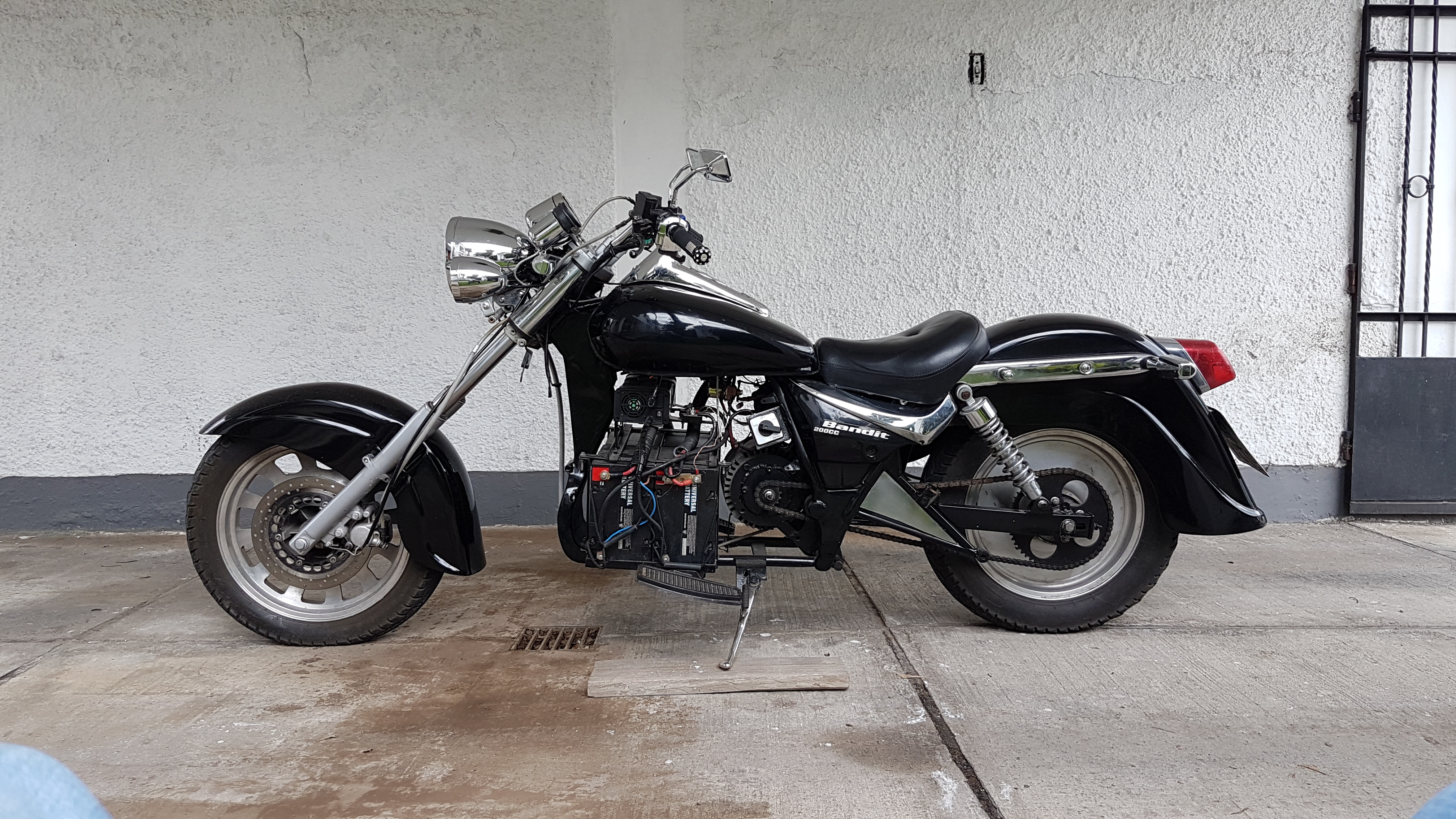

Are your specs taken from this build? Some more info would be great. Range, etc.
Sure Dude, but first let me clarify something: the photos and video above are of the Mark 1, already made, and great. What I want for the Mark 2 is in the very first post. Now, Regarding Mark 1:
System Voltage: 48 v
Amp: 55 AH
Range: 30 Km aprox, on flat terrain, on hilly it drops a lot.
Top speed: 65 Kph
Tires: RIM 15 and 16
single seat
LED lighting
regular dashboard
Donor Bike: Motor 1 Bandit.
