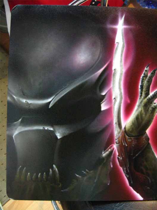

airbrush work
uruk
the head shape could possibly be more accurate, but for an airbrush, that's really great looking piece of art. just love the biohelmet.

biofreak
love that glowing effect how do you achieve that? spray transparent white? or layering? i just dont know.lol
i penciled on the basic outlines of the over all picture.then i mask off mr black with frisket film.its a transparent low tack thin sticker basicaly.with a razor carefuly cut out the outline of mr black.then sprayed the backround and the bio the did a frost of white around the masked off edge that will be the glowing border wen u unmask it.then i masked off the backround and bio and sprayed mr black,unmask that wen finished and add a few highlights to blend the masked edge and presto.
thicky ricardo
very impressive man,yea i thought it was something like that i think the best work ive seen hass layers and layers of masking ect.whole time i thought that you had to achieve those effects from just pure airbrushing ,awesome innfo thanks
