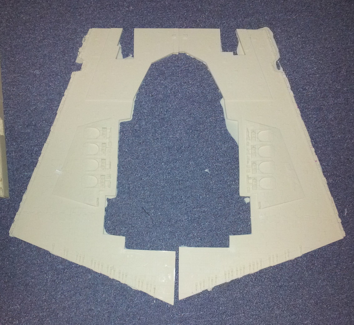

Unfortunately this is the kind of stuff I'm running into
As you can see, the left hull piece is elongated about 1/2 to 3/8". It's not just warped, it's distorted.
I knew when I ordered it I couldn't expect Randy to hold my hand and walk me through every problem, but I reached out to him anyway with some thoughts on how to address this and only got back the general rote answer - run boiling water over it and press it into shape and then run cold water to set it.
The way I see it, there are only two options to fix this piece.
The first would involve building a jig using the mirrored right side piece, which I'll have to take for granted is "true".
I would take an outline of it (bottom up to trace) and then have 1" x 2"'s around three sides in a shape like this
After the hot bath, while the piece was pliable, I was thinking I would be able to slide it into the jig, and then use Rob Rossi's system of weighting it down with a bag of sand while it cools.
Thinking about it some more, is it foolish to expect the resin to essentially contract vertically while remaining the same horizontally?. More than likely, I would guess forcing it into a narrower constraint is simply going to cause the middle of it to start buckling...maybe even rippling in waves? There is a good 1/4"+ that needs to be reined in.
That seems like a lot to me.

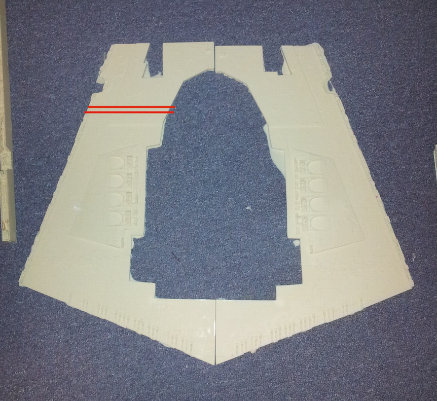

The only other option that I can see is to make a cut and trim out a 1/4" sliver either in this area here, or below closer to the exhaust end.
The problem there is, the elongation is distributed evenly across the interior cut out. Taking a chunk out of one area is going to throw the interior dimension off.
So- which of these two options seems the most viable?

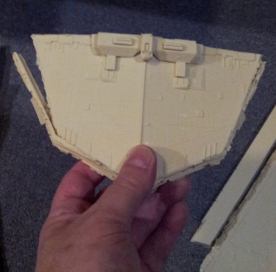

There are a bunch of other pieces that have, what i assume are, the more typical banana effect going on. They need to be made pliable and then tamped down flat, or constrained. This is the kind of stuff I was fully expecting (just not on nearly ever main piece).
One that I'll post a pic of later, is starting to twist like a pretzel and some of the long trench pieces have warping on both the x and y axis.
But it's that hull piece that I think is going to vex me the most.
Welcome to the wonderful world of garage cast resin!
I would extend the right hull with some styrene, since the
inner space is not going to be visible.
But then again, I haven’t seen the new kit in person.
Hey Nils, Thanks for the response.
I'd thought about extending the other side, but the problem is the side wall trenches, and the bottom hull both have to line up properly. There's only one piece stretched out of kilter.
Then again, it might be easier to add styrene to the side trenches and bottom hull, along with the top, rather than trying to take something away from that elongated piece.
Is it foolish to think that I'll be able to basically contract that hull piece with a long enough hot water bath? I thought having a jig to constrain it into would be what I'd need, but I'm thinking now that's just likely to make it buckle and bow up in the middle. I'd use a sandbag to try to keep that from happening, but if it's heated up enough for the core to be pliable, I guess that would be enough to ruin the surface form and detail as well?
Maybe I shoud add 1/8" to the right side, and cut out 1/8" from the left.
I was fine with the notion that I would have to add some thin strips of styrene here and there to fill in seams on sub sections and details, but I never expected on a brand new kit that's only had 60 castings, to have make major corrective repair to the fundamental structure.
Can't Randy send you a replacement piece?
I would trace the non warped hull side on thick styrene,.cut that out and flip it over to have a perfect mating side.
I would then cut up the warped hull piece and glue that on the styrene,...as long as the end side matches up to the engine section and the guns match the other side and the front side matches aswell ,.i think you will never notice you restored(cut up) that side after puttying and painting.
Are the guns(wells) expanded aswell?
If that's the case, forget about not noticeing the restoration.
Anyhow i would ask Randy for a replacement since cutting up means almost scratch building that side,.this is not what i would expect from a quality resin kit from a reputable producer.
I think this kind of surgery also goes beyond statements as "for experience builders only"and"scratchbuilding techniques required"
You might aswell just includes one hullside in the kit and say "for the other side just copy in reverse the included part"(ok this statement is maybe a bit extreme but it borders on the same territory)

I had to boil most of mine in water to straighten my pieces out . almost all of them were warped in one way or another. It took a lot of time and stress. And even after there were some warps that I just couldn’t get out. And there were a ***** ton of bubbles. It was by far the hardest build I’ve ever done. Good luck and take your time and check and double check and triple check everything.

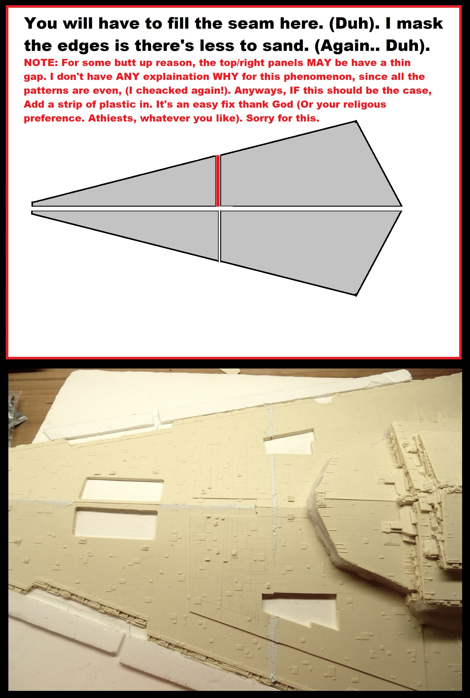

Going through his directions/photos though, I reached this one at the end which is the only one that is identified as "troubleshooting"
I hope he doesn't mind me posting that here. If I did just line everything up right now using the lower left hull piece as the starting point, I would have a gap on the right side there.
However there would also be a large gap where the four hull pieces join and another gap between the top and bottom left hull piece where they connect along the trench side because of the way that lower hull is slightly angled out as you get to the center join.
Before requesting any replacement, I would really like to try fixing it on my own. I don't expect it to be fun, but it would be a good learning experience.
Most of these pieces including the tower, all the trench sections on the main and super-structures are warped. One is even warped both length-wise as well as top and bottom like a pretzel twist. I figure getting those pieces taken care of first will give me a better understanding of how the heating and setting process will go when I finally am ready to tackle the big section.
Oddly enough, the only pieces that don't seem warped whatsoever are the interior support pieces. Those all appear true, or close enough that once assembled, they should be already pulled in the proper directions..
